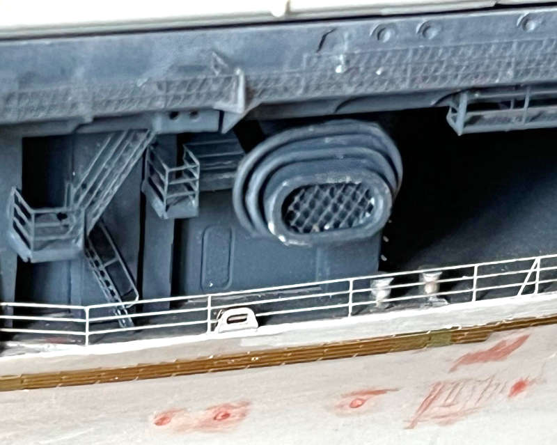

Hello:
Also, returning to the hull to finish off a few last things before it goes in for paint. Under the 5" guns, there are two holes (I think for mooring ropes) and the portholes above them. It seems like this row of portholes remained while the rest were plated over. The kit portholes are round when viewed from the side, which makes them oval when viewed perpendicular to the surface. Those holes were filled, then drilled out with a 1.0 mm drill to make a hole that is round when viewed perpendicular to the surface. Looking at the photo, I think I should do a little sanding over the mooring rope holes...they look a bit rough. The pencil like under those parts is my attempt to draw a level line. It looks really tilted, but that's because of how the tilt of the hull increases going forwards. From the side it's reasonably level.
Mike

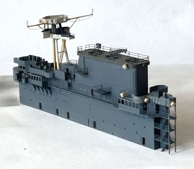

Hello:
The island is coming along. The look out tower is now attached to the island, so now it doesn't fall over with the lightest touch. The yard arms are installed. I waited to install the yard arms until after the look out tower was installed so that I could align the yard arms to the base of the island and the flight deck. From above, I held a square against the side of the island and adjusted the yard arms to be parallel to the side of the square. From the front, I adjusted the yardarms to be parallel to the deck. One thing I noticed is that the top 'hat' of the look out tower must have gone on a little crooked, as the two yard arms are slightly skewed from each other (i.e. the starboard side is a bit forward of the port side). It's a bit hard to see, and fixing it would require tearing apart a lot of the look out, so I'll let it be.
Mike

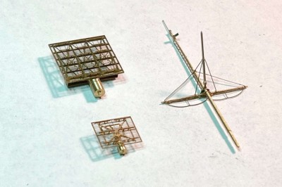

Hello:
On other news, I've also put together a few PE subassemblies: the two radars and the main mast. The only major subassembly left for the island is the foremast. These all went together without any fuss...just following the directions. The only real care was getting the parts of the main mast to be square.
Mike

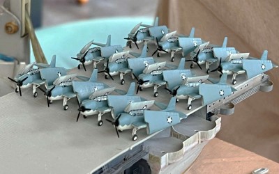

Hello:
Staying with the airplane theme, but these are really tiny. The canopies and props have all been added to the Avengers. I got some Vallejo black primer, so I used that on the props as a primer and then I realized that I don't really need to paint over the primer. The canopies don't have the right number of frames for an Avenger, but given the scale, it gives a reasonable impression of the greenhouse canopy. I used a fine tip brush, then after the paint dried I scraped away some of the excess with the tip of a facto blade where the paint went a bit too wide.
One thing that drives me nuts about little canopies is that you really notice the light reflecting off of the bottom and the edges. This is from total internal reflection of light inside of the plastic. To suppress this internal reflection, I painted the edges of the canopies dark gray, so that instead of reflecting off of those edges, the light goes into the paint and is absorbed. It's a similar thing to how fingerprint scanners work. I'm quite happy about how this worked out for the Avengers.
Moving on with to the F4Fs...

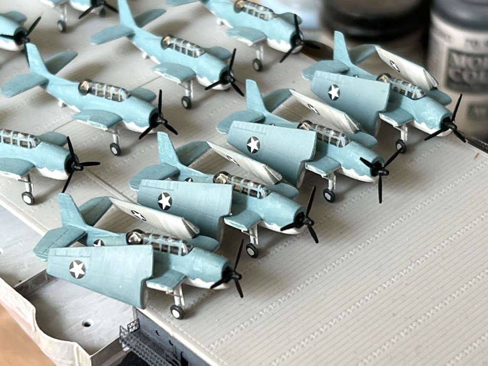

Joined: Sun Feb 07, 2010 8:13 pm
Posts: 215

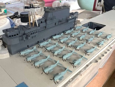

Hello:
Lately the effort has mostly been on the F4Fs, getting the canopies on and painted, and adding the props. I'm about half way through this effort, and I've 'only' lost one canopy. Photos show that the prop hub was often silver, so I've painted them accordingly.
In other news, decals. Let's do some math: (25 F4Fs + 20 SBDs + 12 Avengers) x 6 stars per plane = 342 decals just for the national insignia. After trying to scrounge enough decals to do the airwing, I found that Starfighter decals does a decal sheet that specifically includes the airwing for Enterprise at this time. Shortly after placing the order, the sheet arrived.
The Avengers have long been the test articles, so they got declared first. My first try didn't go well, as I couldn't get the decals to slide off of the paper, regardless of how long I soaked them. I sort of peeled them off with an exacto blade. After a bit of Googling, I learned that hot water can help, and indeed it did. But it can help too much, as one of the side numbers for an Avenger came off in the water and curled up on itself. So hot water really helps to release the decals, but not too much.
At this point, I've decaled 4 Avengers. Having been decaled, I also put the wings on, trying to get the tilt of the wings right. The tops of the wings tilt inwards quite a lot, and the wing tips are point to the ends of the elevators when folded. Overall, I think that went well. Only 8 more Avengers to go.
Mike
Posts: 215
Hello:
The Avengers do have their numbers on, as provided by the Starfighter decal sheet. However, they're very hard to see with the wings folded.
Lately, effort on the Big E has been getting the canopies and props on all of the F4Fs. That is now done. Nothing really to write home about...just a lot of hours to get it done for all 25 planes.
Next: decal the rest of the Avengers and get their wings on.
Mike
