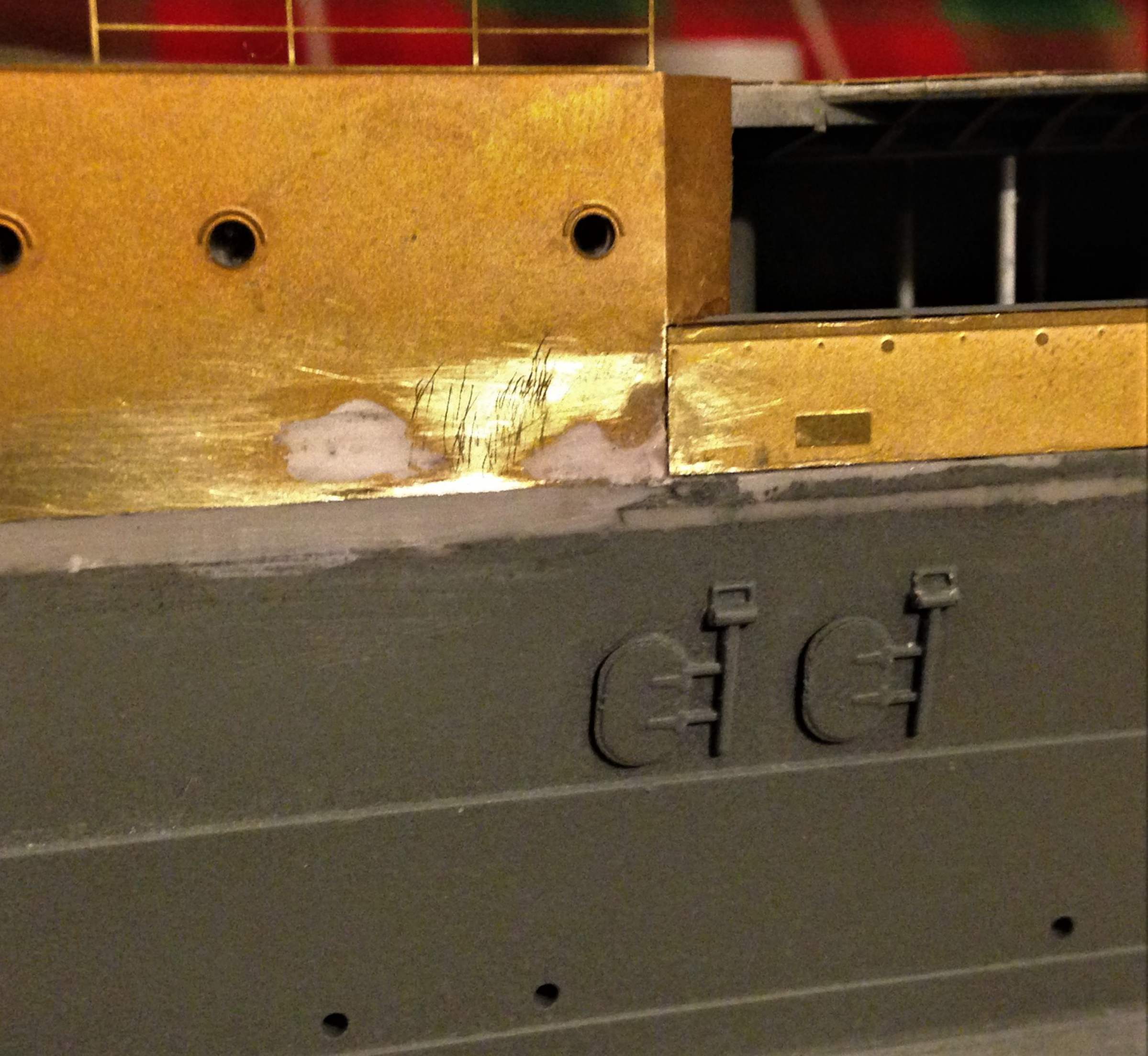

for some reason I was not looking forward to fitting these, and I was right, take it from me you need to dry-fit, file, check, re-check and then go through the whole process again!
The first one I fitted ended up looking like a dogs dinner, there was nothing for it but to gingerly remove, re-fettle and re-fit. Fortunately I managed this without the whole shebang falling apart!
Here are some pics, I did the normal filling with Holts Cataloy, this stuff is brill!, hardens off quickly, sticks like the proverbial to both the metal and the plastic and is easy to sand.
As you can see, I didn't make a very good job of drilling out the portholes before I fitted the etch, I have rectified this now as you can see -

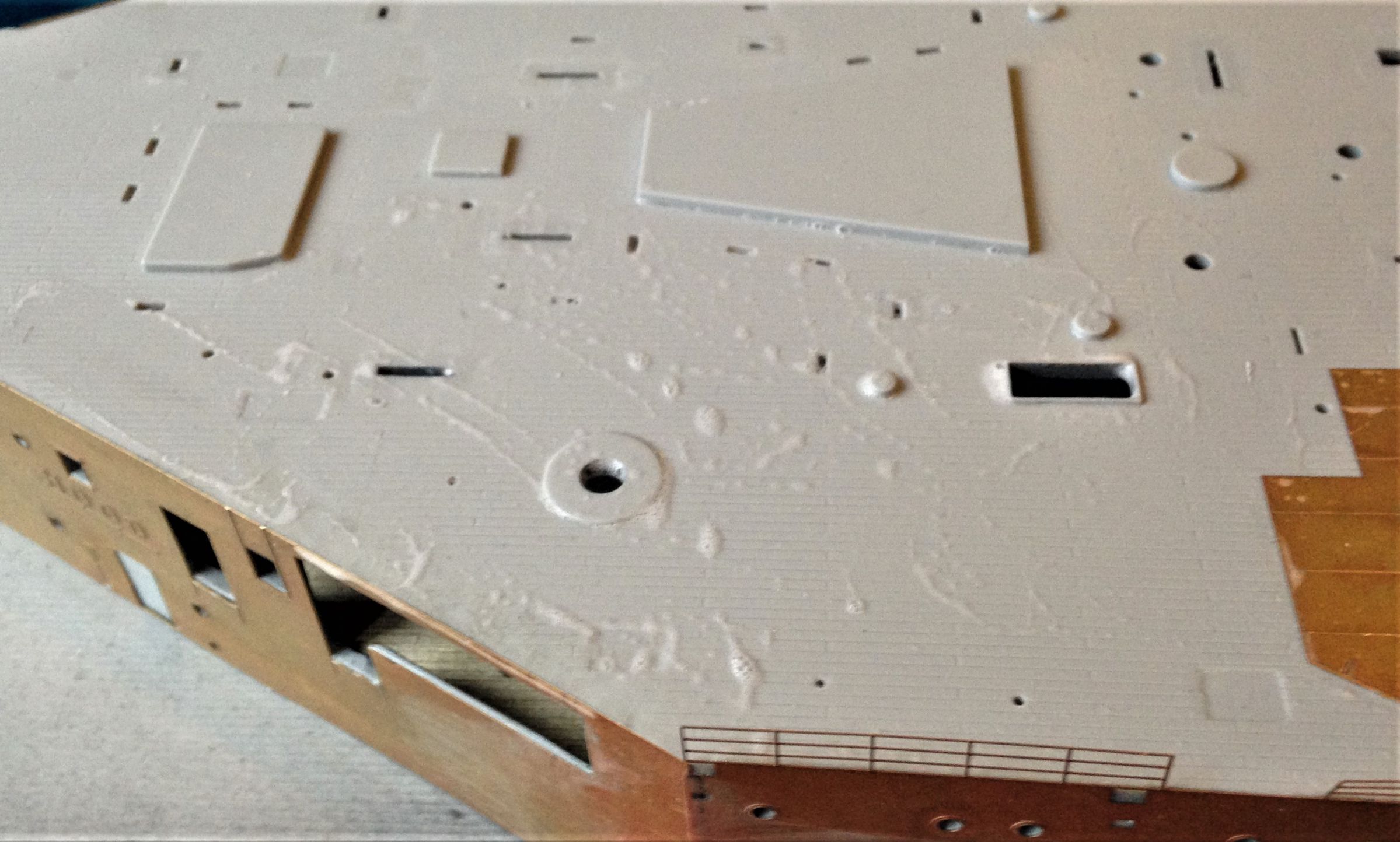

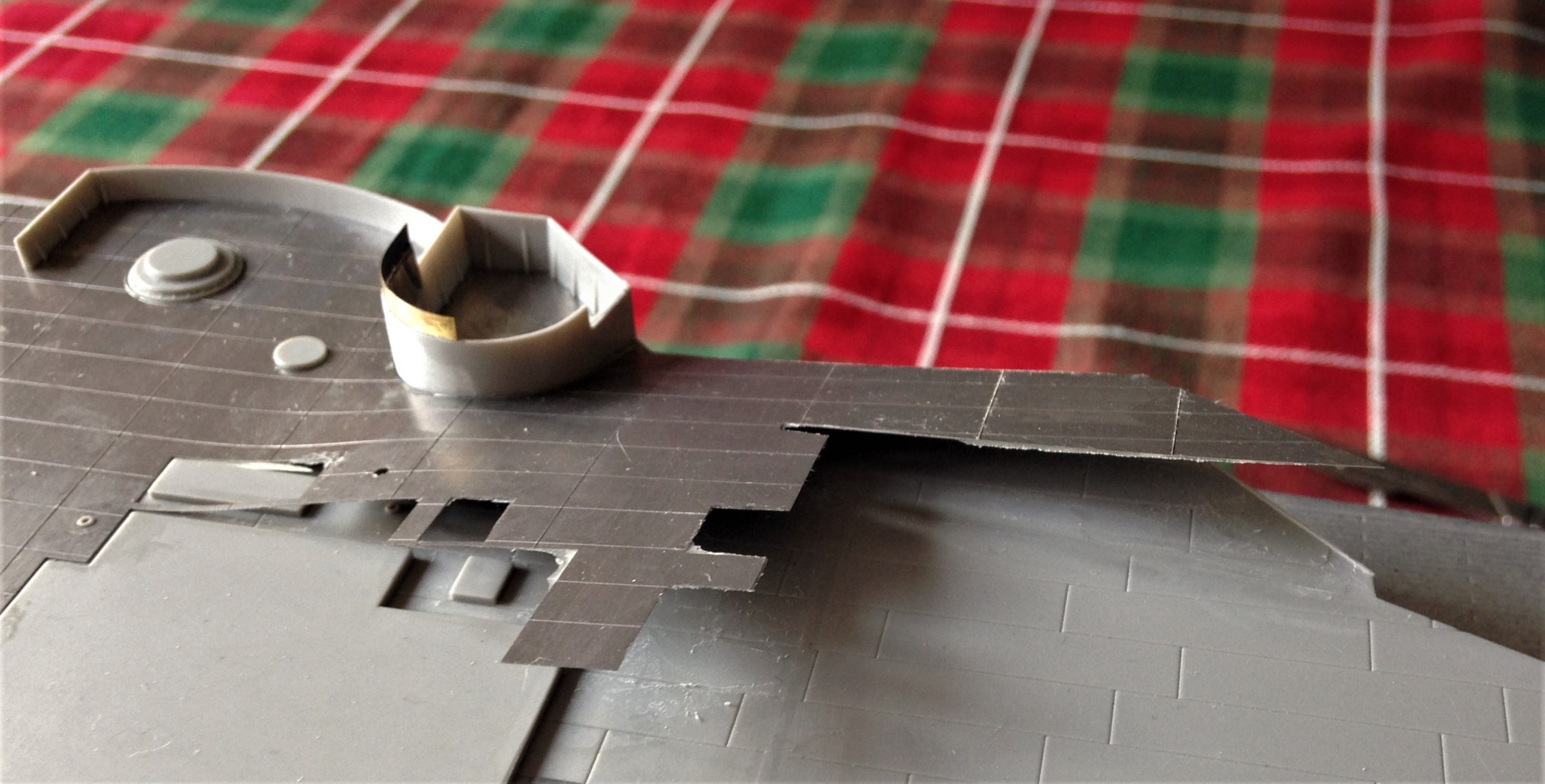

Slight amendment to the plans for this weekend, I have been looking back at some of the pictures and having looked at the model I have decided to remove and redo the etched steel deck on the shelter-deck. It was the first time I had used two-part epoxy resin glue in a long time and I have never been 100% happy with the fit, and have noticed that it is quite badly fitted and there are lumps and gaps where there shouldn't be.
Lump -
Gaps -

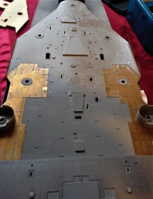

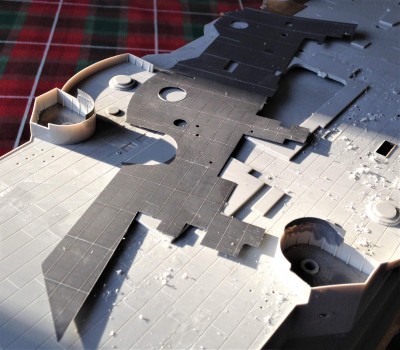

So, bullet-biting time. I looked for a suitable start point to start the removal of the stainless steel part -
and gently moved the scalpel around between deck and etch to break the seal. I started at various points around the deck until they all joined together and the etch was free -
I would not have been able to do this had the etch been made from brass as it would have bent and distorted and would have ended up unusable.

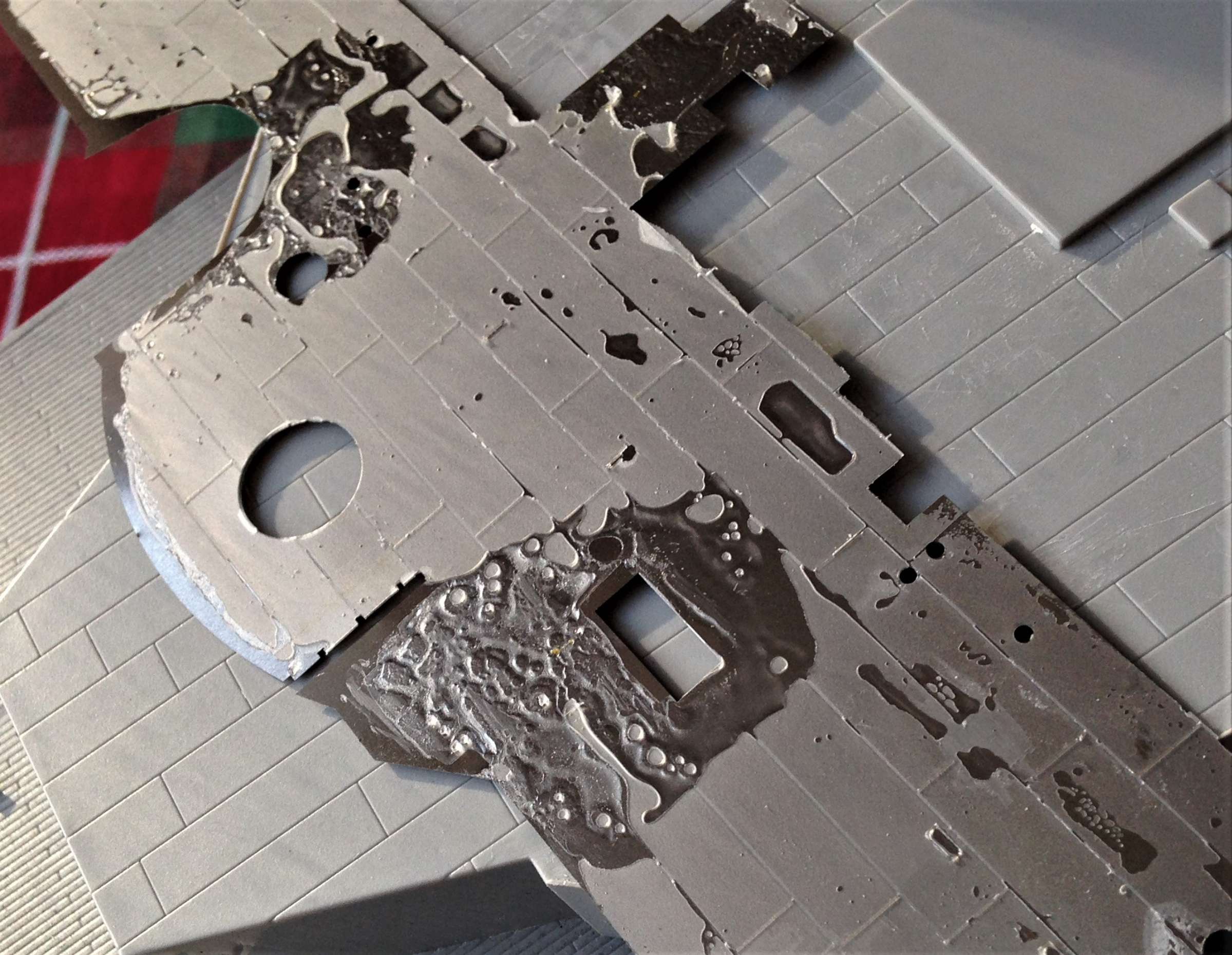

I looked underneath the first one to be removed and noticed this -
I obviously applied way too much adhesive, it hasn't even touched the plastic deck at this point.
I removed the second section, more confidently this time, again with no damage -
Here is the cause of the lump, a large piece of the adhesive, but, more importantly, I missed some of the deck detail that needed removal -
and again, a large area of the etch which hadn't even touched the deck!
Poor modelling and a complete lack of attention, I remember back to when I fitted this I did do it in rather a hurry as I thought the adhesive would dry very quickly - it didn't!

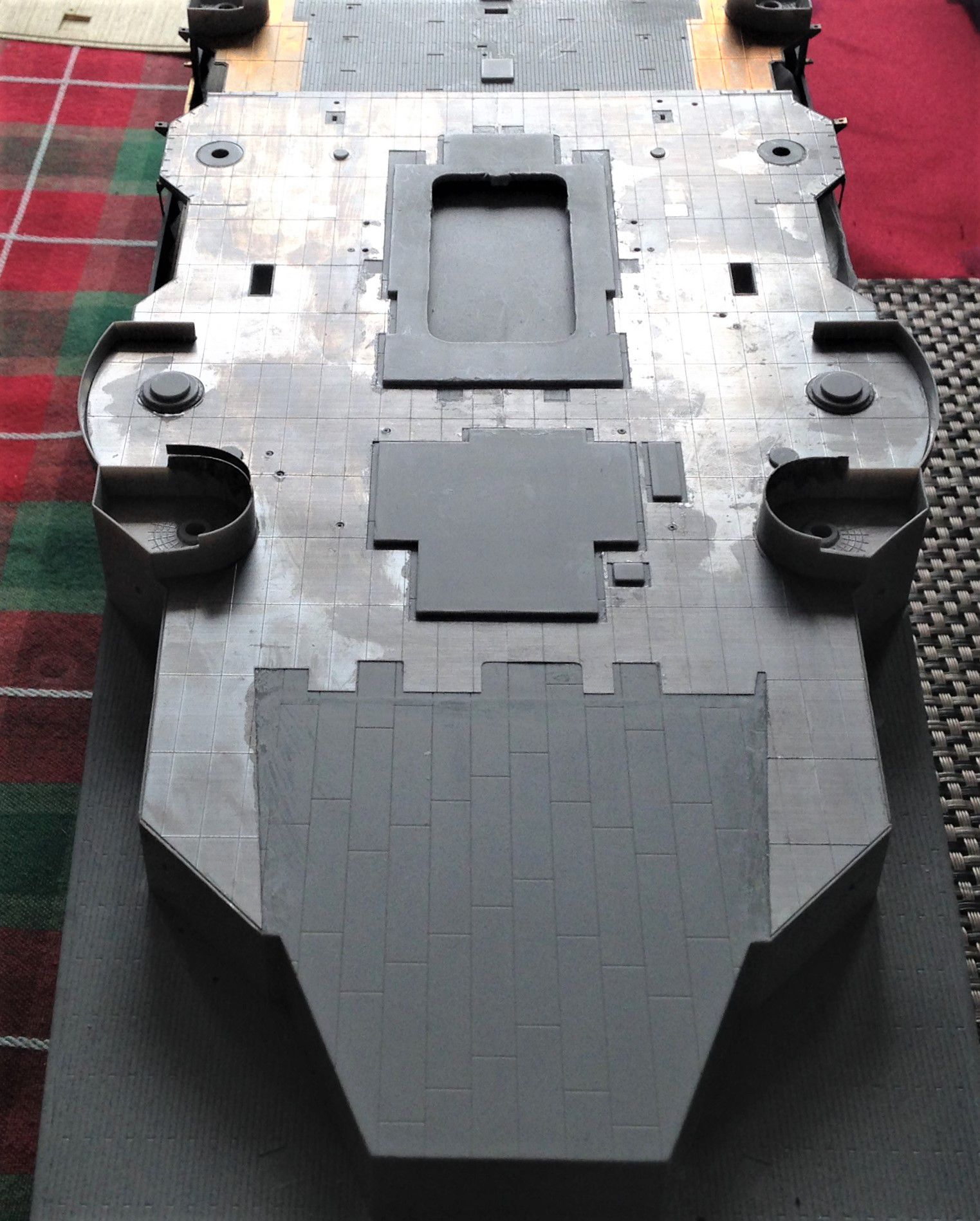

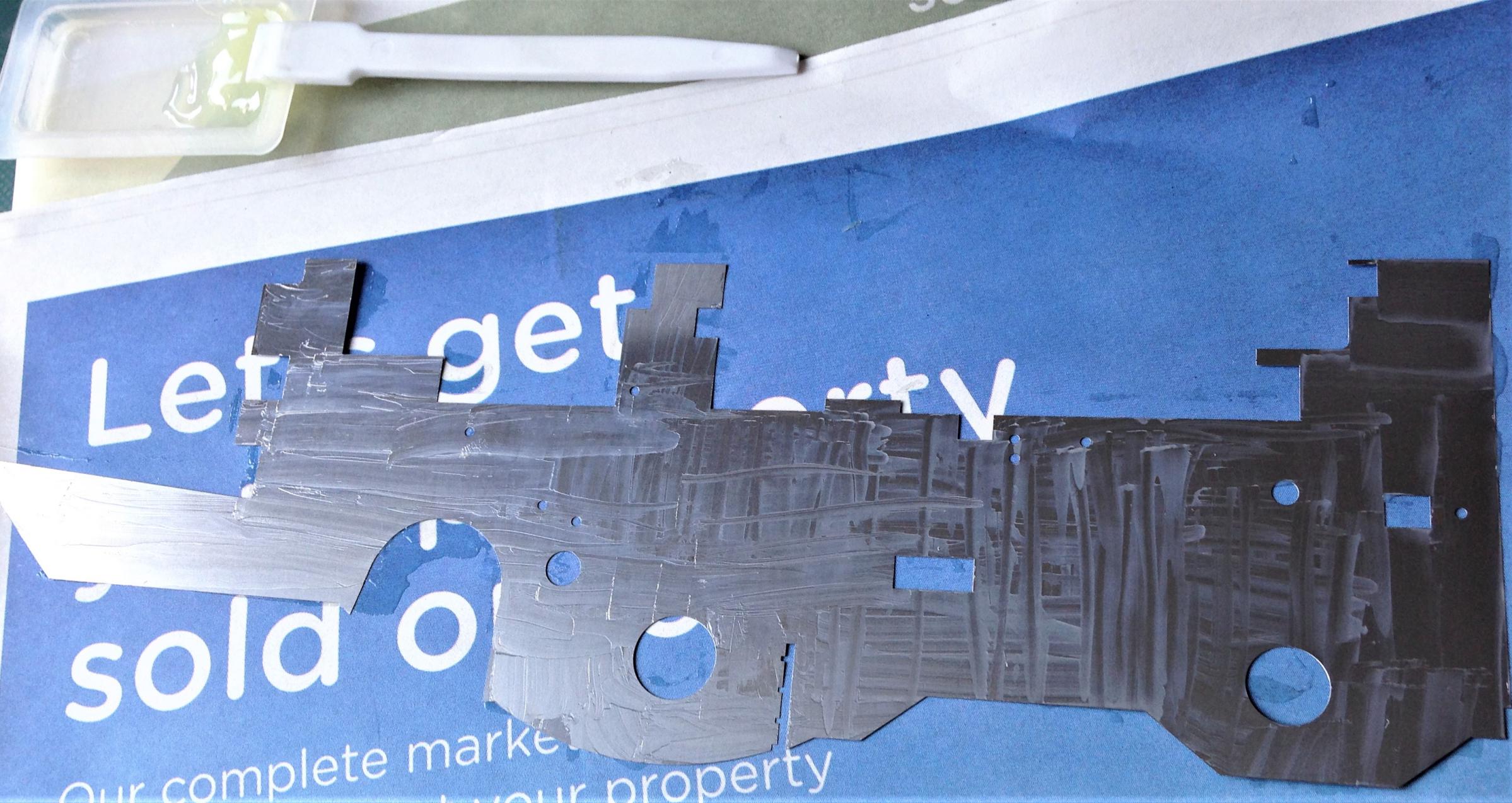

On to the resolution - having been fortunately and kindly donated the largest part of a Pontos kit by Timhan, I had the two etch parts available to fit immediately. I did try to remove the old glue from the fitted etch and it did come away fairly easily so I could have used them if required.
Here are the replacement parts and the glue used -
THIS time, I spread the resin much more thinly -
with the following results -
and the lump
and gaps
are now gone!
Moral! Pay more attention and don't rush things!

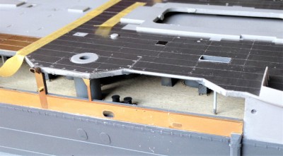

I think I mentioned before that I use a soapy liquid on the deck before attaching the wooden decks -
This is a mix of about 20-30 to 1 of water to liquid hand soap. When it is painted onto the deck I then scrub it in to make it 'frothy' -
and its a good job I did!
I have mentioned this before, the wooden decks are not quite right, this one was 'off' as well! You can see the misalignment around the rear 'box'. It seems to fit pretty well everywhere else!
Here's a little tip, I haven't seen this mentioned anywhere else, but you are supplied with a mask for your wooden deck -
it's the backing plastic, you should be able to see it here. Exactly the right size!
What I will do is cut the edges slightly where needed to allow space for the masking tape around the bulkheads etc
