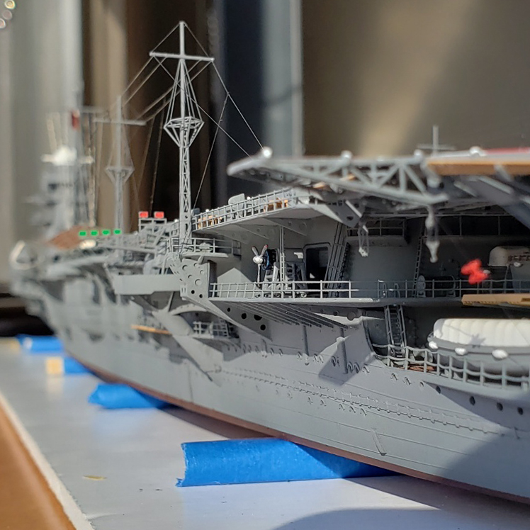

My apologies if this has already been covered, but can you describe how you did the rigging? I think it looks really nice, and kinda makes me think about adding rigging to my Enterprise.
Mike
Mike
- Posts: 9047
Re: Fujimi 1/350 Hiryu ( ?? )
Thank you very much gentleman. Your encouragement is really appreciated.
If there's something else you wish to know, feel free to ask.
Very good, Matt! This argument isn't quite at the level of Arizona's paint job on 12/7, but it's out there among the IJN aircraft cognescenti. I'll explain my reasoning later this week in another post (because I'm really under the weather this weekend and can barely focus. This post is all I've got in me.) My choice is two blue ID stripes on the fuselage.will you be portraying Lt. Tomanaga's bird? If so, which markings would you use as there seems to be 2 versions both alleged to be accurate and I am not expert enough one way or another to try and make an educated decision.
Well, it's a combination of Infini white Lycra (40 Denier) for the vertical halyards, and Infini black lycra and Dai Rikki 9X fishing line for the horizontal lines. The insulators are just black paint. One thing about the Lycra halyards. They look great, but they are too flexible to support something like a windsock, which I really wanted to display. A line of Dai Rikki would have been better in this regard.can you describe how you did the rigging?

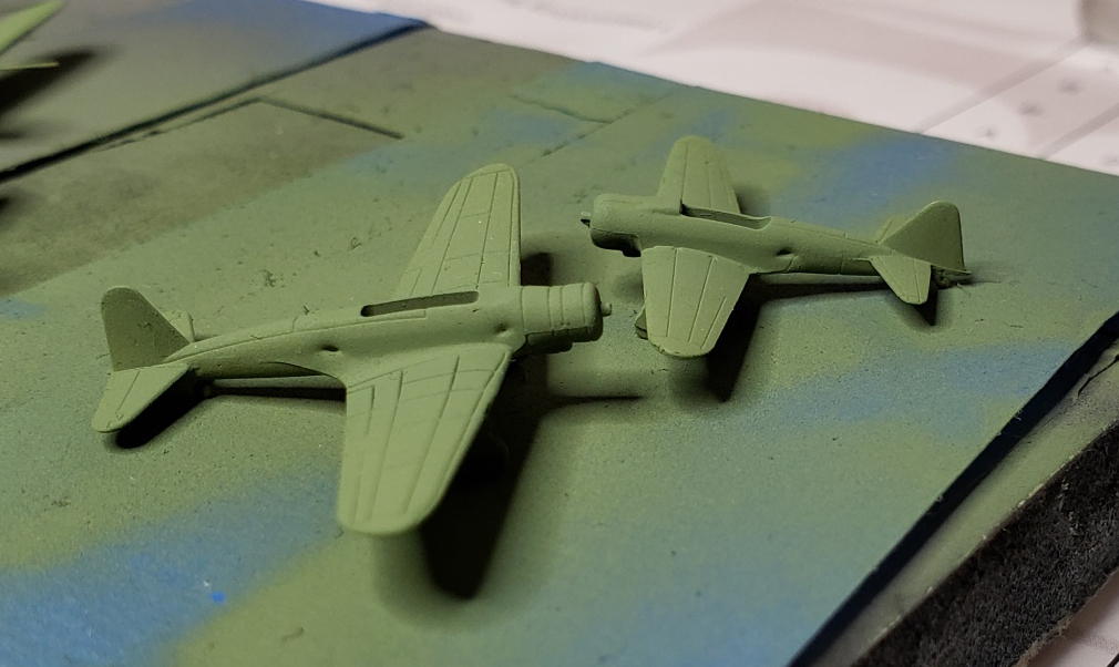

I realized that never posted the Fujimi aircraft with sinkholes
marijn van gils
- Posts: 2686
- Location: Belgium
Thanks!Dan K wrote:I realized that never posted the Fujimi aircraft with sinkholes
Not impossible to fill, but it would be a pretty annoying job...

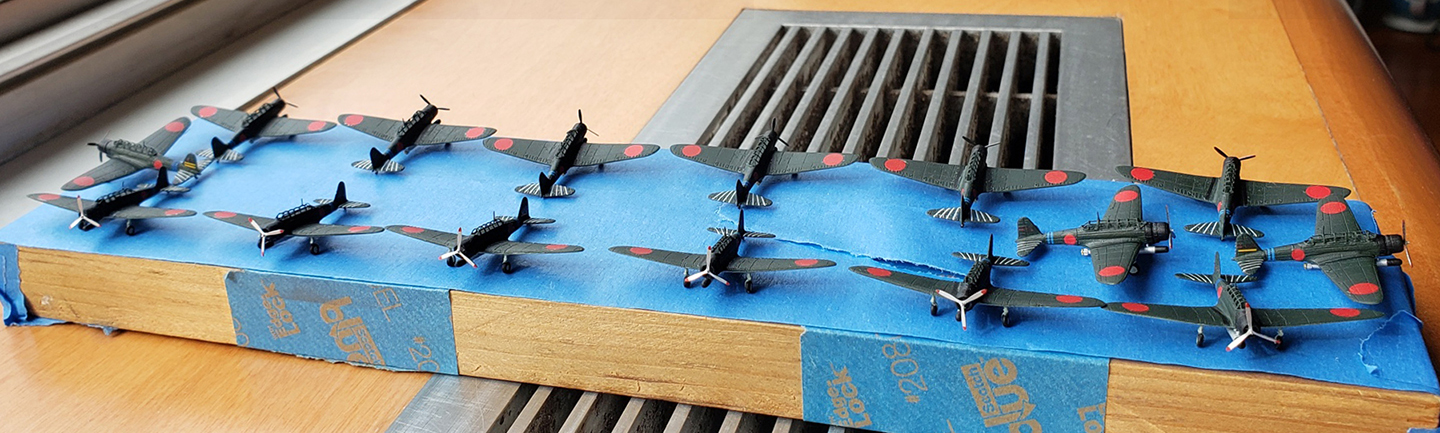

In the meantime, I�ve lagged in my posts once again.

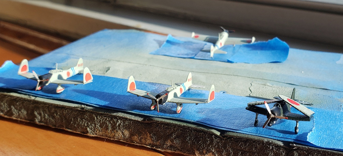

To better answer Matt�s earlier question on aircraft markings �
Through early 1943 or thereabouts, the IJN assigned carrier air group markings based on carrier division and ship seniority. Aircraft assigned to a given division were assigned color bands for their fuselage to differentiate themselves. So, initially, CarDiv 1 (Akagi, Kaga) were red, CarDiv 2 (Soryu, Hiryu) were blue, CarDiv 3 Hosho, Zuiho) were yellow, then later, black, CarDIv 4 (Ryujo, Junyo; Hiyo added later) were yellow, and CarDiv 5 (Shokaku, Zuikaku) were white. After Midway, the new CarDiv 1 (Shokaku, Zuikaku, Zuiho) were white and CarDiv 2 (Hiyo, Junyo, Ryujo) were yellow.
Aircraft were given one or two fuselage bands (or three if in a three-ship carrier division) according to which vessel they were assigned. The aircraft from the senior vessel (typically the flagship of the division) carried one band while the junior vessel's aircraft carried two bands. So, for example, Akagi�s aircraft carried one red band and Kaga�s aircraft carried two red bands.
At the outset of the war, Rear Admiral Tamon Yamaguchi commanded CarDiv 2 and carried his flag aboard Soryu. Soryu�s aircraft carried one blue band and Hiryu�s two blue bands. However, just prior to the Midway operation, Adm. Yamaguchi chose to move his command to Hiryu to take advantage of her larger bridge facilities for his staff. And this is where opinions diverge, both in Japan and in the West.
Some knowledgeable folks maintain that such a move would have dictated a repaint of the aircraft bands to reflect Hiryu�s new status as senior vessel. This would have involved a fair amount of work on the part of the aircraft maintenance crews, particularly while readying for a new operation on the heels of Operation C to the Indian Ocean, but it was not impossible. And, there are at least two testimonies by surviving air maintenance crew aboard Hiryu that the repaints did happen.
On the other hand, some maintain that the move was only temporary, and did not necessitate such an effort. Administratively, the ship�s status and designations were not handled by their operational commands, but by the Navy Ministry. So, from that perspective, any shift in in the flag was for conveniences sake and had nothing to do with the administrative structure of the division.
So, opinion has long been split, particularly because there is no documented evidence to substantiate either opinion. Even the model companies are split in their opinion. Fujimi�s kits favor the two blue bands for Hiryu�s aircraft, while Hasegawa�s line of aircraft models consistently shows one blue band for Hiryu�s aircraft. The same is true for other companies.
Personally, I favor two bands. The clincher for me is that at Midway, Soryu is wearing the large white surround type hinomaru as befits the senior ship of the division, just like Akagi.
In any case, the air group is done. Unfortunately, the red tail code marking decals are not particularly visible against the dark green color of the Kates in this scale. Doesn�t seem to matter if the decals are from Fujimi or Hasegawa. As to the tail code numbers for all the aircraft, the actual numbers are again poorly documented for Midway. So, some extrapolation from the known tail codes beginning from Pearl Harbor were used.
I also decided to put some aircraft in the hangars; that�s in the next post.

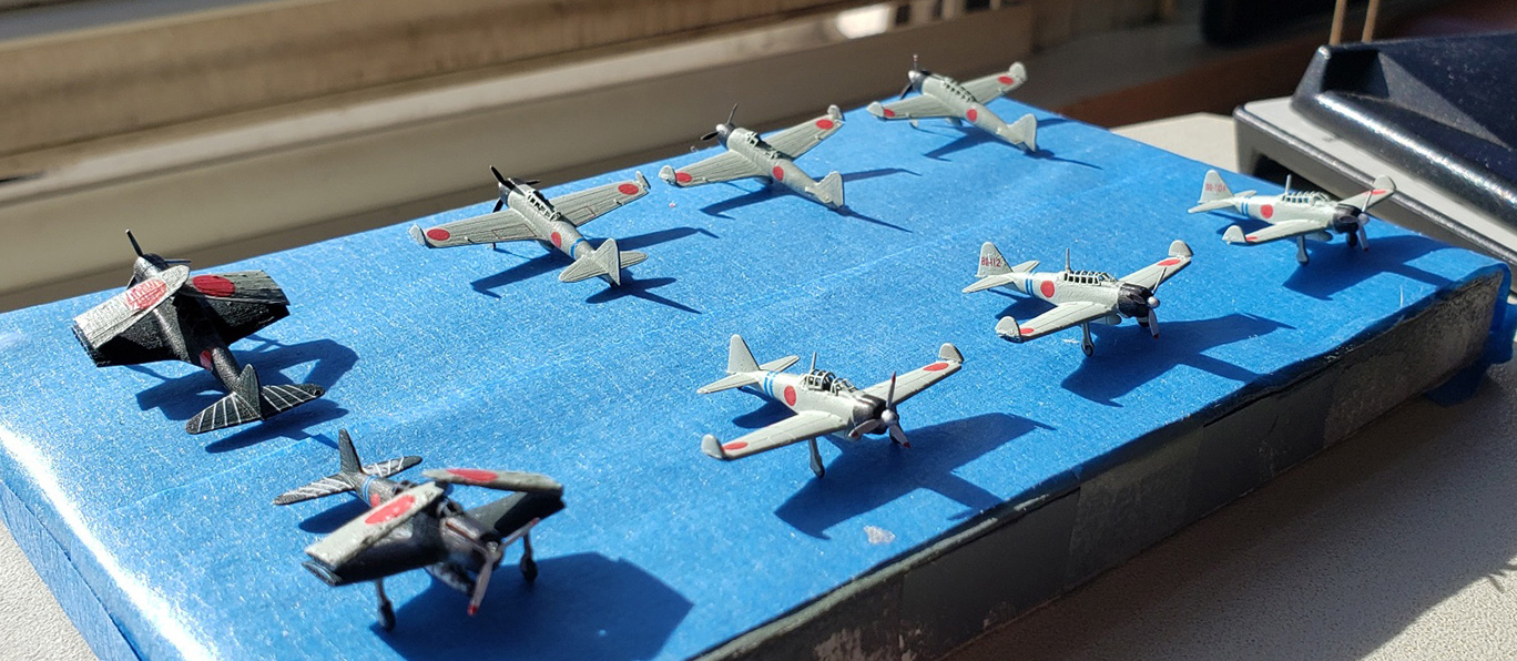

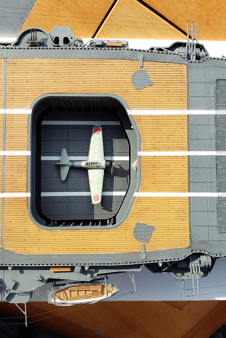

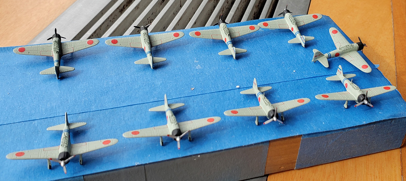

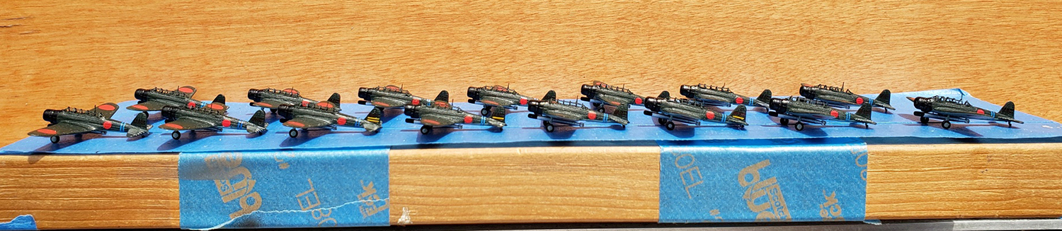

Continuing on, I ended building three of the Fujimi Zeros as well as two of the Fujimi Vals for use in the hangars. Which meant filling those sinkholes. I also used a couple of 3D Wild aircraft for the same purpose. And, I built a second #1 elevator to stage in a mostly lowered position with a Zero aboard.
I can't seem to find my shot with the Vals stowed in the hangar. Hmmm.

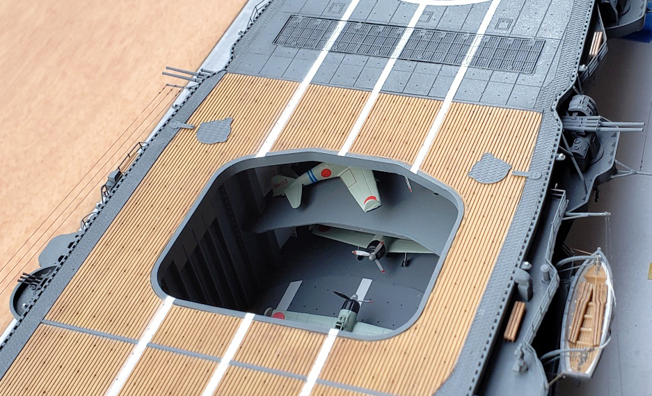

One last item was the engine test stand. In this particular case, I went the lazy route. I just didn't feel like building one. So, I challenged one of our hobby's leading after market suppliers to design and 3D print one after I gave them whatever information I had.
And, they did. Magnificently so.

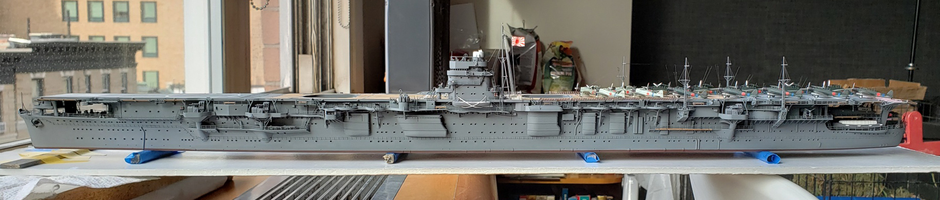

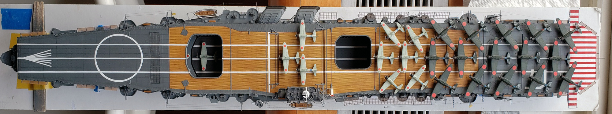

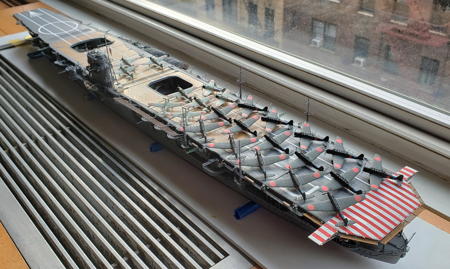

I'm pretty much done now, save for a few small things. I've staged the air group for a couple of photos. Hopefully, I can finish these other things soon, then post a gallery entry.

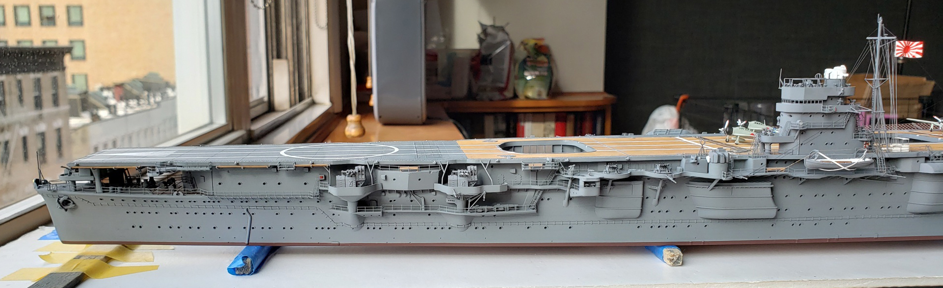

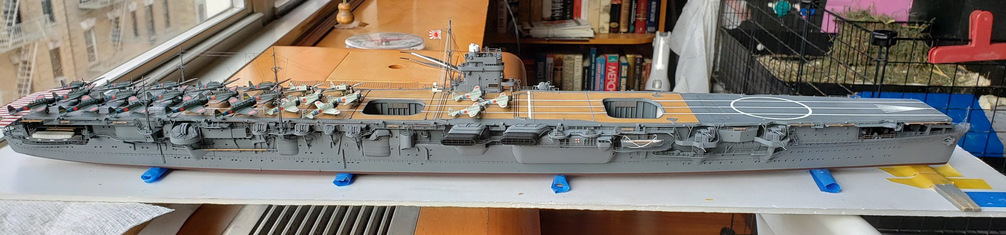

I'm still planning to add a few details.
A recent photo shoot did not produce many good photos, but here is one showing one of the Vals in the hangar.
