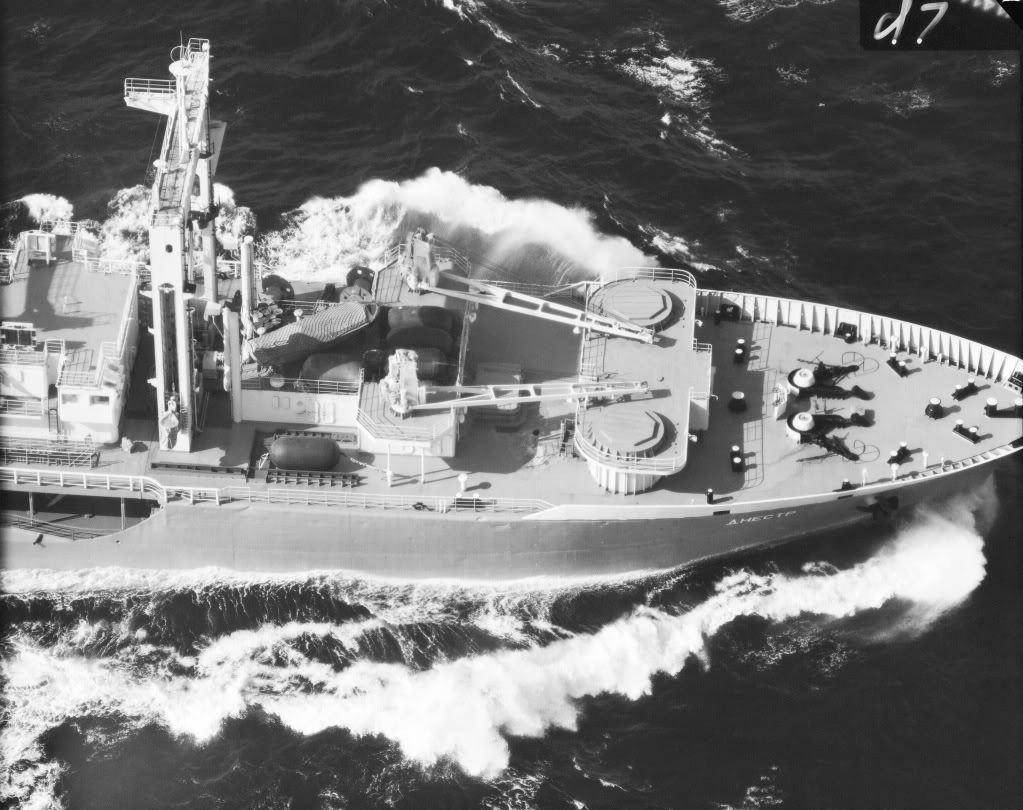

PS: I just figured out why I always assumed they were fenders. The Chilikin class has these tyreless fenders on deck too. I have close up pictures of those, I'll upload this evening.

Here it is.
This will probably confirm my thoughts when you compare it with your pictures.

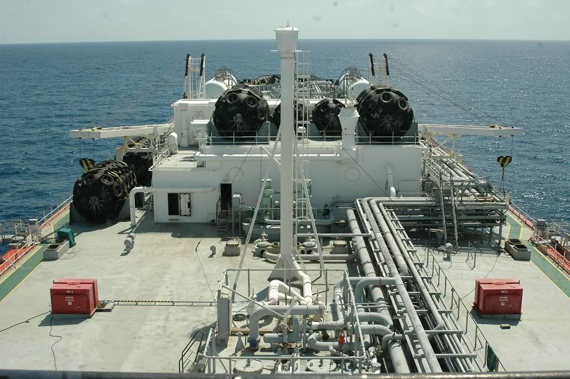

Just for reference, ours are 6.6m long and 3.5m diameter (and they weigh 7.5t each, in case you want to go this far for scaling on your model :heh: ). The ones on the Chilikin class, look like about 4m length and 2-2.5m diameter.
We often refer to them as "Yokohama's" as that's the main manufacturer. The tyres are old truck tyres, with steel inside the rubber. Pretty solid stuff.
That's ours in stowage position, they take quite some place, not sure if the ones on Kirov are the same size, they look slightly smaller. The No 3 fender you've marked, looks smaller than the others too, but it could be due to the shadows and lighting.

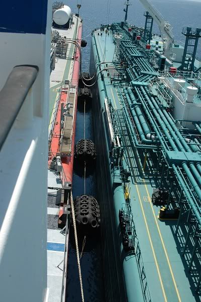

Guys, found a couple of photographs showing the fenders "deployed" over the side.
