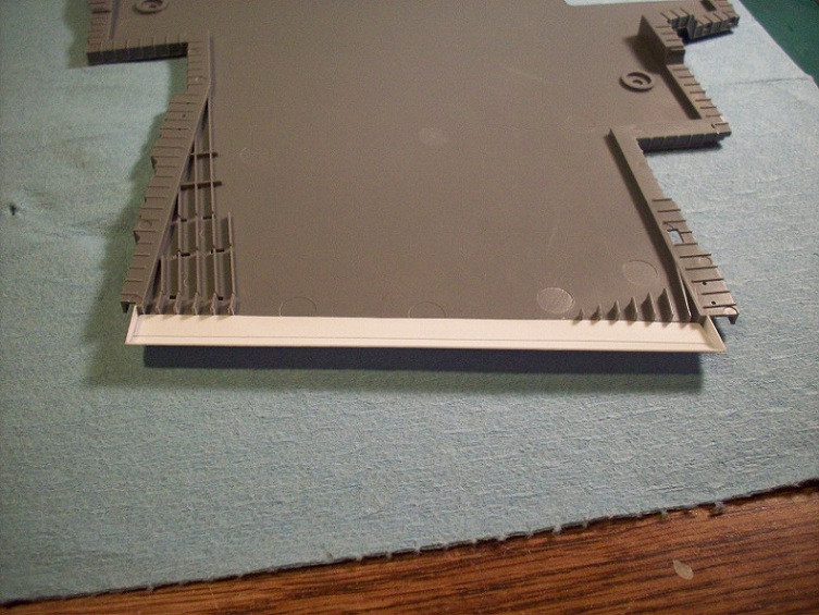

I have also cut the rounded aft end of the deck off and replaced it with the corrected angled deck. Once the deck is glued on I will finish building the structure underneath.

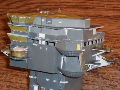

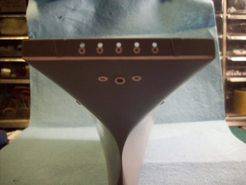

Here's a couple bow shots. I've sanded down all the raised detail and I plan on going back and adding it in later and try to get everything where it is supposed to be. It is quite a bit of work but I think it will be well worth it in the end.

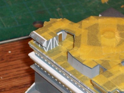

Since I am still waiting for a few items before I get going on the hangar deck, I started looking back over parts of the island that I had done and noticed a few things that needed changing after looking through Still motion photographics photo CD of the Enterprise. What an invaluable resource. Tons of great quality photos. I ended up adding the signal flag station on the port side of the island that I had left off and removed some of the piping that should not have been there on the lower portion and replaced it with what should for the 2001 configuration. I'm still getting some of the other stuff worked out. I wish I had bought the Enterprise photo CD sooner. It really helps.

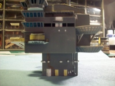

Still working on detailing the island and bow section. progressing slowly . . . . .

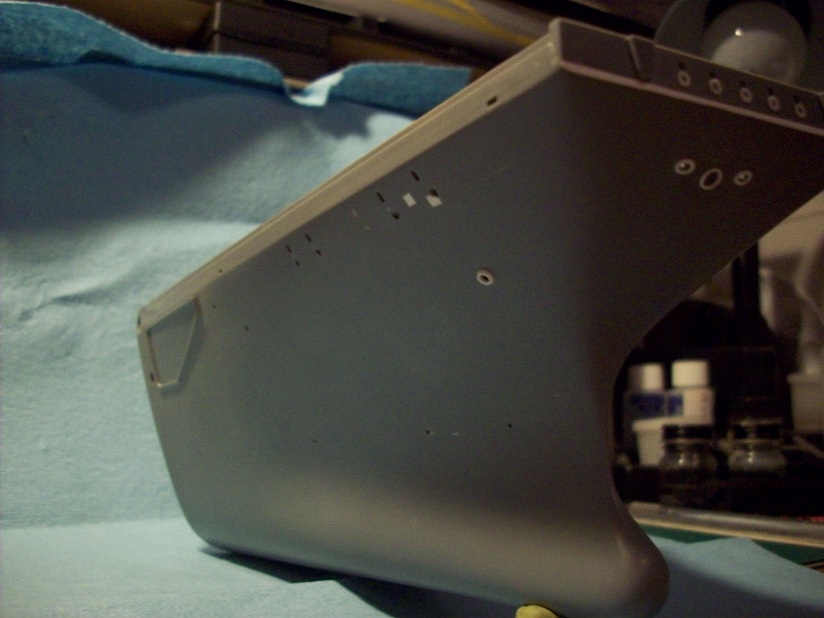

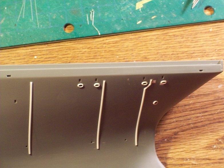

File comment: More piping and wiring added along with the window wiper mechanism boxes for each window.
File comment: Here is some of the corrected piping and hawes pipes. Probably not 100 percent correct but closer to the look.
File comment: Bow on Starboard side
File comment: Bow on port side

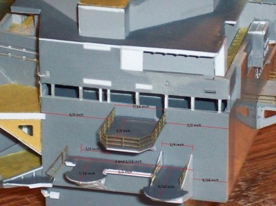

Hi DWD .... a question:
Do you have the exact measurements of platforms that you're absolutely built white plastic on the island (width, depth and height from the flight deck)???
PostPosted: Thu Jan 17, 2013 6:27 pm

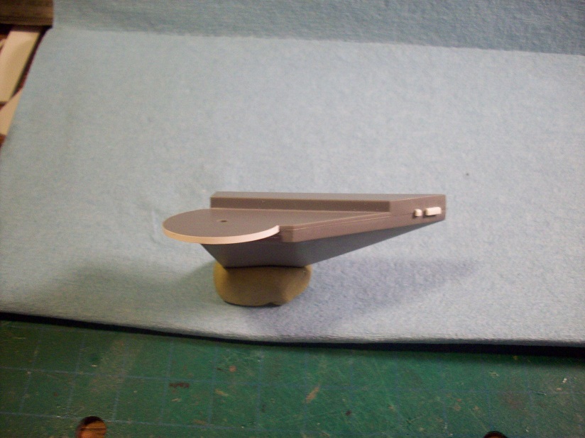

Hey Renato. I will see if I can dig through some of my drawings that I did to illustrate the dimensions. I'm certain they are not absolutely correct though. I based them on dimensions of the Tamiya kit and looking at photos and came up with what "looked right" to me. I actually made pencil drawings of the Tamiya island and based everything off of those. I'm also certain that anyone else who has spent a considerable amount of time building and researching this kit has come to the conclusion that there is quite a bit that can be corrected. Anyway, I will see what I can come up with for you.
PostPosted: Thu Jan 17, 2013 6:32 pm
Posts: 365
Location: Idaho

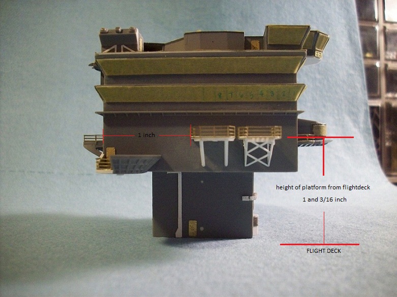

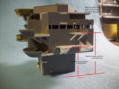

Sorry bout the post above, I forgot to log in. Anyway, I hope these help with dimensions. You probably use the metric system in italy I would imagine, but these are listed in inches. . . . sorry. Hope these help. If you have further questions or need other info, just let me know.
File comment: Here are the dimensions for the bow facing platforms.
File comment: Here is the height measurements for the same platforms facing toward the bow.
File comment: Here are the dimensions for the aft facing platforms.
File comment: Here is the height for the aft facing platforms.
