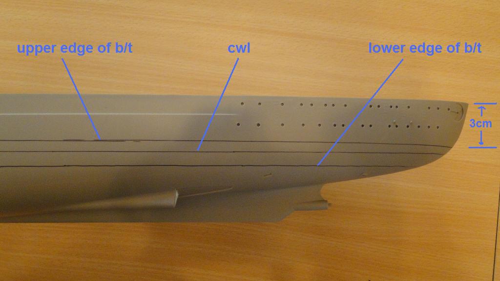

Many thanks for the clarification photos, they do help a lot. Maybe I can make it onto my attic today, grab that hull and see if it features the same problem. From what I've read here so far, not all hulls do have this problem. I find your solution very neat, although I don't quite understand how you figured out the 3cm measured from the upper edge of the hull. If you look at photos, there is no cwl visible. What you're looking at it the upper edge of the boot-topping, and this upper edge was 1m above the cwl (on your model 5.15cm above the keel). Your photos seem to indicate that the *artistic* upper edge of the boot-topping at the stern meets the lower cwl midships.
Happy painting ~ Olaf!
EDIT: I drew on the boot-topping (b/t) and cwl on my model, see attached snap. I've opted for the 2.7m version of the (b/t). Its upper edge at the stern is about 30mm from the main deck. About 6mm below is my cwl (@ 47.5mm from the keel, more or less), followed by the lower edge of the b/t which is located 75mm below the cwl. I think it looks okay, although I'm not quite sure about the height between the upper edge of the b/t and the upper edge of the side armour belt. Did I got that 47.5mm figure wrong? :scratch:

Olaf Held wrote:Many thanks for the clarification photos, they do help a lot. Maybe I can make it onto my attic today, grab that hull and see if it features the same problem. From what I've read here so far, not all hulls do have this problem. I find your solution very neat, although I don't quite understand how you figured out the 3cm measured from the upper edge of the hull. If you look at photos, there is no cwl visible. What you're looking at it the upper edge of the boot-topping, and this upper edge was 1m above the cwl (on your model 5.15cm above the keel). Your photos seem to indicate that the *artistic* upper edge of the boot-topping at the stern meets the lower cwl midships.

Olaf Held
Posts: 892
Location: Flensburg, Germany
Re: 1/200 Trumpeter Bismarck (Commissioning Day 24 August, 1
Post by Olaf Held »
Hi Bill ~ I just got the impression that the cwl on your model merges into the upper edge of the b/t at the stern. It doesn't matter if my cwl is 1mm higher than yours, but I find it funny that your recommendation of drawing a line 3cm below the quarterdeck results exactly into the upper edge of my b/t at the stern while it is the cwl on your model.
And my upper part of the b/t is 6mm as mentioned, not 2.7mm. My lower part is 0.75mm.
What happens if you put your 4mm above-part of the b/t on top of your 3cm-below-deck-cwl? Arent' you getting too close to the portholes that way?

Olaf Held wrote: What happens if you put your 4mm above-part of the b/t on top of your 3cm-below-deck-cwl? Arent' you getting too close to the portholes that way?
