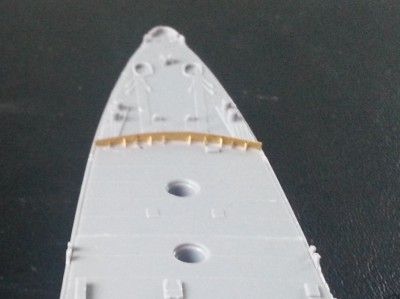

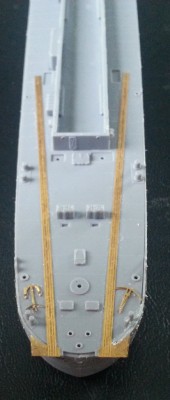

Thanks Dan. I bought the neutral grey. What do you think of the linoleum color I have chosen?

Tamiya has XF-79, linoleum, which is what I used on my build of Nagara. The Mahogany seems pretty dark.

Looks good. Before XF-79 came out, I used XF-64 Red Brown, which is just a shade darker. You could add a drop of white to lighten it.

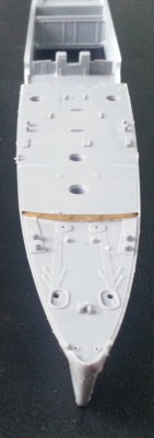

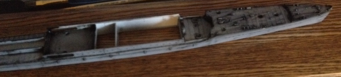

Seven hours of work does not look like a whole lot with these pics. Lets just say it was tedious to try and remove molded on deck detail without messing up what I wanted to keep there....
File comment: removed the closed stairwell hatch that was molded on.

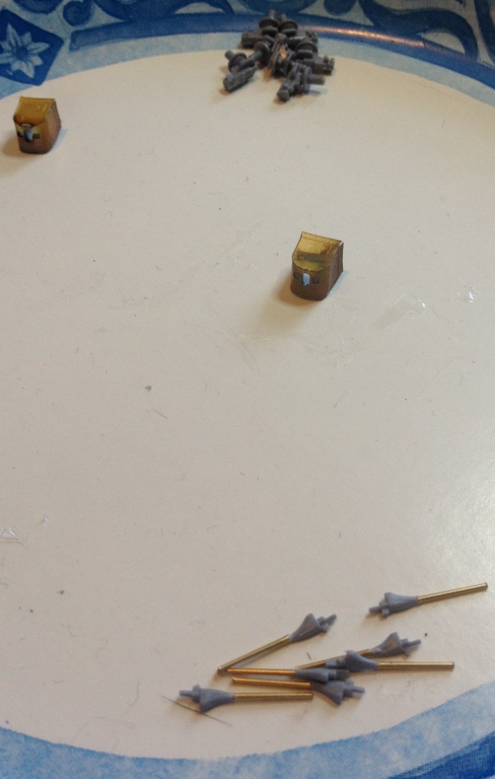

Working on the main batteries. All the barrels have been replaced. I am working on the photo etch wrap arounds for the armor. This has been a bit more of a challenge that I thought it would be. I had to sand the back of the photo etch to give it some tooth as to not just slip all over the place when I put the glue on. I also used a lighter to heat the bras up some to get the bend easier. I have three of the seven done now. It is a lot of "glue a section, add clamping tweezers, walk away for an hour".

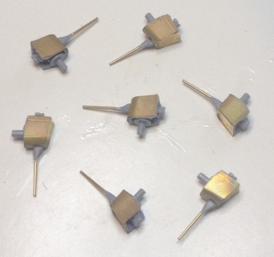

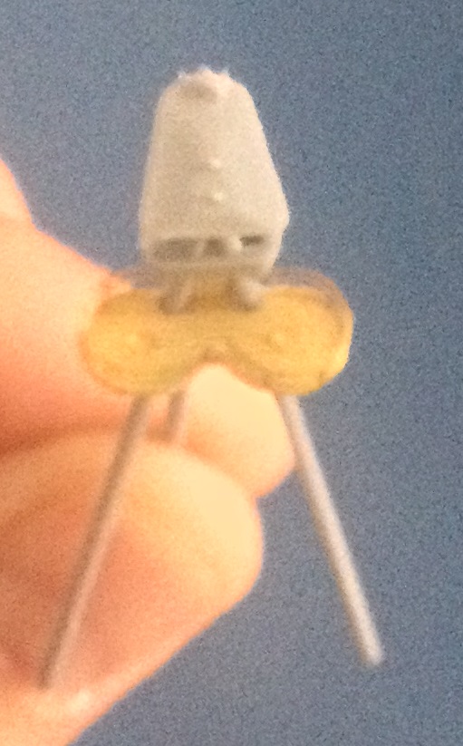

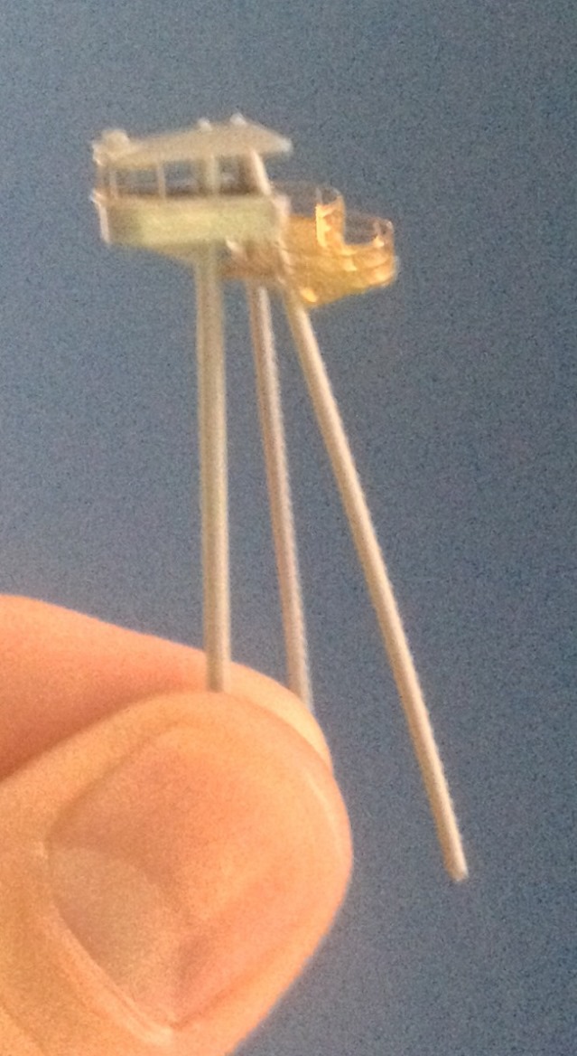

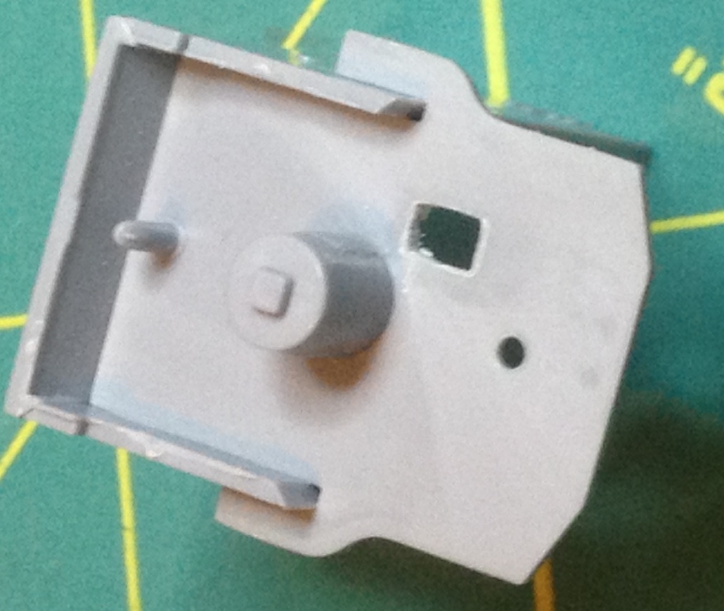

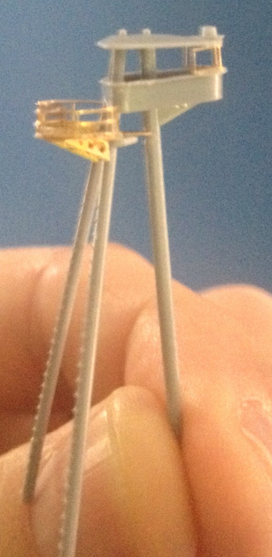

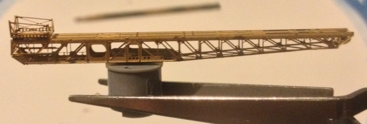

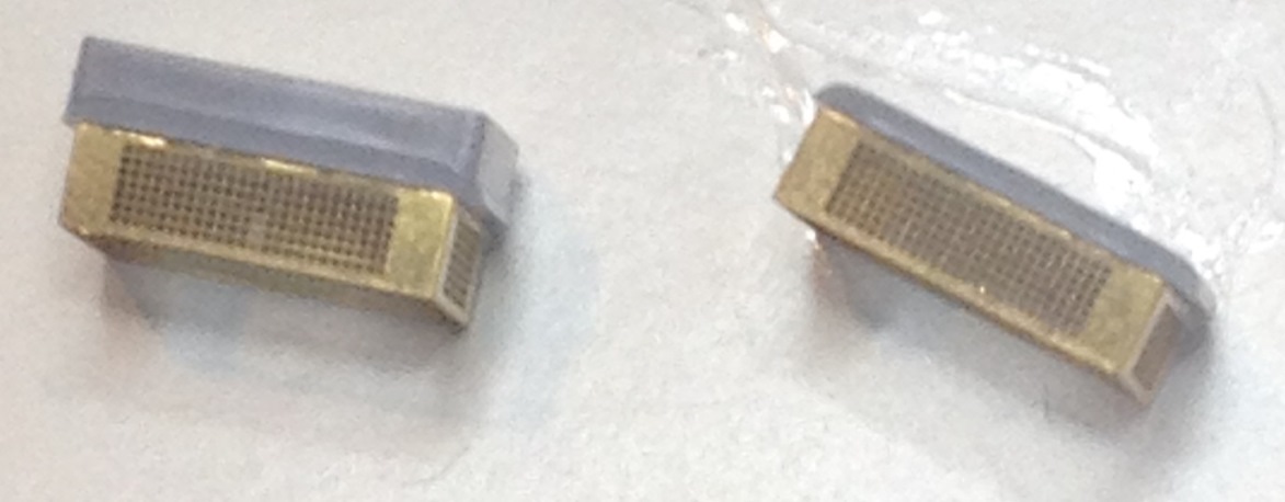

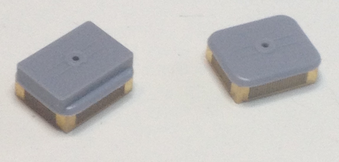

I have managed to get the main batteries and the structures between the funnels largely completed and the main mast is now about 1/3 done. There is a lot more PE that goes on the upper portions of the mast.
File comment: main batteries. This is the first time I have ever done this kind of PE work and also used brass barrel replacements.

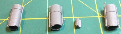

File comment: structures that go between funnels

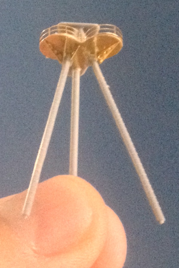

File comment: Main mast

Dude, those PE gun shields are the bomb! So much better than any plastic. Looking fantastique!

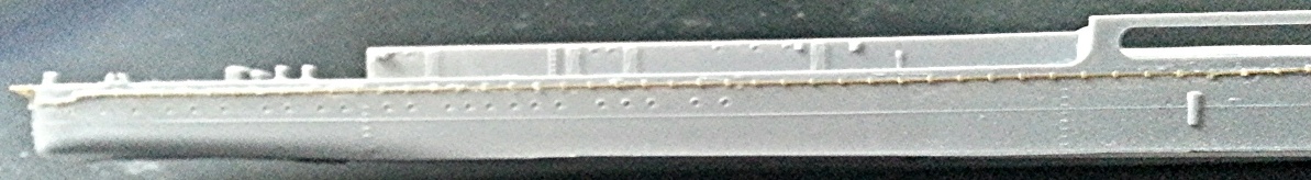

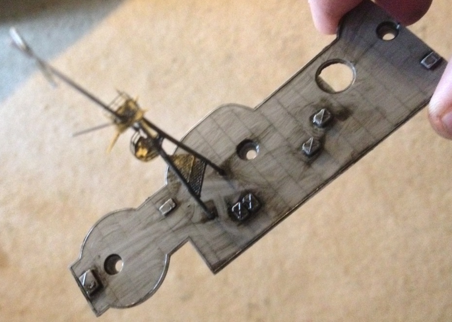

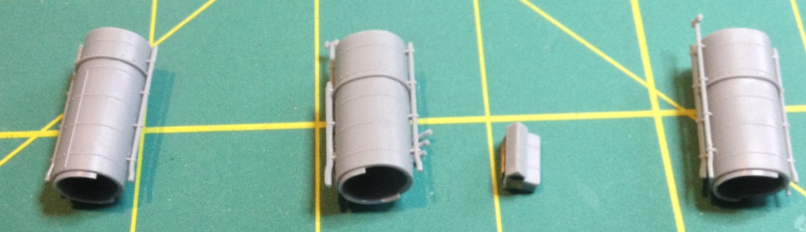

Hey Look! I found my modeling table again! Seriously, I was able to put some time back in and here are the results.
File comment: Basic funnel assembly. The PE will be added later. There is also a small vent shack there as well.

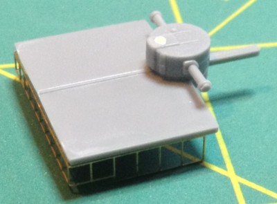

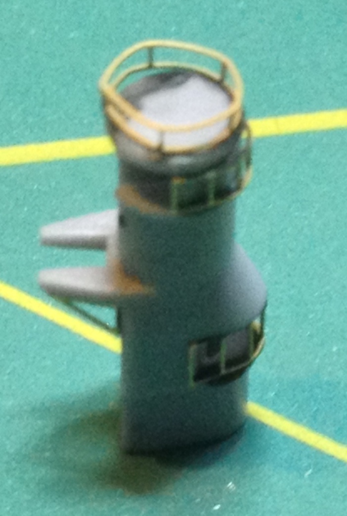

File comment: Top of the bridge. There was a really nasty sink in the range finder that I fixed.
File comment: Part of the top of the foremast. I dropped it and now have to fix the railing... yay.

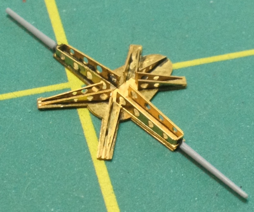

File comment: Part of the foremast structure. This is the underside view. I am really pleased with how this turned out.
File comment: dry fitting
Thanks for looking, and comments are always welcome!

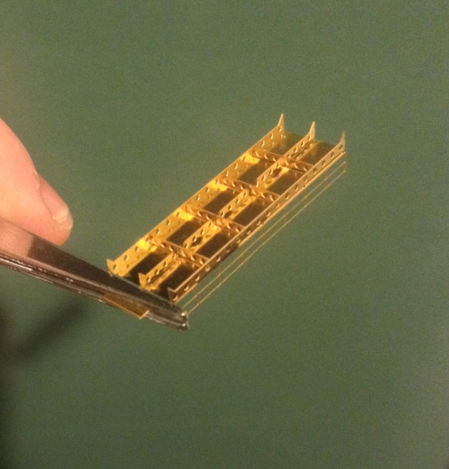

File comment: walk way aft of the bridge - topside
File comment: walk way aft of the bridge - bottom

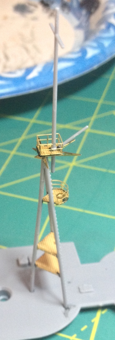

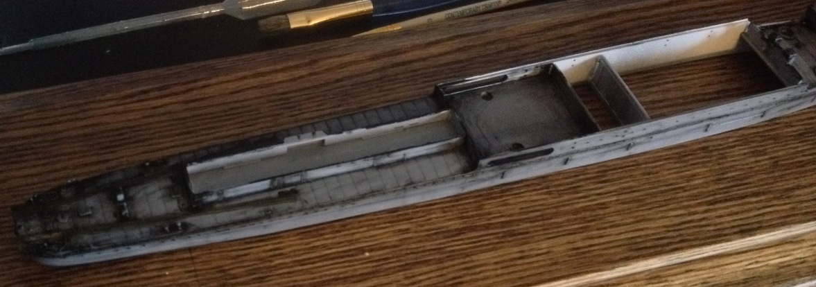

Thank you for the kind words everyone.

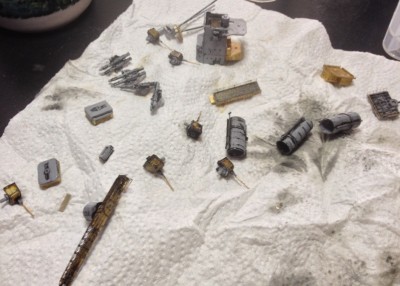

I must send an apology to Chris F. I am attempting to us his shading technique that he so kindly shared with us on his wonder USS North Carolina. So this is my sad rendition that needs substantially more practice. Everything is now sealed with Krylon Matte. Painting to start once I fix a couple of things that decided they did not wish to be attached to the model anymore.
So far I have learned a lot doing this but it should still hopefully turn out decent.
File comment: Midship deck
File comment: Aft deck with main mast
File comment: the rest of the sub assemblies that have had this treatment done.
File comment: forward half of the hull
File comment: aft section of the hull
