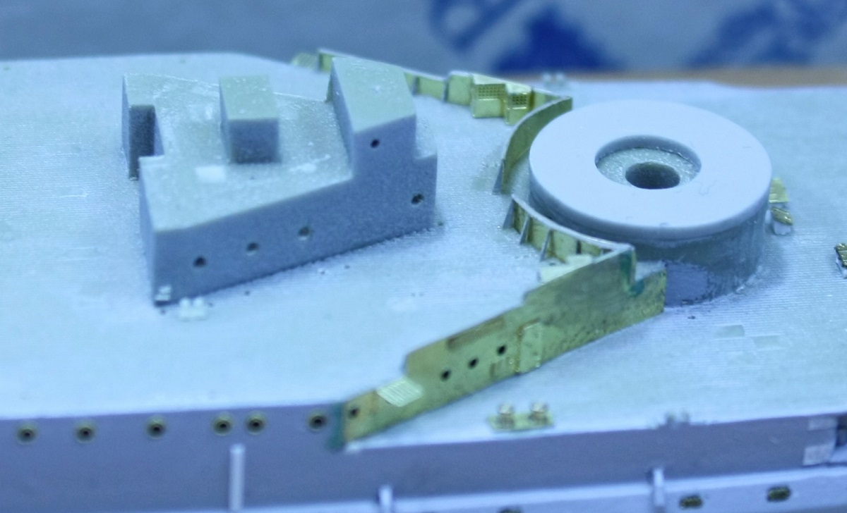

With the deck fittings ready for later painting I turned my attention to the superstructure. For some reason I decided to move from aft to fore, so the bulkhead on the after end of the forecastle came first. This I took from Artist Hobby’s excellent WWI Warspite set. When one side was glued to place I recognised that something was wrong. The bulwark of correct height was higher than barbette X. Measurements confirmed that the kit’s barbette is not high enough. I went on to correct this flaw by cutting a disc from the Trumpeter kit’s respective barbette, glueing it on top of the existing one and sanding the side flush, which was no easy business as the PE bulwark on one side was already in place.

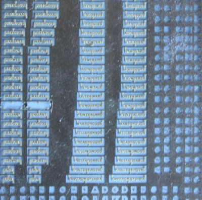

After attaching the other bulwark I replaced the nameplate with one indicating „Barham” from another, really crazy set of Artist Hobby containing nameplates for most important British ships and more hundreds of individual letters.

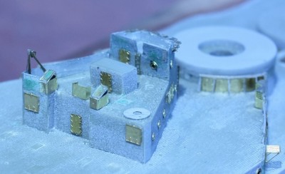

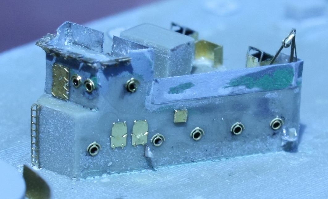

I went on to detail the after superstructure. In the Profile Morskie plan there is a structure on the aft end whose outline is not confirmed by any other source. Therefore I didn’t accept if and came to a solution which is mix-match of information from various sources and probably not correct at all, but I just couldn’t do any better from what I had. I cut off the bulwarks deeming them too thich and replaced them with aluminium sheet. Sanding them flush with the sides of the superstructure was tedious.
I embellished the superstructure walls with everything necessary

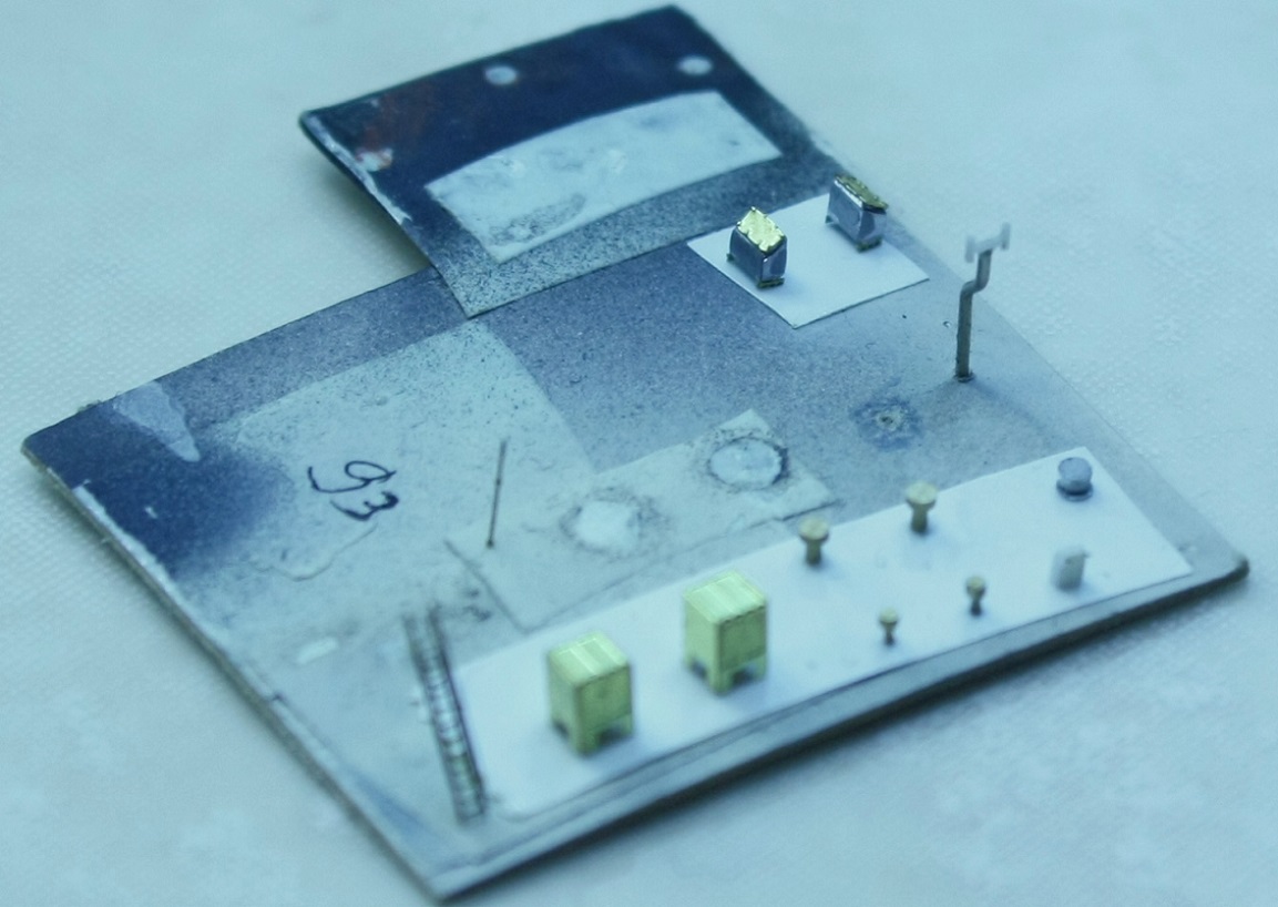

and glued other fittings like two beautiful fresh water tanks from Artist Hobby to a piece of cardboard dedicated to this deckhouse.

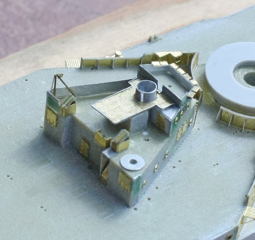

Sometimes it’s harder to proceed with a build if you get additional information during construction. We’ve been through several discussions with Richard Price who builds another, most spectacular Barham about the possible layout of the after superstructure. This led me to rebuild mine to a certain degree. I added a small extension to the port side of the AA platform made of aluminium sheet, then I changed the front face altering the position of the port side vent exhaust (a change possibly necessitated by the fitment of the aircraft handling crane). This was based on a picture found in the Raven-Roberts book about British battleships.
Next a light mesh platform was constructed the exact shape and size of which is not deducible from the available sources, one can only be sure that it was there.
I’m certain that this final configuration of the after superstructure isn’t 100% correct but I’m not willing to spend any more time on refining it. I think we (Richard and I) still did our research more thoroughly than the maunfacturers of existing kits of Barham.

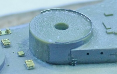

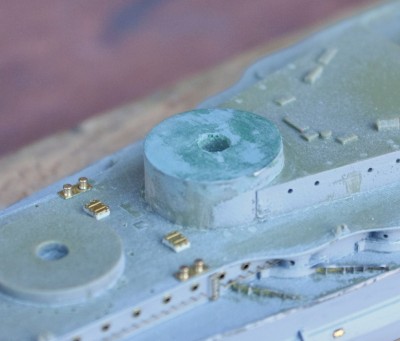

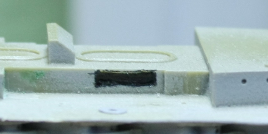

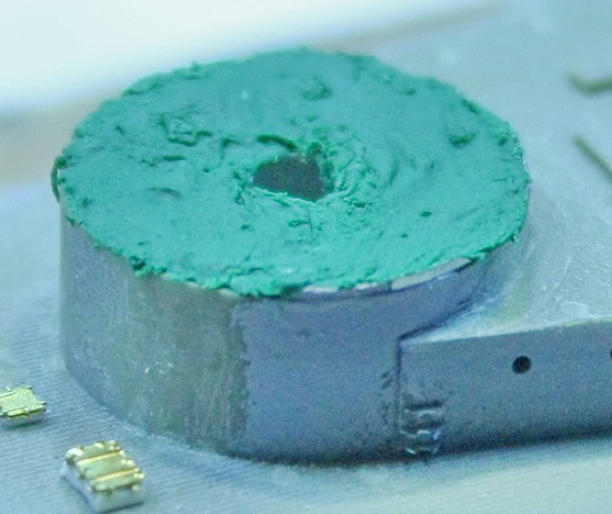

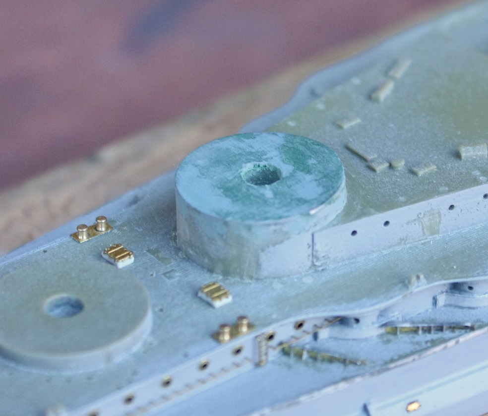

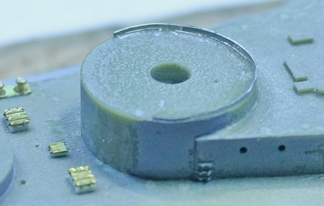

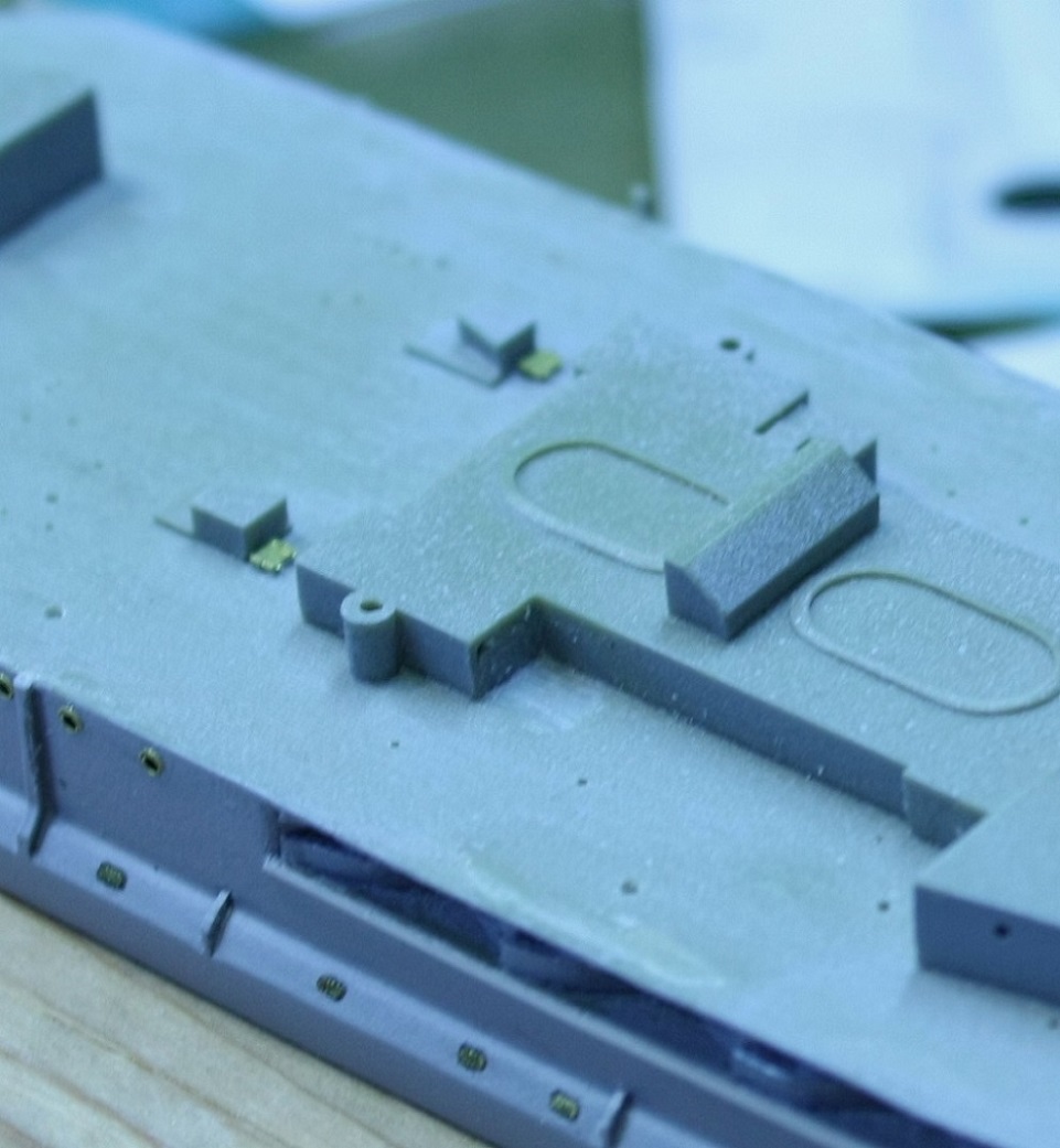

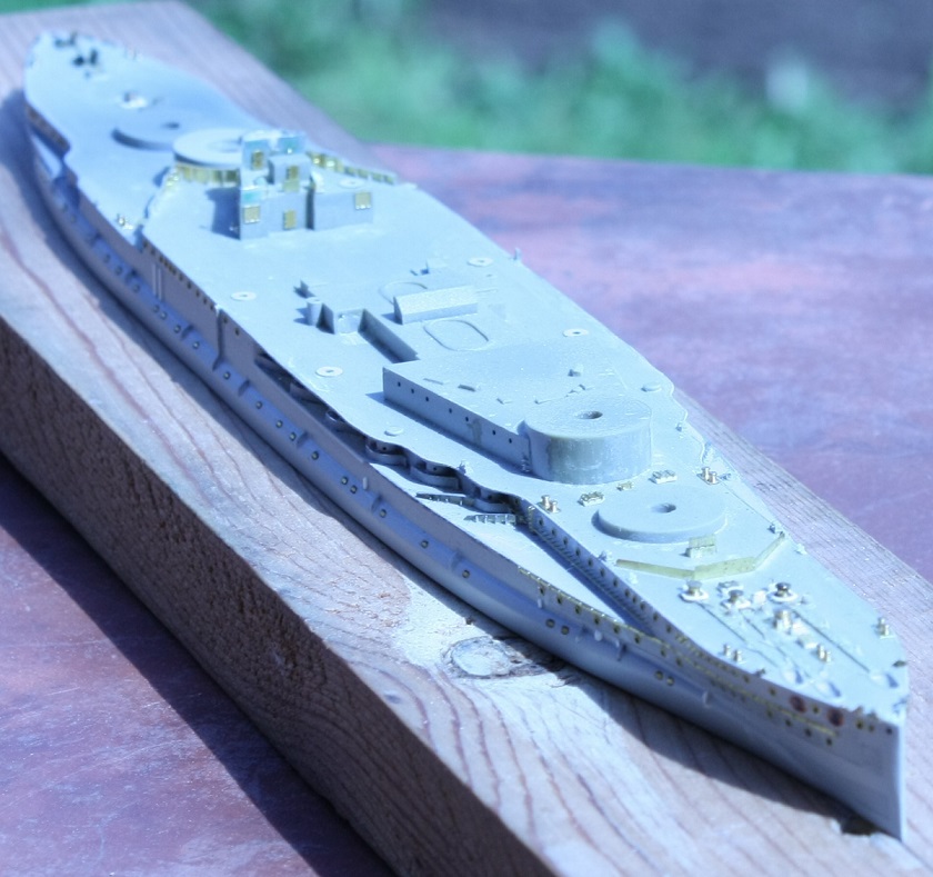

I started to detail the superstructure ’aft-and-fore’ and that means that the bridge will come last. However there was one flaw of the kit which I had to correct upon recognising in order not to damage tiny details to be added later. When I temporarily put turrets A and B on their barbettes just to see how they look it became apparent that the top of barbette B had a slope towards the back – this was the second barbette of the kit with an inherent flaw!
I chose to correct this by glueing a thin strip of aluminium sheet to the circumference, but only to the after half, then applying a generous amount of green putty followed by careful sanding which led me to an acceptable result.

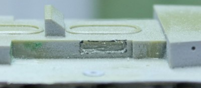

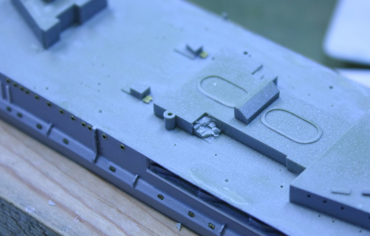

I went on to detail the funnel base. First I had to remove a block from its starboard side by cutting it away piecemeal.

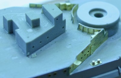

The boiler room vents on the side of the funnel base presented a problem as they did not protrude from the surrounding surface. After some deliberation I decided to glue strips of aluminium sheet to the sides of the base and mate them to pieces of PE containing mesh of appropriate size cut out FlyHawk’s Hood upgrade set (this I bought just to be cannibalised so I could do the barbarian act described above without feeling any remorse). I carved a shallow recess to the locations where the actual mesh would go and coloured it black before adding the PE pieces thus preventing them from being clogged with paint during the subsequent painting process.

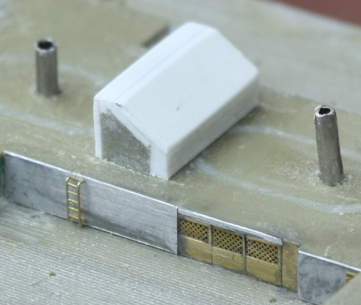

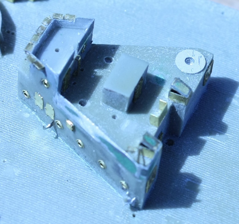

There is a small deckhouse with an oblique roof situated between the two funnel apertures – this was too small and its walls were not perfectly vertical. I cured this by adding layers of styrene sheet to the deckhouse until the desired size and shape was obtained. Later I added some detail to this deckhouse.
