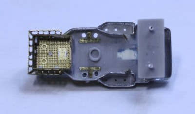

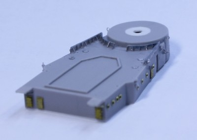

Here is the original kit part:
And the same after modification:

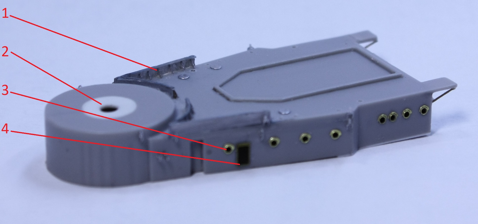

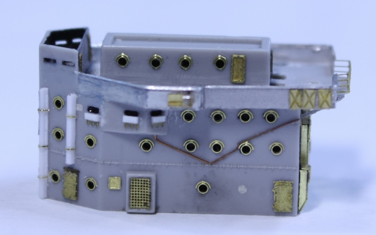

All moulded-on details have been pared off from the circumference of barbette ‘B’
1. A new splinter shield was made out of aluminum sheet, complete with reinforcing gussets and top strake
2. The opening in barbette ‘B’ has been made smaller to accept the 3D printed turret
3. All portholes have been drilled deeper, the inside painted black and finished with PE rigols from Artist Hobby
4. An opened-up watertight door with a PE frame can be seen in this blurry portion of the image

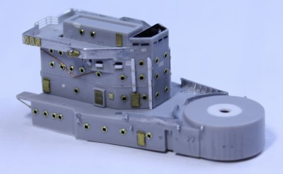

The kit’s part of the lower bridge is quite an impressive one-piece affair with some fine details.
There is always room for improvement, though.
I found a strange flaw which can be easily recognised in the following picture: the vision slits on the upper front part, themselves being too short and high, do not line up: the ones on the starboard side are located lower than the rest.

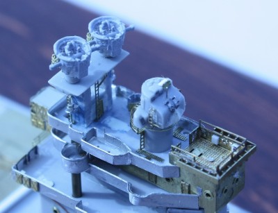

The uppermost tier of the bridge had to be that of the compass platform and upper bridge. This has been altered considerably as well.
1. Sides and deck of the compass platform and walls of the upper bridge came from the Tetra QE set – a great addition. Some bridge equipment has been fabricated to add more detail
2. The two HACS IV-s will be affixed to metal rods as pivots
3. The structure supporting them has been refined in more ways than one: deck thinned down, opening enlarged, small platforms and
4. PE ladders added

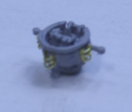

The two HACS IV instruments are 3D printed items from MicroMaster. Although not from their latest Premium Collection they feature prodigious detail and only needed some PE ladders to finish them (sorry for the blurry image):

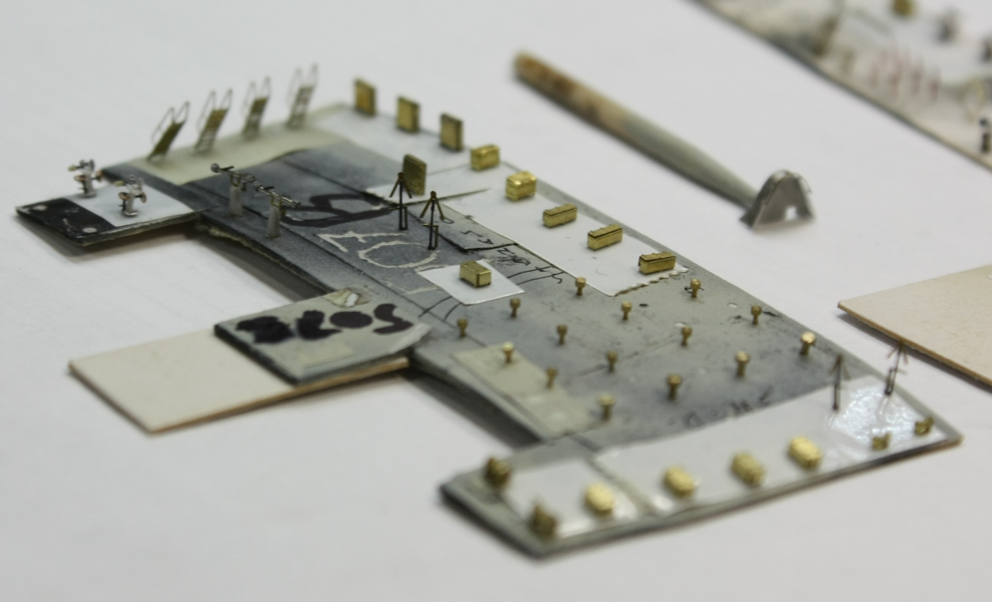

1. Almost entirely scratchbuilt searchlight platform complete with one-bar railing
2. Semaphores made of scrap PE
3. Pre-bent railing for the HACS platform
4. Searchlight sight
5. Air Defence Officer’s sight
6. Air Lookout’s sight
7. HF/DF antenna
8. Pom-pom director
9. Cordage reel
And there are of course numerous other fittings: mushroom vents, ladders, signal flag and other lockers, a pair of 12’ rangefinders, voice pipes, etc.

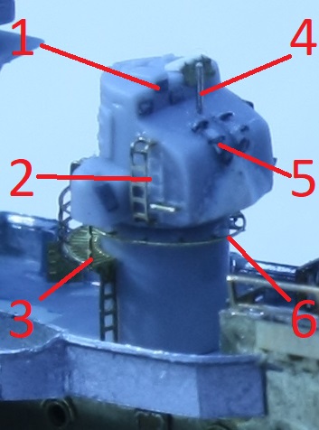

Oops, I have not included a numbered picture of the main DCT.
Here it is:
And the description:
1. Spotting, rate and control officer’s lookout covers
2. PE ladder in lieu of the original, engraved representation which can be seen as an outline in putty
3. A semicircular walkway (PE, FlyHawk)
4. Dial sight (metal rod)
5. Kent clear view screen cover complete with hinges (really small)
6. A circular grab rail, again taken from the very comprehensive FlyHawk upgrade set

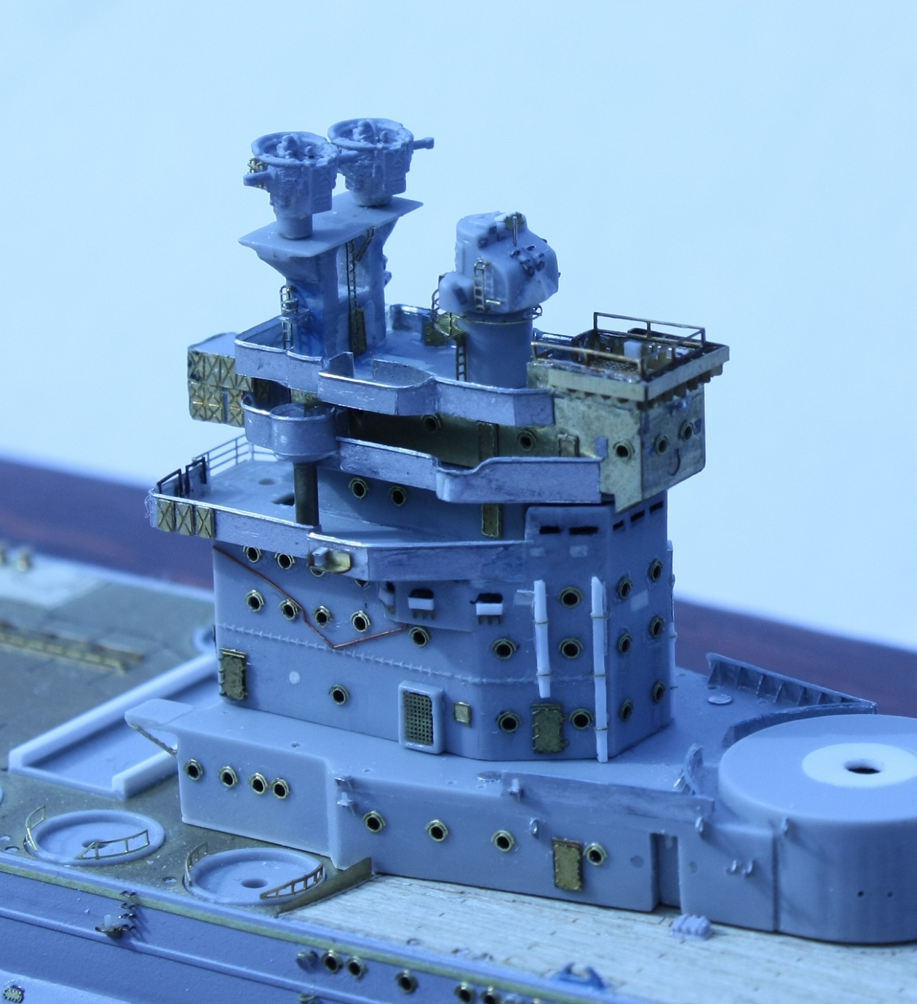

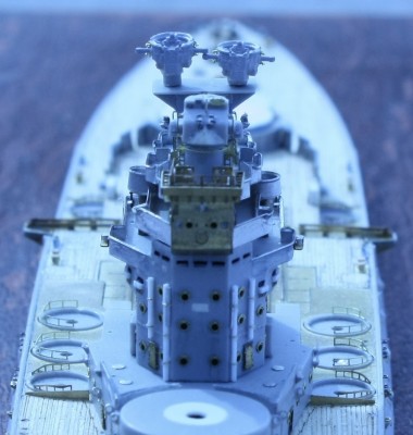

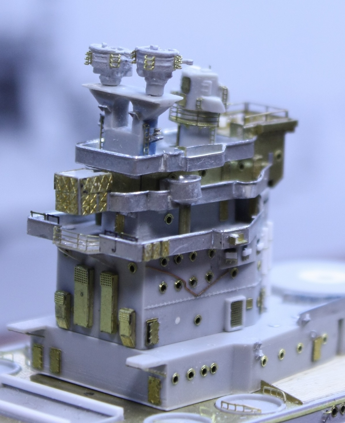

The following pictures show what has become of the bridge.
PostPosted: Sat Jul 03, 2021 7:48 pm
Posts: 622
Location: Budapest, Hungary
Some more pics:
This is by far the most complex structure on this ship. Having finished it is not without some kind of relief.
