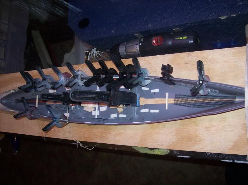

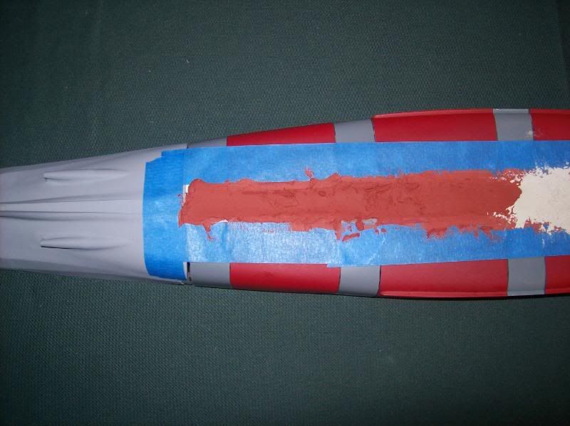

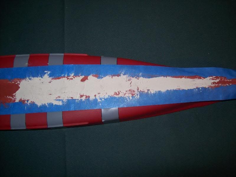

Here's the latest update. I have finished gluing the sections together,which I might add was very fun :doh_1: Then I began puttying the massive hole along the keel.I ran out of putty so my progress was stopped I have to run and get some more today.After I finish the keel I'm going to start cleaning up the sides.
Well thats all folks ,let me know what you think :thinking: and have a great day.

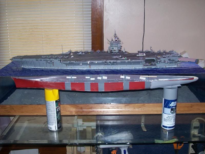

Here is the latest update on the ohio, I have most of the hull complete,but still need to do the finishing touch-ups.
Here is a pic of the hull beside my Enterprise model,just for comparison purposes .

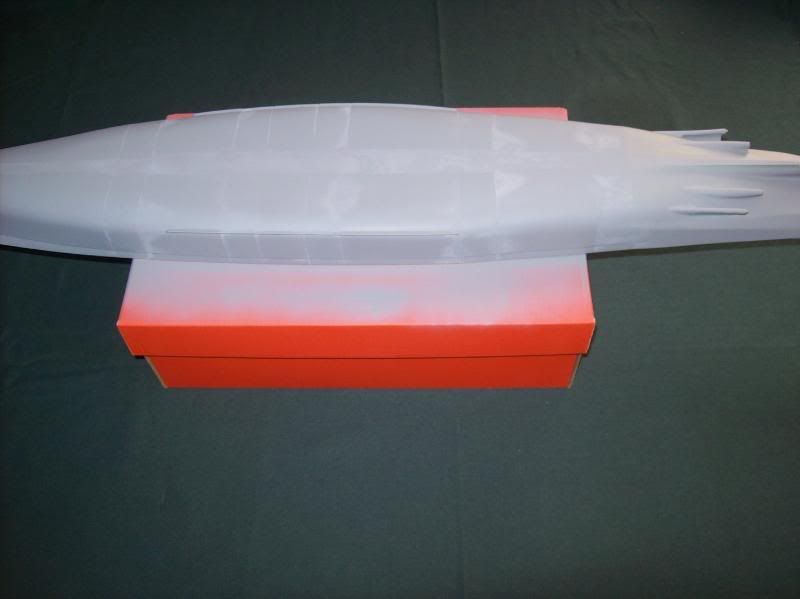

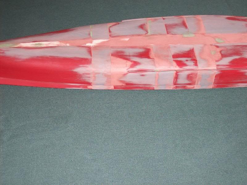

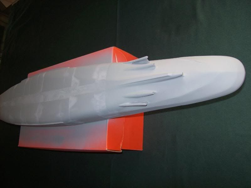

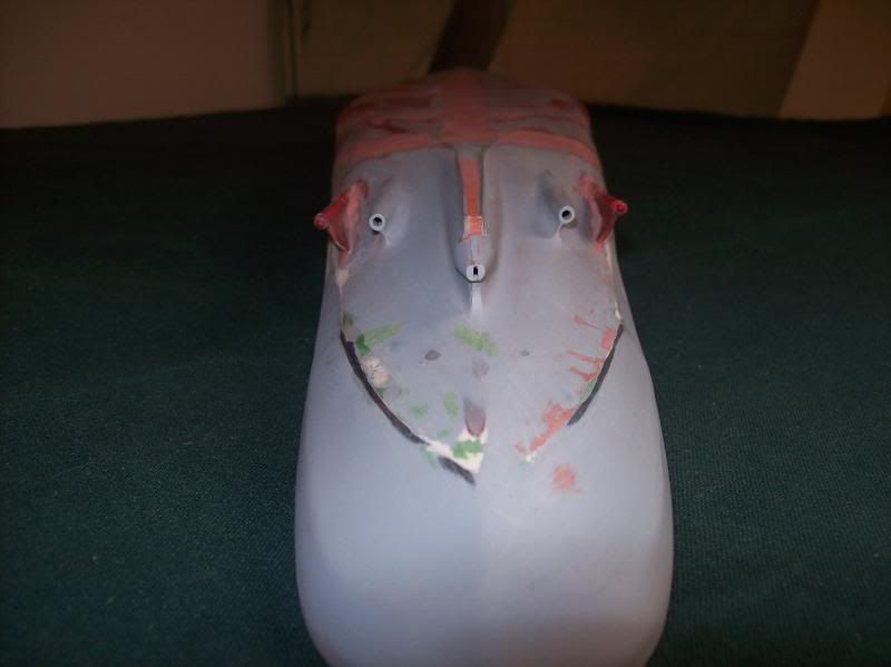

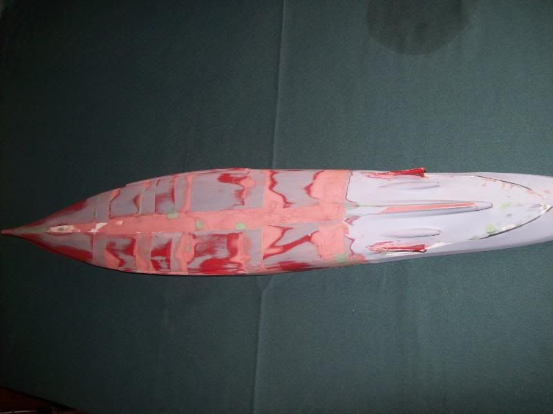

Here is a few pic's of the hull before primer paint
Here is a few pic's after the paint,clearly you can see i have some touch-up work to do

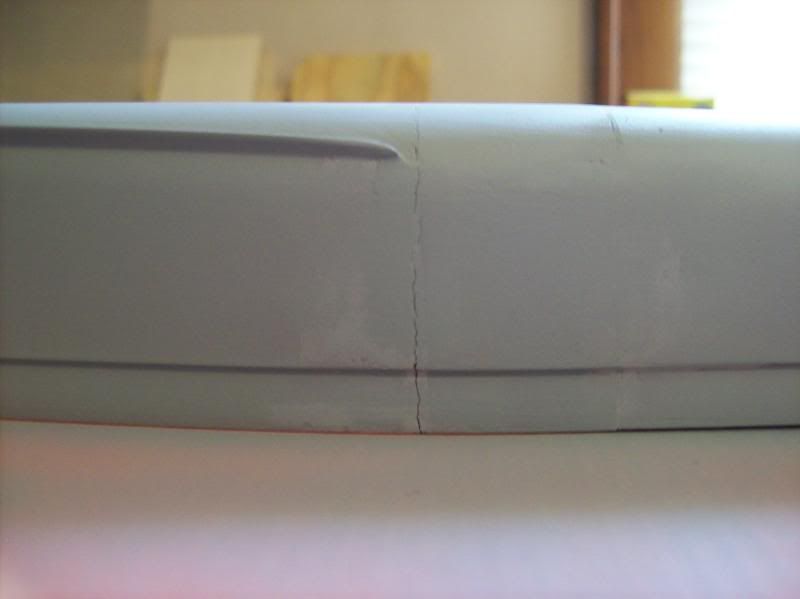

I do have a question I hope someone can answer.In the pic below you'll see a crack on the hull,this happened when I started to paint this section,it's not terribly bad,but what would cause this crack to happen when paint hit it ? Image As always I appreciate all advice and or critisism,So take care and have a good day. :wave_1:

hmmm...the crack...
Default of gluing (2 parts not clean enough )
or, the thickness too thin of the hull here.

I'd use thick CA on both sides of the crack. You also might want to add a sheet of plastic to the insde hull sides and bottom for strength. Hit it wih accelerator and sand it immediately before it gets too hard.

Thanks gents for the help I think i found the problem, although it's a stupid mistake :doh_1: Where I paint my models is kind of in the basement way and fairly cooler than the rest of the house So what i think happened was the cold air was coming in around the door, and since i left the hull there while i shook the can of primer that allowed the plastic enough time to cool down considerably,and when the much warmer paint come it contact with the now cold plastic and putty mixed joint "SNAP". I did go back and strengthen all joints from inside the hull and added more putty ,and of course fixed the leak in the back door,but it's holding as of now.

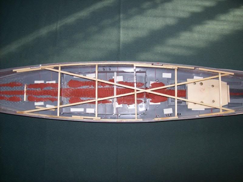

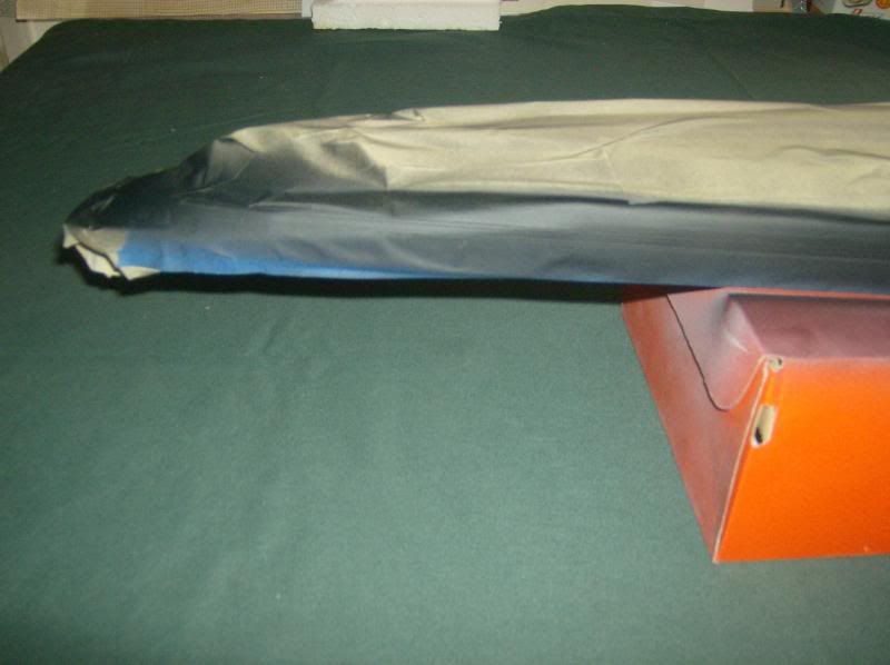

I have a bit more progress on the Ohio. I've kind'of been allover the place but,this is my latest update.

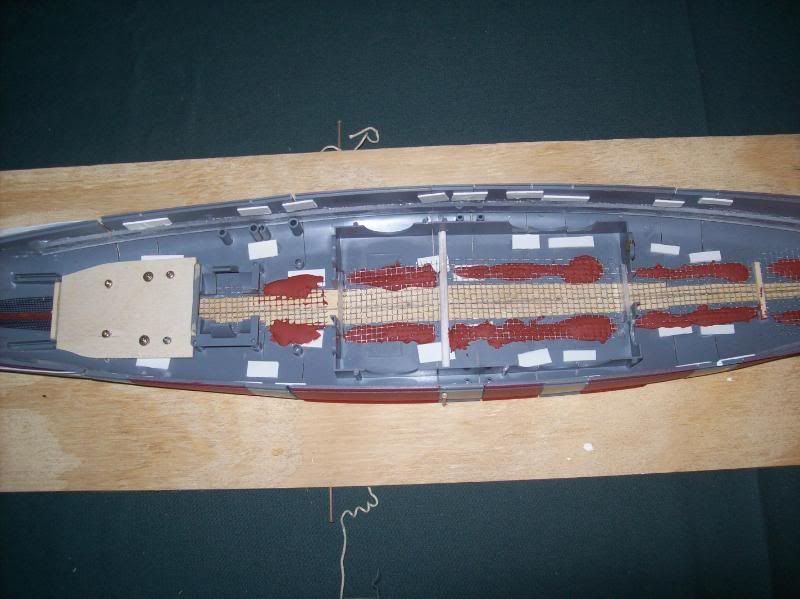

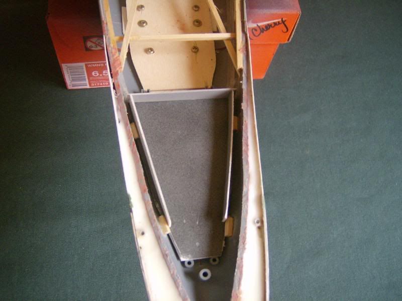

After the crack occurred I strengthened the ship by more internal bracing.

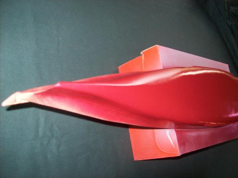

I then got the red on the hull done.

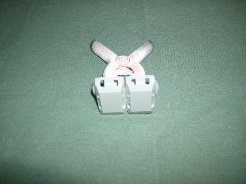

I moved on to some basic turret work.
I also got my tiny hanger bay done. I think it will hold around 6-8 a/c
Then I painted the black waterline on

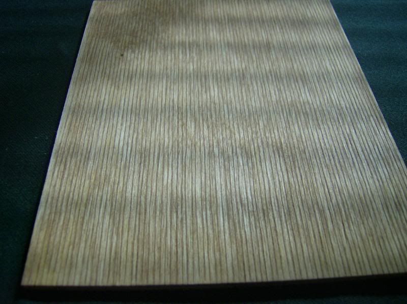

Then I started on the wood deck I got this idea from sauragnmon Thank you much :thanks: . I believe it will look good
Thanks for looking and as always I appreciate all advice ,comments,and criticism. Have a good day
