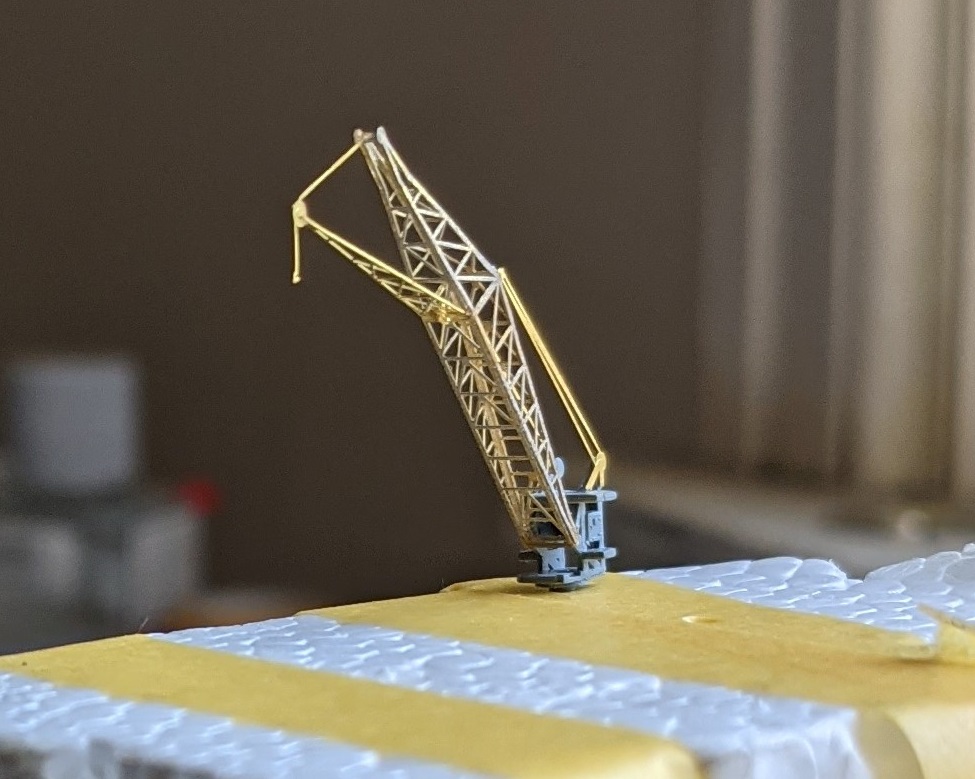

I was able to get one of the cranes together. I expected it to be a bit complicated, and I wasn't disappointed. Folding the crane was harder than expected. Flyhawk has a penchant for incorporating super helpful bend creases in 95% of the places they are needed. Also note to Flyhawk: putting a bend seam through a half millimeter wide beam is not super helpful. But anyway I got it together, but it did end up very slightly warped. Flyhawk instructions call for adding a plastic winch looking thing on the crane arm near the base. The original plastic crane lattice had a spot to place this piece, but the PE piece does not, at least not at the proper position and angle. The photo in Flyhawk's instructions have it slapped half-heartedly on top of the arm. Looking at other builds, it seems like most people just omit that piece, which is what I did.
As far as lining everything else up, here was my method:
1) Glue one main pulley/cable assembly on to the plastic base to give a reference for where to position the main crane 'arm' (or boom? Not sure the official term)
2) Glue on crane at desired angle
3) Glue on second main pulley/cable
4) Use the end hook and pulley to try and set the angle secondary boom. I had to tweak the length and angle of the this piece to get it so the hook was properly vertical.
5) Ruin the pulleys from step 1 in the process of fumbling around on step 4, so rip those off and replace them from the spare PE sheet
6) Glue on the hook and pully assembly.
7) Lock the assembly in a guarded vault where it can never be bumped, disturbed or damaged until the the rest of the ship is finished.
I still have to do crane number 2...

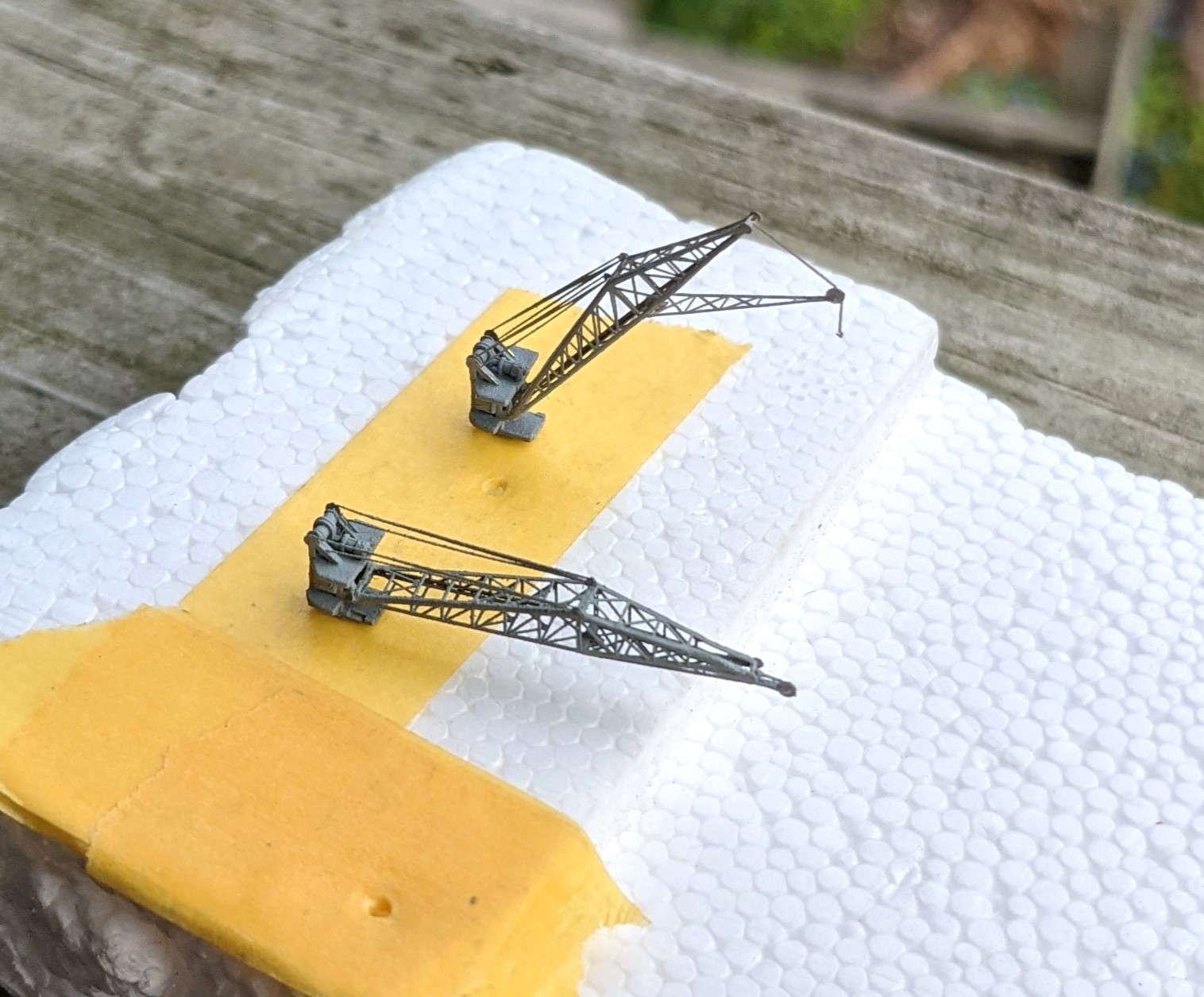

Despite the lack of updates I have been working, slowly... I did want to update everyone on an exciting development regarding the elusive aircraft catapult cradle - the WEM 1/700 KGV photo etch set has it! I will update when I find out if it actually fits!
Also, the cranes.

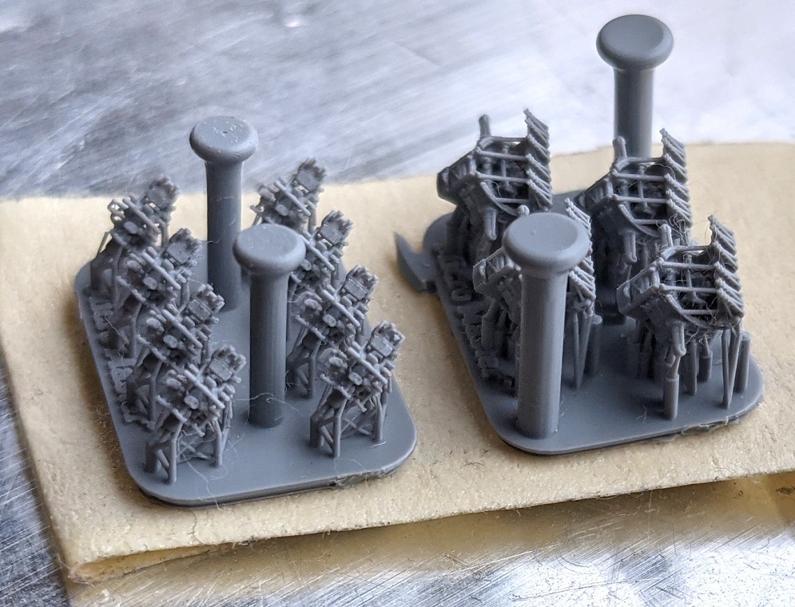

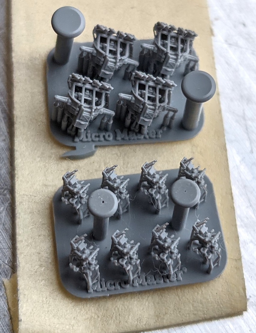

So, regarding the fire control radars I had been dreading: I made a few attempts and... fail. Many PE parts have been a struggle but these are beyond my limit. However, a new option has appeared: Micro Master now offers the 5.25" and pom pom directors in 1/700. I immediately said "yes please". And they are amazing, although "easier to work with" is definitely relative. I can't over emphasize how amazing the detail is on these parts. One minor annoyance, however is the cotton packing, which leaves dozens of fibers to pick out of the parts (as you can see in the pictures).
Another caveat to these parts: The fit vs the Flyhawk kit is not perfect. The pom pom directors do not quite fit in the tubs. I had to cut away what looks like a tiny seat to get them to squeeze in. This part was especially difficult due to 1) There is almost no safe place to hold the part while working it and 2) My tears at having to maul such a gorgeous part made it hard to see what I was doing. Also, the aft 5.25" directors interfere a tiny bit with the railings on the platform. I had to remove them, I will see if I can tweak the position. Otherwise I will probably just omit those rails.
