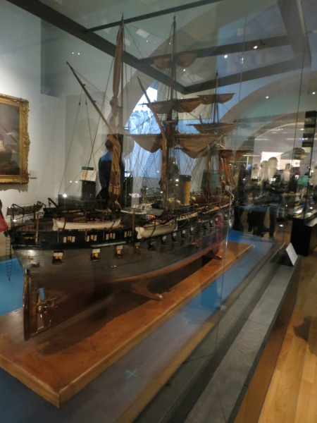

"La Gloire" is on display:
https://www.ouest-france.fr/culture/mus ... 868188f4e2
"In the display case, the silver model gleams. "The Gloire has been restored down to the last detail, the entire deck has been rebuilt, shrouds, sails... It's the collector's item that fascinates me most," admits Vincent Campredon. "The steam propulsion gives it great speed, despite the weight of its wrought-iron armor," says the cartel. La Gloire is the link between the old world and the new world," continues the director, before adding, spoilering a little the display cases at the head of the armada: "The next big step is nuclear propulsion, which brings extraordinary autonomy."
According to the museum administrator, it is planned that the models in reserve will rotate with those on display over the years.
Restoration works are probably still in progress.

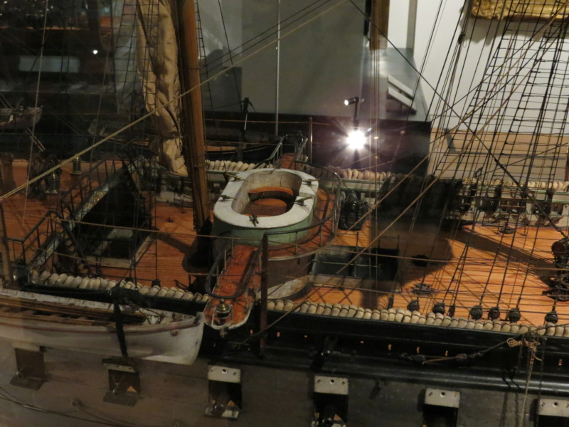

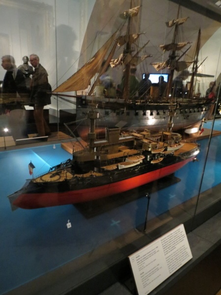

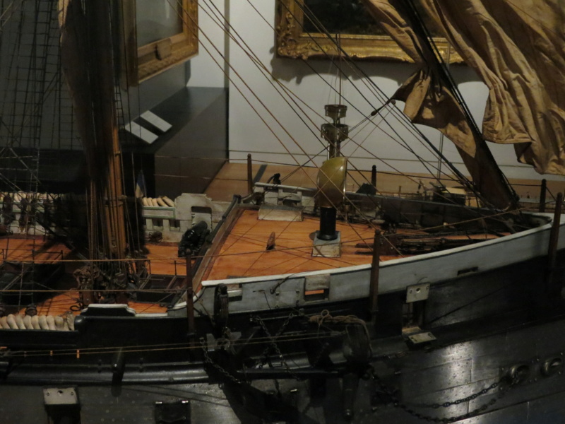

Yes, as I said LA GLOIRE is still there. She is of too high historical significance to sacrfice her to modern 'museography' (that tends to disconsider the value of the object per se in favour of societal or political meaning or worse: message) and put her into storage.
In autumn 2022 I think it was, I attended a workshop in the museum's restauration workshop, where they explained the works on LA GLOIRE. Keeping these iron-clads with their bright real iron armour in good shape is not so trivial, as iron obviously is prone to rust due to humidity in the air and acids from the surrounding wood.
Eberhard

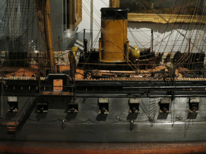

Well, they have a purpose-build depot now near the old Paris airport of Le Bourget. I have not (yet) been inside the storage facility, but it seems to be well organised. In principle, one can arrange to view indvidual items, but they are usually made safe for storage and moving around, i.e. tied down to baseboards, delicate items fastened so that they don't get lost, etc., so that they would be difficult to photograph.
The scale of these models is usually 1:50, so they are huge - not quite a decoration for the average salon - unless you own a chateau.

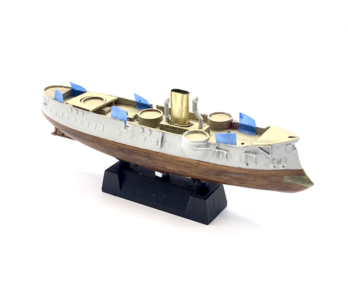

As I cannot go to museum to check this, here is my approach to rebuilding the top deck (whatever the term is).
So the kit is modelled with main deck only. I believe that is wrong, as on many images, paintings and photos there are people walking right on the freeboard top. But it is also clear it is not fully flush. I dont understand why it is like this, but it feels like it was a normal thing for the ironclad of this class, and its sisters (Vauban) that had 2 masts. Several images only exist to show rough outline of what the deck situation is.
This is a model , so sacrifices will be made to god of "Good Enough". I am super open to anyone suggesting me the detail of the steering wheel docking bridge in the back - was it on deck or was it elevated? But it is certainly there, just ahead of the Mizzenmast.
Below is the layout with evidence. Original image posted also, for comparison. Did I get it right?

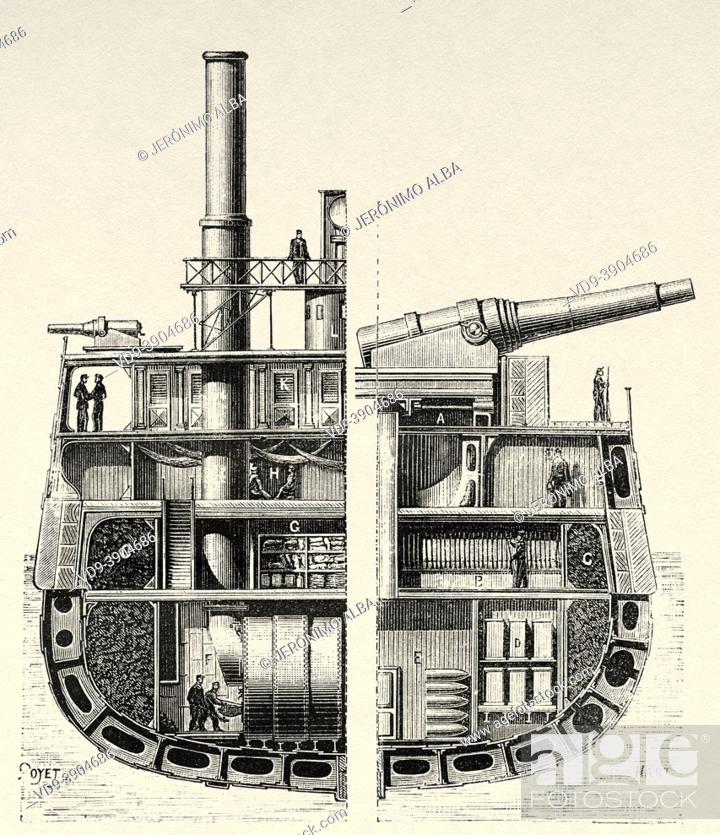

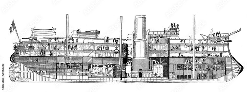

Yes, I dont know how to read those plans. Yes, there is a cover, and it is not planked. Blast shields? The whole deck is covered? where possible? What about those gantries along the hull, they are walkways along and people walk on them in many pictures, they are obviously not walking on the gunwales or - what are you suggesting, I dont think I follow! :wave_1: Build the upper deck or not? Paint it brown or wood?
The painting of the Vauban is clear enough showing some kind of cover. Is it that you suggest all of that stuff was temporary erected deck cover to protect deck from blast effect of the guns? So doesnt need to be on the model?
The covered decks seem actually normal and not shown on plans, may be it was always installed after?

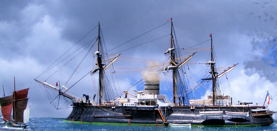

With black hull it looks more interesting, kind of how it makes sense, more impressive almost.
I need to figure out which colors would be for:
1. Funnel (for Mediterranean squadron, ca 1885 - red? Black? Buff?
2. Superstructures (beneath the funnel, pilot house - white? dirty-beige? Buff? Wood natural?
3. Masts - yellow or buff?
4. Turrets - white or buff?
5. Freeboard (on the inside, whatever it is called) - white (except sides of barbette?
Do we know what was practice for French Navy Ironclads ca 1885 in the Med?
If anyone has ideas please share. Have to start closing up the deck soon... and need to decide on paints. Below is just a prep.
