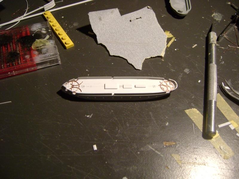

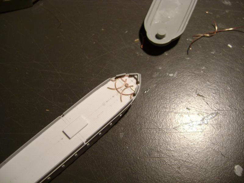

Armed with Jim's valuable advice, I got a pair of plyers, some copper wire and went medieval on this. The result is below, not too shabby, if I say so myself. Next: the aft gun mount and the various deck hatches.

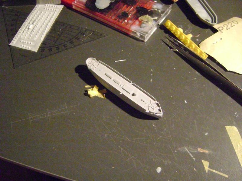

A sunday afternoon's progress. Aft gun rails installed. Starboard side hatches installed. Two out of three skylights installed. Three mast bases installed: a 2x2mm with a 1mm hole drilled in. The holes for the anchorchain have been added. (proper nautical term eludes me at the moment) I'll have to add one more skylight and the armoured conning tower, and then she'll be ready for the silicone rubber. With any luck, put her in tonight and tomorrow cast the first copies.

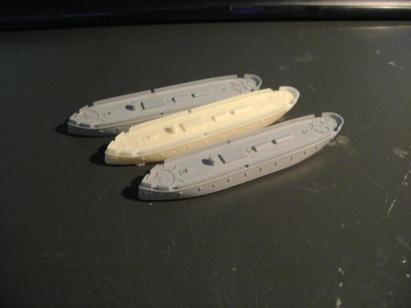

Images of the first catings. It's really tricky to get the details filled out. I don't have a pressure chamber, so I have to remove bubbles with a small plastic toothpick while the resin is slowly but surely setting. Difficult, but that's garage manufacturing for ya.
In the back is the Master, next a clear copy and in front a copy with a layer of primer.

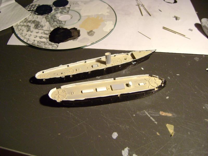

FINALLY! YES! I've gotten my groove back and am at it again. And further ado: here she is, together with the Japanese steam corvette Kongo from Seals Models. The painting is the first layer and will of course be finetuned. Hopefully more progress tomorrow.

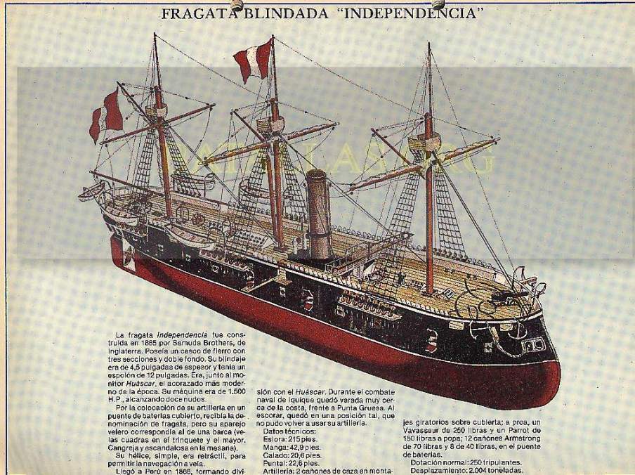

As announced in my PM, here the "profile" I found somewhere in the net.
I don't know if you know this.
Please go on, she's becoming a beauty!!!
Peter

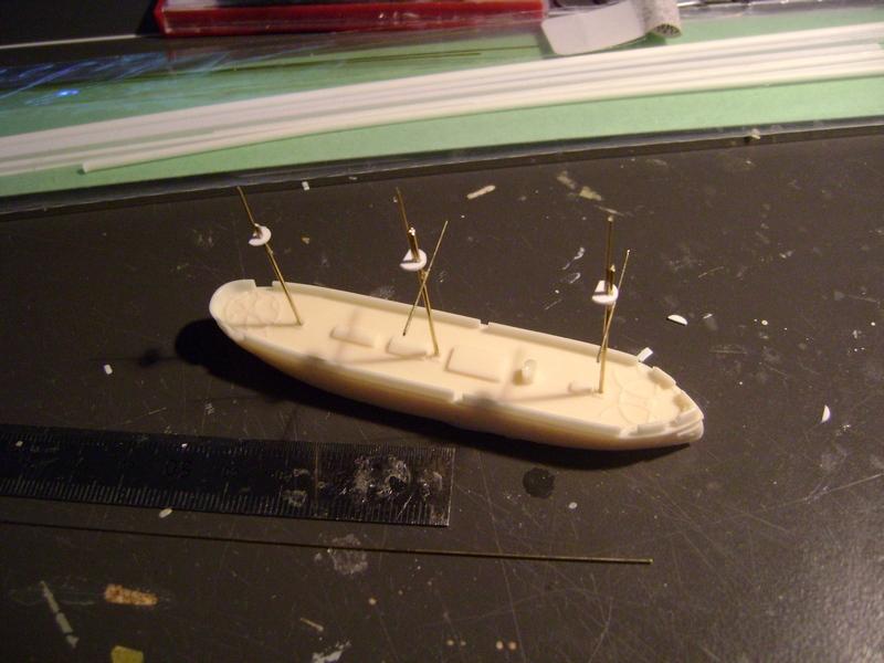

Update, from a rainy Saturday afternoon. Here's a test stand to figure out the dimensions of the rig on one of the miscast hulls. This is really done mainly with the Mark I Eyeball, figuring out how high something has to go, and trying to integrate it with the ratlines (from Atlantic Models). It seems that only the largest size ratline will do, so I'll have to order another set. Or can anyone spare them?

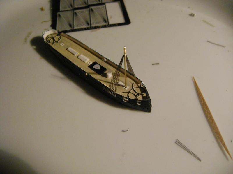

Update! I've installed the foremast and added the ratlines. Was a bit difficult to cut them down, being steel and all, but I persevered. Now I have to wait for the next ratline set to arrive in the mail. In the mean time, I'll concentrate on the little details on the deck. Not much is known, however, and things like the hammock-splinter shielding, I still have to figure it out. Other things, such as the bridge, will be easier.
