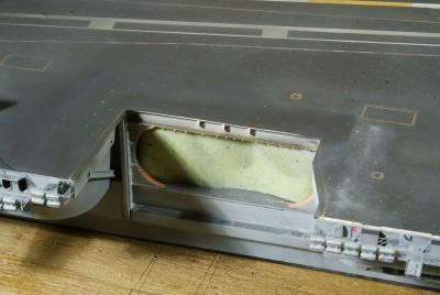

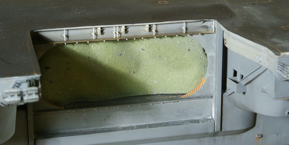

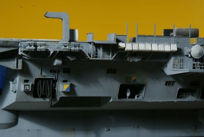

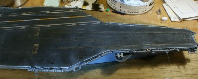

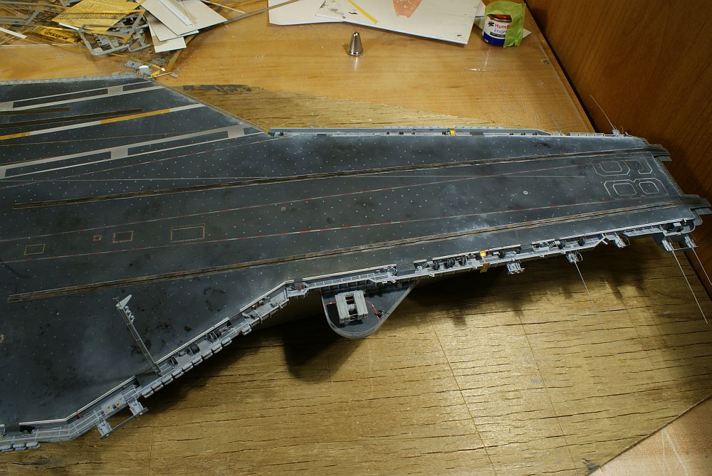

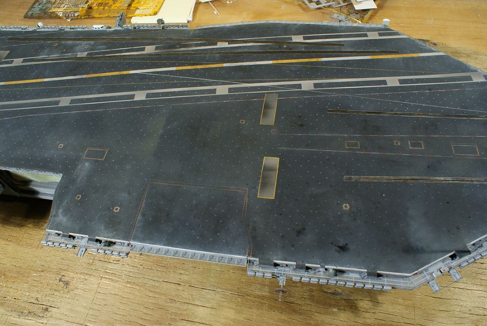

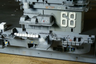

Thanks , tiger! You got me.... I never even smelled glue before. The hardest thing is to wait long enough to post my fake pictures, to make you guys believe I spent that time with actual building.... Well, I managed to photoshop a few more images. But this time hopefully everyone will pick up all the mistakes that show that I am actually building parts. :lol_1:
I worked on the #2 elevator area. It is almost ready, as far as the hull goes. I am still looking for that "special someone" to help me out with the elevator PE I mentioned a few posts ago. :anyone: :please:
I also worked the area just below the island. I love this section, it is very unique to the ship I am doing. The Nimitz only looked like this for a few years. It's a complicated section, and I really enjoyed putting it together. It is almost complete!
Weathered the deck, the starboard half is nearing completion as well! I love it when things come together after such an anticipation. So far I am pretty happy with her looks, bit let's hear it from you guys!
Happy modeling: Laci

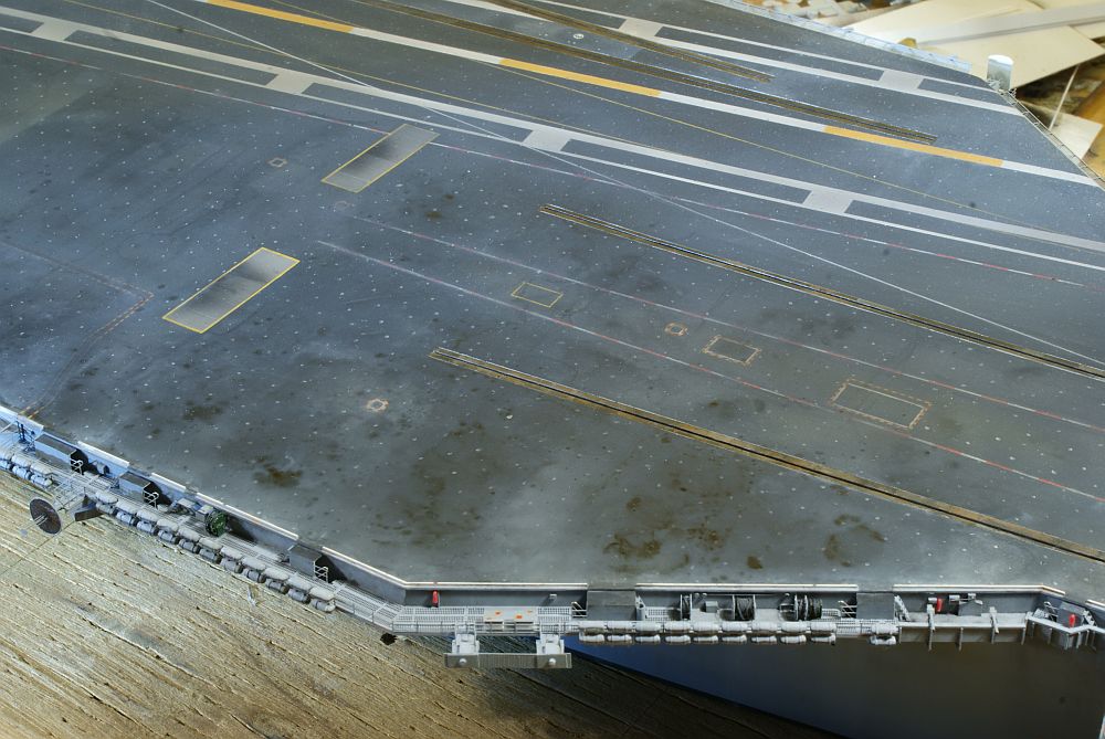

Hey, the deck is getting more alive even with out aircraft!
I may have overdone some of it, but I've seen pretty large oil stains on the usual parking spots, so again: I made up for some of the other modelers missing them :lol_3:
I am off to messing up the port side half of the deck! The MH-53-s are coming along too, but really slowly.....
Cheers: Laci

Hello Laci
just perfect :thumbs_up_1: :thumbs_up_1: :thumbs_up_1: sometimes,on this scale,one can "exaggerate" the effects, it strengthens them ."bravo l'artiste "

That is just beautiful work Laci. The construction with all the attention to detail, painting, and weathering to bring it all together is excellent! :woo_hoo: This has shaped up to be an amazing build man. Can't wait to see the aircraft aboard. Just a great job!

Nicholas: I think I may have over-exaggareted some of the things, but this is where the strategically-placed aircrfat will come in;) Thank you though, if a guy with your eyes doesn't think it's horrible, than it must be O.K. :heh:

Laci, dude, this keeps getting better and better. Your deck and hull weathering is phenomenal :thumbs_up_1:
Seriously, you're gonna make me go back, nit-pick, start rebuilding stuff and get into a fight with my wife over the dining room table being utilized for another three months :big_grin:

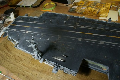

Guys!!!!!
This is a big day!!! It's bigger than big. It is monumental!!!! Everybody, get their most expensive booze, call in sick, and then rip the phone cord out of the wall, and start celebrating: the hull is done. DONE ! D.O.N.E.!! :woo_hoo:
I am done weathering the deck, and the number 2 elevator is only one part away from completion.
Here are my latest pictures, come celebrate with me!!!!!
what should I continue with: island or airwing?
Cheers :Laci

AIRWING AIRWING AIRWING :woo_hoo: lol
Well done on your completion of the deck. It really looks jaw dropping!

She's been through the mill, that one.
As for your question, I suggest you do the island next rather than the airwing. If you do it the other way 'round, then you have to worry about constantly knocking off little planes and losing (or, worse, breaking) them while installing the island. Plus once the island is attached, it makes for easier spotting of the aircraft (you wouldn't want to accidentally glue down one plane too close and have it interfere with the fit of the island, would you?).
But then, I'm not really a carrier builder. ;)

Wow, that must be the most complete 1/350th carrier model I have ever seen!
Bravo on all the detailing, the weathering (flight deck looks great! Not overdone at all in my opinion but just right), and the sheer stamina.
I vote island too, but why not make some prototype planes in between, as a preparation for the "series production"...

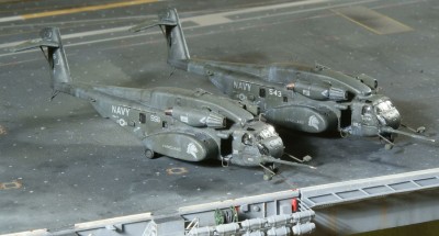

It is great that we are looking out for each other's mental health, but I think it's the perfect "blind leading blind " situation here: we are all effing insane! :lol_3:
Well here is my first bit, I think I made it out sane, but these birds aren't finished yet, and even if they were, it's only 2 out of the 52!!!! :lol_3:
I finished most of the 2 MH-53-s I am planning on staging as a couple of visitors on my carrier (or to use their gigantic size to cover up mistakes on the helicopter landing spots on the angle deck. ( I forgot which one :whistle: )
About these choppers:
They are Bronco, and are very excellent kits. I am seriously considering buying 6 or 8 of these and convert them into CH-53E-s for my Wasp. They are the BEST S-65-s in this scale. The widows are actually pretty clear -the ones on the sides are perfect see-thru! But only the fuselage pieces (halves and the nose piece) are made of clear plastic, the rest is grey. These guys provide PE as well!!!!
About these: some parts are better off being built using copper instead. While we get the main rotor in both plastic and PE , the tail rotor only comes in plastic, and for the scale it's pretty thick. When I am done with the main rotor , I will do a bit of writing about that too.
The decals are awesome for the most part: they are thin, sharp, and colored right! BUT: they are for only one aircraft: number 556....This is the smaller problem. The horsehead is only printed the same way for both sides , so for the port side it would be facing backwards.... I fixed it by installing this decal flipped over-so the white side showing towards us, and later filled it in with grey. For the second chopper I used numbers from separate decal set (I forgot I had)
I opened the side door on both choppers, and the ramp on one of them. I had to fabricate a rear ramp for this, for the one in the kit is for the minesweeping set-up.
:Oops_1: make sure to paint the joining surfaces of the nose piece black before attaching it to the fuselage. I only did this on the second helicopter. Without this the `windows`will look like a white magnifying glass...But painted black it gives them model a more realistic look. You might even notice this difference on the photos.
Surprisingly these choppers sit on their wheels without any weight needed in the nose.
All the other changes/modifications are listed on the photos below. I think today's A.D.D.-infected society will appreciate those more (including me :lol_3: ), rather than reading all this B.S.
I am pretty happy with the way they look, and I gotta say, Blake's (Nwarty) Nimitz airwing highly motivated me in the making of these tiny jewels.
Cheers: Laci

HI Laci
this is smart!!!!!!should be warned when you post pictures like these ones.......I fell off my chair :woo_hoo: :woo_hoo: I thought it was of 72 em
I am completely speechless !!!! c'est magnifique !
