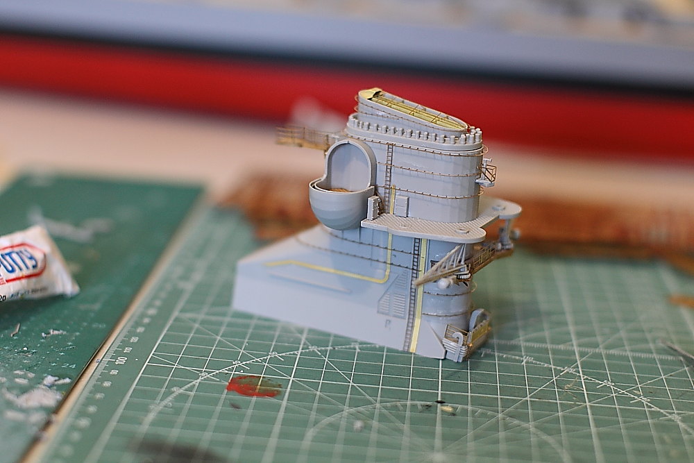

ok so just a small update. The funnel is completed with the KA pieces. The bottom structure with the vents isn't attached to the funnel, hence why it's wonky - before anyone says :-)
Now for the real fun, scratch building all the extra details!

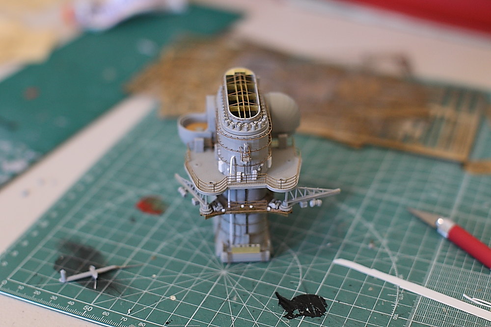

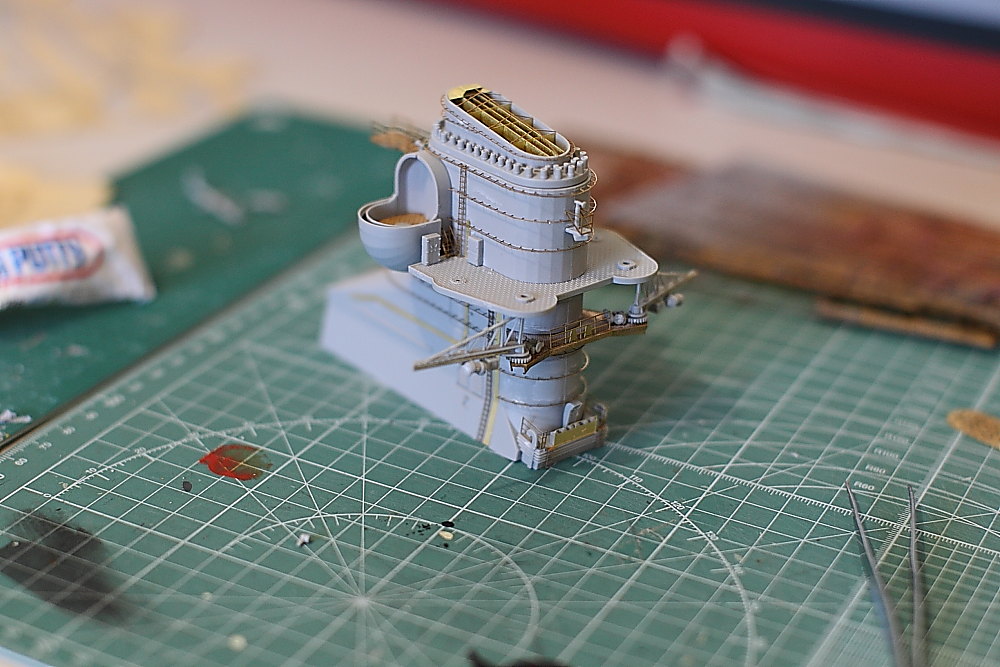

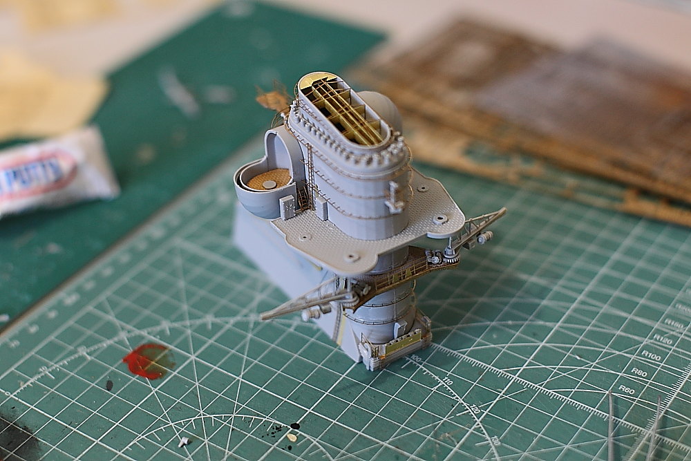

further development of the funnel adding lockers and pipes using brass rod, stretched sprue and styrene.

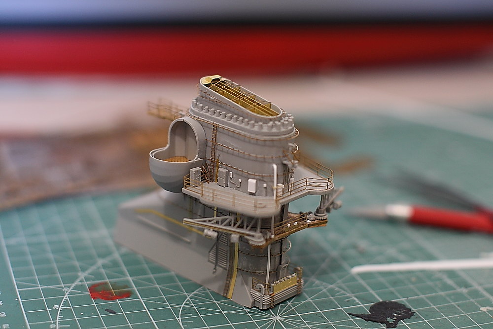

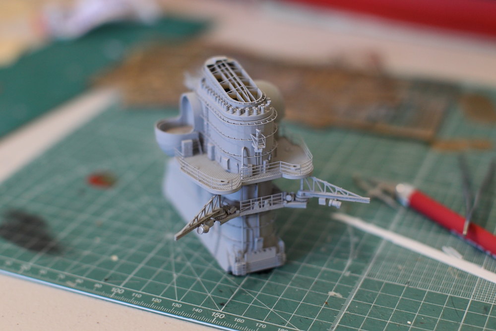

after a first prime, it definitely brings out the detail.

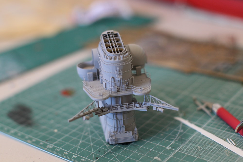

How it looks in place.

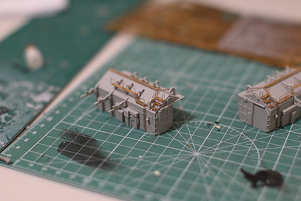

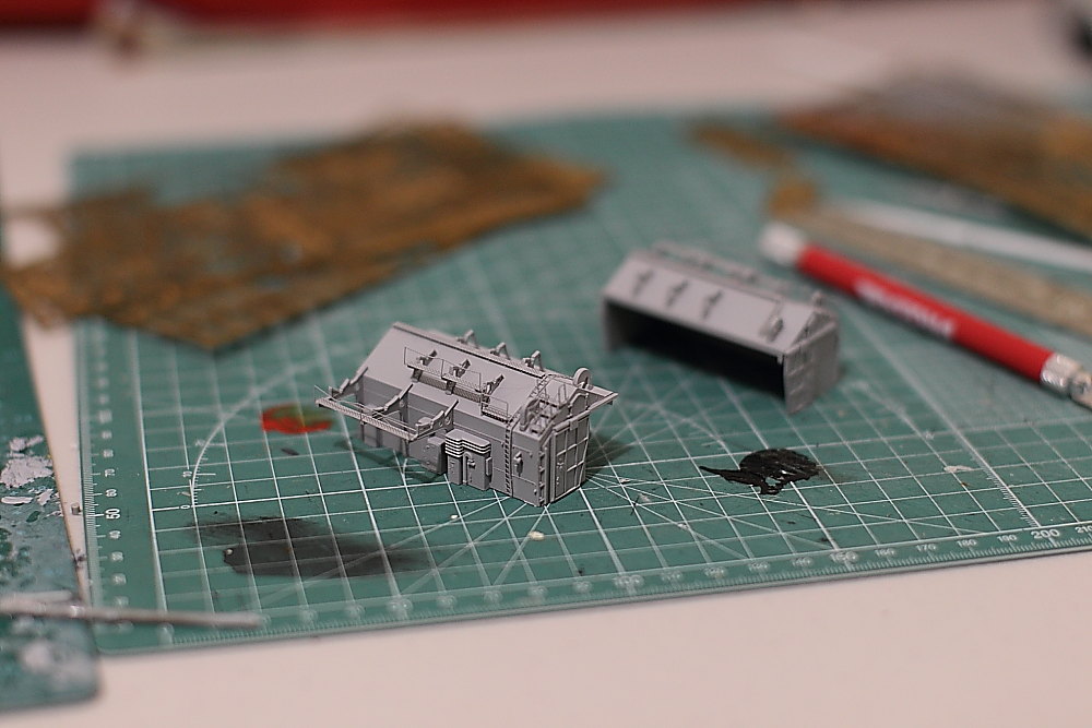

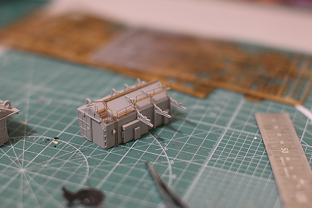

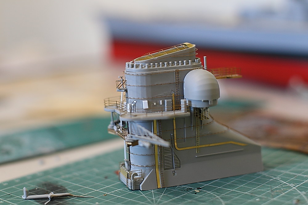

Hangers either side of the funnel now built up.
File comment: all PE is from KA set

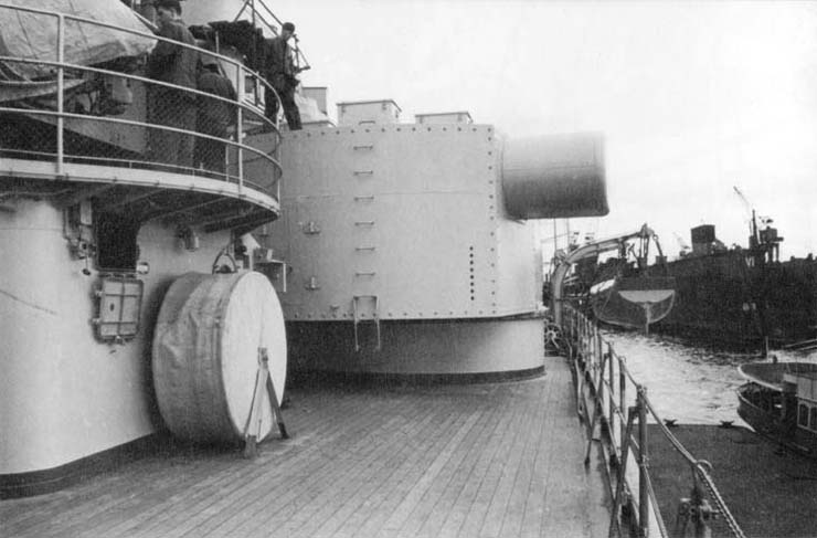

Regards
Nigel
PostPosted: Mon Jan 21, 2013 6:15 pm
Joined: Tue Dec 08, 2009 11:15 am
Posts: 677
Location: Fremantle Western Australia
Hey channell, I thought the same until I saw the pieces themselves and I think they're actually spot on. Need to be careful taking them off the spruce as they're molded on right on the cradles so need to take it easy trimming.
Hey Nigel, the wood planks actually were laid on top of the steel deck so the effect is correct. There is about a 1.5mm gap between the edge of the margin plank and the edge of the hull which is also correct. In the photo you will see what appears to be a lip in the hull which rises above the deck planking, what that is, is where the steel deck and hull are joined. I was going to use plastic strip to represent this on the model, but the railings supplied by KA include a strip on the base which while is there to help attach them to the hull, also will pass for this lip on the deck :-)
The edge of bismarcks hull does have a 45% angled edge which I've already sanded to match, so when I add the railings I'll attach them just above the edge leaving the gap of steel deck visible from the margin planks of the deck.
