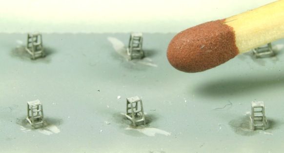

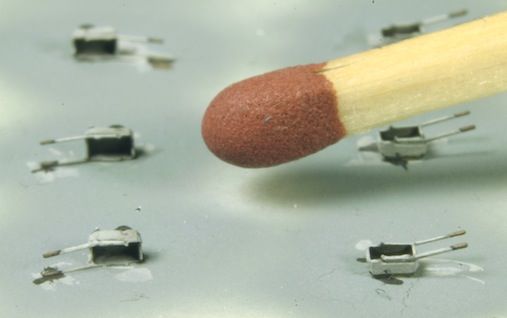

PostPosted: Tue Feb 03, 2015 3:26 am
Posts: 2567

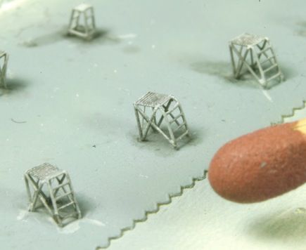

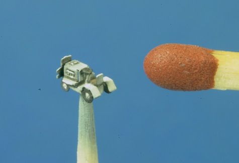

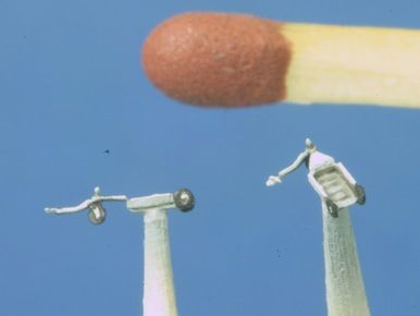

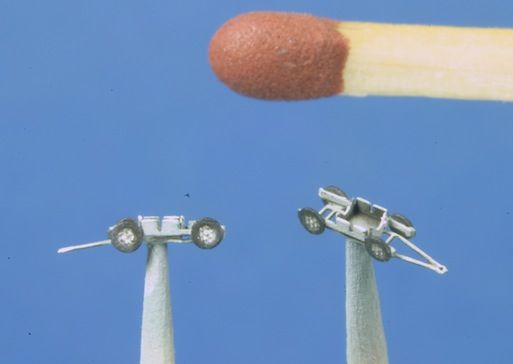

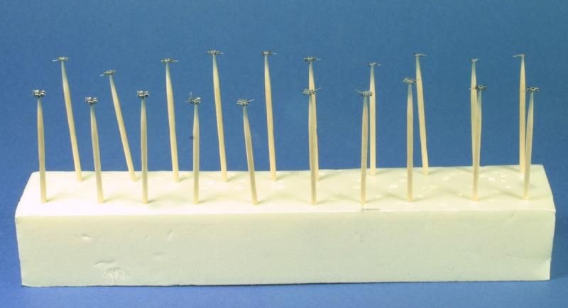

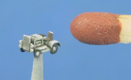

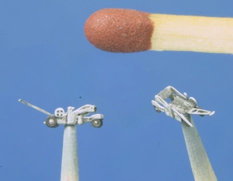

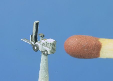

I still had to paint the deck equipment, but that's finished now too.
In case the matchhead doesn't give enough feeling of scale in the very much enlarged photo's: both the tractors and forklift are only about 3,5mm long.
Marijn
PostPosted: Tue Feb 03, 2015 5:10 am
Posts: 356
Your progress never ceases to amaze me! I recently got that deck equipment PE (from Flyhawk right?) They are really small! This motivates me to work on them as I initially thought they where too small :big_grin:
Are you going to put some figures in the equipment? or were they already abandoned by the time your diorama will represent?

PostPosted: Tue Feb 03, 2015 8:12 am
Posts: 2463
Location: Hoboken, NJ
Beautiful work, as always. I'm having issues with small assemblies in a 1/350th scale build, it's hard to fathom how you do these in 1/700.
One historical note, if you're concerned: the Lexington and other carriers in 1942 did not have aircraft mules/tractors. Those are a 1943 and later development. They had bomb and torpedo carts and everything else you have there, but when it was time to move an unpowered aircraft around, it was done with a half-dozen or so crewmen pushing on the wings. It's not a huge thing and most people put them on their builds anyway, but if you're going for total accuracy, you could just leave those off.
This is all correct, of course, until someone finds a photo with a tractor from that time frame. I'm still waiting for that to happen!

PostPosted: Wed Feb 04, 2015 3:33 am
Posts: 2567
Many thanks guys!
They are PE from Flyhawk indeed. This set is excellent: amazing detail, and the items are surprizingly easy to assemble as the PE is very well designed. The tractors are only four pieces (chasis with wheels, nose with shield, rear fenders with drivers seat, and steering wheel), and everything folds very easily. The carts are only 2 pieces each. Highly recommended!
Mostly abandoned, as the crew is gathering on the aft flight deck and abandoning ship. I only plan to have one tractor driving towards the rear, pulling a small cart with crewmen in it.
Many thanks Devin!
Of course, this kind of info always comes AFTER I build and paint something... :)
I suspected this already, but couldn't find any info on it. I just couldn't see any in any '42 carrier photo's.
Usually I go for accuracy, but these are just too much fun to leave of. :) And many people do put them on indeed, and often even paint them yellow too! :) Anyway, I'll be having more bomb carts etc. on the deck than would be totally accurate for that moment in time too, but the artistic aspect of having a crowded and lively flightdeck is important to me too.

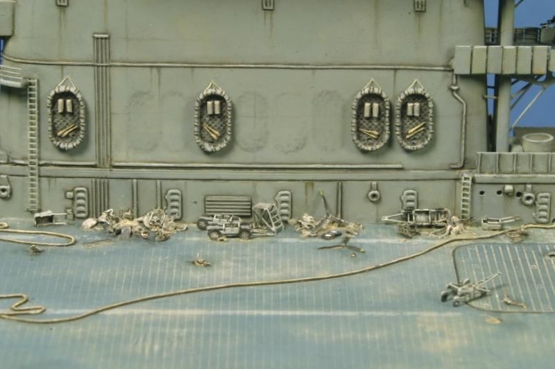

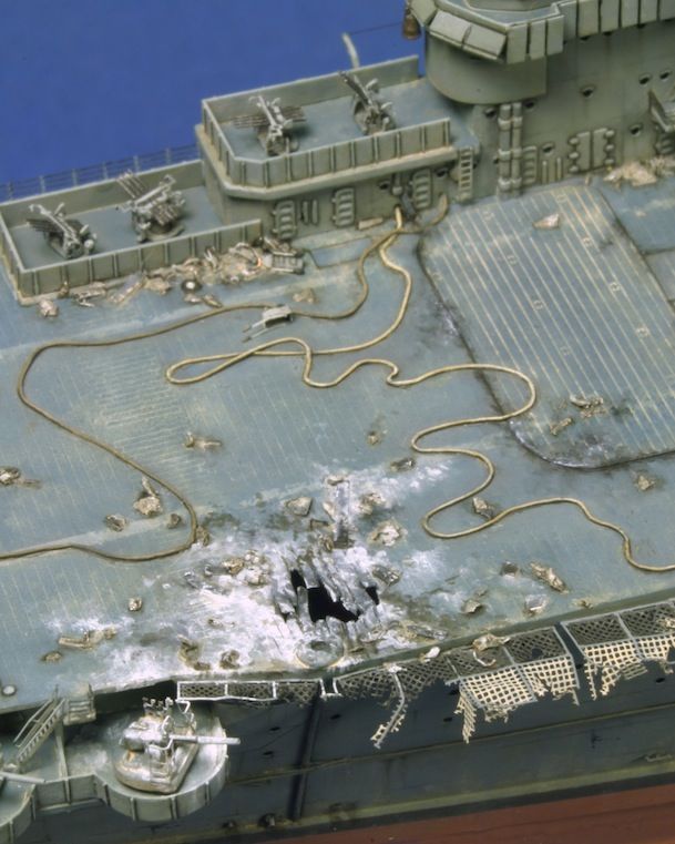

Another update:

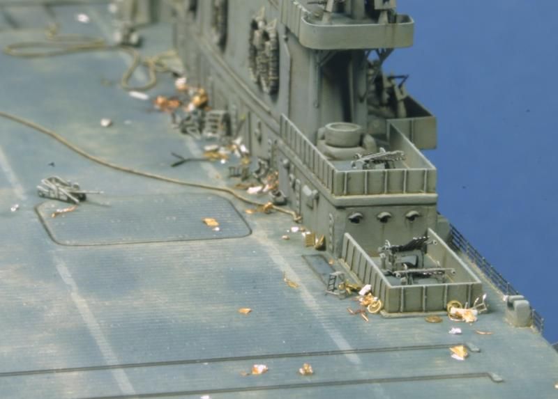

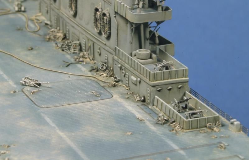

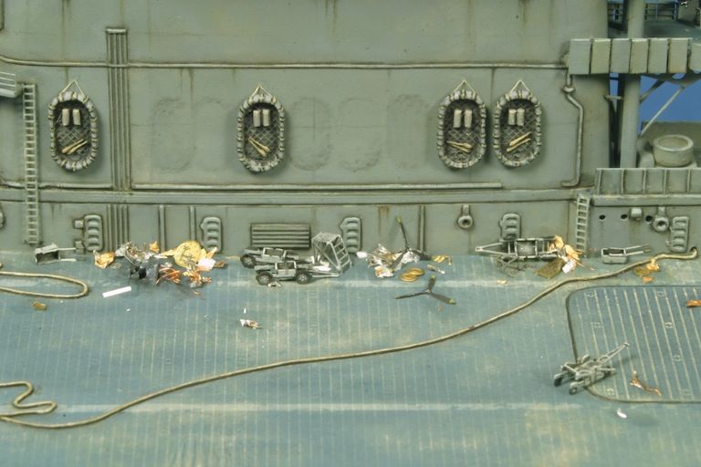

I added rubble to the deck. It consists of assorted pieces of PE, cut up plastic sheet, fine copper wire, and mostly crumbled thin chocolate wrapper foil. I "glued" it with flat varnish and integrated some of the deck equipment.
The inspiration. The only two photo's known of the deck after the 14h45 explosion (as far as I know) show ruble and equipment "swept" against the island, as well as some rubble spread around the flight deck:

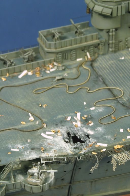

And painted:
The area around the bomb hole was actually already cleared at that moment, but I want to make it absolutely clear that this is bomb damage, also to people who are not familiar with the subject. So here the storytelling needs compel me to combine different moments in time in one image. And I just love cheating! :)
Cheers!
Marijn
PostPosted: Mon Feb 09, 2015 10:51 am
Posts: 2463
Fantastic. I love the negative image of the missing life rafts on the island.

PostPosted: Wed Feb 11, 2015 7:35 am
Posts: 1381
I am really closely looking at the way you are handled the battle damage. It simply amazes me.
Some of my more ambitious projects will involve some effects similar to this. With your permission I would like to save a few of these pictures to my hard drive for personal use only, as the WIP will eventually disappear before I get to those (especially with my build pace).
Gabriel

PostPosted: Fri Feb 13, 2015 3:53 pm
Posts: 674
Hello Marijn:
Your battle damage is very convincing. It's hard for me to get my arms wrapped around that this is 1/700! I too like your shadow effect of the missing life rafts on the stack, all your work is truly outstanding.
Mark

PostPosted: Sun Feb 15, 2015 4:50 pm
Posts: 8327
Yes - bravo! Very nice touch!

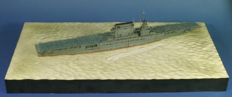

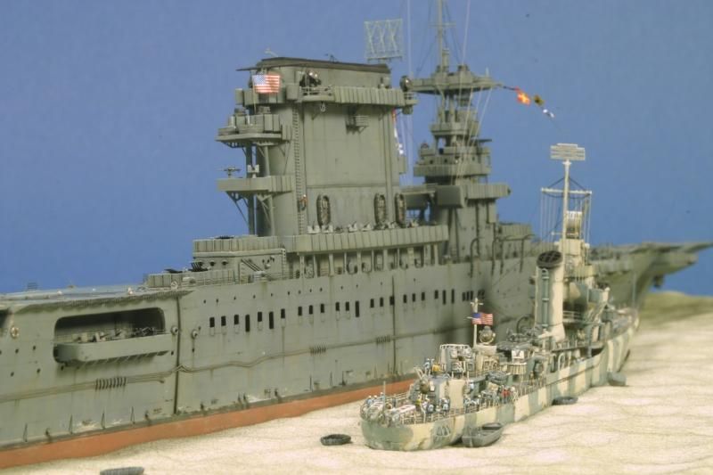

Meanwhile, Lexington is fixed in her seascape. Still have to fill the gaps (and of course paint it).
Of course I couldn't resist taking a shot with Morris by her side:

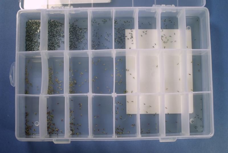

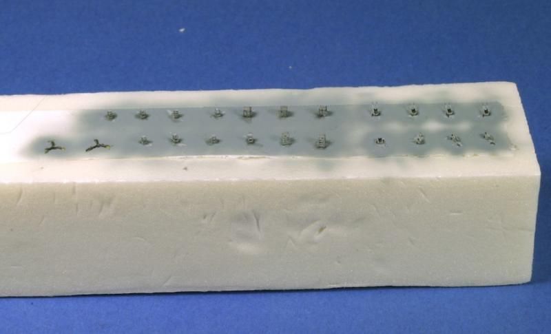

I also sorted all 1400 figures by pose and color, to make it easier to keep an overview on them while gluing them to the ship. Of course I could have made many more subdivisions, but I couldn't find a box with more spaces… :)
