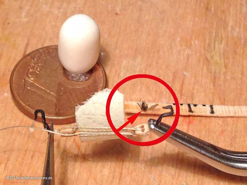

PostPosted: Sun Oct 20, 2013 12:43 am
Posts: 2261
Location: Paris France
Hello Dan
I can finally disclose to the world that you are a usurper!!! Indeed ,this time it,you made ​​a mistake ,you said you made ​​your work yourself,lies !the proof in the red circle
this poor fly is died in forced labor that you their inflicted ,the secret is here ,your cheap workforce, is the fly!!
I told myself,this work ,is impossible to be performed by a human being :whistle:
I stop my silly things :rolf_3: ! for to once more acclaim your amazing work!!! :thumbs_up_1:
congrats Dan , "is shouting truth":woo_hoo:
cheers

Oh yes THIS fly ...
... once one uses cheap workers, it does not work, they give up far too fast ...
I usually use the minions from Despicable Me (les minion; Moi, moche et méchant) which are much tougher and more enduring.
So please, bad workers alert - avoid the flys!
XXXDAn
To Victory and beyond ...
