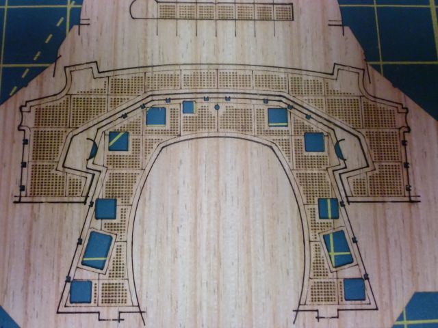

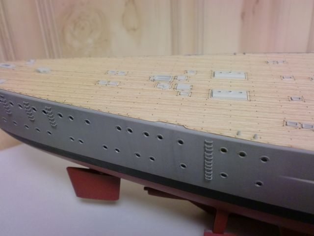

Jason, is there any chance that you could post some close-up pictures of your Mk.1 decking similar to the pictures which can be seen in the Artwox web site (http://artwox.com/index.php?document_srl=7541)??? I'd also be very interested in seeing pictures of 'thinking-man-too's Artwox deck installation. I also noticed that Artwox has gone the photo etch route for the bridge grating. How does Mk.1 approach this area?
PostPosted: Sun Mar 10, 2013 9:13 pm
Posts: 2068
Location: Salt Lake City, USA

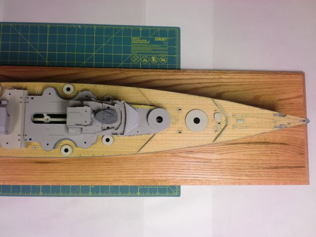

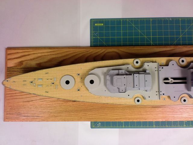

the Mk1 set does them with the same wood as the rest of the deck; here's how they look on my set:
I'm just not dedicated enought to try to copy all of Artwox's pics exactly (besides, I'm not that far on my build anyway) but I've posted quite a few pics and Anton did on his build as well ( viewtopic.php?f=59&t=144178 ) so you should get a good impression of what the Mk1 deck looks like.

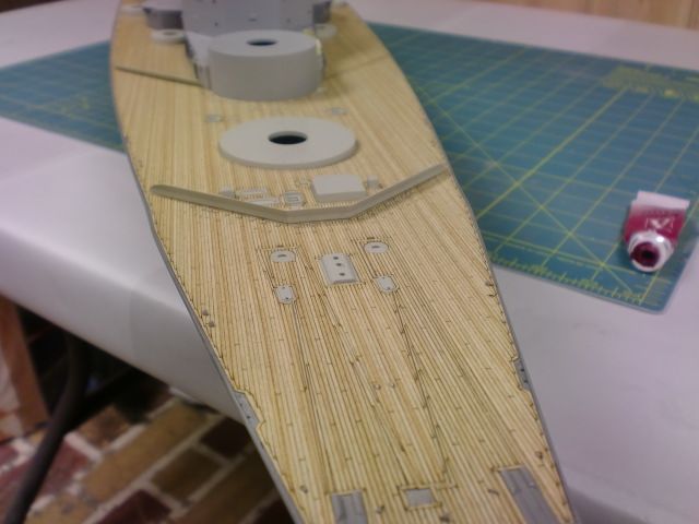

Anyway, I put a good day's work into the Bismarck today; here's where I ended up:
I sealed the maindeck with a clear polyurethane finish (satin finish). It darkened the deck slightly, but I think it looks alright and will keep the deck preserved into the distant future. I also intend to either dull it out with fine steel wool or dullcote it:

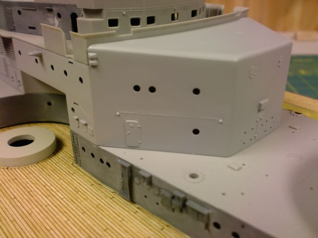

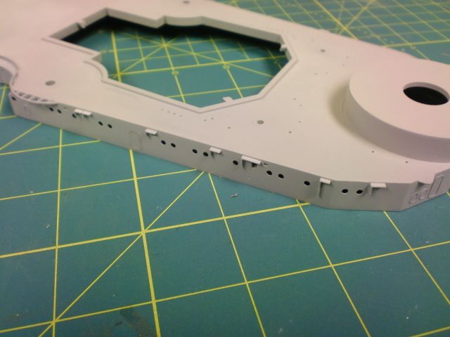

I also did a fair amount of cleanup on the superstructure; I bought an airbrush so I am going to ditch rattle-cans for the superstructure of the ship, though I'm probably going to stick with the same color.
This means I've gotta get things cleaner for a smooth paint job, especially because this color grey really highlights errors. On the aft half of the lower superstructure I ended up completely sanding off the remaining details to finally clean up the mess I made with my porthole replacements:
I will rebuild the L-shaped vent air deflectors with styrene strip (probably a good move anyway as they were molded on crooked on the angled aft section). I will also need to replace a couple of doors and pipes but it won't be anything too difficult.
The forward section came out a bit cleaner so I might not have to do much beyond adding the additional PE I already have:

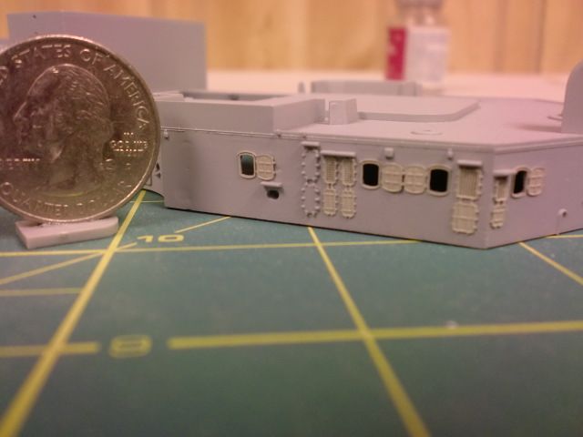

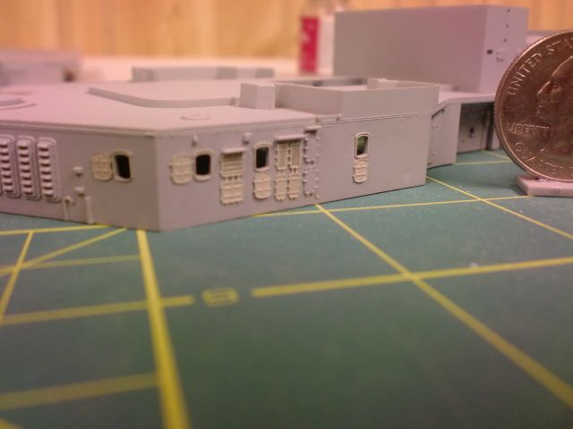

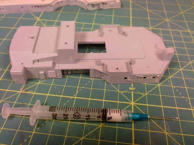

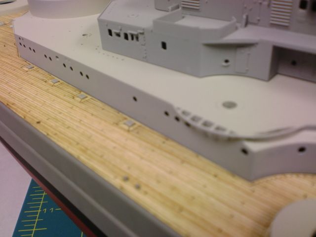

Even though I am "taking a break" on the build work still manages to creep along. That's what happens you are a model junkie... and for once it's OK to share needles. :big_grin:
No that's not the "good stuff" in the syringe, it's white glue... the best way I've found to get tiny bits of glue where it's needed. Free syringes are perhaps the only benefit of my son's medical problems.
Anyway, here's an example of the Mk1 set's PE on the Admiral's staff quarters. I pre-painted the vents (which actually go all the way through on the PE!) and cut out the area behind for that extra bit of realism. Now that I'm armed with a shiny new airbrush it should be easy enough to paint around them without clogging them up.
I'm gonna try to get moving again here; I took some of the forum's advice and went looking for a mistress as a small side project :eyebrows: . My wife wasn't pleased until she arrived in the mail and was found to be 1/24 scale and well, not real:
Her name is "Sasha" and she can weld, which should come in handy on the Bismarck. :rolf_3:

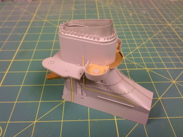

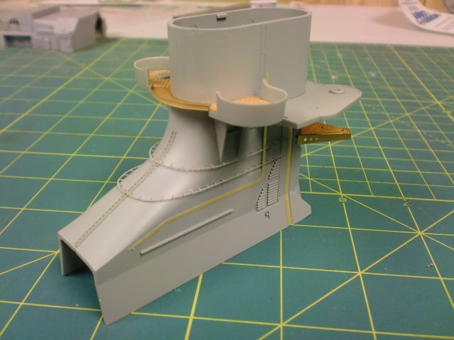

I replaced the the vent wind deflectors that I cut off earlier, now they are all the appropriate 90 degree angle to the superstructure:
And I started work on the funnel:
Just that represents about 6 hours of work. Still plenty of work to go here... this is probably the most complex piece of superstructure on the kit once you throw all the extra PE in. :wave_1:
(edit) Just a quick FYI for those who haven't arrived at this point yet...
I replaced the vents on the side of the funnel with the PE from the KA set first off but the slats will bend if you look at them wrong and look like they won't take much bending before they break off. One would be counted wise to resist the urge to add them and/or or bend the slats up until they are closer to finishing the funnel... it is a serious struggle to get the rails on and you will want the extra manuverability (and not-ruined vents). It also appears the KA instructions tell you to put the vertical ladders in the wrong place though Trumpeter got it right in the instructions (I double-checked with the Kagero book); something to keep a lookout for. :thumbs_up_1:
-Jason Channell
