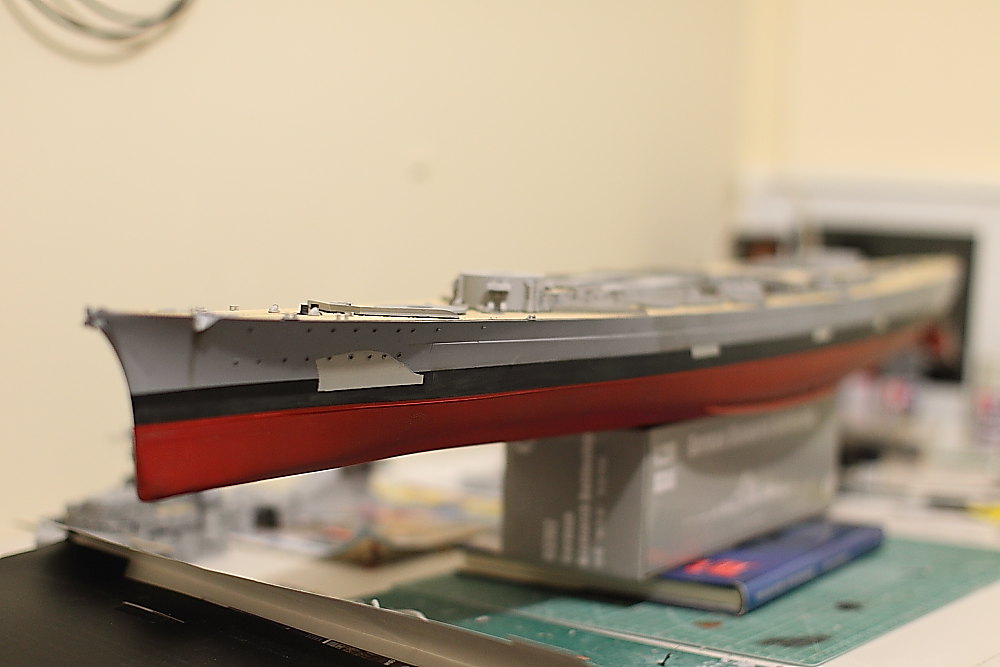

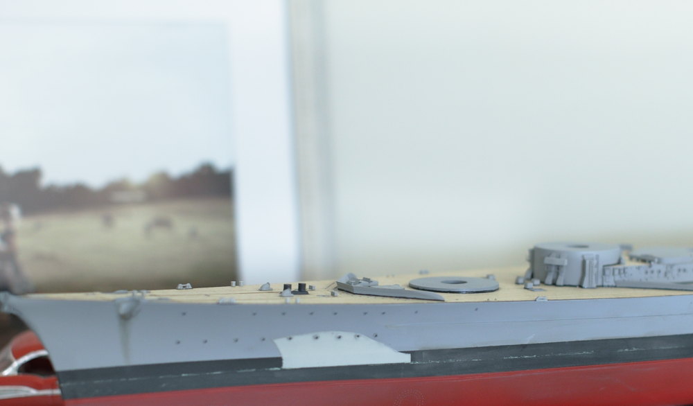

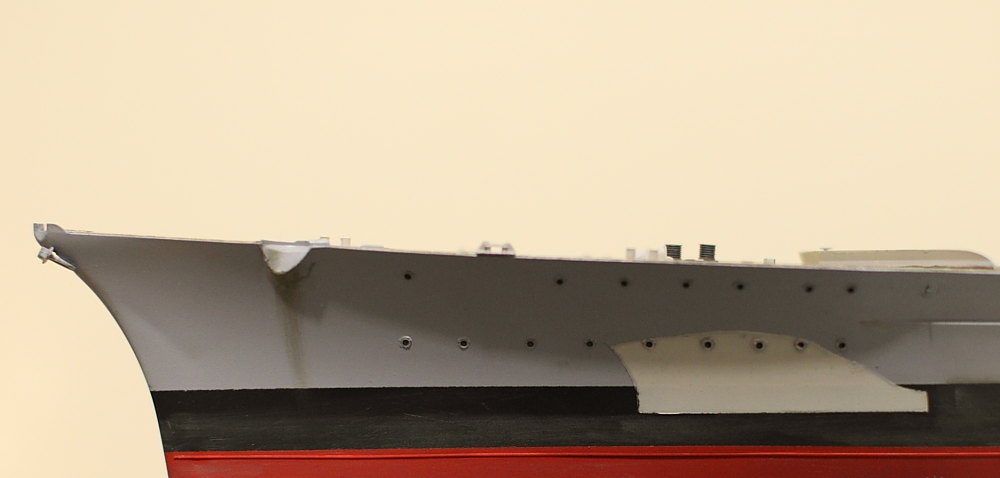

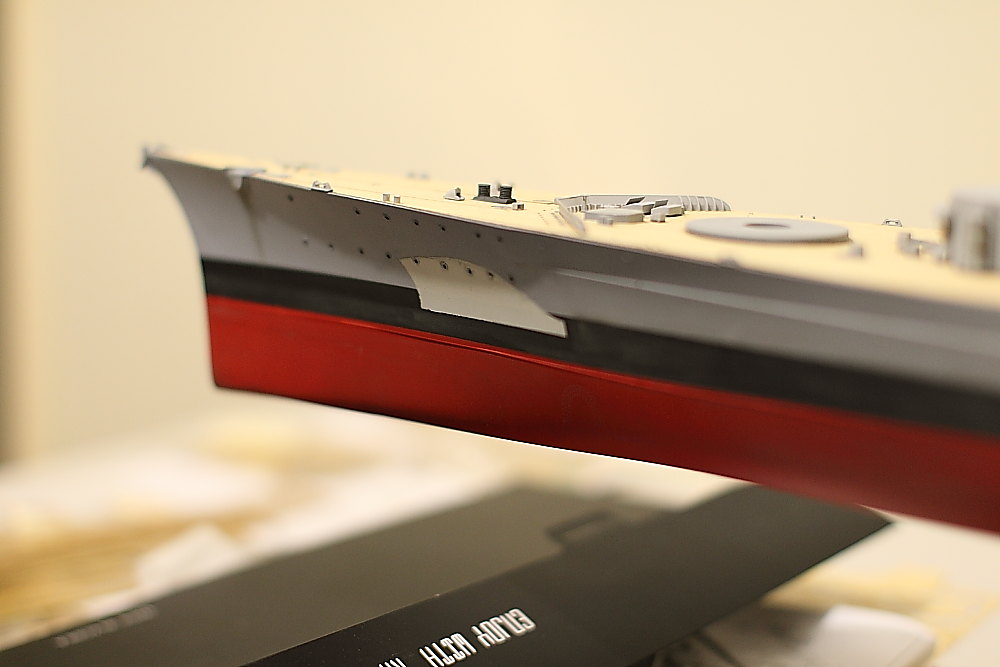

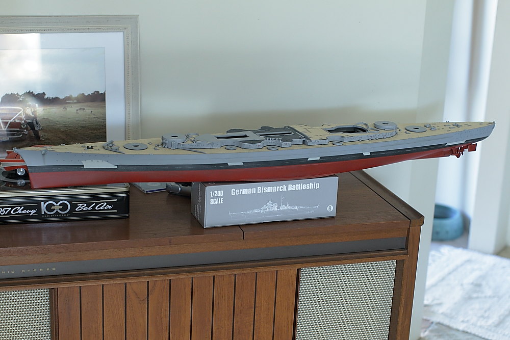

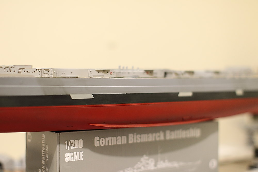

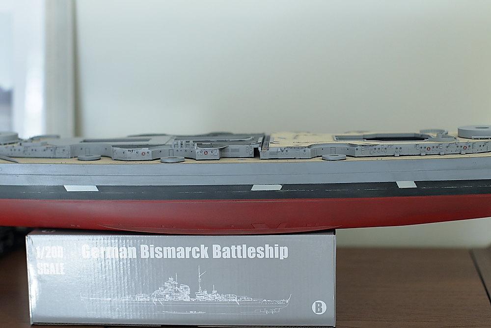

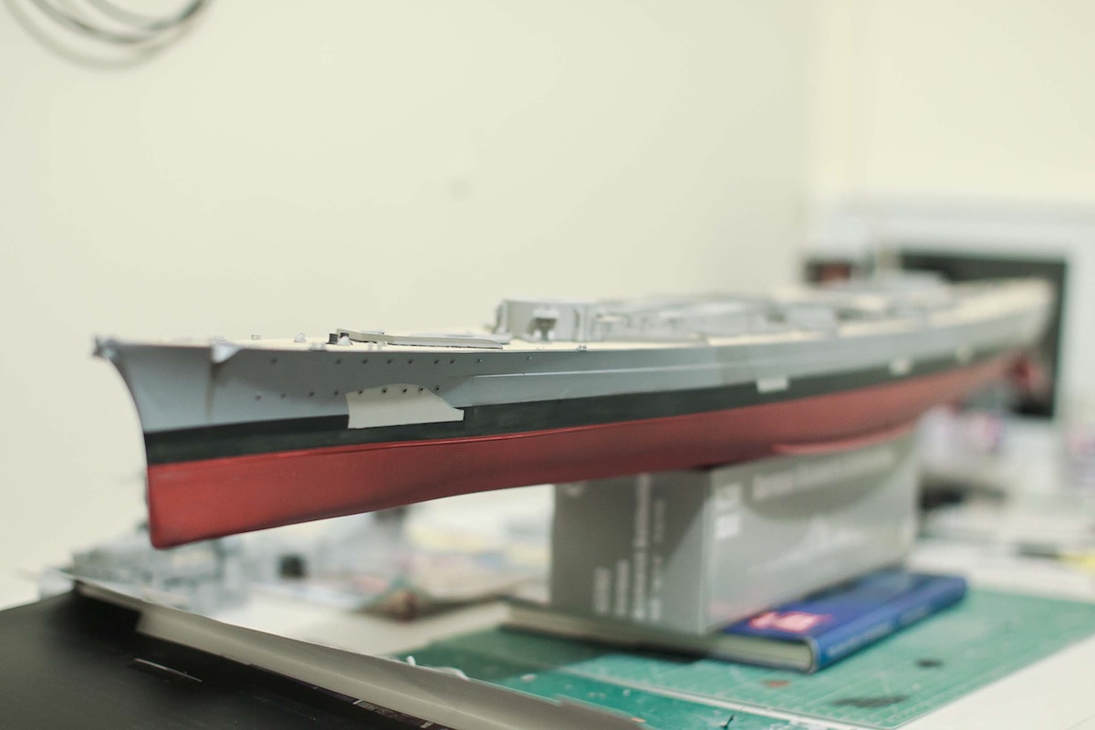

yeah the false bow waves.
Ok so i'm putting the superstructure to one side for now and finishing up the painting and weathering for the hull, and then the deck details. There's still a lot to do with her.
I've added the MES along the hull and given the antifouling it's final coat which is just a shade darker. The false bow wave on the port bow has been added with the white remains from the stripes on the boot topping. The dark grey on the bow and stern, which like the stripes on the hull were painted over has yet to be added. I've giving the antifouling it's first stage of weathering. I'll be focusing most of weathering on the hull, above and particularly below the waterline. The above decks will get some shading and oil stains mostly as a sailors most important duty was to clean after all! hahaha
See what you guys think.

Looks great Anton. Would you like to show us all the route of the MES?
May I ask, why is your boot topping so wide??

the boot topping was well... depends on what various information you want to take into account. There are various thoughts on this. from 2m following 1940 regulations, 2.5m which is what the Tirpitz had and- 2.7m in width. The 2.7m width works with photographic evidence from the wreck so this is what i went for. The upper edge of the boot topping is at 10.5m from the keel and the CWL is at 9.5m so you have the option to make you're own minds up :)
Olaf is the expert in this so can fill you in with more details.

The MES runs the full length of the hull, parallel to the keel at 38mm above from the keel on the model. This is 7.6m on the real ship, hence why its just below my boot topping as my boot topping starts at 7.8m as I went for the 2.7m Boot topping theory.

The CWL is at 9.3 m.

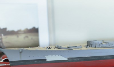

Just noticed the photo's haven't reproduced the colour on my model as it really is, damn fluro lights! so here's another pic which is how the hull looks at the moment.

sorry but this is something i don't agree with as 9.5m is on the hull lines plan. Yes k-bismarck etc have 9.3 and also 9.33 is in AOTS. This has been discussed and argued.
From an earlier forum topic
"There is photographic evidence that the upper edge of the b/t is at the upper edge of the 10.4m mark of the bow draught marking. Since the lower edge of that number marks 10.4m above keel level (minus shellplating) and since the numbers are 10cm in height, the upper edge of the b/t is at 10.5m (well, maybe 10.522m if you count in the shell plating). This is consistent with the CWL which is (according to my source) at 9.5m above keel level (remember: the b/t should be 1m above CWL, and value X below it"
This I agree with but as mentioned you guys can make up your own minds.

Just eyeballing it compared to Bismarck photos I'd say Perth's boot line is correct. She just had a huge thick black boot top in real life!
I'm gonna do a thinner line on my Bismarck just for appearances though... I think we *might* be carrying things to extremes when we start counting measurements that translate into tenths of a millimeter!
I like accuracy and crazy detail too, but I'd venture to guess that very few of our Trumpy Bismarcks will ever show up in a museum. Is it just me or is the rivet-counting getting to be a bit too much?

Yes Nigel.
I fell on the first image too, and the second one doesn't count in as there is still the Baltic camo visible. In my believe it is down to a trick of hull curvature, angle of view and distance.
Happy painting ~ Olaf!

I realised later that you can just see the stripes on the hull in the second picture. I'm think I may agree with your conclusion with the rounding off and not do it to the stbd. I have to say the white stubs of what is left of the stripes on the boot topping annoy me now... I might have to paint them over ...

The CWL was always 9.5 m. The mean draught at constuction load condition was 9.3 m. Relevant in this context is only the CWL.

Yes, 9.5 m is ok! :-)
Took the data from Kaiser's book. Cu.

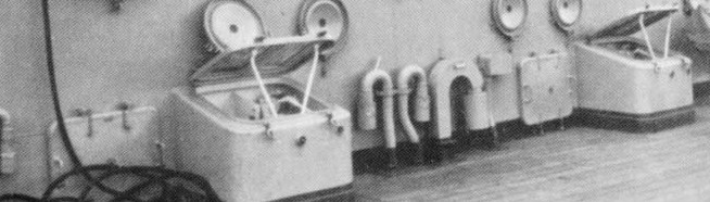

Have been looking at some photos of Bismarck and noticed this about the box deck vents. Look like the covers were stowed against the superstructue walls when removed. The model has no molding for this and I have not seen anything on the PE sheets for them. One more detail to add to the list.

Yes they're the watertight hatches.
