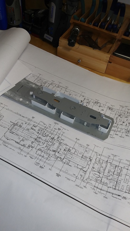

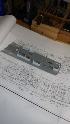

I have been working on the deckhouses of the model beginning with the after main deck and after 01 Level and now working on the main amidships deckhouse where there is a large amount of change involved from the original configuration. So, after a few days/evenings of work, here is where things are at tonight:
As you can see with the original 01 Level laid over the deckhouse, there is quite a bit of additional decking to be added to the original. I had bought a large sheet of styrene the correct thickness for replacing this entirely, but have decided that I will simply modify the kit deck with styrene additions as needed. This is what I've done on the after deckhouse 01 Level, as well.

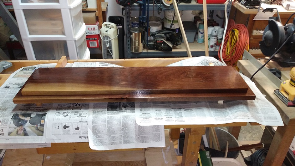

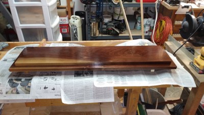

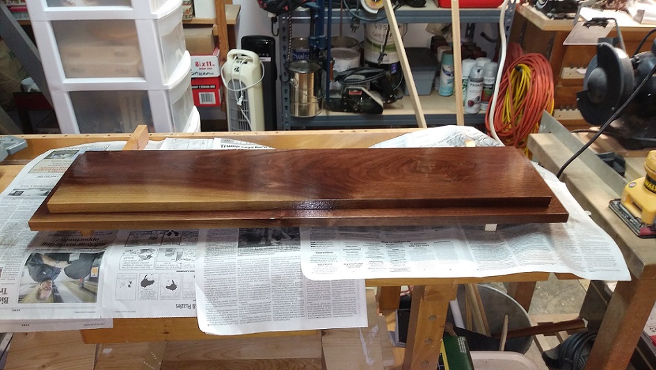

Tonight's work included getting the necessary doors located and installed, as well as drilling holes for fire hose stations, etc. In my garage shop I've now got the black walnut display board assembled, finished, and put aside for when I can start working on the keel blocks (maple) - they will need to have their upper end shaped to the hull at the point of contact. Here is the display board:

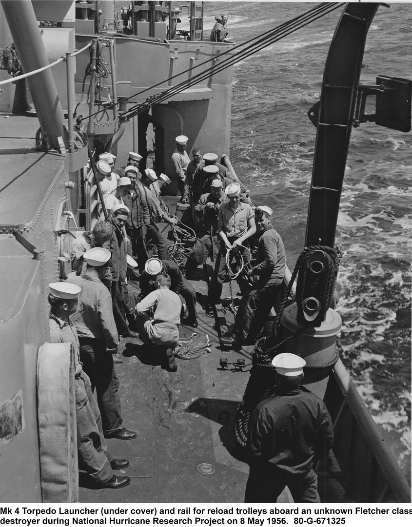

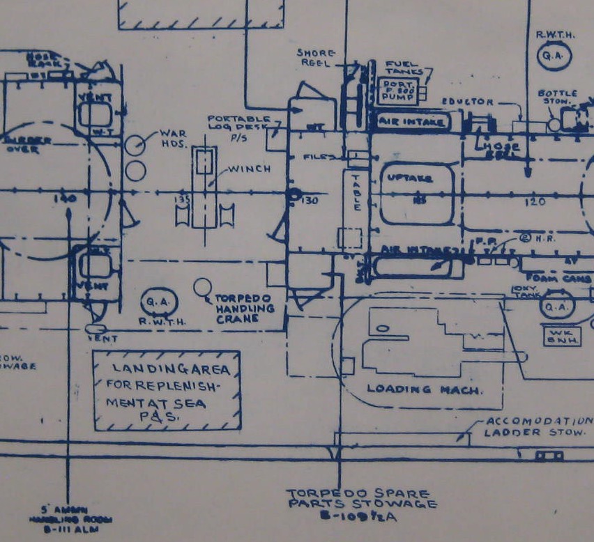

An image that may be of use to Hank and those building a post-WWII FLETCHER with a Tripod Foremast.
The attached image shows the attachment point for one of the legs of the tripod mast. Something that doesn't show up well in most photos because of distance and shipboard clutter.

Part of what you see is likely the grounding straps installed to reduce corrosion between the aluminum tripod and steel deck. Also, needed for the proper function of the various antennas. While researching 1950's FLETCHER's BuShips files at NARA, I found out that the USN experienced corrosion bad enough that at least a couple of masts broken at the base!!! Additional strapping was installed as a preventative measure.

Interesting photo, looks like the portside winch has been removed? Also shows the size of the cleat (huge!) on the davits. For a 1:144 the detail at the base of the tripod might be a bit difficult, though not impossible.
Some of the early Fletcher's had at least partially aluminum superstructure, wonder how that worked out? Certainly wartime manufacturing logistics certainly suggested Aluminum was better utilized for aircraft.

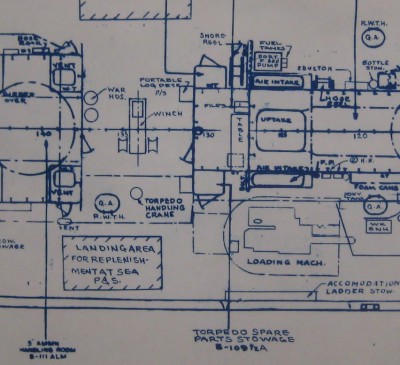

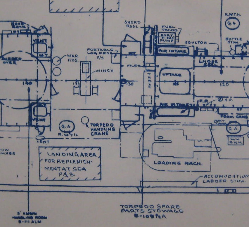

A good observation. When the Mk 2 Torpedo Launch System (TLS) for launching the Mk 32 torpedos was installed at frame 98 or 99 BY NAVY SHIPYARDS with the rail for reload trolleys, the boat winch was moved to where the 5-in practice loader was located between the midship and aft deckhouses. The 5-in practice loader was relocated to the starboard side below the Mk 15 torpedo tubes. The new location of the winch also helped with resupply.
However, there were at least two other methods used to provide Mk 32 torpedo reloads. The new standard was to install a rack for three Mk 32 torpedos with a crane near the launcher. Also, some of the destroyers with Mk 4 TLS, had them installed by tenders, and a wide variety of install locations resulted because they didn't want to move the winch.
USS CASSIN YOUNG is preserved in this configuration.

Thanks - good historical FLETCHER class info!! In the case for 1960s era STODDARD, she did not have those mentioned alterations. The boat winch remained on the port side, amidships without change. The 5" practice loading machine had already been moved up on the 01 Level, centered between the two new Mk. 32 triple torpedo tube mounts, this probably occurred in her mid-50s overhaul. New torpedo loading cranes (2 - one each side) were installed just aft of the torpedo tube mounts. Our quarterdeck remained open without any obstructions and I believe she was decommissioned in 1969 in this configuration. Her last yard period in 1967-68 in Long Beach was mainly maintenance and repair and only involved small modifications to existing equipment. The only real changes I recall were to her at-sea refueling stations - some newer, quick-release connections were installed. We were in the drydock with INGERSOLL (DD-652) at the same time; I think she had similar work done during that yard period.

I didn't get into it above, because it would get to be more involved that I had time to use, that there was a big difference between the Atlantic based and Pacific based FLETCHER's for Mk 32 torpedo launch systems. The Atlantic Fleet opt'd to schedule installation of the Mk 2 TLS during overhaul periods or other short-term Availabilities. The Pacific Fleet in the timeframe that the Mk 32 torpedoes were joining the operational Fleet, was operating in areas of CRISIS off SE Asia. They wanted improved ASW weapons ASAP and having supplies of the Mk 32 torpedoes, but no launcher, couldn't wait for Mk 2 TLS equipment to be sent to forward area yards like in Japan. Besides, the Mk 2 TLS was still in short supply with production schedule around SCHEDULED OVERHAULS. Plus, the DDE's based at Pearl Harbor had priority and Fleet Destroyers based on the West Coast were left naked. So, enterprising minds in the Pacific Destroyer Fleet decided to copy the design of a launcher used during development of the Mk 32 torpedo. A single pair of Drop Rails off the fantail. This was NOT the optimal launch point from the ship, the best location was from midships and over the side. The interim launcher was fabricated at Sasebo Naval Facility, Japan.
What happened was that about half of the Pacific Based FLETCHERS in about 1955 had this "interim" TLS known as PMGL (Poor Man's Gravity Launcher (system) :big_grin: ) installed and actually kept it for a number of years even after. Altering the boat winch location wasn't an issue.
The movement of the 5-in practice loader to the former Mk 15 TT mount location actually didn't occur until the early 1960's. The introduction of the Mk 32 triple ASW Torpedo Tubes started entering the fleet in 1957. However, many HIGHER priority units were in the pipeline before the FLETCHER FLEET DESTROYERS, including all the destroyers involved in the FRAM program. If the Vietnam War had not happened, there was a good chance that the FLETCHER's in the Active Fleet would have been phased out by about 1964 (and actually were from the Atlantic Fleet). So meanwhile, the Mk 15 torpedo tubes were kept as weight reserve. As an aside, on the 4-Gun FLETCHER's there was a weight saving measure of removing the outside pair of torpedoes from the Mk 15 TT mount and blanking off those tubes. This happened in 1957-58 time period, something that could be done by tenders without a yard period and wasn't done on the 5-Gun FLETCHER's (partly because the 40-mm guns were being removed).
The first FLETCHER to have the Mk 32 triple ASW TT mounted was USS HAZELWOOD as part of her DASH Experimental Install in 1957. The DDE's started getting the Mk 32 TT shortly afterwards, but the remaining FLETCHER Fleet Destroyers didn't get them installed until about 1960-62. That was when the Mk 15 TT was removed and the 5-in practice loader relocated.

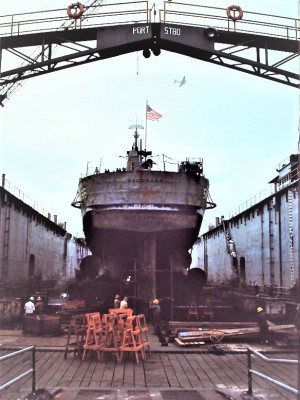

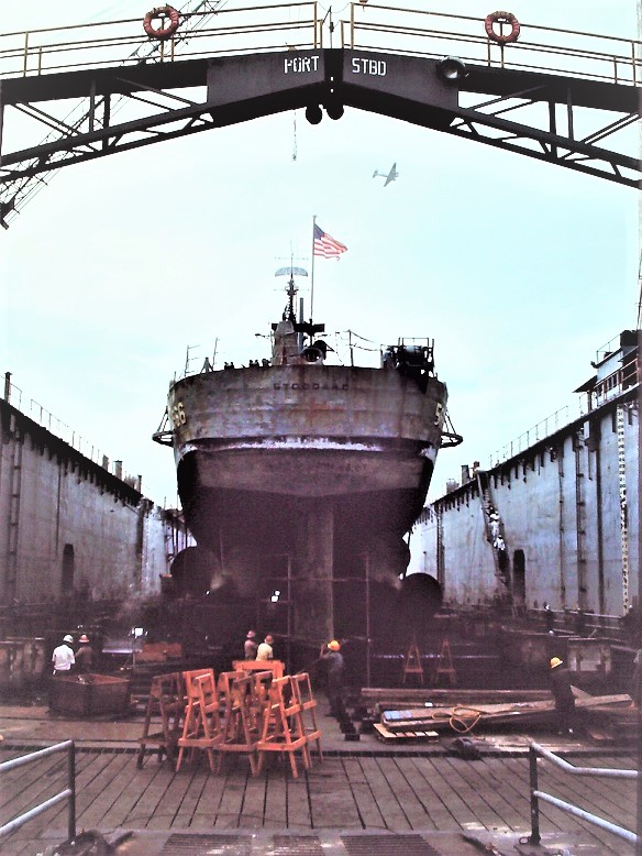

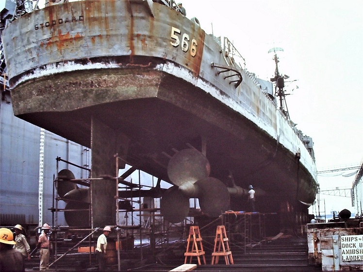

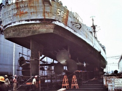

Here is a photo of STODDARD in the drydock in Subic Bay, PI in 1966 for stbd. shaft bearing replacement:
Resized - Drydock - screw dropped for bearing replacement.JPG [ 185.32 KiB | Viewed 1340 times ]
(photos courtesy of Robt. Schutte)
I'll now need to see how the kit rudder compares to the 1968 BoGP and make alterations, as needed.
PostPosted: Fri Dec 04, 2020 9:13 pm
Posts: 5060
Pretty notable oil can smashing above the waterline, but not below. Wonder if that area was reinforced with some heavier STS plating?
Floating dry dock?
PostPosted: Fri Dec 04, 2020 10:30 pm
Posts: 3102
Location: Mocksville, NC
Floating dry dock?
You know, I actually don't recall the drydocking at all - we were in for a week and then back out to continue on to the Tonkin Gulf - I had no direct involvement other than line tending - was in 1st Div. (SA at the time) and working on the boat deck (01 level).
As for the oil canning or not, I don't think the FLETCHER hull was anything other than 1/4" plate steel. The frames, however, I haven't looked into as to size or location, etc.
