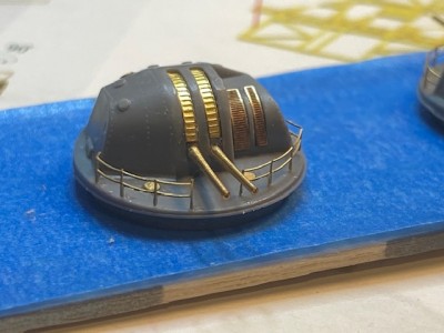

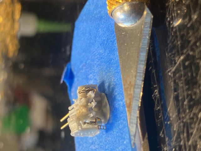

I’ve been working on the 12.7cm guns, both the enclosed and open mounts. There wasn’t much to add to the enclosed mounts. The open mounts, on the other hand, are extremely detailed. I used the Pontos resin structures and brass barrels, with the photo-etched pieces. I really have to hand it to Pontos - the detail is amazing. I’ve included a picture of one of the mounts with an xacto knife blade in the picture to illustrate this.

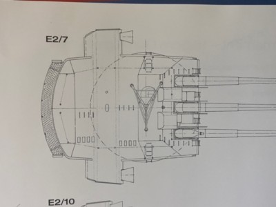

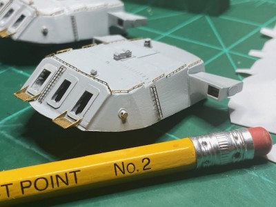

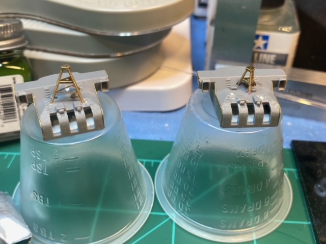

The 15.5cm turrets are up next. There’s a lot of little detail that can be added to the kit here. I started with the tripods on each turret. According to Anatomy of the Ship and the Pontos kit, they are different: the forward turret has an isosceles shape tripod and the aft one has a more equilateral shape. The holes in the kit pieces are wrong for this, so I filled and re-drilled them. Putting together the Pontos details, I mounted them on the turrets.
The rear of the forward turret has a small platform on it. Interestingly, this isn’t in any of the PE sets I have, so I scratch built this.
File comment: The kit part with the holes for the tripod is the wrong positions.
File comment: The Anatomy of the Ship reference drawing for the forward turret.
File comment: The turrets with their tripods glued on
File comment: Drawing of the rear platform in the Super Illustration book.
File comment: My version.

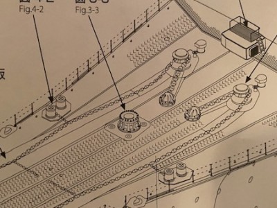

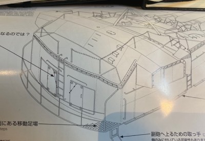

1. The focsle appears to have plates of diamond tread where the seams between them are covered by flat strips of steel. Since the piece I had does not have the junction strips, what you see in the picture is my clumsy attempt to simulate this (see illustration below).

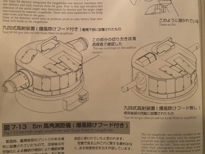

2. There do indeed appear to be two types of the type 94 rangefinders. As far as I can tell, the forward pair have hoods over the protruding rangefinder, and the aft two do not. The explanation in the book is that the forward pair were subject to blast damage, so they were covered (also see picture below)

File comment: An illustration showing some of the strips between the diamond plate that I’m trying to simulate.
File comment: The type 94 range finders. The hooded version (on the left) appear to be the forward pair, and the non-hooded (on the right) were positioned aft.

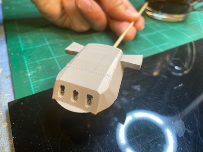

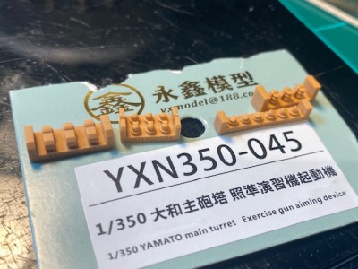

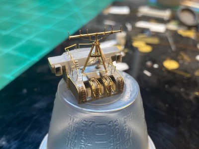

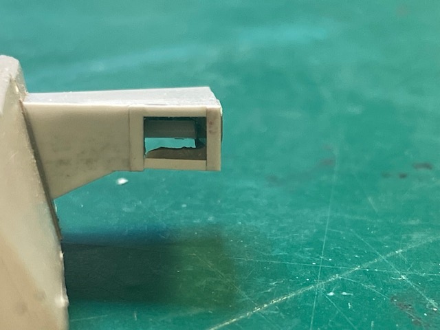

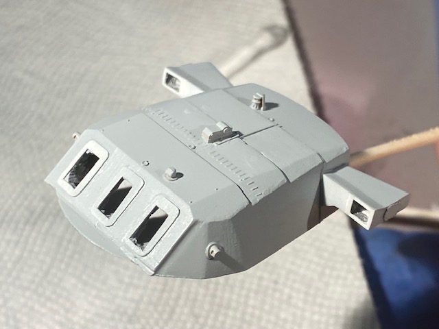

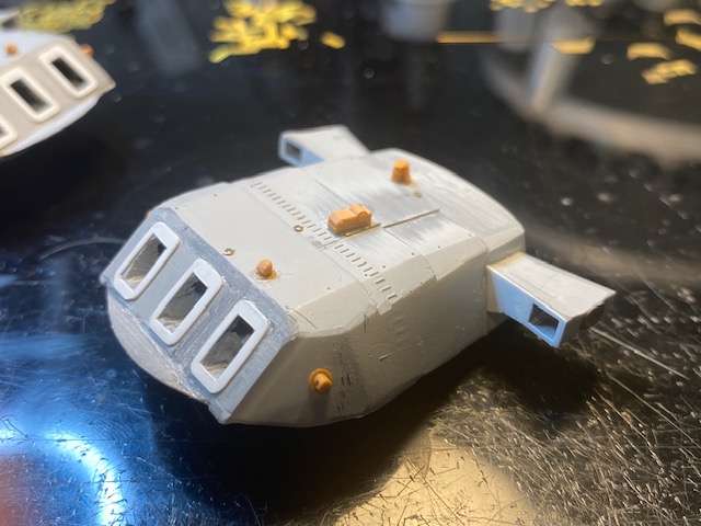

I’ve been working on the main 46cm turrets lately. The kit parts unfortunately required a lot of reworking. I started by removing some molded-on details, such as ladders and the rectangles the represent the ammunition boxes. I ended up removing the molded detail of the front face of the turret as well, as the Pontos blast bags would not fit on it. After a lot of sanding and filling, I added various aftermarket parts. The rangefinder openings needed a lot of work in particular. This was re-formed with strip styrene. I just re-primed what I have so far, and after fixing the errors, I can move on to adding the railings and painting it.
File comment: The kit turret.
File comment: Unwanted molded detail removed.
File comment: The rangefinder openings were molded as a protrusion, which is the opposite of the correct appearance. I tried simply sitting the hole out carefully, but I couldn’t get it to look straight and square. Therefore I hollowed out that piece and re-faced it with strip styrene so it would look better.
File comment: Way better than my freehand cutting.
File comment: Some aftermarket parts I got manufactured by “YX Model,” which high is a manufacturer I’ve never heard of before. The parts are really nice and detailed.
File comment: The details added with attachments for the blast bags I made using strip styrene.

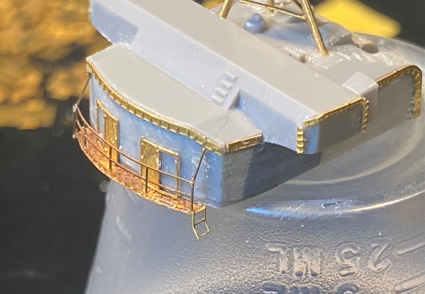

I am in need of some advice. I have been working on adding the PE railings from the Pontos set to the turrets. In past projects, the PE railings I’ve used have a “bottom rail” that actually sits on the deck. This makes it a lot easier to glue down. The railings I’m using here are different - they only have the upright posts to attach the railing to the turret. Since this is not a very large surface, I’ve been having a hard time getting them to stick. I’ve tried both thin and thick CA glue, with or without accelerator, and the results are hit-or-miss. I have ended up re-gluing the small railings on the turrets multiple times. Is there a better way to do this?
File comment: The small rails at the edge of the 46cm turret are visible here.
File comment: The primed 15.5 cm turret with the hand rails in question.
PostPosted: Fri Jul 28, 2023 4:22 pm
Posts: 12325
The "proper" way to do these kinds of rails is to drill a bunch of holes, or to drill a whole for the first and last stanchion and cutting those a bit longer than the rest so they can go into the hole.
Personally I would start with white glue to position the rails before finishing with CA.
