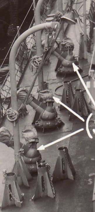

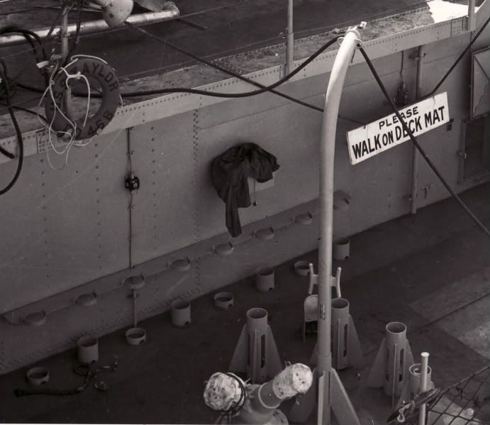

Here is an image of the "typical" early arbor post style storage used on Fletchers seen on the Taylor (DD-468). This is about the best view I have found "without" the depth charges in place and I actually went ahead and made a high-res scan of just this area while I was at NARA. As an aside, the USN used a different layout on Benson-Gleaves destroyers that was more "compact". The short sections of "pipe" you see on the deck along the bulkhead, at two different heights, are for storing spare arbors. I have not looked at the kit to know how accurate Revell made these parts. As another aside, note the non-skid walkways used on Taylor appear to be a solid mat or "painted like tar" on and not individual "pads" seen on many other Fletchers.
The second image is from another angle this time on Bache (DD-470) ... different builder ... but the K-gun was "Government Furnished". The chains would loop over the depth charges to keep them in place. Note the anal adherence to the camo paint specs ... deck blue on top of the K-Guns.

Those have been saved for future use. It appears that i wont have to scrape off the deck right away. I might find I will need work on the K-guns themselves. But weapons will be far down the line. My next adventure are going to be all the cabin bulkheads....opening all the hatches and getting rid of all the molded on details. I might even use styrene to make my own bulkheads, might be easier.

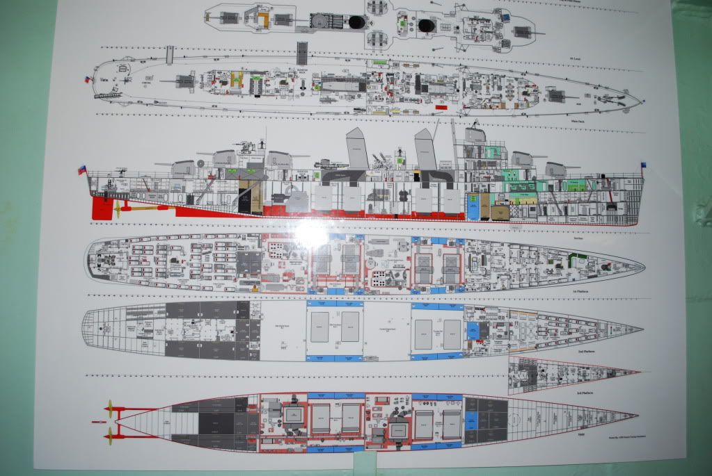

We were in Boston and while onboard the Cassin Young, I found this drawing of her as she appears today posted on a bulkhead. Note the location of the sonar dome.

As designed Fletchers were planned to have two sonars. One at the position shown by you, and second one just before 1st 5" mount. Due to sonar shortages as war emerged they were finished with only one sonar at the position just before 1st 5" mount. What you shown on these drawings is post-war modification of Fletchers. Unfortunately I have no photos or drawings showing early arrangement of the sonar dome - one drawing is in N. Friedmann book on US Destroyers.
