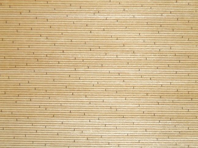

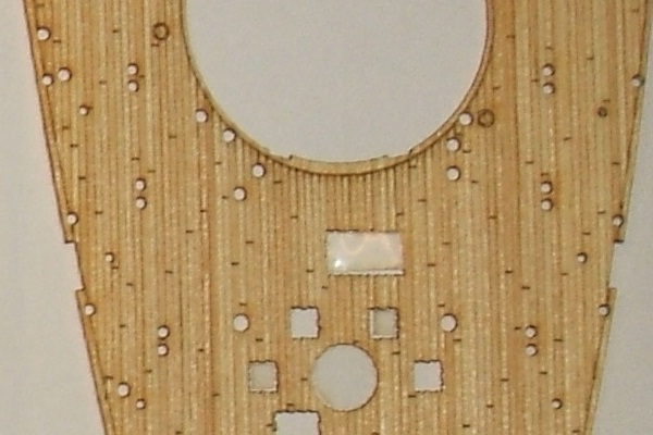

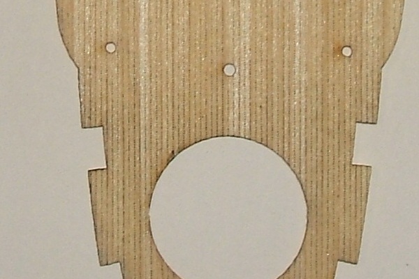

I have a few updates for you today... First, I have listed the blank sheets in 5x14 size on eBay in case you want to pick those up; I'll see what the market will do with those...
Also, I updated the planking pattern a bit to enhance the end plank lines. This may still be a little dark, but it is a manifestation of the printing. In a subsequent post I will show this problem across various manufactured decks. But, in very fine close-up (Remember, these plank widths are .03 inches wide!) here are two images of the wood sheets... I think we will start using this pattern for our ship decks from now on too, and people are saying they prefer the heavier end lines.
File comment: Here is the new planking pattern with heavier cut lines in MAPLE.
File comment: Here is the new planking pattern with heavier cut lines in TEAK.

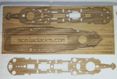

I decided to break out three of the decks that I have for kits that are waiting on the shelf and do another analysis and comparison based upon our production decks. I have the following five to compare, all in 1/350 scale, with associated material thicknesses:
My Borodino/Maple - .0100 thick, thermal fleece backed
My Konig/Teak - .0090 thick, thermal fleece backed
Hasegawa Nagato - .0120 thick, adhesive backed
Academy Graf Spee - .0150 thick, adhesive backed
KA MK1 Bismarck - .0120 thick, adhesive backed
I prefer to NOT have adhesive backing, allowing for a thinner product and also allowing the modeler to use whatever types of adhesives they prefer, from CA to Liquid Styrene Cement or even White Glue. (I ordered some Gorilla Glue and I want to experiment with that; when I do will post results.)
For the self-adhesive decks above the backing layer is actually very thin, and doesn't add appreciably to the deck thickness. The Hasegawa, for example, barely measures .0005 on my digital caliper; it's VERY thin! (My caliper is only accurate to 1/2000 of an inch, and the backing film kept flipping between .0000 and .0005) The thicknesses above are thus very close to the actual thickness for the wood product alone without the backing.
Appearing below are shots of all five decks, in the same resolution, and taken from the same distance. You will notice the differences in the planking patterns between the different manufacturers, and the differences in rendered plank widths. I think we offer the narrowest plank widths available. Also note the "burned brown" end cuts on the laser cut decks, versus our printed black lines.
The Nagato deck is the best detail, made by Hasegawa directly, with superb deck features (like wood rings around the barbette) rendered in the deck. We're still working on perfecting the alignment between printing and cutting before we get to that level. With that said, here are the five decks:
File comment: scaledecks.com - Borodino / Maple
File comment: scaledecks.com - Konig / Teak

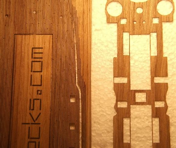

So, how thin are our decks? Well, the MAPLE in particular is so thin that it is translucent! For this reason we recommend that you paint the deck under the wood to keep an even background color. Paint the deck white for a lighter color, pait it blue to appear less yellow, pait it red to appear warmer, paint it black to appear darker, etc.
To show you this effect, here is the maple Borodino deck placed on top of the teak Konig deck!
File comment: Notice how thin and translucent the scaledecks.com decks are.

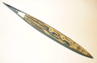

At the office today re-engineering plank lines and photographing deck materials... And in the next room we had a test fit going on for the Tamiya I-400, so I snuck in and took a shot of that. We still need to make some adjustments, and the laser was running a bit hot and it singed the wood a little bit - but we didn't care about that since this was just a test cut for alignment purposes. Here's what that process looks like:
File comment: Test fit underway for I-400. It's getting close!

PostPosted: Sun Dec 05, 2010 9:03 am
Joined: Mon Oct 04, 2010 2:29 pm
Posts: 20
Hi John .Your planking looks about the best Id say . About the end cuts , in this scale would they really be that visible?The linear cuts would because they catch the eye more but im not sure its the same effect with the end cuts . I like your porthole attatchment device .Cheers Martin :thumbs_up_1:

Well... speaking as a dyed- in-the-wool deck painter.... :big_grin:
Disclaimer:--personal opinion only! :heh:
I think the maple deck looks the best so far--teak is a nice tone--but to rich for a scrubbed/ holystoned deck and in relative scale tone.
good colour for 1:1 or on a larger scale yacht or powerboat model- maintained/scrubbed or oiled teak
I thin in 1/35o the butt ends should not be visible- painters of deck try and vary the tone of individual planks to show this off --often excessively in my view- but it suffices to indicate --without overdoing it by an actual marking
On the whole,- a deck is usually a fairly homogeneous colour...
I prefer the printed almost invisible butt ends to the burnt version-- if they have to be there at all!
They always catch the eye to much, lateral marking show more as models are usually viewed side-on....
here are some views of North Carolina-( from MW.com) -which shows colour differential in plank tones--but the bitt ends are al but invisible..
in 1/350 scale I think the tone should be a bit greyer still ...
http://www.modelwarships.com/features/a ... nc/004.jpg
http://www.modelwarships.com/features/a ... nc/016.jpg
http://www.modelwarships.com/features/a ... nc/021.jpg
http://www.modelwarships.com/features/a ... nc/019.jpg

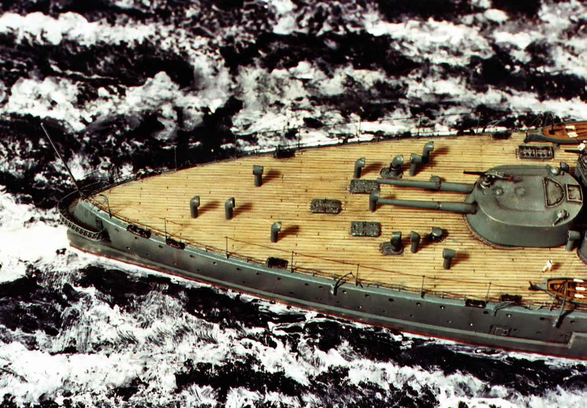

here is a model deck of mine( 1/350 Roma )that looks believable...
and even so I wished the deck did not have the cast butt ends-( I filled them with paint!! )
and from way back wehn....
I tried indicating the butt ends with pencil ( excessivly!)
Better here...
subtler still
and on my latest 350 model almost I left them off completely...( apart from the odd gentle pencil stroke...)
Please do not get me wrong--I think your decks are a definite improvement on the trenched plastic/resin caulking seams in decks--a flush finish is of course preferable...-
- but for me I would prefer the barest minimum of but ends visible...
so far this lighter deck--without butt ends is your most convincing effect

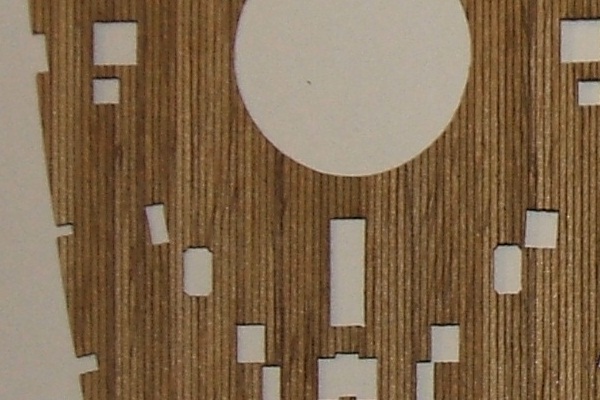

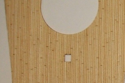

My Borodino decks came today :woo_hoo: I have two versions of teak, one with heavy cut lines the other with light, which are both superb. The wife likes the darker Teak, said it looked more like a real deck, I like both but will more than likely do the darker Teak to make her happy and help me order another kit later :heh:
Here are a few pictures I took for you to look at. These decks are sliced so thin that if I were to put a couple of coats of paint down on the deck rather than John's wood, the paint would be thicker. This is by far the thinnest and finest cut wood I have seen. Kudos John for a fine job.
By the way the fit was right on, I laid the deck over the kit deck for a test and it fit like a glove! No need to cut or trim anything for this to work.
I had to cut the file size so I could post them here, but I think you get a good idea of the quality.
I plan to follow up with more on these as I progress in the build. Shipping was under a week after I bought on ebay.
Hey John looking forward to the Bismarck now... :jump_1:
File comment: First look with flash
File comment: taken through a magnifier
File comment: through magnifier with heavy Teak on left light Teak on right

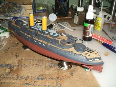

Hey, gang... I took a day off from work today (and will tomorrow, too!) to relax and spend a bunch of time on the Borodino. I am racing on this build because I want to get this sucker done and move on to something else. So this is not up to my usual build quality standards, and I can feel myself rushing through this. But all that I really want to do is to make sure that the deck works okay, and that I can a completed model to show with a deck in place. (And if I think THIS is rushing, coming soon will be a build of the Borodino out-of-the-box, only following kit directions and using kit parts. The purpose of THAT is to show what a basic model looks like compared to a model with metal barrels, etched brass, and a wood deck - a great exhibit at a trade show.)
Now that I have made that disclaimer, and admit that the Borodino is going together slapdash, here is what we were able to get done today...
    We windowed the bridge and cabins (see below)
    We started to assemble 18 deck guns (more on that tomorrow)
    I painted a lot of linoleum (nasty job; I may start making linoleum decks!)
    I touched up some roofs and walls
    I drilled out some glued portholes
    I test fit the walkabout deck, and had to trim it a bit
    I glued down the walkabout and aft deck (see below)
    I snapped of the four stern guns when I tried to rotate them
    And I took a bunch of pictures
All in all, a pretty good day.

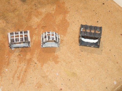

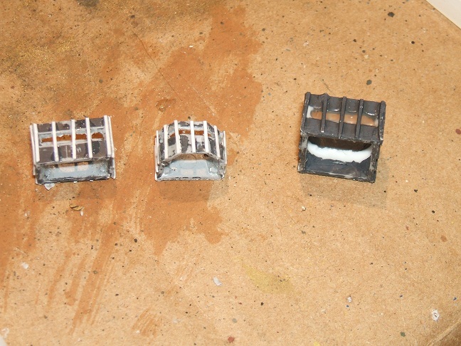

I thought about painting all the square windows on the Borodino silver to simulate glass, but decided instead to open them up.
I first tried to drill them out and file them square, but that was a disaster. The windows are large, and separated only by thin, externally-mounted strips. Filing down the windows filed through the strips and left jagged, uneven squares.
Jayson recommended doing a complete rebuild of the structures using strip stock. So that's what he did - and it turned out pretty good. When complete and painted, we filled the windows with a mix of white glue and water, which dried clear to simulate glass. Here's the process...
File comment: After slots are cut in each wall where the windows will go, and the external braces molded into the kit are shaved off with a knife, the external braces are replaced with strip stock.
File comment: After the glue sets, the excess strip stock can be trimmed away. The unit is then painted, inside and out. Notice the painted unit at right. The glued windows at right have already mostly dried and are clear, whereas the windows on the underside are still wet and opaque white.
File comment: The glue is easily applied with a paintbrush. You can see the "clearing effect" clearly happening here. If the bubble pops, just re-paint it. If they keep popping, add more glue to stiffen the mix.

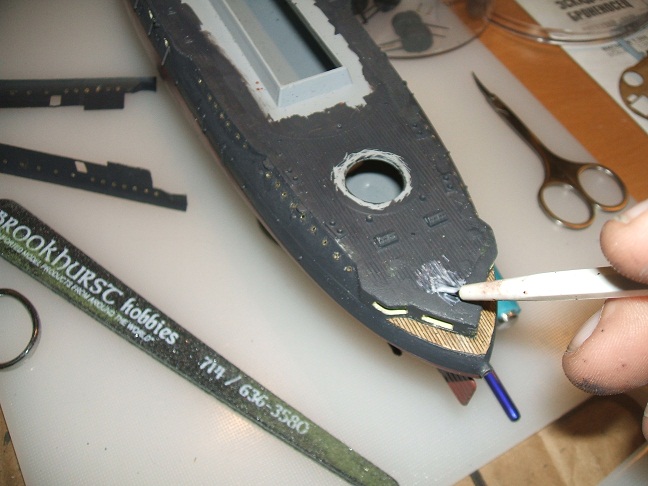

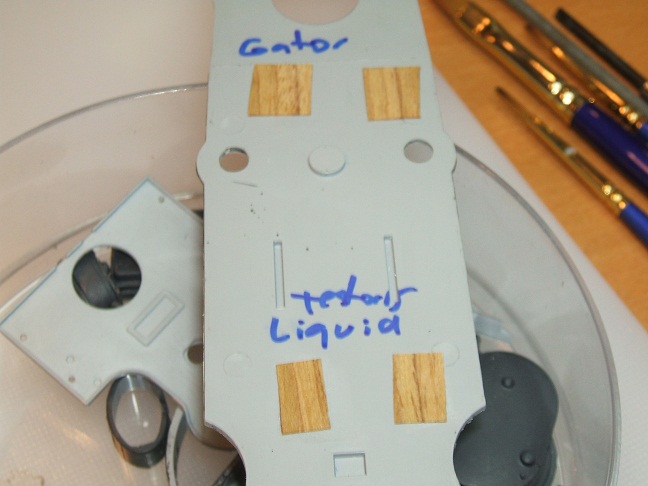

For those of you who will be working with wood decks, I recommend you do the following test FIRST: Stick a scrap of the deck (if you have one) to a spare piece of plastic with whatever method you plan to use to understand how the adhesive plays out. For me, I did not know if I wanted to use Testor's Liquid Plastic Cement, or if I wanted to experiment with some Gator Grip that was recommended here. So I tried both on the underside of the upper deck, as so:
File comment: Testing glues on the underside of the deck.
I liked the Gator Grip - it was very easy to work with, so I decided to try it out... I heard that it could work almost like a contact cement if you applied it to both surfaces, so I decided to do that with a wet layer in-between.
First, I coated the underside of the wood - figuring some of it would be soaked up in the thermal fleece backing. So the first coat here acted more like a sealer coat...
File comment: Gluing the underside of the wood...
Next, I applied the glue to the plastic deck. The underside test revealed that the Gator Grip was really clear when it dried, so I didn't worry too much about slobbering it on the fittings - preferring instead to get a good grip all the way to the edges.
File comment: Brushing the glue on the deck... Shortly after starting to spread the glue, I realized that I had to paint the two bumps brass - so I took a brief time-out to do that. You will see the results later.
I then applied another coat to the wood (I did not take a picture of that; if you want to see what that looked like, go back two pictures and check it out - it looked exactly like that! :smallsmile:) The second coat, stayed wet a bit longer thanks to the sealer coat preventing the wood from soaking up so much of the glue.
Next up was just a matter of plopping the deck into place, and giving it a good rubdown to make sure that the glue made good contact.
File comment: When you're not using the sharpened end of a dental instrument to carve your initials in the side of a moose (sorry, I could not resist) - they can serve as the perfect tool for pressing down a wood deck to apply a lot of pressure in very tight spaces.
When you're done, You have an effect like this... Notice how crisp and clean the lines are between the wood and the fittings in black or brass. (I spent hours today painting the boundaries between the black fittings and the painted-on linoleum on other decks. The wood deck makes that maddeningly frustrating task totally unnecessary.
File comment: Here is a close-up of the two decks. The deck I am using was a test cut that had one small flaw at a rear cleat - I figured I could live with that on my rush-built model. Also, note that the planking pattern on the two decks doesn't quite match; the walkabout deck uses a bit of a heavier line. (It's pretty pronounced here in the enlargement, but it looks okay in real life. Once I add the walkabout railings and canopy frame, and replace the broken-off stern guns, it will be buried under a bunch of other detail and not so pronounced.
I glued the hull sides to the foredeck, then added in the rounded aft bulkhead at the rear of the foredeck and did some touch-up painting of the seams. Finally, before wrapping up for the night I decied to put some of the pieces into place just to see how it was all looking. I think it's starting to look like a Borodino!
File comment: Everything above the aft deck is held in place only by gravity. Lots is missing, and a bunch of what is placed here is misaligned in this photo.
Tomorrow we shoud be able to start putting the superstructure together, and mounting some of the detail fittings.
Closing question: Have you ever built a deck gun and stand that looks like a squashed mosquito - only smaller?
:doh_1:

I am very impressed with the Gator Glue. My observations are that indeed it does allow a lot of movement, and it sticks down pretty well. I think the plastic bond is pretty solid, but not absolutely locked in, as I was able to slide in a razor blade on the test patches and separate them from the plastic undamaged. Actually, I think that's a really good thing in case you encounter some disaster and need to back up a step. With CA, that ain't gonna happen. Once it's down, it's attached, and any attempt to peel it off and try again would just shred the deck. The liquid cement is thicker and I think it bonds better than the Gator Glue - a nice happy medium between the two, but it has super-grabby tackiness - so it is not going to allow for much repositioning at all...
The thing to consider, though, is that with all the cutouts for the fittings the decks aren't going to slide around much anyway. They just drop into place and you use all the cutouts molded in the kit as a guide to position the main decks right where they need to be. So for the main decks, I think I would use the liquid cement. But for things like round gun tubs, there are no real landmarks. If you want to make sure that your planks are running fore and aft then the slippery Gator Glue has a ton of appeal. Also for positioning the walkabout deck it was great. And, we're looking at doing wood cuts someday for utility boats and rowboats and such (I think our material is thin enough to get away with that.) So some slipperyness there would be a great benefit. If we start doing curved pieces - say for the outside of rowboats - then I would probably not trust the Gator Glue or even Testors Liquid Cement, and I would probably jump right to the CA in those circumstances. I want the curved wood to stay put and not try to straighten out... I would say that there is no "one best glue." Each has strengths and weaknesses, so get familiar with them all, then choose what you are most comfortable working with in each unique application.
