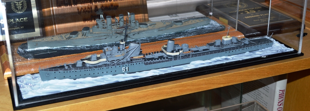

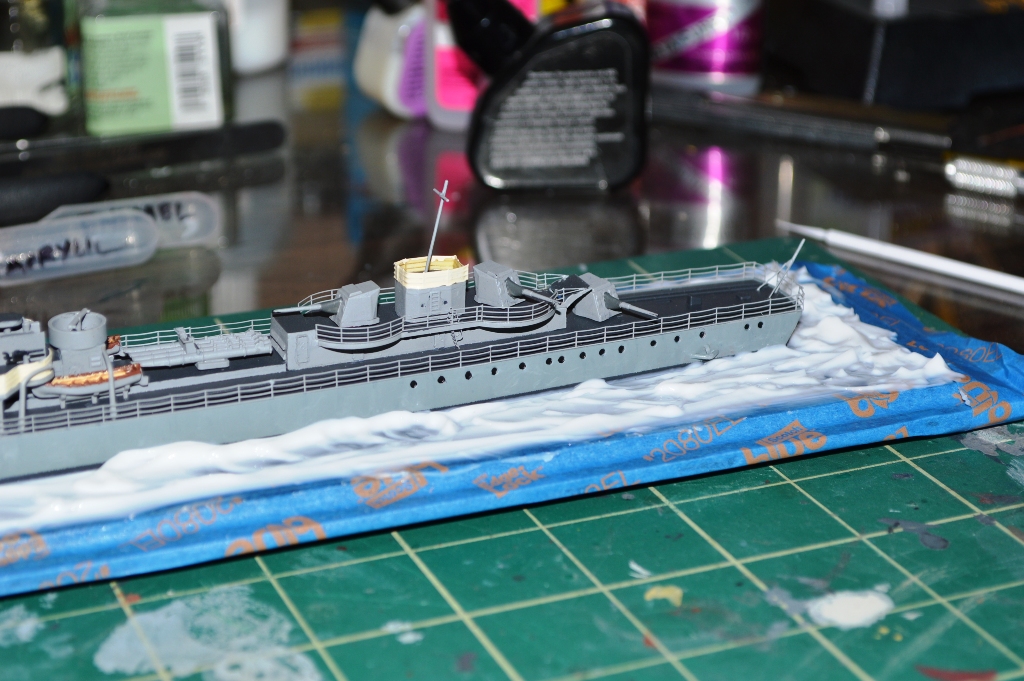

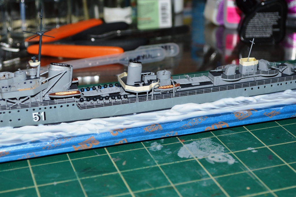

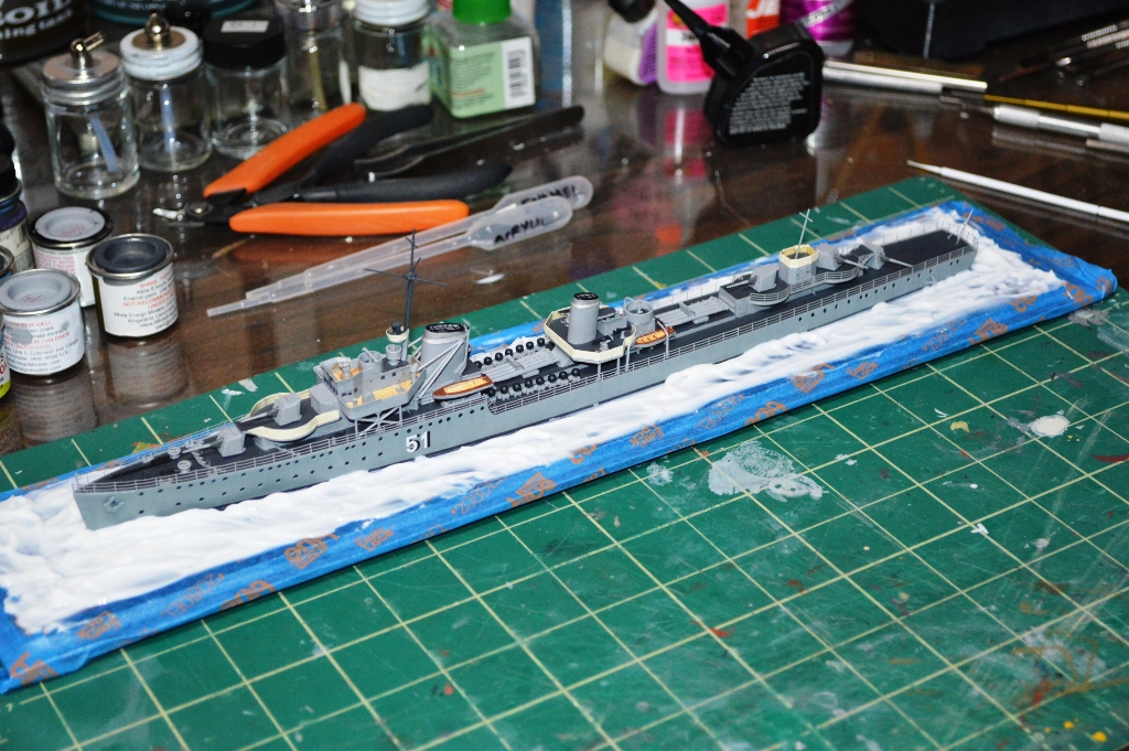

Airbrushed a few coats of flat over the weekend, then put her in a "seascape" of Acrylic Gel Medium tonight. I'm letting her sit in her case - time to let the gel dry for several days so it can be painted. Here are tonight's photos:
Once the seascape is painted, etc., it's onto the rigging and final dullcoat. I want to have her done to enter at the MarauderCon Show in Baltimore on 11/15/14.

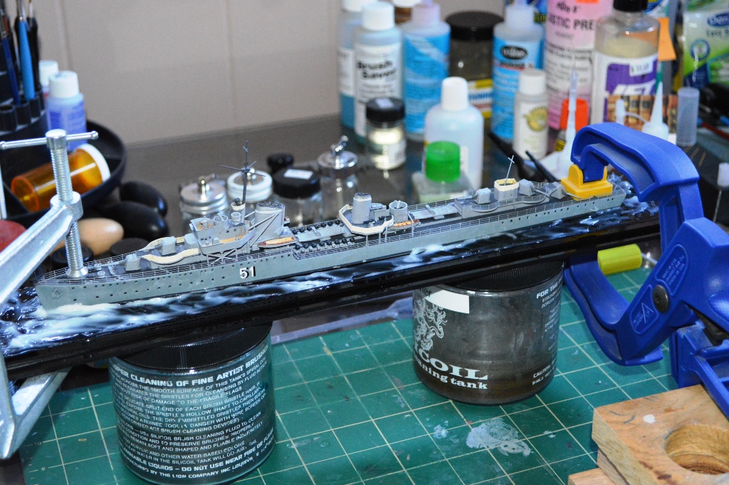

Last night I decided to remedy the bollard issue by making my own. I took the model off the shelf and took the case off. I was surprised to find that not only was the gel not drying, but the model had popped out of the seascape at the bow. I ended up getting some clamps out and clamping her down, then leaving her overnight to dry. The gel dried more in one night with the over off than it had in the previous 3 days! This is how it looks today:
The other thing I noticed was that the flat coat had frosted in some places. How this happened is a mystery to me - it wasn't like that when I had put the model into the seascape and then covered it. Maybe the moisture in the acrylic gel?
It's not really bad, so I think I can work around it, but it's a little disappointing - I was so happy with how this model was coming out. Once the gel is completely dry I'll tackle the missing bollards.

I'd say that the gel not drying means that your display case is airtight. That'd keep it from curing, and the moisture from that would cause the frosting.
Even once completed and fully dried and cured and all the other things that paints and glues and such do, you still probably don't want a fully airtight case. I'd drill a few tiny holes in the cover, on the back at the base level, so you don't see them, but you still get a little air turnover.

How about installing just a thin piece of adhesive felt ( I use the stuff for putting on furniture to prevent scuffing the floors) on each corner of the back of the base, that will give you a mm gap and allow your airflow without risking cracking the plexi. The cracking would concern me as well.
