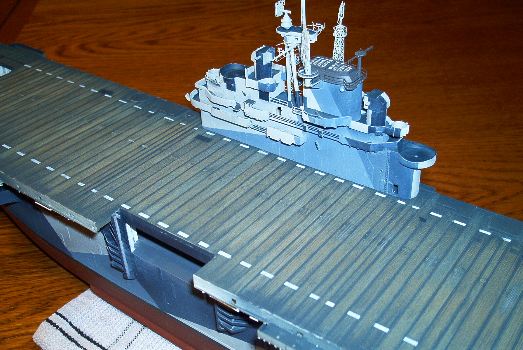

Here are a few more pics with the flight deck and island dry-fit in place.
Aerial photos taken of Yorktown during her October 1944 post-refit cruise in Puget Sound in Warship's Data 5: USS Yorktown (CV-10) by Robert F. Sumrall (ISBN 0-929521-45-5) show that the white deck edge dashes appear freshly painted while the centerline dashes appear worn away. I tried to replicate that look.
The next big effort will be completing the gallery deck.
File comment: The hull plating detail shows up well in this photo. You can also see that the
side elevator rails are I-beams.
File comment: The island is about 90% complete. Some of the detailing of the side elevator
track supports shows up well in this photo. More of the blue will be removed
from the flight deck.
Have fun, Monkey around.™

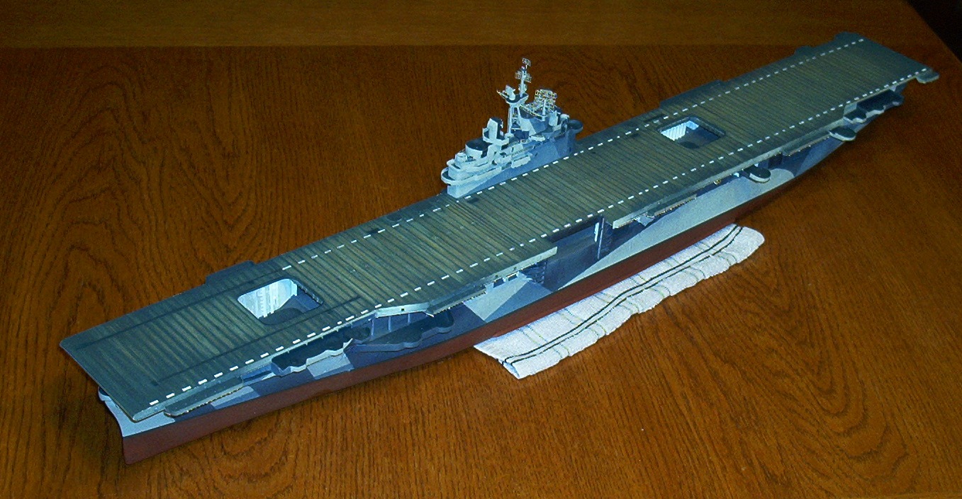

Which color blue did you choose for the flight deck color? And would all flight decks of that time period get the same color?
According to noted naval historian Alan Raven the correct color for mid-1944 through 1945 is #21 Flight Deck stain (revised). He states, "About mid 1944 there was the introduction of #21 Flight Deck stain (revised). This revised stain was (when newly applied) identical to 20B deck Blue (revised) and was a near match in service with the introduction in March 1944 of glossy Sea Blue, a new camouflage color for use on carrier aircraft." You can read more of this discussion on ShipCamouflage.com
WEM has this color in its colourcoats line of enamels and I highly recommend it as accurate. Since I airbrush indoors and we have lots of small kids, I choose to use acrylics instead of enamels. So as a substitute for WEM's #21 in acrylics, I chose Polly Scale "Weather Deck Blue 20-B" which, IMHO, is an acrylic that closely matches #21 Flight Deck stain (revised).
Despite reports that ModelMaster Marine colors and PolyScale marine colors have been discontinued, they are all available directly from Testors Corporation
For those modeling an Essex class ship in 1943 or 1944, go with the earlier Flight Deck Stain #21 (Late 1941). In acrylics, it is also available from Testors Corporation.

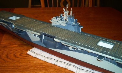

Two views of the overall flight deck:
File comment: The flight deck: worn and dirty. The aft elevator opening
bulkheads will be painted soon. The gallery deck sure needs
some more work!
File comment: She's just about ready to take aboard Air Group 9 and head
out after IJN Yamato.
