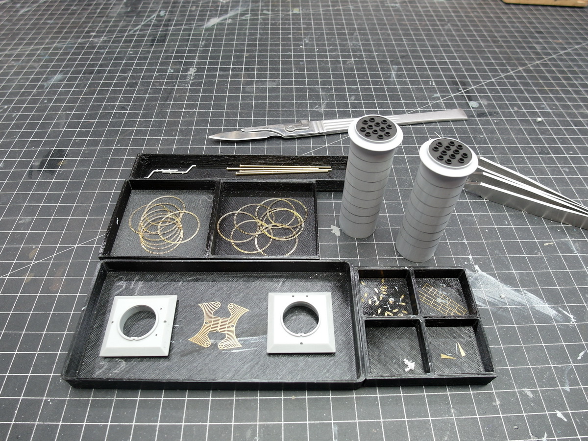

I was once again spoiled for choice between Pontos and KA for the funnel surface.
Pontos offers riveted struts, KA rings that run around the funnel.
So, I once again rummaged through my archives of the original ship and looked at conflicting pictures. Of course, often of rather poor quality.
The deciding factor was once again the quite good picture from Vladivostok, which I believe shows rings.
And since it’s one of the last photos of the intact ship, I chose that one. I like it better anyway.
So first I cut the components out of the circuit boards.
And again, KA Model wins.
My enthusiasm was dampened slightly when attaching the rings. They were a little too big. That’s why they were touching on one side, leaving an unsightly gap on the other.
I took them off again, sanded them cleanly, and then primed them thoroughly. Another attempt with the blue BluTack putty. This allowed me to keep the rings centered.
It works. And since I’m using Mig’s acrylic adhesive, there’s no mess like with superglue. Diluted and applied with a fine brush, it flows wonderfully evenly into the gap thanks to capillary action.
Excess glue can then be easily removed with a brush.
Ring by ring it continues downwards.
It’s nice that I managed to solve it cleanly after all, since the funnels are in a rather prominent spot. So I set them up for a test. They look great with the rings.

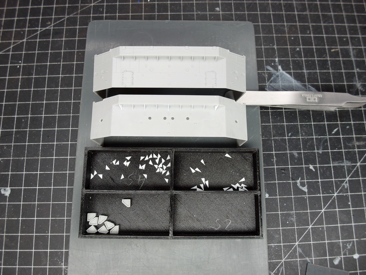

Once again, the details are sanded down, portholes drilled out, and holes filled in to replace and re-clad everything with beautiful brass.
First, the rear bridge house.
The gusset plates are too thick for me and will be replaced with 0.25 mm thick styrene.
And again on the deck.
Now the same with the bridge house on the bow side.
Greetings from Germany.
Jörg
