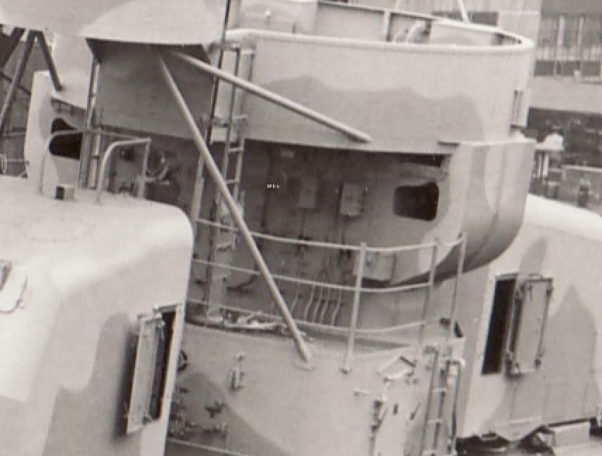

Anyone have a picture of the after steering? I have one picture that I can make out several pieces of equipment, but not everything.

PostPosted: Mon Aug 24, 2009 8:17 pm
Posts: 3841
Les,
What detail exactly are you looking for at the emergency con station?
Rick
PostPosted: Mon Aug 24, 2009 9:16 pm
Posts: 3841
Les,
Here is a blow-up view of this area on the Fletcher herself on 26 June 1942 from a different angle. There appear to be a few detail differences compared to O'Bannon, but mostly the same. Every other image I have of this area is too far away, too dark or have crew members in the area.
PostPosted: Tue Aug 25, 2009 5:38 pm
Posts: 819
Location: Port Townsend, WA
Thanks Rick,
Now I have to figure out what the black areas are. Air intakes?

PostPosted: Wed Aug 26, 2009 7:29 pm
Posts: 3841
Les,
I don't think the holes are vents. I believe (I have not gone looking on the BIW Engineering plans DVD to check) that the "chutes" on the sides are for spent casings from the 1.1-in rounds or 40-mm rounds depending on the ship. For some reason the aft end is enclosed and the fore end open. There could be more going on inside, but I doubt anyone will go in there and look for it. :smallsmile:

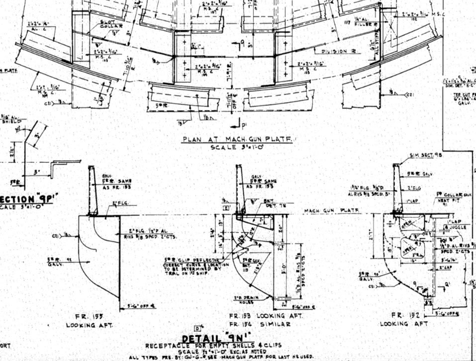

Rick,
What are the chutes on the aft end of the gun tub for? I imagined them to be spent shell case shutes. Could the side shutes be ammo lifts? That might mean the black (open?) spaces are for access in case the lift became fouled.

PostPosted: Thu Aug 27, 2009 6:38 pm
Posts: 3841
Les,
I had suspected, but checked the drawing in the "BIW Fletcher class Engineering Drawings" DVD just to be sure. The two small "chutes" on the aft end of the tub are actually the trunks for the ammo hoists to bring up the clips from the clipping room. The two "chutes" on each side are the spent shell receptacles (bins if you please) for either the 1.1-in or 40-mm guns. I had guessed that these could be accessed from inside the clipping room. But the drawings seemed to show that the "hole" that we see is the access opening to the empty shell cases and clips. Here is a "grab" of the bin and holes in the deck of the tub for the shells to pass into the receptacles (top drawing). The middle bottom drawing shows that the receptacle bin is more complex than being a simple "box". The square opening above the odd shaped access hole to the bin, appears to be an access to what would otherwise be a closed space. It appears that there actually were two levels to the spent shell bins. You can see the divides to the separate bins in the top drawing. Interesting engineering.

Rick,
Thanks for all the research! I'll try to figure out the drawings (I'm not an engineer) to make the corrections in the kit.
