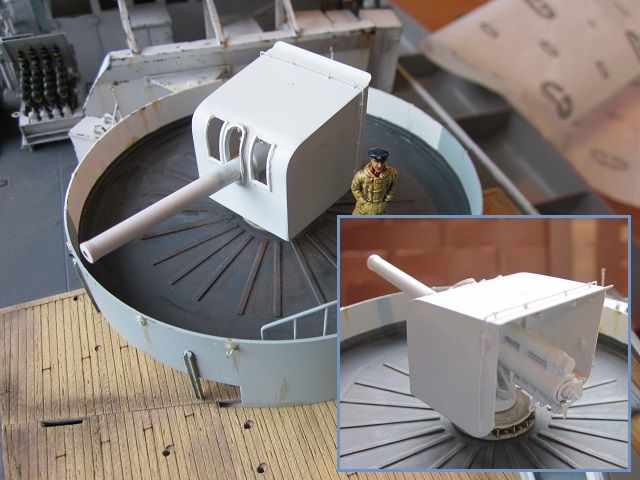

Thanks PG :smallsmile:

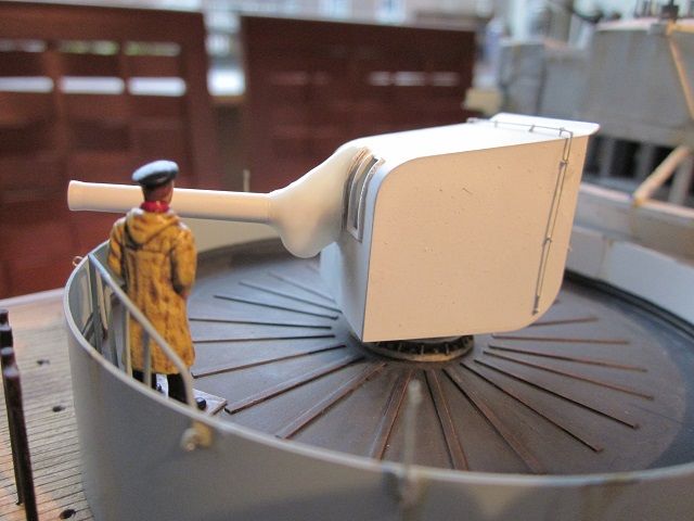

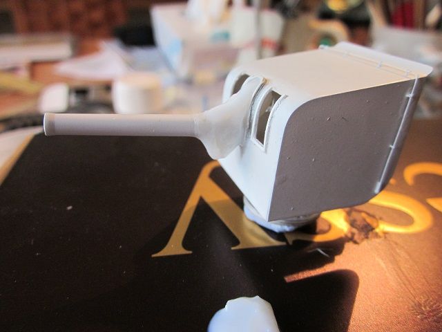

putting the shield on the gun was somewhat nerve wrecking...6 internal PE brackets and very little room to adjust them to a good fit. Some scary bending was needed to get it all done...some more scary bending to get the shield sit straight, but in the end...a fairly decent result I think.
I must now make the blast bag before I can continue painting...tissue paper and white glue I guess.
Edit:
Watching glue dry is relaxing :big_grin:
I soldier on...more soon.
Rob :wave_1:

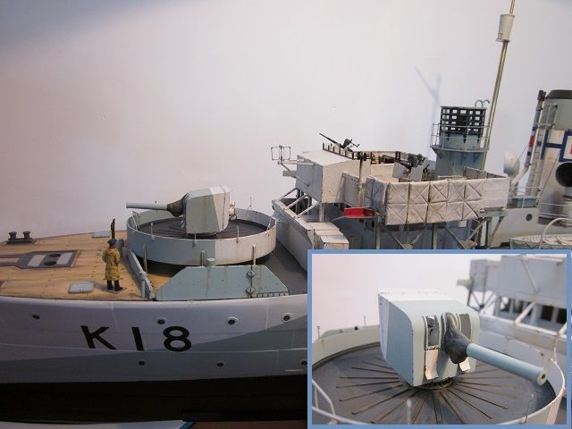

nice blast bag :thumbs_up_1: it is not a critic ,just for me, a little more "folds" (plis in french??) would be even better than better :wink: but ,the whole is really very convincing,a beautiful personal work :thumbs_up_1:
good job
Nicolas

this is after several more layers. You're right...I'll add some texture to it :smallsmile:

the cigarette paper stuck to the wood glue,or with cyano is good for this type of work

Still some jobs to do there...ladders, shell holders (might do ammo lockers instead) and the rope for the rope stanchions.
Can now move on and do the 3 davits, rope reels, anchor winch, anchors and railings.

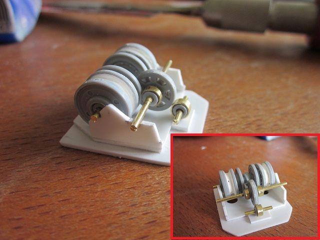

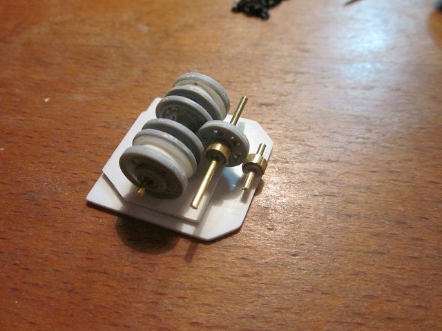

The anchor windlass...one of those projects I kept postponing, because I simply don't have a clue how to do it.
The kit's windlass is one of the worst parts of the kit, can't use anything of it :huh:
The drawings in the Agassiz book are good, so there is hope.... I just started and see where it ends...
1/72 scale Tiger II wheels, evergreen, brass rods and tube and model putty.
Finished the shafts, gypsies (chain drums), gears and base plate...so far so good I think.
Next will be the steam pistons, side frames and warping drums.
hope to finish this...and the remaining bow stuff...next week :smallsmile:
Edit:
Made the outer frames and added another gear (overlooked at first). the small centre gear on the chain drum axle.
There's also an inner frame, it's exact shape isn't completely clear to me, so I'll use common sense for that.
Drilled the chain pipes too much forward, so I'll fill them and drill new holes :puppy_eyes:
LE BOSCO kindly offered to turn the warping drums for me, I'll give it a try myself first, but his skills surpass mine by a mile or two, so perhaps I need his help :thumbs_up_1:
More soonish
Rob :wave_1:

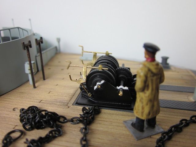

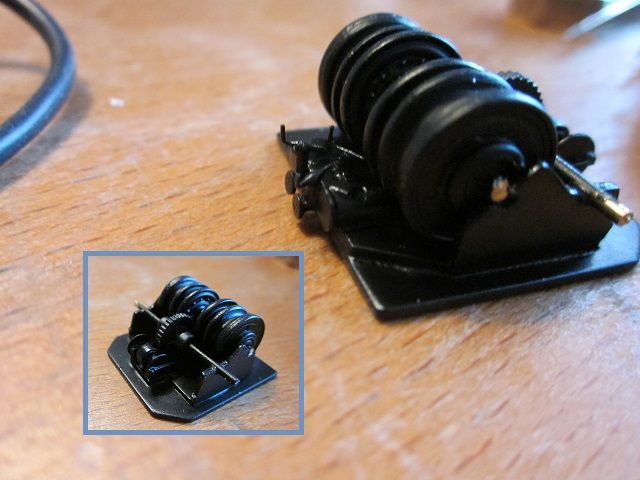

Wasn't happy with the warping drum axle, so I made a new one, drilled new chain pipe holes, made the inner frames and did the whole steam thing. (cylinders, piston rods, crank disks, reverse handle, steam valve handles and flanges). So far...53 parts.
Had to basecoat the whole thing black, because it's not possible to reach all corners for painting after construction and it's good pre-shading I guess.
Next will be the band brake handles, the clutch handles, steam input and exhaust pipes, warping drums and what more...total amount of parts when finished...141 :shock:
Glad when it's all done and I hope it's worth the hassle :puppy_eyes:
