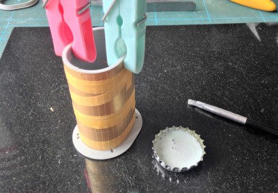

Following on with the turrets, I also decided to do something with the commanders position look out. I had a look at Bill's method but thought about taking a different slant on this.
I used to make Airfix kits when a lot (lot) younger and bought the Airfix Magazine religiously. I actually had a couple of letters printed and was very proud of that. The reason I mention this is that there were always conversion articles which relied on modelling skills, rather than purchasing a piece of resin that someone else had cast and then cutting a suitable sized hole in the kit and fitting it. Not that there is anything wrong with that, it's just that we did things differently back then.
I mention this because I remember an article doing a conversion on a Sea-king Helo, adding a Radome to the spine to duplicate a Royal Naval version, and the radome was made by filing a suitable size of balsa-wood to shape and using this to push a softened piece of plasticard through a hole. Here is my updated version of the method to create the curved wind-shield on the commanders look-out.
A piece of 30thou plastic card was cut off and softened over a cooker ring (apologies for photo) -

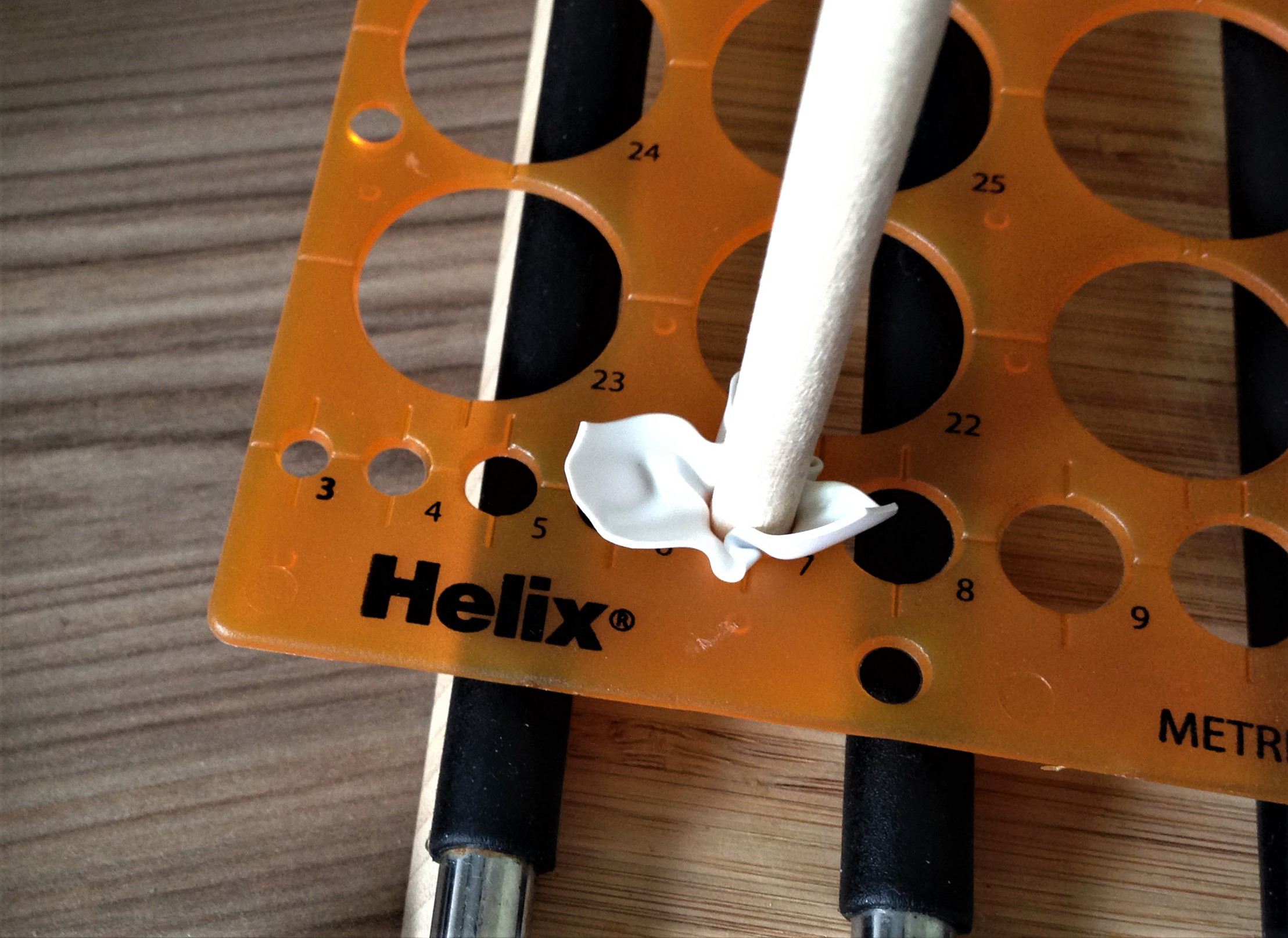

The 'hole' was from a helix masking set that I use for spraying tank wheels -
A suitable diameter roller from an etch rolling set was chosen and the end smoothed off -
the softened card was placed over the hole and the rod pushed through -

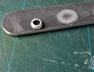

A suitable hole is drilled in the end -
and then I rub the drilled end on a filing stick to create a flat circle on the end to act as a guide to how much material to remove -

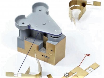

Previously, I was working on the searchlight platform (Trumpeter part N2) and need to issue an amendment to the instructions to fit the etch that Pontos supply to enhance the kit part.
After removing the sections as per Pontos, also don't forget to remove the starboard hatch and open up the doors as per http://www.hmshood.com/hoodtoday/models/trumpeter/trumpeter200.htm
The instructions give the following order of addition -
From my experience of putting this together, I would recommend the following order.
1. Bend and fit the upper section first, part 1008, care is needed to fit the insert that goes inside the kit part and take care with the bending.
2. Fit part 1004 next, you may have to file away the plastic to allow this part to fit
3. Bend and fit the box, part 1007
4. Finally fit the lower section, part 1018, bearing in mind my previous post regarding folding this part.
I slavishly followed the order as printed, and, although I managed to get it all together, the above would have resulted in a far easier order of construction.

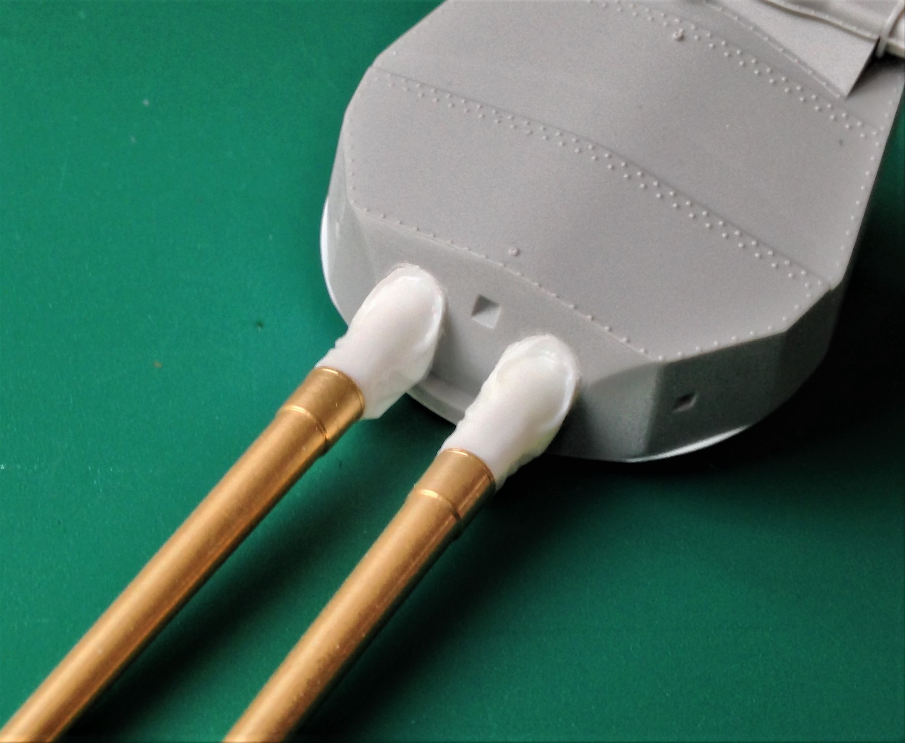

Thanks Pete, I will always pass on any info I get, see below for a couple of amendments to the instructions on the turrets below!
I started them off by attaching the barrels to the bloomers, or blast bags. Note that the resin parts are 'handed' and fit reasonably well.
The bottom section is sort of 'squared off' and this fits to the inner side, some seem to fit fine but others need a little filling. I have taken a couple of pics to try and show this -
I used PVA painted on with a small brush to fill the gaps

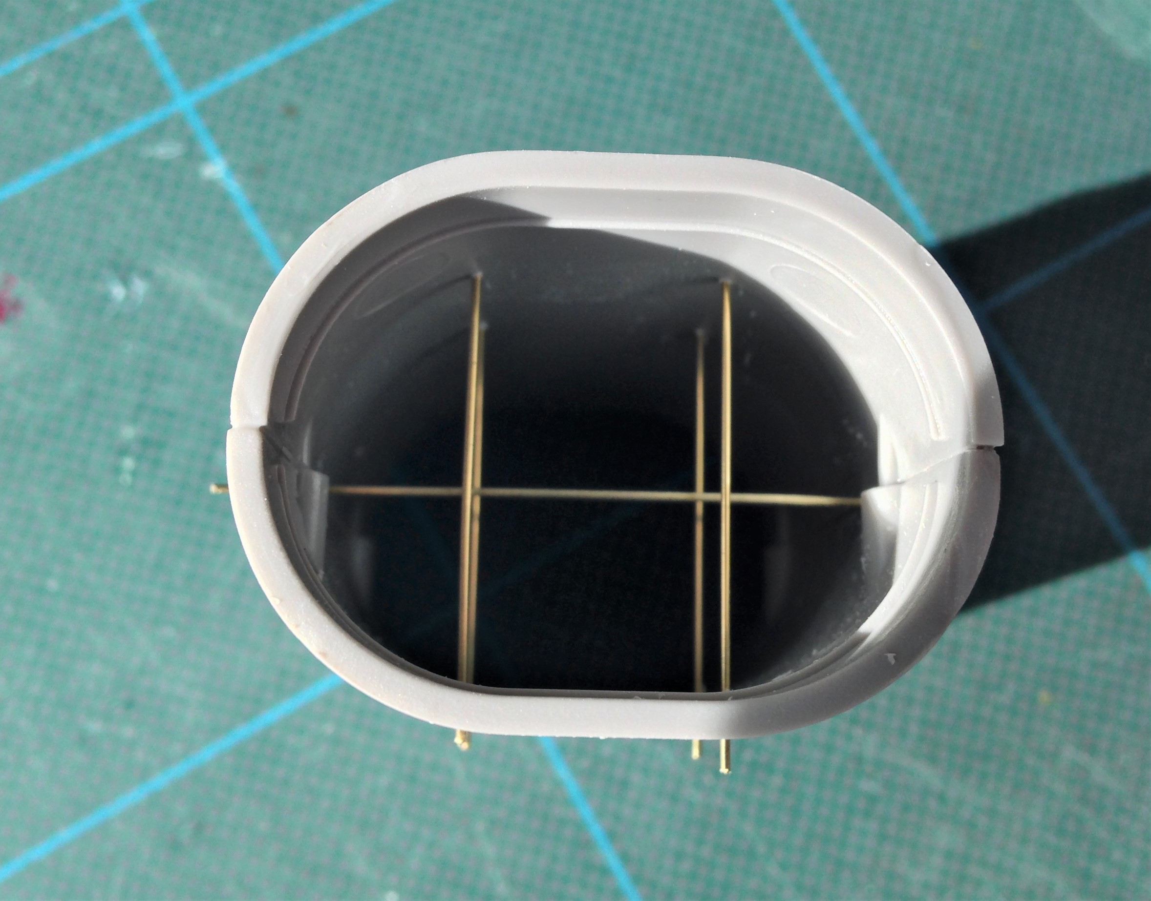

I am going to add some stays inside as per the AOTS of the HMS Dreadnought and EJ's scratchbuild https://ontheslipway.com/?cat=11
I found some brass rod in my stash, 0.51mm, looks about right for the job so started by drilling 0.5 holes, not big enough!, so went with 0.6mm
If you do something similar, make sure you drill the holes prior to removing the details, you can count the rivets to find the right place to ensure they're square.
I've done two across and one along, don't know if that's enough, what do you think?
Once these were glued into position, I then removed all the external detail, prior to fitting the etch.

I purchased an etch roller, it has come in very handy and you really need one for the task of bending the funnel detail -
I used PVA with a touch of washing-up liquid in it -
I will use two-part epoxy when doing the ones on the model, not sure about the join though. Would have been better if they had hidden this behind one of the steam pipes!

I have made the interior walkway, just one thing, don't forget to pop the 'hangers' over the central platform BEFORE gluing it in position. Ask me how I know!
Lessons learnt? I think I will use more stays, and make them slightly closer together horizontally.
If you have any comments or suggestions on this section, don't hesitate, post away! Also has anyone any experience of adding the etch to the 3D printed funnel?
