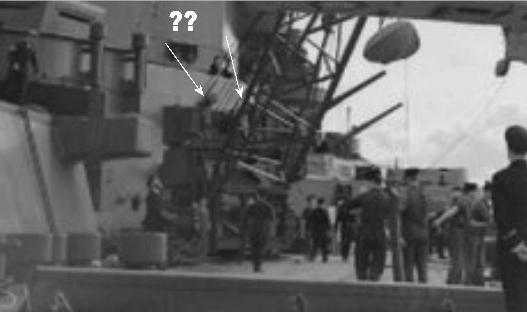

PostPosted: Thu Jul 13, 2023 3:05 am
Posts: 5568
neat stuff-!!
-- the flared tubes on top aft of the main crane
what is their purpose?
exhausts??
I would guess at a guide for a moving cable...?
though none of the other cables appear to need that?
a ( very ) quick sweep of the net got me this image
poor quality and not helpful...
PostPosted: Thu Jul 13, 2023 3:31 am
Posts: 2874
exhausts??
[/attachment]
Buffers to avoid the crane from being elevated too much; there's a small square pad on the gantry too.
PostPosted: Wed Jul 19, 2023 3:04 pm
Posts: 5568
Sorry for delayed response,
Thank you EJ -
now that you have pointed it out......... it makes perfect sense (!) :wave_1:
