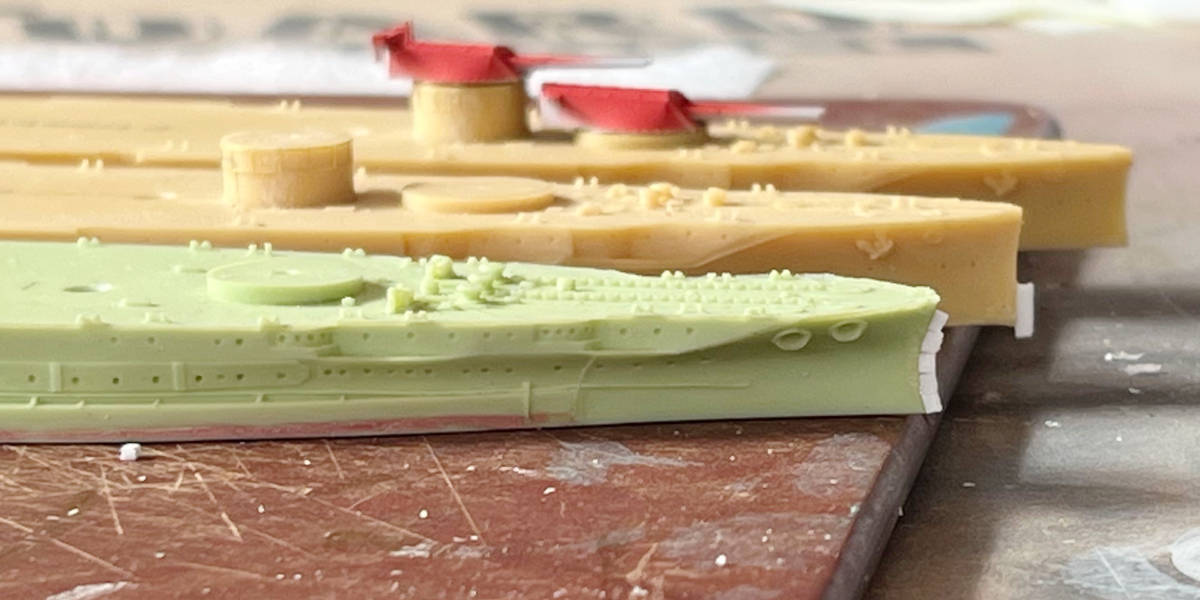

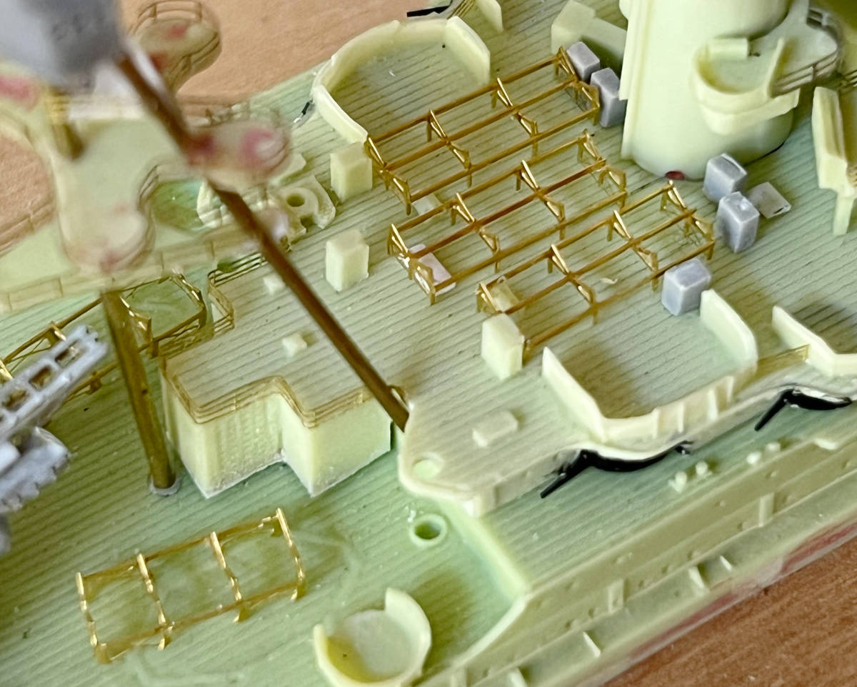

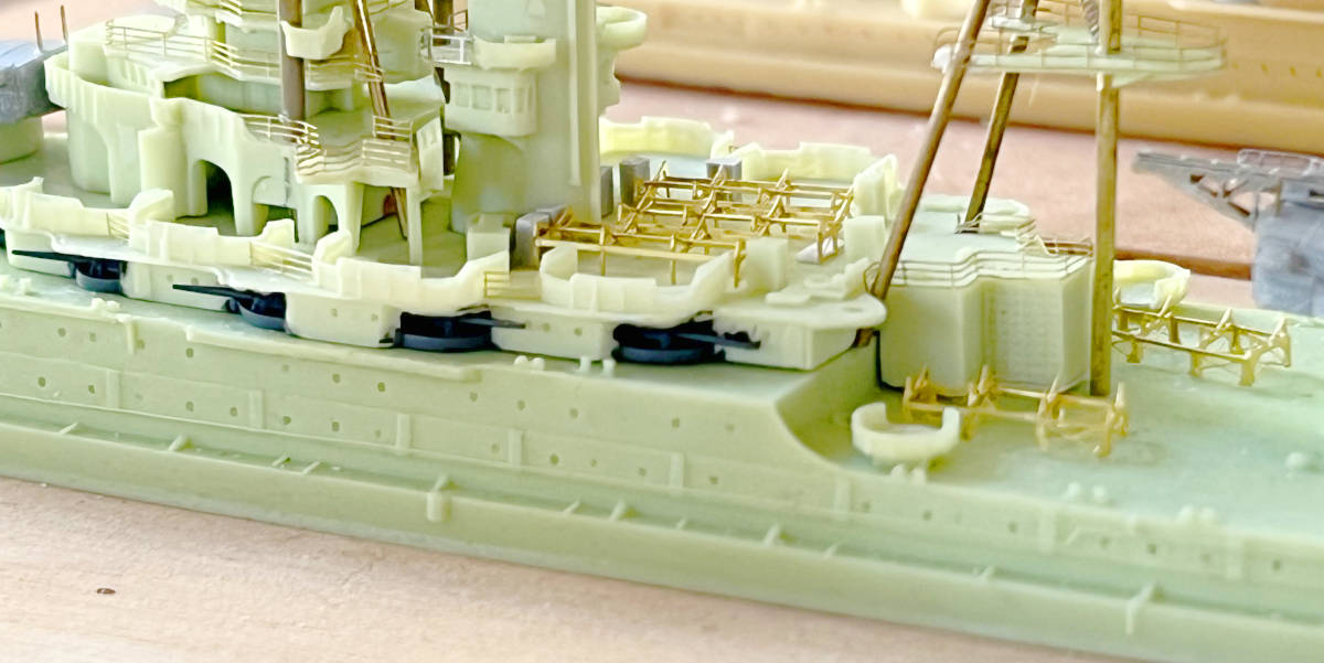

I've started working on the boat deck area of Arizona. As they'll be depicted as they were in Pearl Harbor, the boats will be off the ship and in the water, and so there won't be the usual stack of boats behind the funnel. I got the Tom's detail set that has the boat racks so that this area wouldn't look empty. The kit has resin parts for this, but they're much heavier than the photo-etch.
On one side of Arizona, I've painted the casemate guns in their final color. The photo came out a bit dark, and the color is quite dark, but the last photo shows what it looks like.

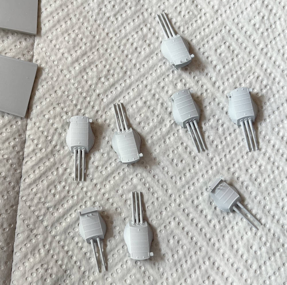

I've also primed and started to paint the turrets. I've assigned each turret to its final location, and labeled them all on the bottom of the turret. At the point, the tops are all white so that there's a light background for the red or blue later. Turret 2 of Nevada will stay white.

Hello:
Turret 3 had the catapults on them, and were dark gray on top. Since the tops weren't painted white, red, or blue, there isn't a need to a white base layer. The same goes for Nevada's turret 1, which appears to have not been painted red on top. So don't worry about the three turret 3s...they're just set aside and not in the picture.

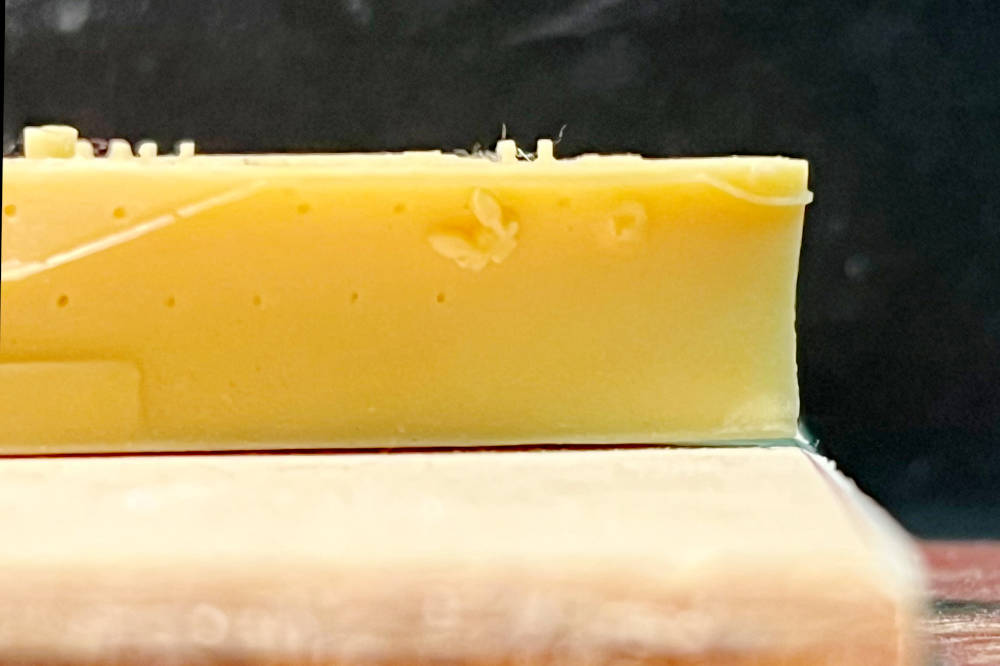

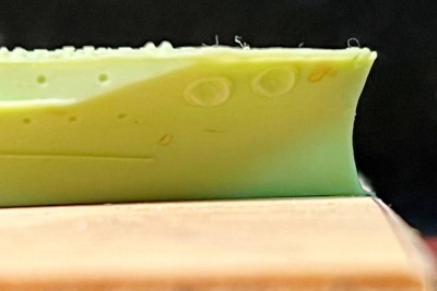

One thing that was bothering me is that the profile of the bow for Oklahoma and Nevada (tan resin) compared to the Hi-Mold Arizona (green resin). The bow profiles look quite different, since the Oklahoma and Nevada being very straight, and Arizona quite curved.
For comparison, I found pictures of the bows of Oklahoma and Arizona. Oklahoma is the top picture, Arizona is the lower picture.
My conclusion is that the bow of Nevada and Oklahoma are not curved enough. The bow of Arizona is too curved, and the point where the bow meets the waterline is aft of where it should be.
Mike

PostPosted: Mon May 05, 2025 10:26 am
Posts: 468
can you post sideview pictures from the anchors & aft to show both bow casements while still posting the 2 photos of the real ships as I see a possible issue with Oklahoma.
PostPosted: Mon May 05, 2025 12:35 pm
Posts: 993
mconnelley wrote:
Hello:
Mike
Agreed! Also, remove that degaussing line from the side of Oklahoma's hull. That was a short lived temporary deguassing line that was replaced with the permanent line at the deck edge.

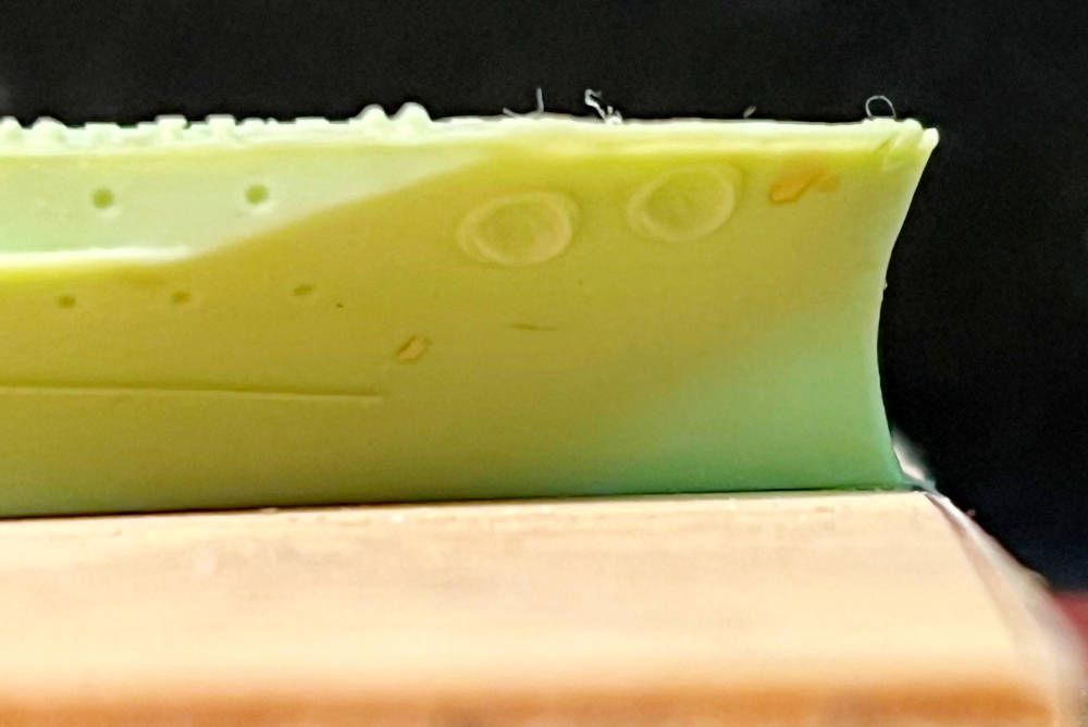

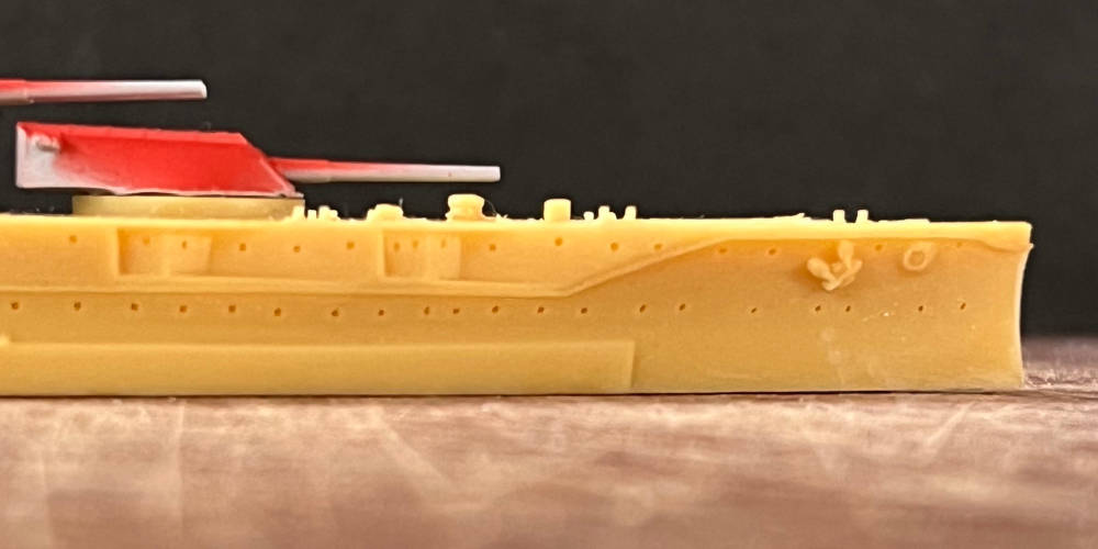

Here are pictures of the Oklahoma kit and the real ship, from the bow to turret 1. The thing I noticed is that the casemates are too tall, and the lower edge could be brought up to increase the downwards slope of the hull line forward of the casemates.
Mike

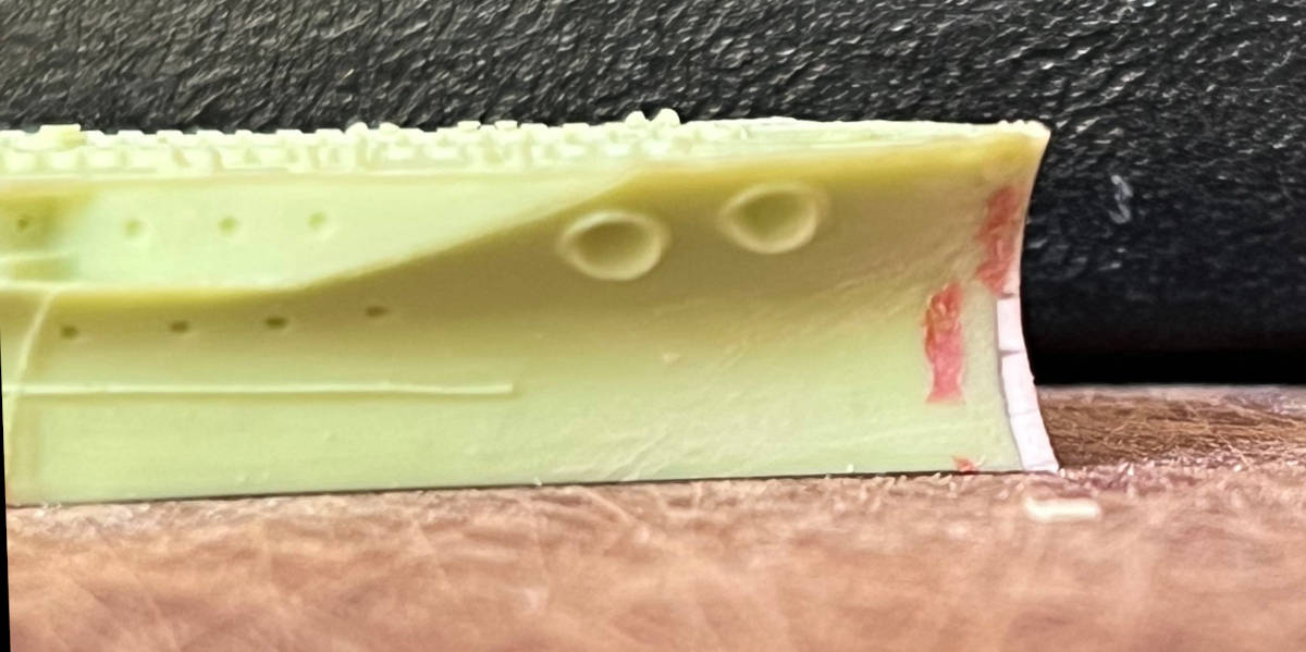

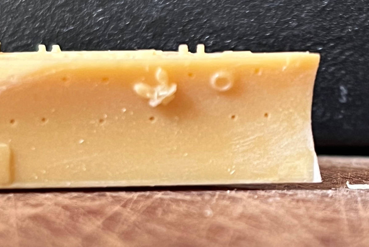

Hello:
I've finished adjusting the bow profiles for Arizona, Nevada, and Oklahoma.
For Nevada (or maybe it's Oklahoma) there was either a casting flaw or the tip of the bow broke off, so I filed the area flat and glued on a bit of sheet plastic with a liberal amount of superglue. Once that set, I filed it down, using drill bits like pin gauges to get the right depth to the curve.
Arizona needed a lot more help. I glued on bits of sheet plastic, slathered it in superglue, then slathered that in putty. A bunch of filing later and we have the final bow as seen here. I similarly used drill bits to get the right depth to the curve.
Mike

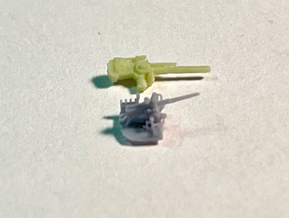

Just got an order in from Blackcat Models. First, I'm quite jealous of the name, as I have a wonderful black cat myself. Second, their 5"/25 guns are fantastic. I dared to remove one of them from the print raft, to compare with the resin part. I suspect that the resin part was near the limit of what could be cast at the time. Technology has come a long way since then.
Mike
