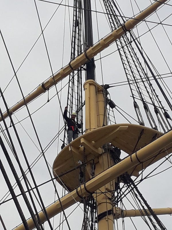

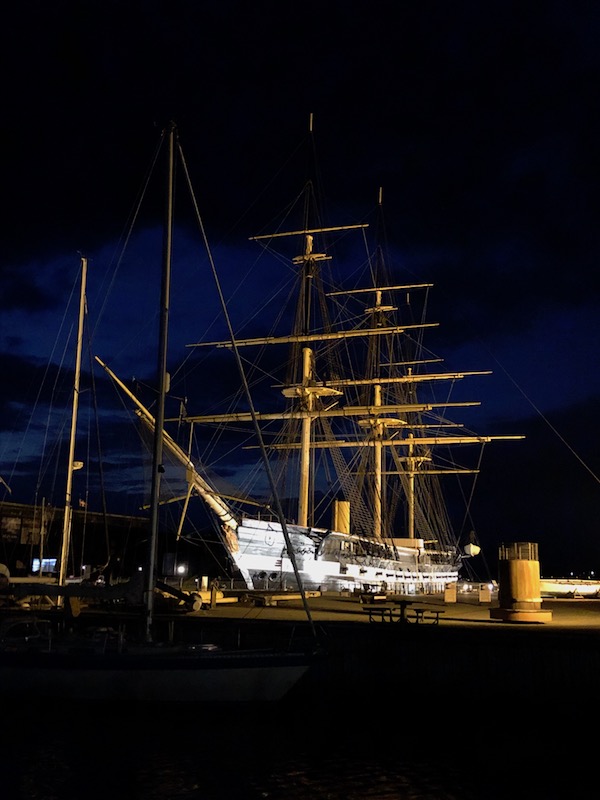

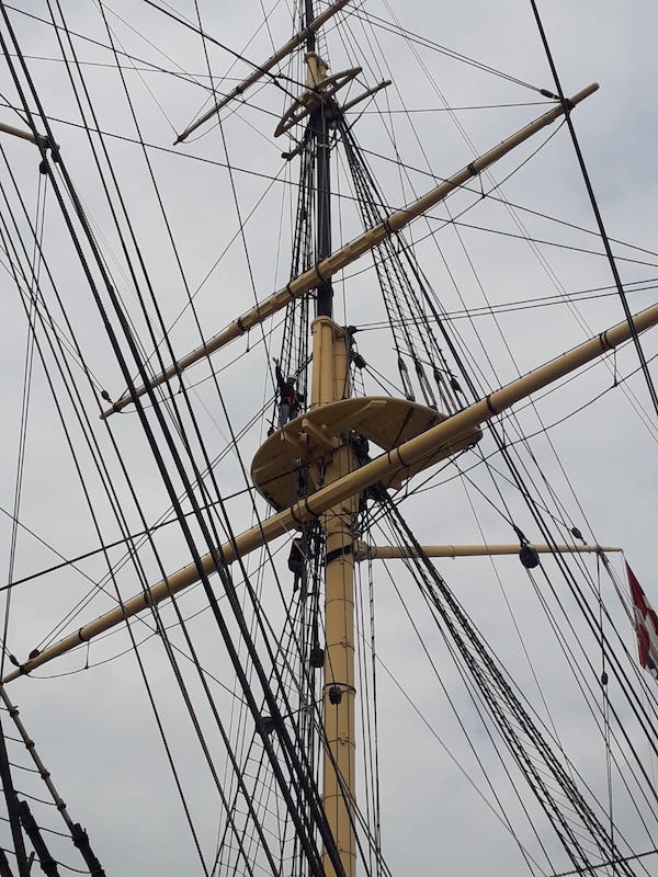

PostPosted: Wed Aug 10, 2022 4:24 am
Posts: 975
Location: Ludwigsburg/Germany
Small sign of life from Denmark: Frigate Jylland :-)
XXXDAn
To Victory and beyond ...
PostPosted: Thu Aug 11, 2022 3:01 am
Posts: 2625
That looks like fun! :thumbs_up_1: :thumbs_up_1: :thumbs_up_1:
