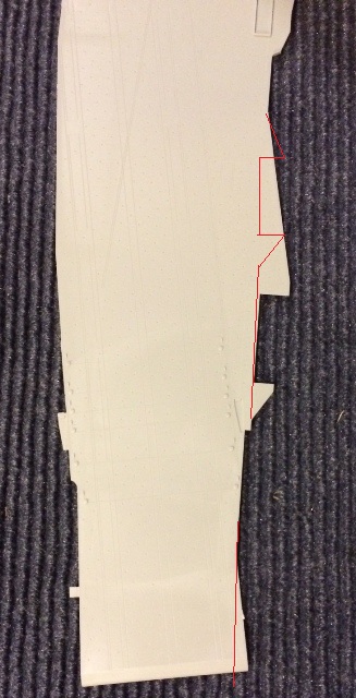

I was able to grab an hour at the workbench this evening; so after unboxing the main components I did some dry fitting and assessing some of the conversion work to be done.
I believe I've found a set of Floating Drydock plans for Bon Homme Richard that will illustrate the major changes I need to make. As I understand it, Lexington, BHR, & Shangri-La are fairly similar to one another with respect to the SCB changes.
Dry fitting reveals excellent fit so far, and the detail is fantastic! I did some minor cleanup work on the hull, and removed the subtle locating marks for the dual gun tubs on the fantail, as well as the raised outlines for the Intrepid's hull number on the superstructure.
I don't anticipate doing too much more until I get the plans & PE sets.
Thanks for looking-
Jonah
File comment: Preliminary planning of the changes to the flight deck based on moving the #3 elevator forward and removing part of the aft starboard edge of the flight deck.

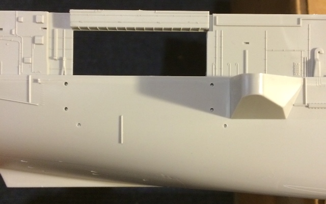

File comment: This illustrates the portion of the upper island that I just don't see in photos of the Lex, so I anticipate removing the forward section
File comment: Elevator & crane sponson will swap places
