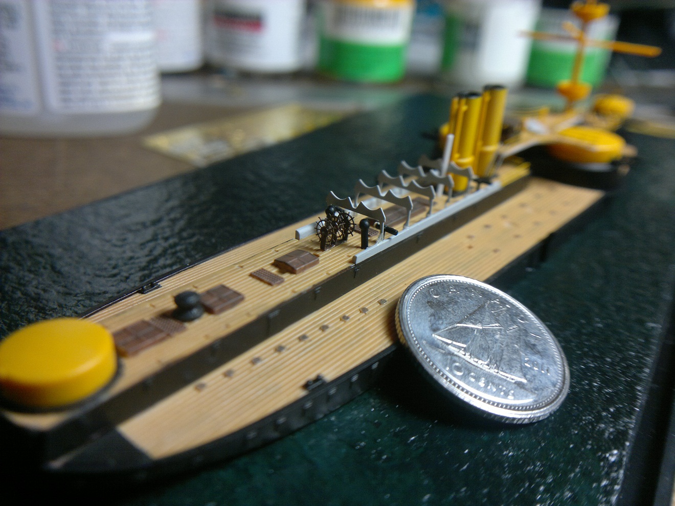

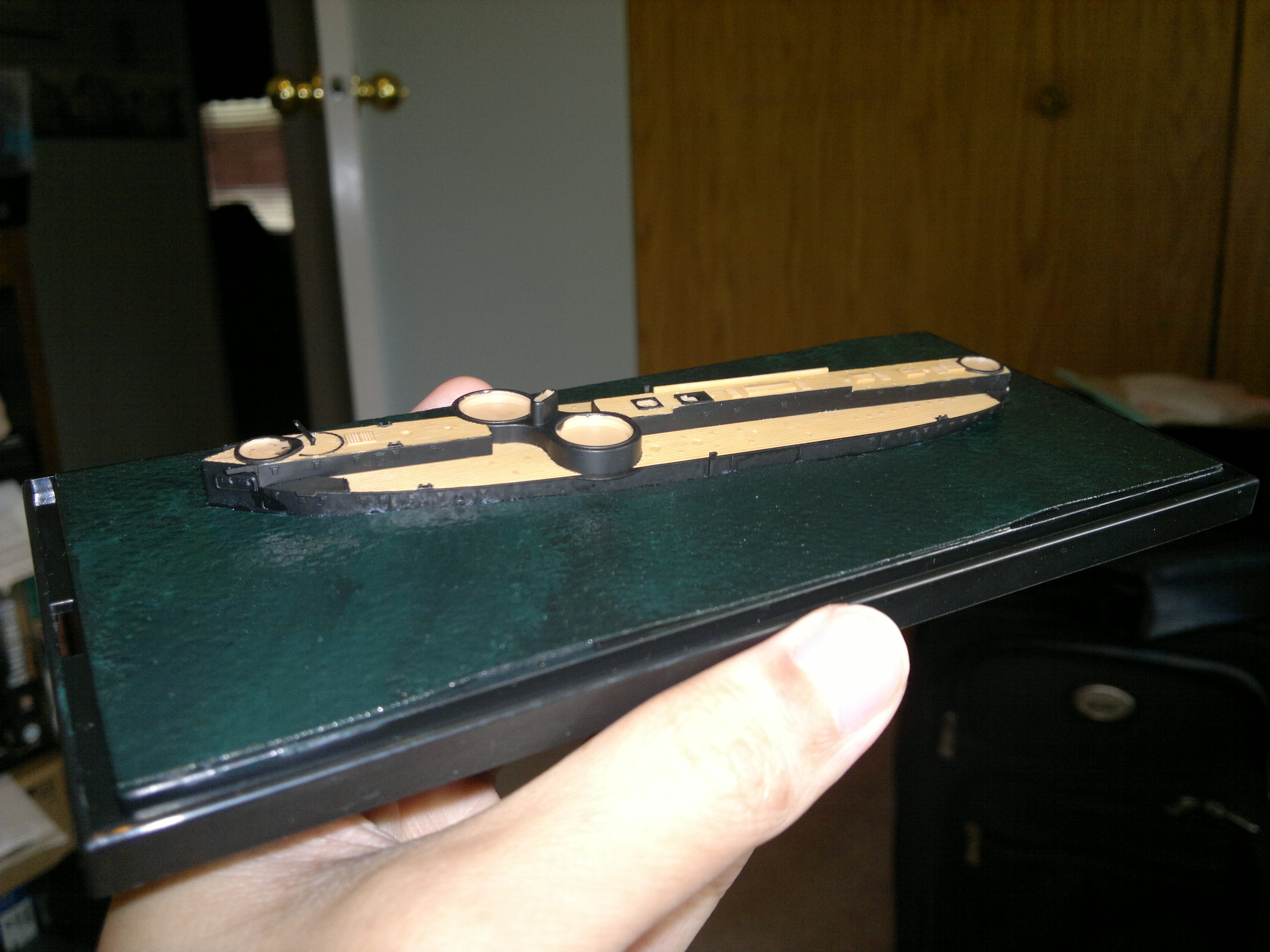

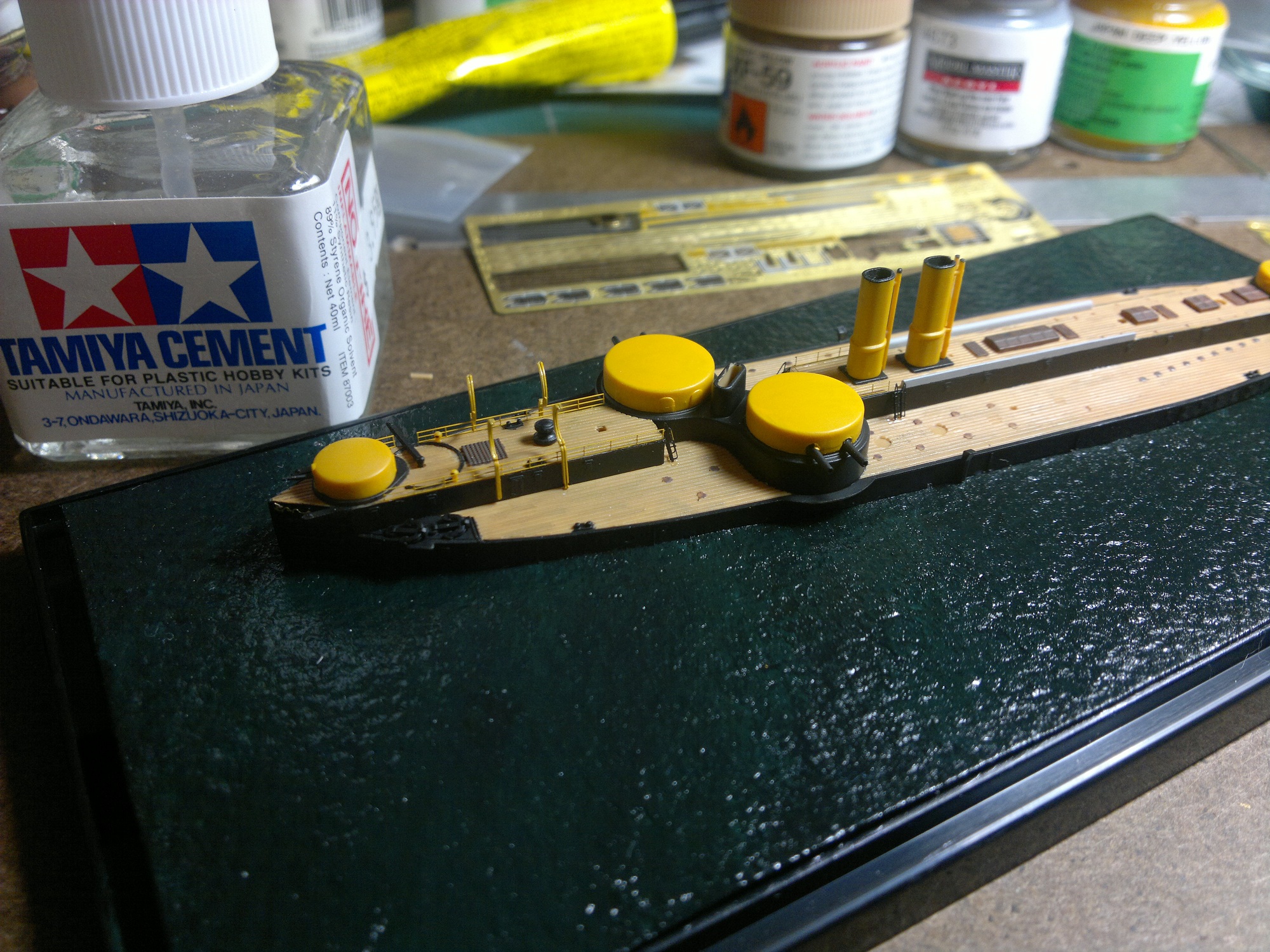

After the intense journey involving much research and scratchbuilding that was the HMCS Chambly corvette, I decided to relax with a kit that looks to be well-researched and complete - a straight OOB endeavour.
Here's how she looks right now:
This is also my attempt at making a deep green water. I only wish that the different shades I put in the water would be more evident without needing to use flash.

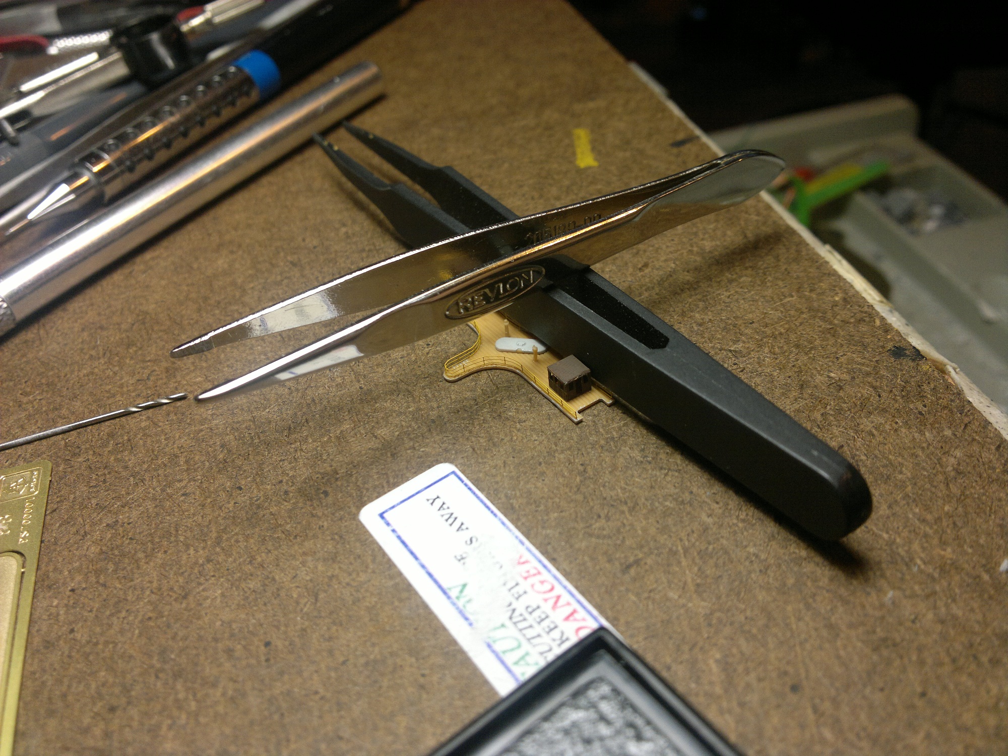

The littlest dragons you ever did see (they're separate PE parts):

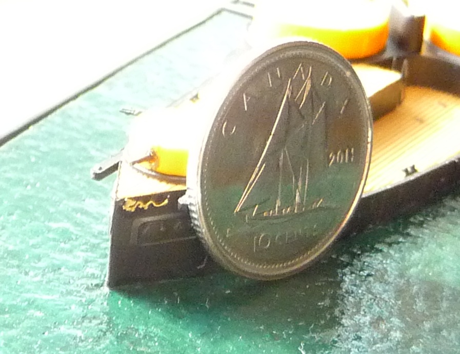

Latest update - finished putting on/together the bow fittings and flying deck. The compound curves for the flying deck railings were very challenging - 30 minutes spent on each side before they would fit!
One of the drawbacks to the kit is that the anchor hawse openings are moulded with the covers closed, making it impossible to accurately depict anchor chains without scraping off the covers. If I had noticed this earlier, I would have done so, but alas, it is too late.

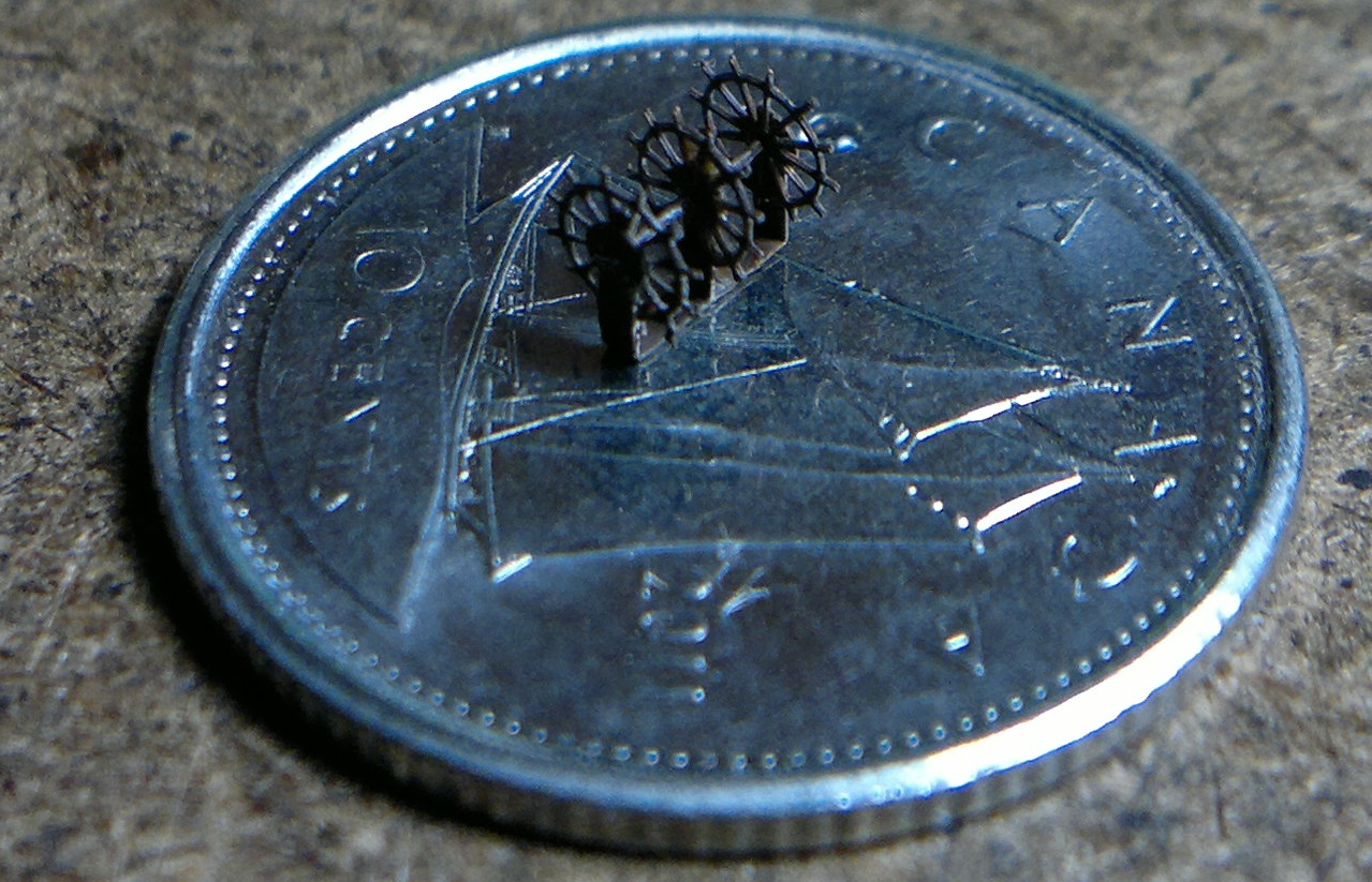

Today, spent two hours putting together the ship's wheel. Ended up being 7 parts in total, since I had to cut the axle in half due to the hole in the middle set of wheel+post being clogged with glue.
Being built.
Being built.
Completed.
Completed.

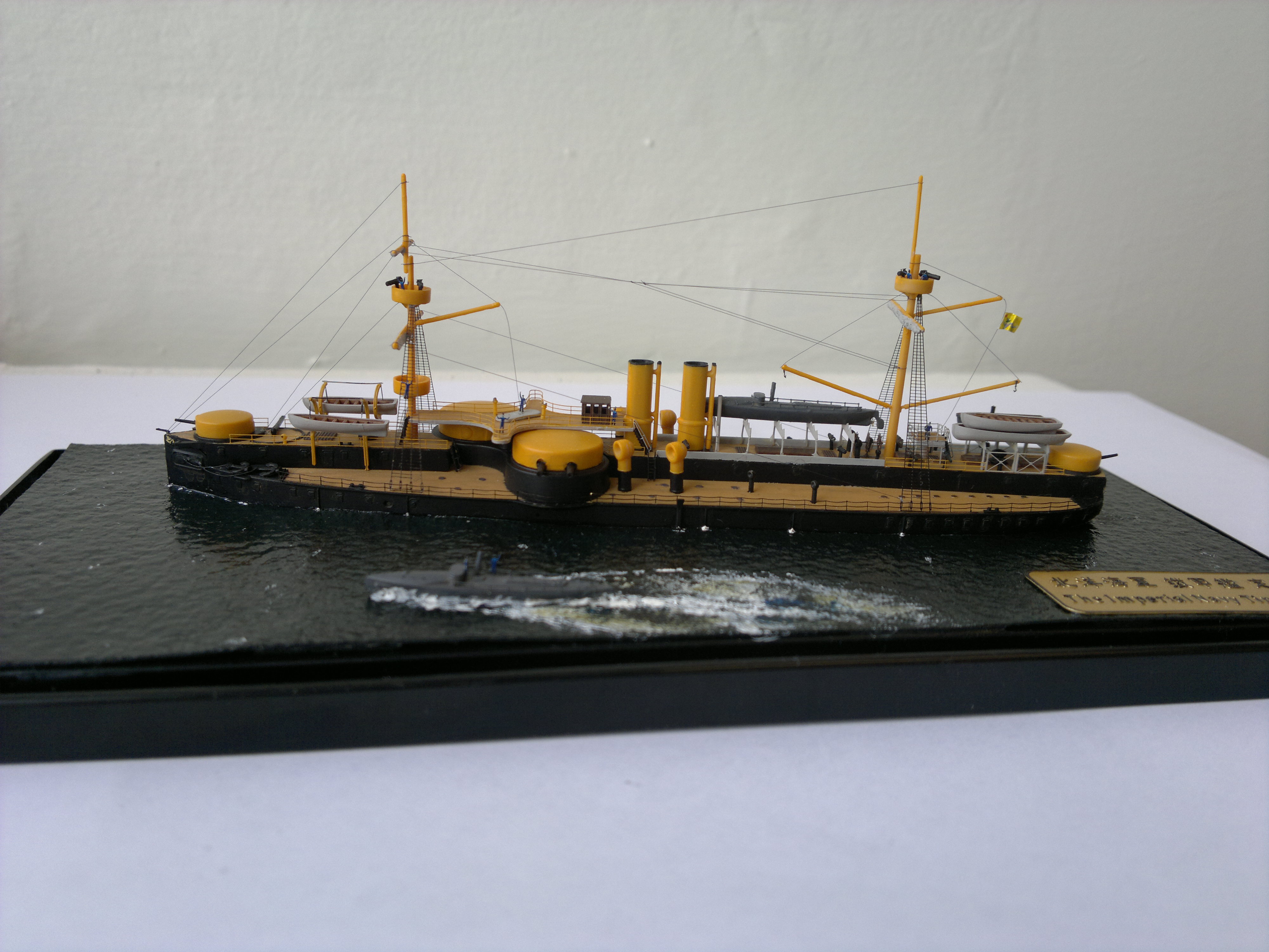

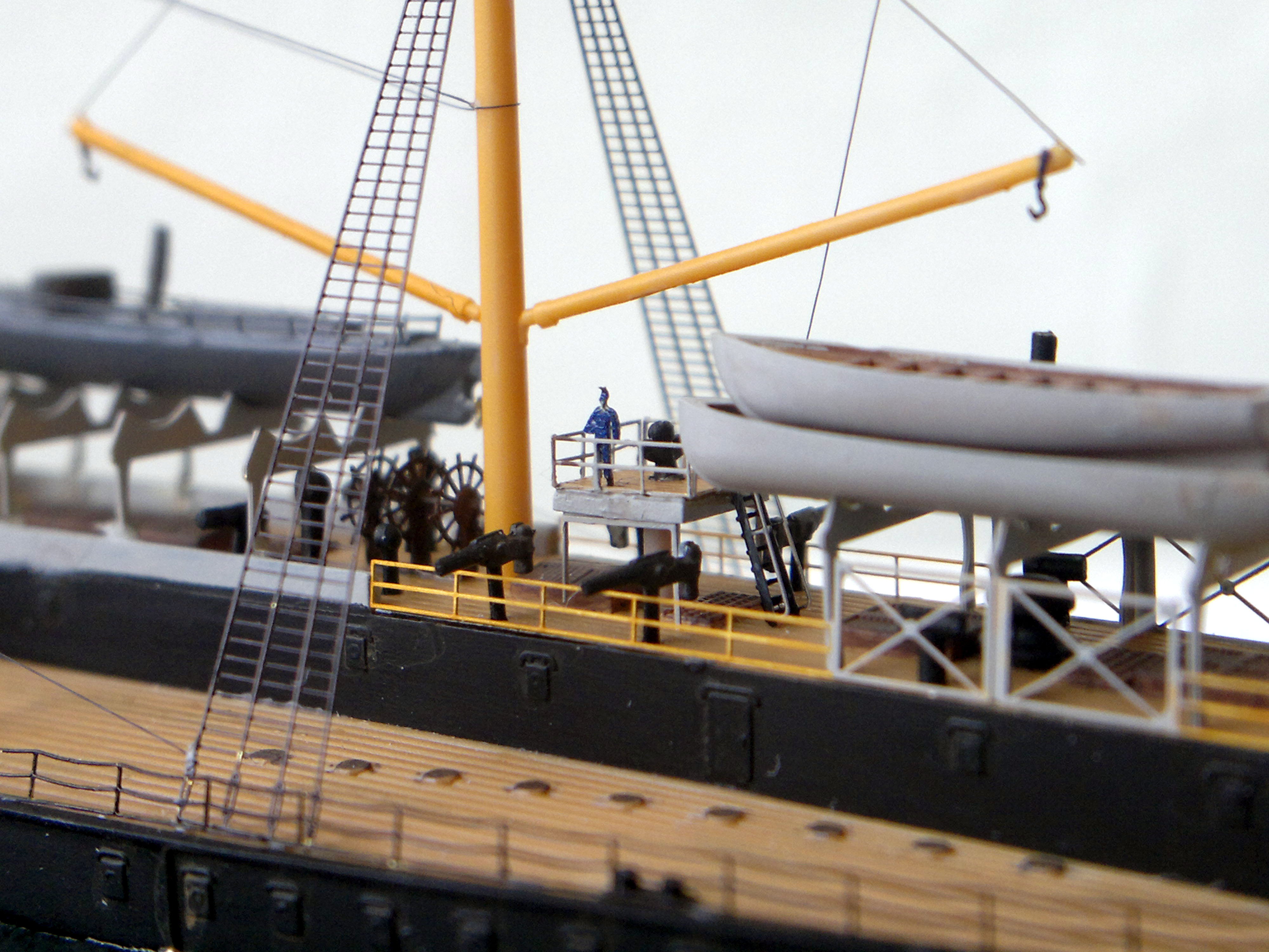

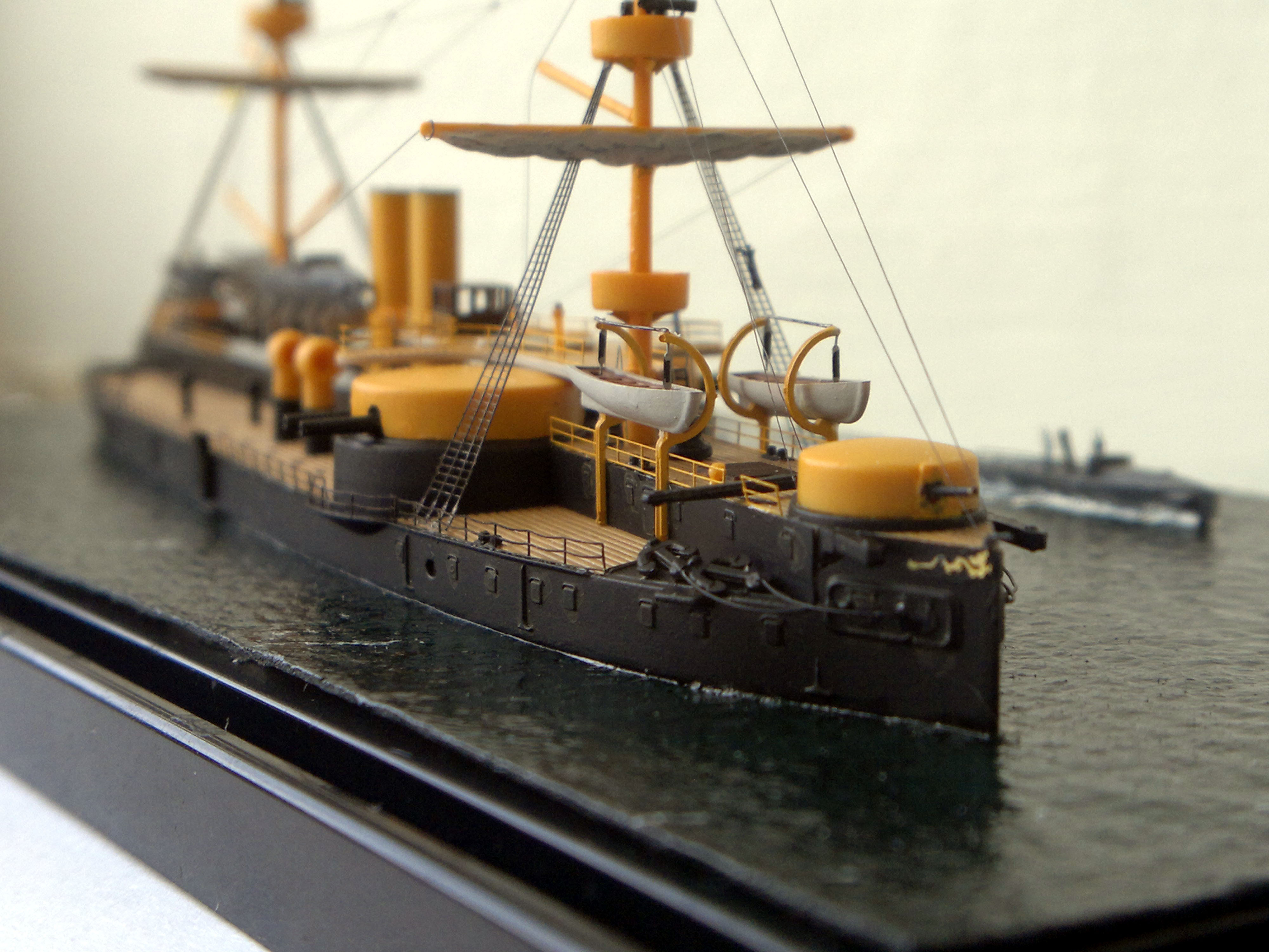

Well, here she is in her completed glory - could've done more/better, but time constraints, lack of good resources for detailing and rigging, and the desire to just get on with it got in the way.
Sails made with white glue filling the spaces in the PE footropes.
