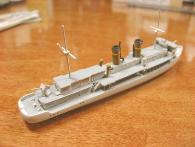

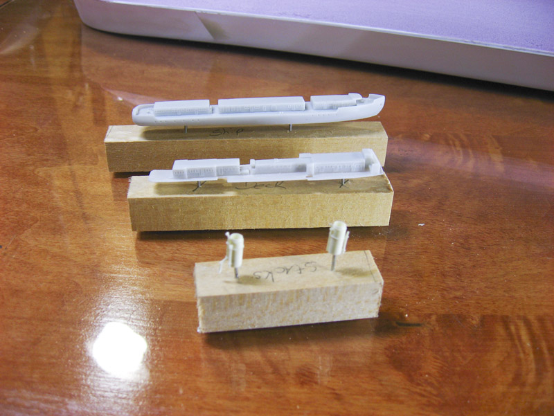

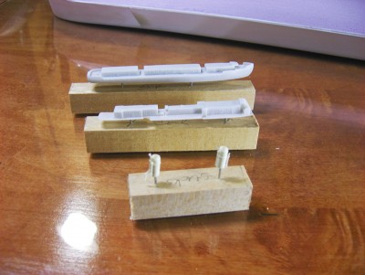

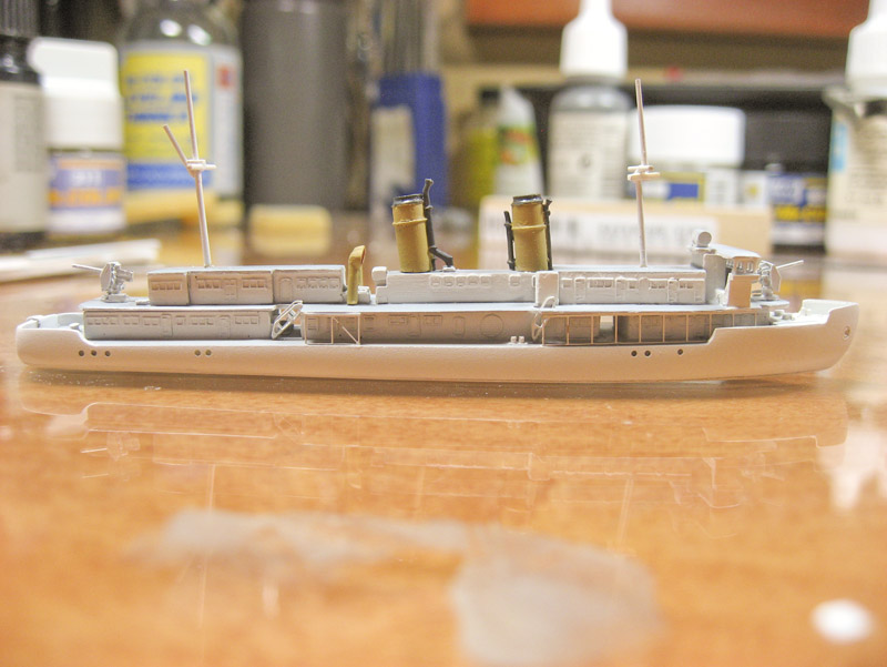

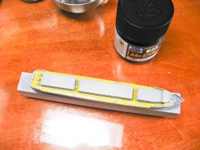

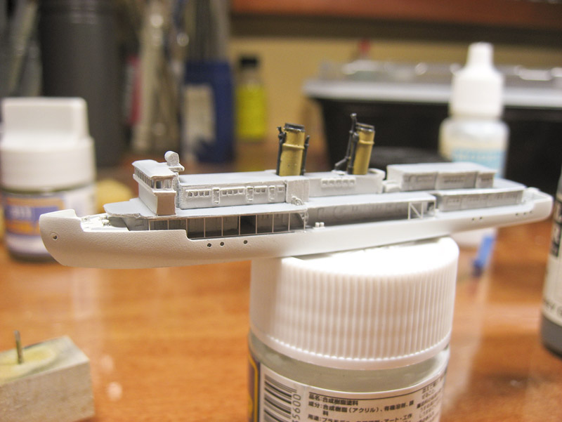

Because I don't have enough projects going on (currently 4 underway, 2 of which are ships), I thought I'd add a thread on the Niko USS Luzon. This is the first 1/700 kit I have built in over 20 years. Man, this thing is tiny!

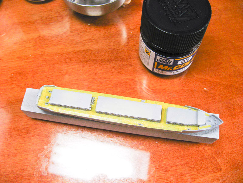

Out of the box this looks to be a really nice kit, but upon closer inspection there are some issues. The copy I have is rough in places, the decks in particular had a lot of scratch marks, sure signs of sanding the master with a coarse file or sandpaper, but not following up to sand them smooth. The sides of the superstructure have some roughness as well, but it's mostly passable as long as you aren't looking at it though a magnifier or through macro digital photography. I primed, puttied and sanded every deck at least three times to get rid of the scratches. Another issue is that while the main hull seems fine, the upper superstructure and the stacks do not want to hold paint. I've cleaned them with Bleech White and straight lacquer, and still masking tape pulls away the paint and primer.
The captions on the photos tell the story so far.

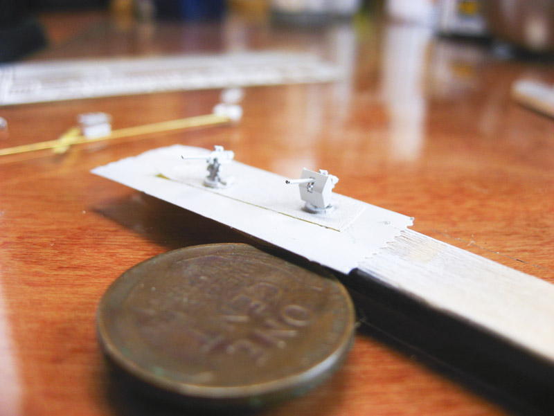

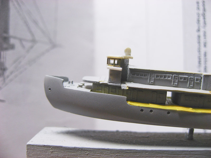

- The 3" gun mounts are quite nice. The consist of a base with the upright trunnions, the gun itself, and the shield, which is bent from PE (surprisingly easy to do). One of the mounts had the barrel broken and the base cracked, so I replaced the barrel with wire, and punched a disk out of styrene to replace the base.
- Upper deck glued on, stackes attached. I had to paint the black piping on the stacks free hand (since I can't mask), but I think they look okay with the naked eye. Here you can see the portholes, which I had to fill and re-drill in a straight line (fairly common on a resin kit). I need to work on the anchor hawse pipe on this side, the starboard one looks much better.

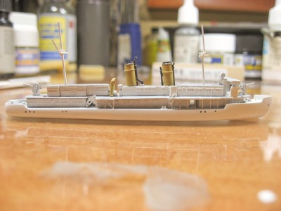

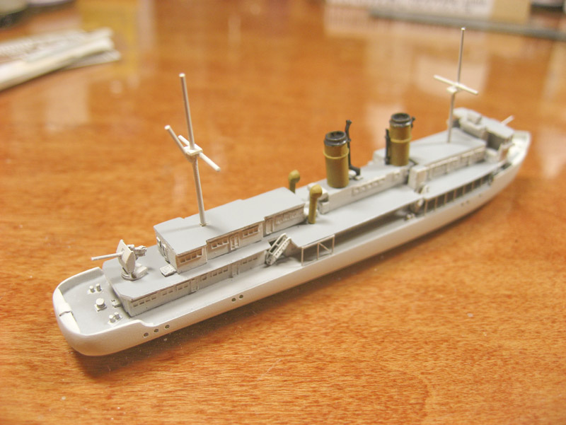

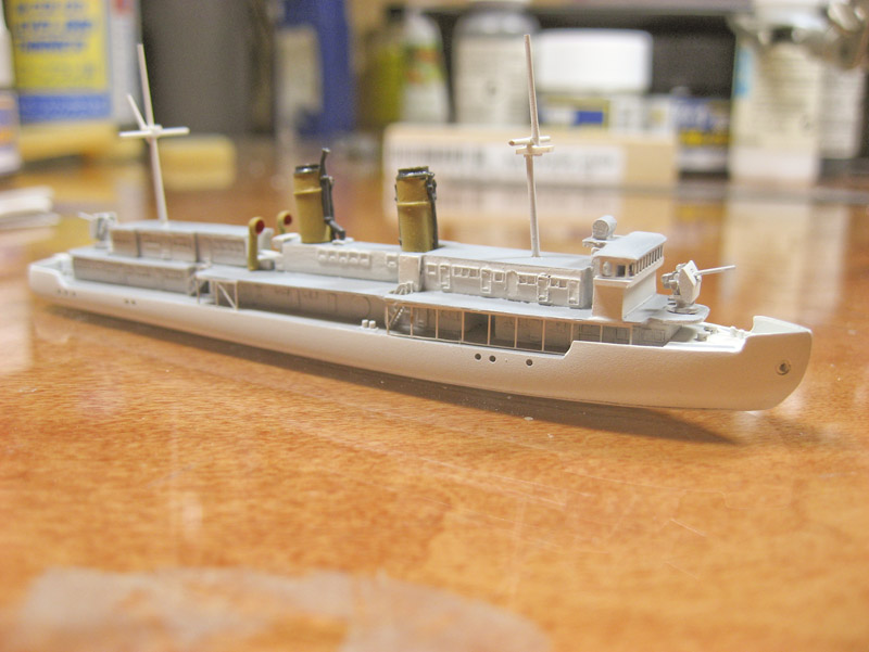

I've made a little more progress. I have to admit that when I started working on the masts I thought I was done with this build. Holy crap what a pain working with these tiny tapered brass wires. I cheated a bit on the forward mast and put in a lookout platform as extra bonding surface for the two vertical brass pieces and the cross member. The after mast I made from a single piece of wire, I'm done dealing with making two-piece vertical assemblies until I get a resistive soldering setup!
Also added are the 3" gun mounts, and the ventilators. There are a few more items, such as searchlights and ammo lockers to add, and then I'll gloss coat everything so I can do a wash on the portholes and doors on the superstructure. I want to do that before I put on the railings, boats, davits and machine guns, as it'll be too tight with all of that on the decks to get a brush in there without snapping a ton of stuff off.
- The rake of the masts is pretty much spot-on. The trick is to not obsess with them being the exact same angle as they appear in photos, but to get one of them so that it looks close, and then match the other exactly. Also, always look at ships with multiple masts from directly forward, as that's the first thing a judge will look at in competition: they need to be exactly in line and perfectly vertical.

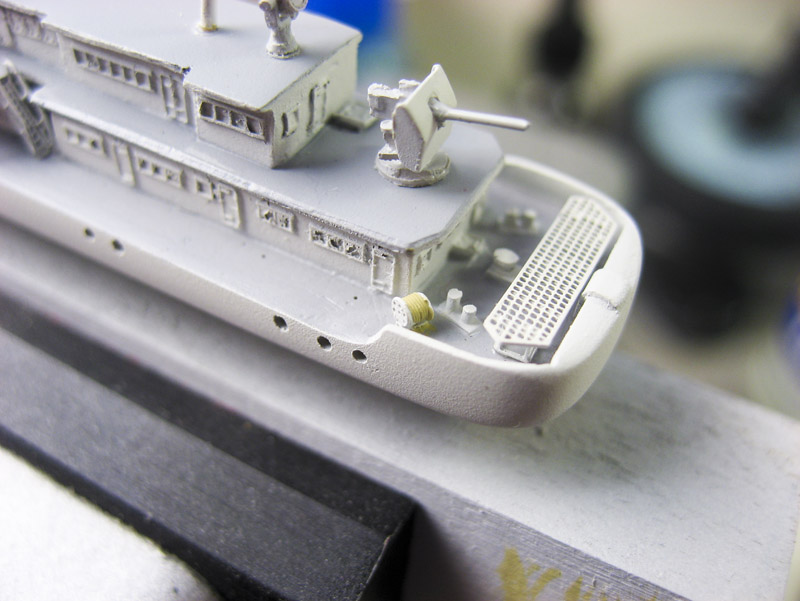

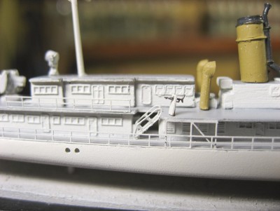

I've slowed down a bit on this build. Started a new job late last week, so the learning curve is taking a lot of time, even though it's a work-from-home position.
Basically all that I've accomplished is a little paint touch-up here and there, and a couple of small items added. There's this screen roofing bit that goes on the stern. Not sure what it is. I also added the line spool and painted the "rope" a tan color. The spool has a little shape issue on the inboard side, as you can see, but it's passable. I have a GMM 1/700 PE set with these things in stainless steel, but I spent a half-hour to an hour trying to assemble even one of the things, and it was beyond my patience level and it just wasn't any fun.
Looking at this photo I can see how bad the superstructure windows look. Oy. It looks like maybe I can score/clean them with a fine needle, though, before I do a wash to darken them.

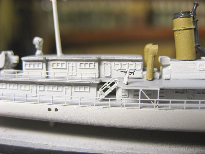

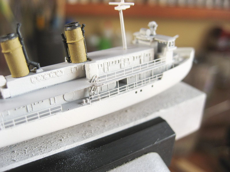

I'm at the PE railing part. Man, do I HATE doing railings in 1/700! I have to admit, though, that I haven't put PE on anything this small in over 25 years, so there was definitely a learning curve. I initally started with really long runs and using CA glue (things I know not to do even in 1/350th or 1/200th scale), but have started making more cuts in the rails and am using Gator Glue to attach the. I've also started on the base, using Jim Bauman's method from the Tips section of this board. I didn't get the swells very well (rhyme!), but that's because the paper I bought is more of a cardboard. Next time I'll go thinner.

Excellent work so far Devin. I don't know if you're coming to the meeting tomorrow, but I'd like to see that base so I can try it myself one day! As far as the windows go, you might want to scrape them off an use some 1/400 PE ladders to replace them?

Railings looking good.

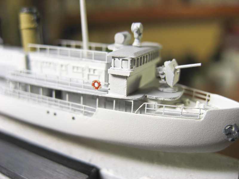

A couple more photos. I've finished with the railings, also added the anchor cables, as well as life rings (not sure they should be orange, but I wanted some color) and the machine gun positions.
She's ready for gloss coat (I'm holding off on the davits and boats until after gloss coating), and then weathering and rigging. I'm also trying to scrounge up a few figures to put on her; I know I have a set of them around here somewhere.

Looks nice! You going to paint the windows?

I'm going to go heavy on the wash with the ship laid on its side for the windows. The full sized one shows the frames the same color as the superstructure, fortunately.
