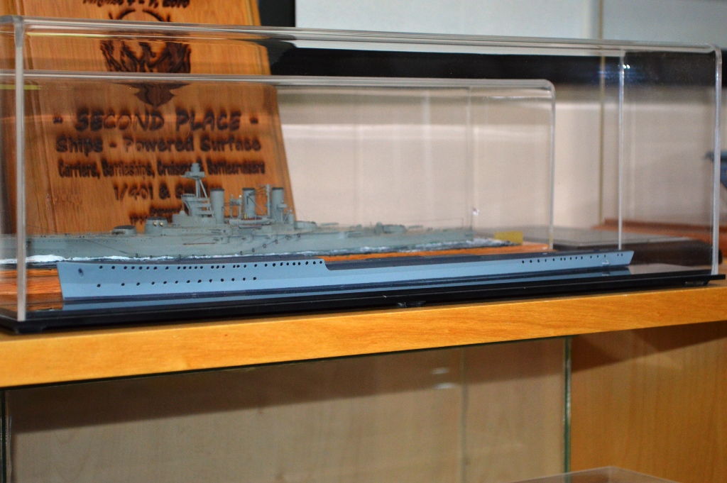

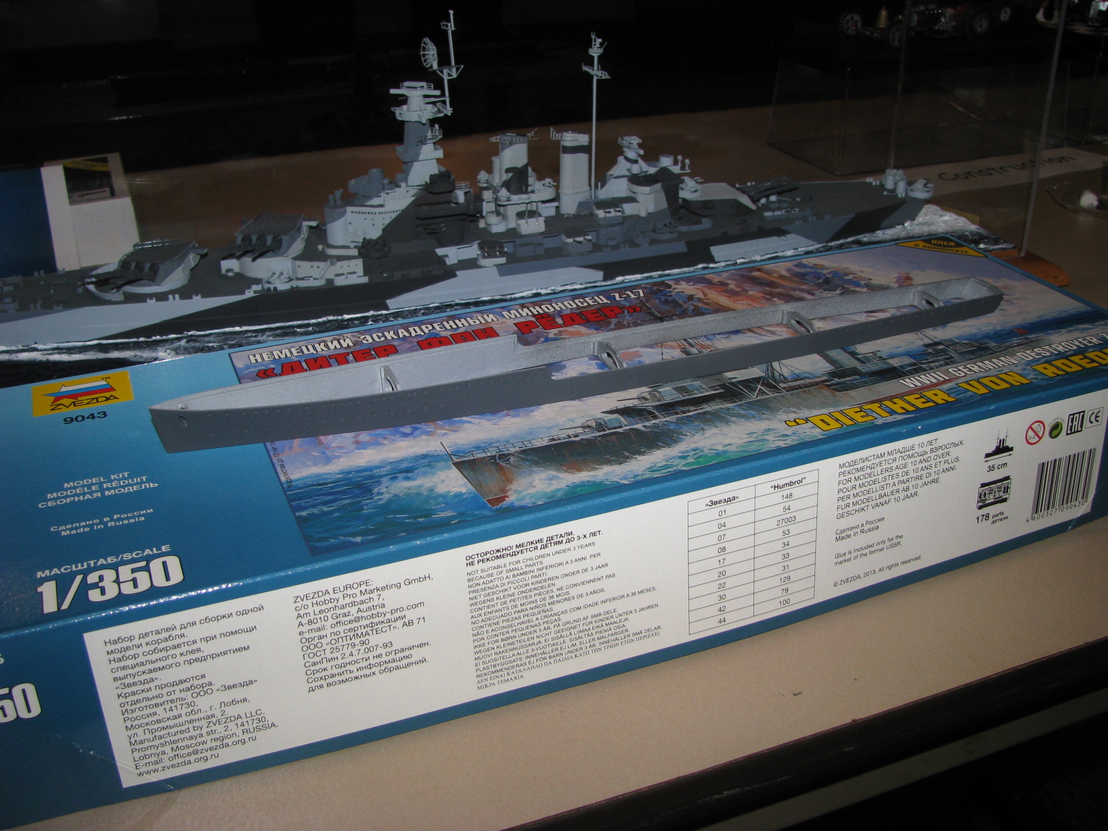

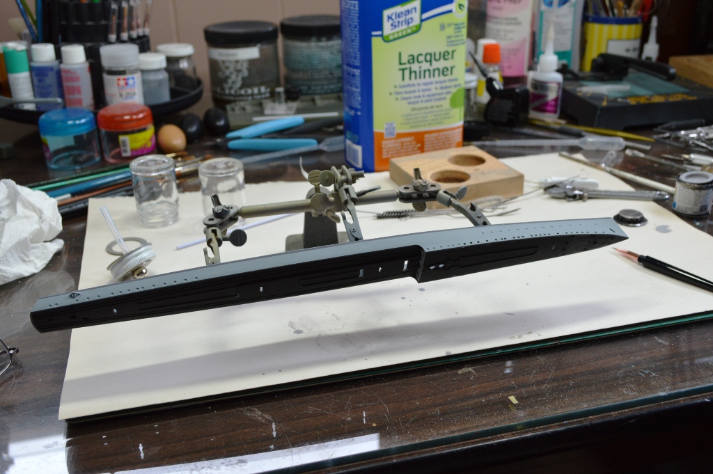

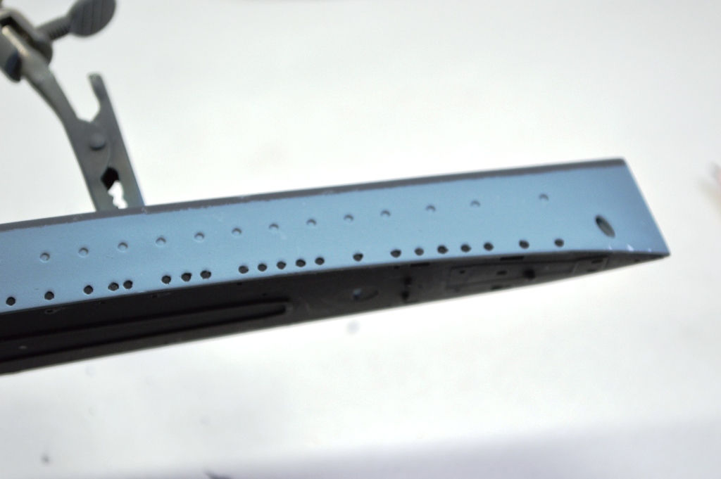

With North Carolina finally finished, onto the next project. With a workshop littered with more hulls than Puget Sound in her heyday, the hardest part was to actually pick the next project. Since our local IPMS club is having a Tin Can group build this year (that was my idea), I figured that would be the best kit to tackle next.
I've previously reviewed the Z-17, and had done some work on it, but just none in the last two months.
After I first got her, I started by water lining the hull, then painting the hull black, as to make sure those big ass portholes were covered with paint.
File comment: The hull painted black

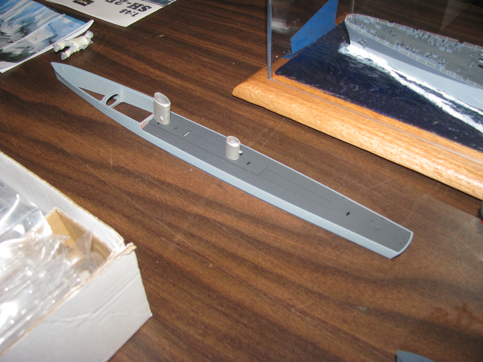

After masking the boot and painting the hull, I painted and then added the aft main deck. Which gave me a little bit of trouble, but it finally snapped into place. I also assembled, puttied and sanded the funnels, then painted the funnel tops aluminum.
File comment: Funnels are just sitting on the hull

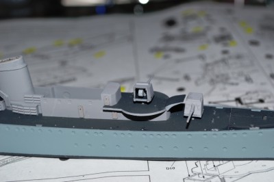

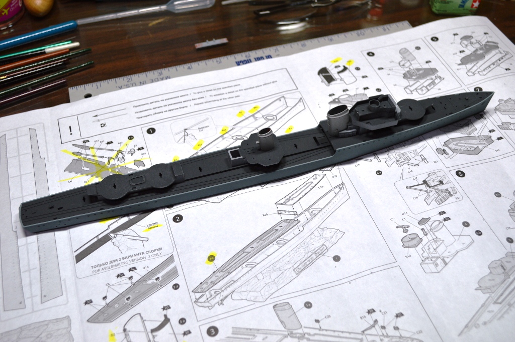

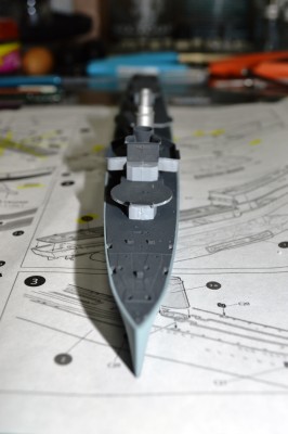

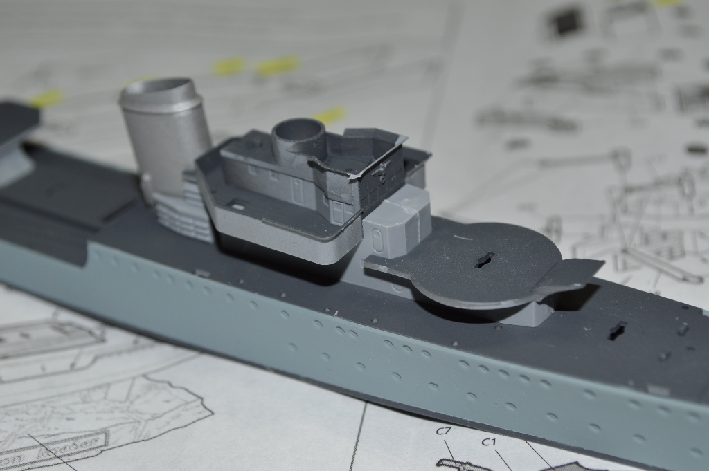

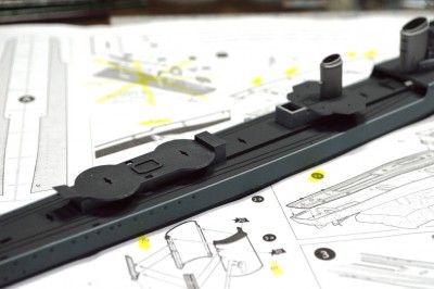

And that is how she stayed until last night. I started assembling some of the superstructure components, getting them ready to paint, then dry fitted what I had done together. I also removed the Aztec stairs as I went along.

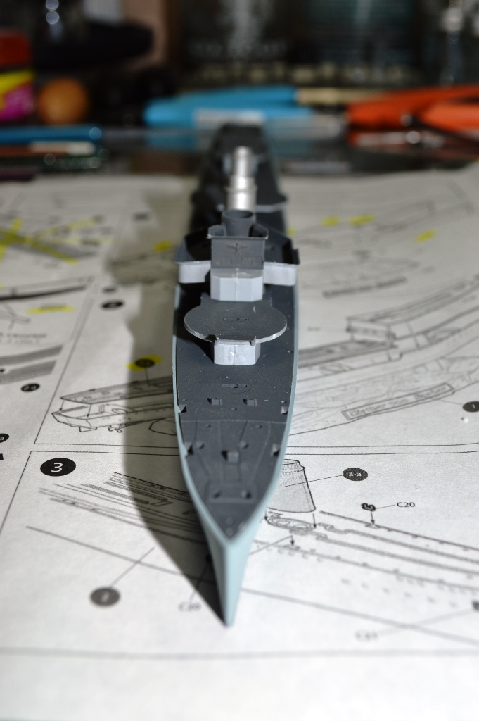

File comment: Can't find a good bow on photo to see if the bridge wings really curve like that.
The fit is pretty good - so far it doesn't seem like I will need too much filler, if at all.
I may have mentioned in the review that this kit cries out for a photo-etch set. I have the Eduard set for the Trumpeter Z-25, but that appears to be custom fit for that kit, so I'm hesitant to use it for this kit. I may just get some generic Kriegsmarine doors, ladders and railings and go from there.

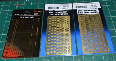

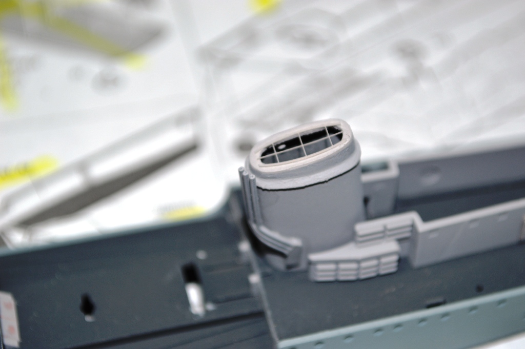

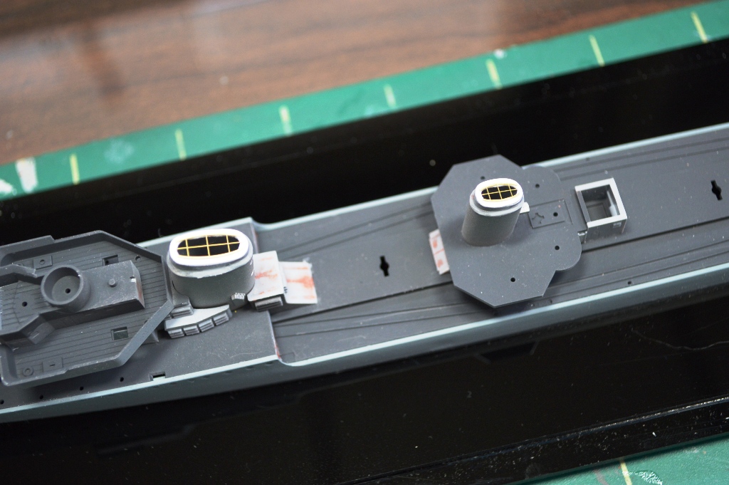

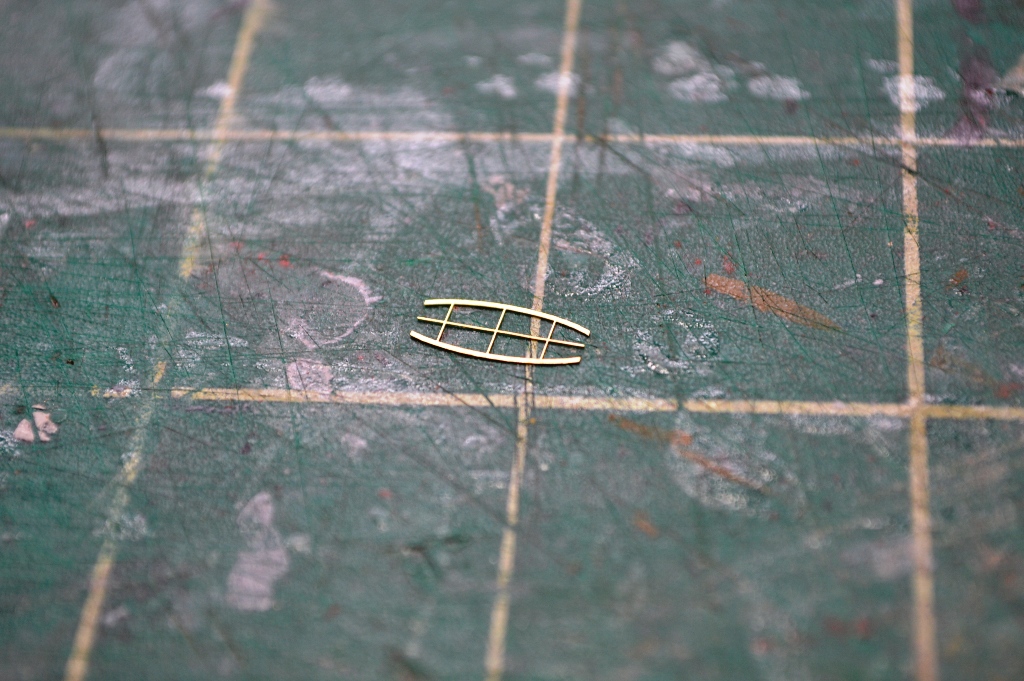

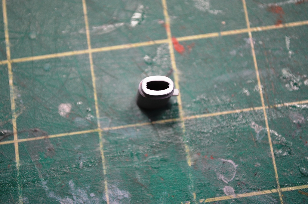

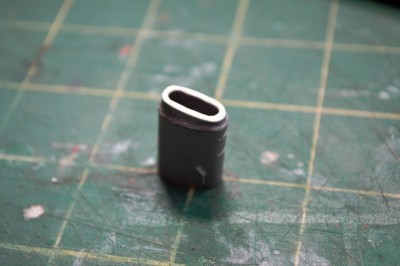

So I went ahead and ordered some German railings, doors and hatches and inclined ladders from Free Time Hobbies. According to the tracking info, it will probably get here Monday. In the meantime, I started doing some more work on the funnels. The Trumpeter PE funnel grates are narrower and a little longer than the Z-17 funnels, so I wasn't going to use them. Instead, I started making my own out of plastic card. Then, after I got the plastic card onto the funnels and roughed out the openings, I realized I could now use the Trump PE, if I didn't make the openings too wide. So, that is what I did.
File comment: Opening in the forward funnel roughed out

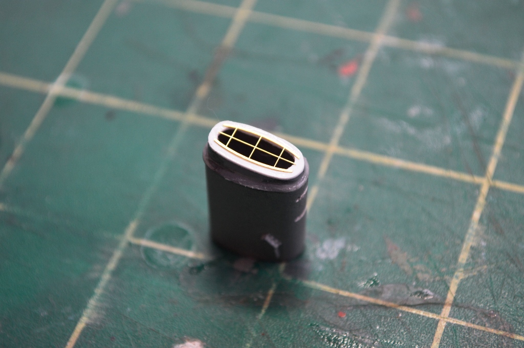

File comment: The Trumpeter PE funnel caps. The ends are snipped for it to fit on the Zvezda funnel.

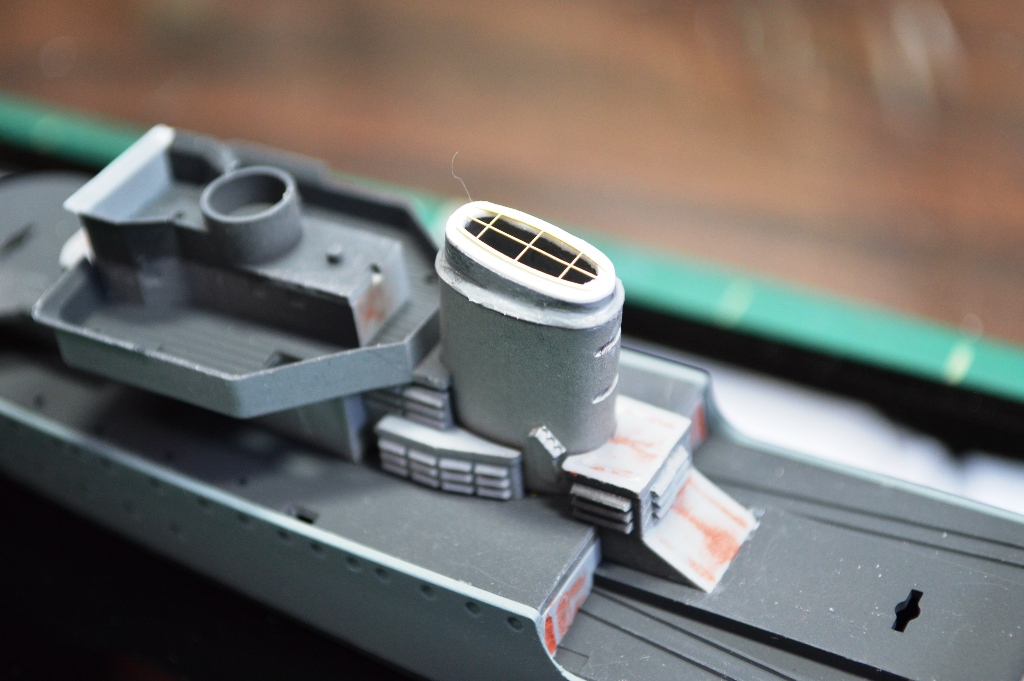

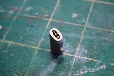

File comment: Trump PE on the modified Zvezda funnel

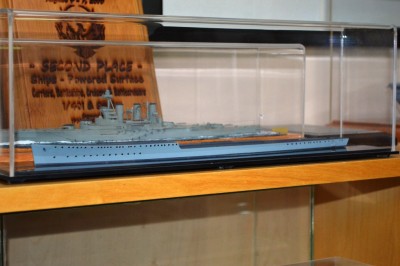

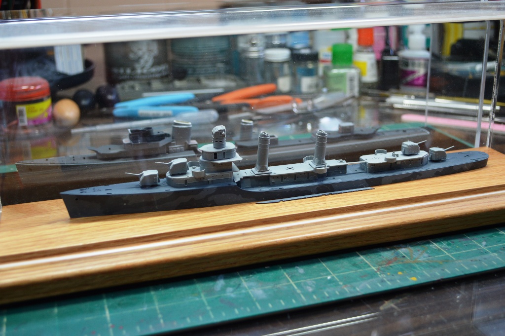

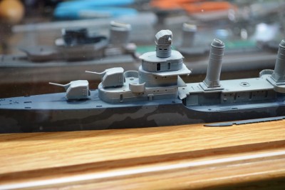

File comment: Z-17 in her new case
Other than some painting, that is about all I can do while waiting on the photo-etch to arrive. While I wait, I may do some more work on this other tin can that I started...

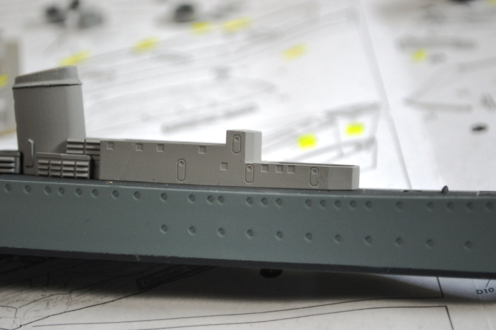

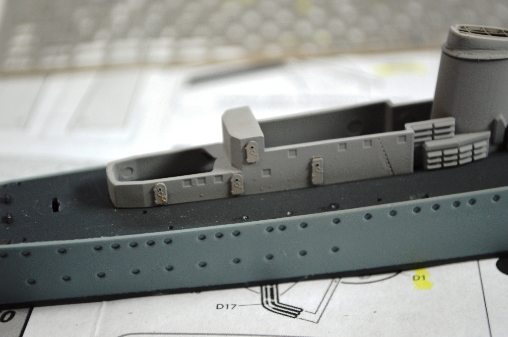

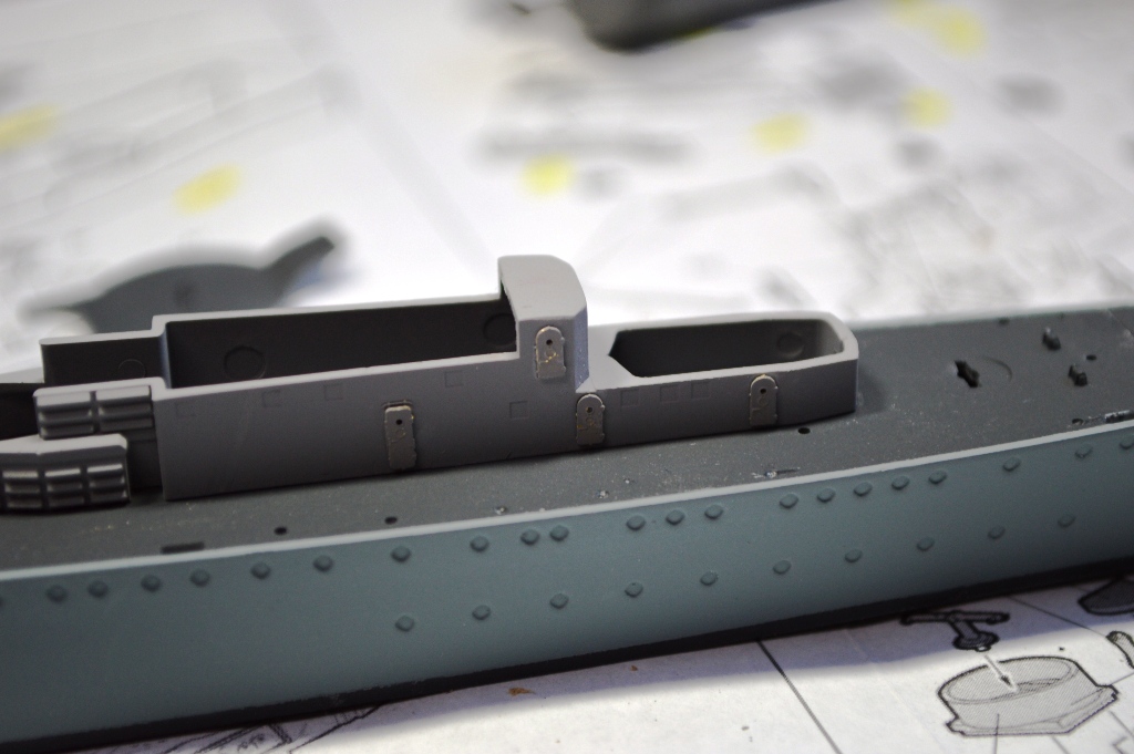

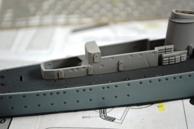

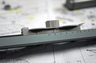

More progress was made over the weekend. I started adding the photo-etch doors from Lion Roar set:
File comment: Before photo-etch doors
File comment: The aforementioned doors...
File comment: After...
And then the other side (which I did first, but neglected to take photos of until I was done).

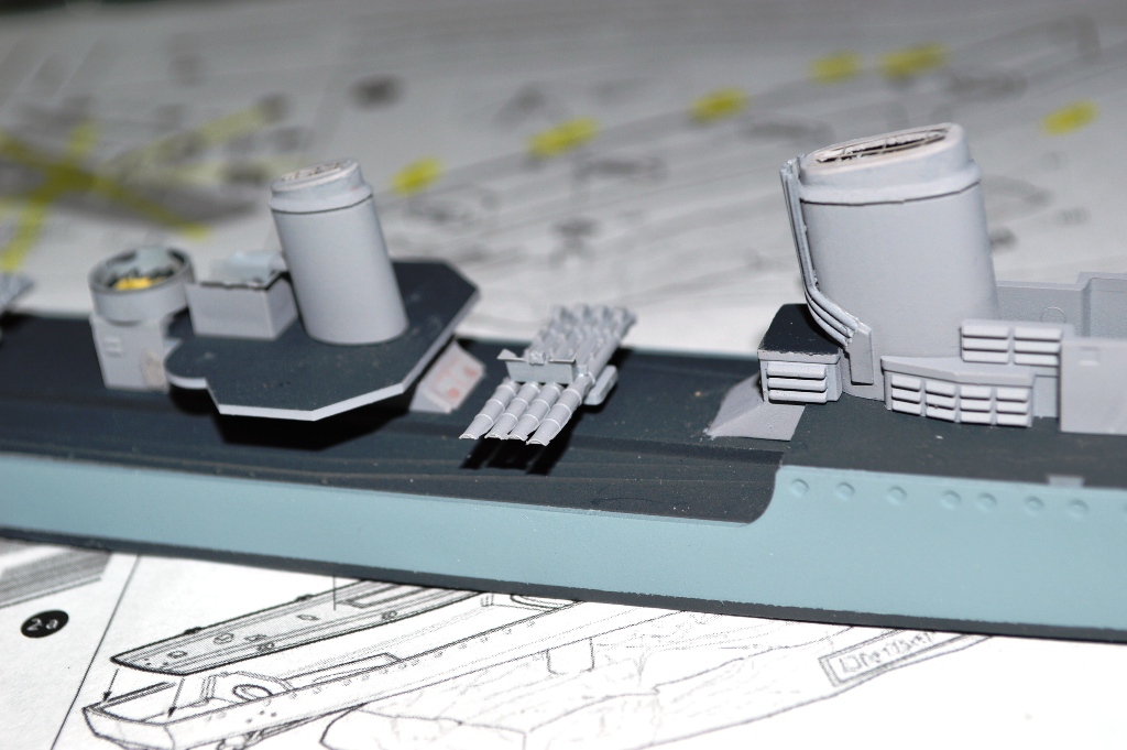

With the doors (mostly) on (realized I forgot two afterwards), I added the piping to the funnel, but first drilled out the tops...

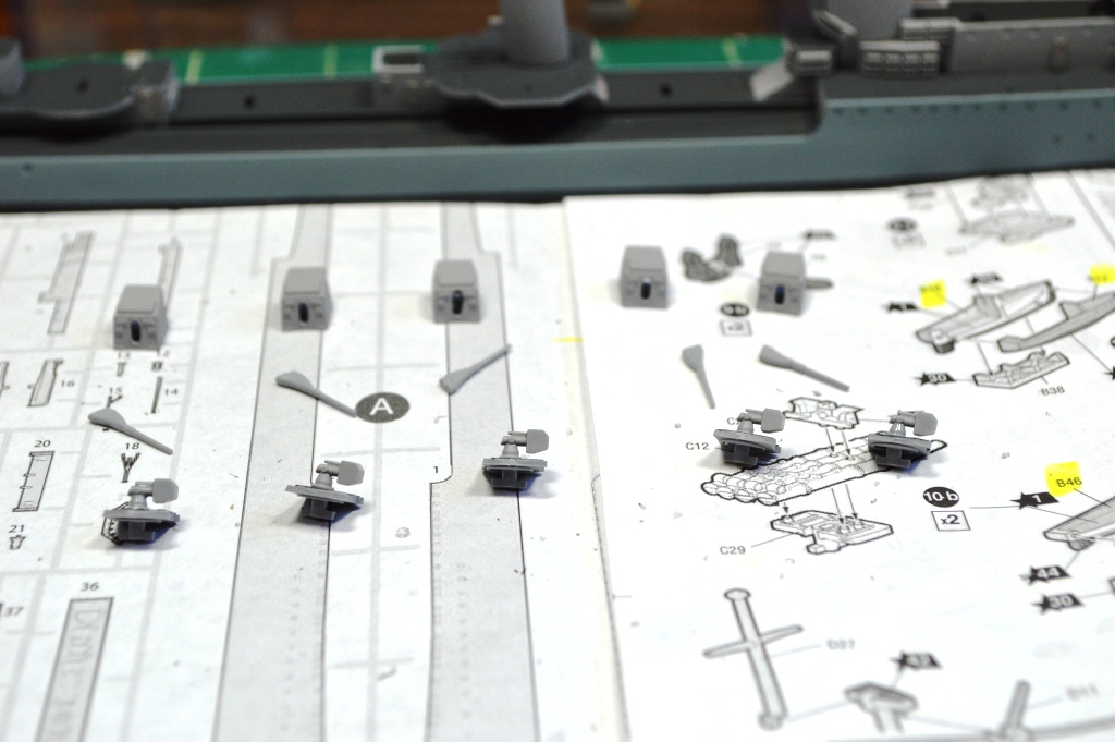

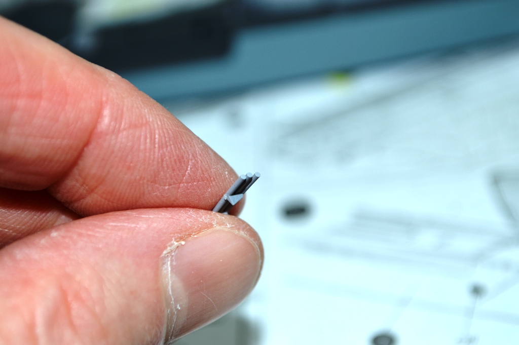

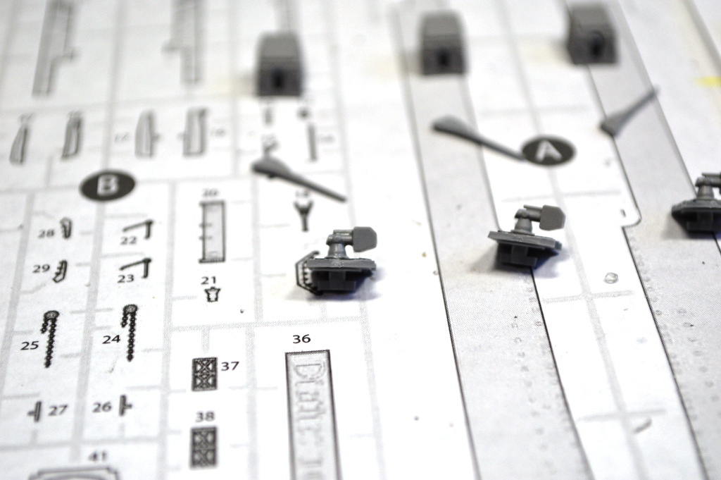

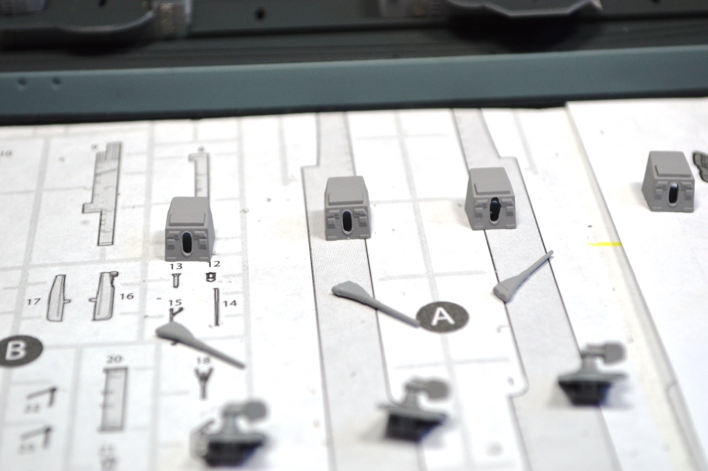

While that dried, I started assembling the main armament:
File comment: Not much detail on the gun mounts
When these were dry, I glued the shields to the bases and the gun barrels to the shields. Just haven't taken any photos yet.
Overall, it's a pretty decent model. Goes together without much fuss.

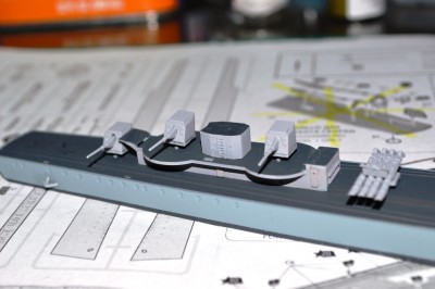

I neglected to mention that I also assembled the torpedo launchers.
Here are few more photos I just snapped of where she is at as of tonight:
File comment: Main battery armament
File comment: Torpedo launcher
I'm going to keep working on her until I leave for the IPMS/USA National convention next week, my goal is to finish her for our local IPMS September meeting, which is when our "Tin Can Sailor" group builds are supposed to be done.

Looking good, Martin. I like that the blast bags are molded on. Did you drill the little portholes in the PE hatches?
stash:
1/350 Grosser Kurfurst by ICM
1/350 Seydlitz
PostPosted: Wed Jul 30, 2014 10:01 am
Posts: 8369
Thanks. Oh, gosh no. Those were there!

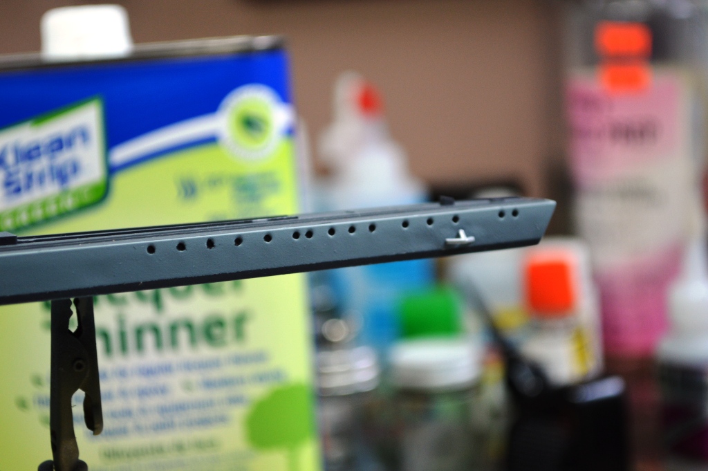

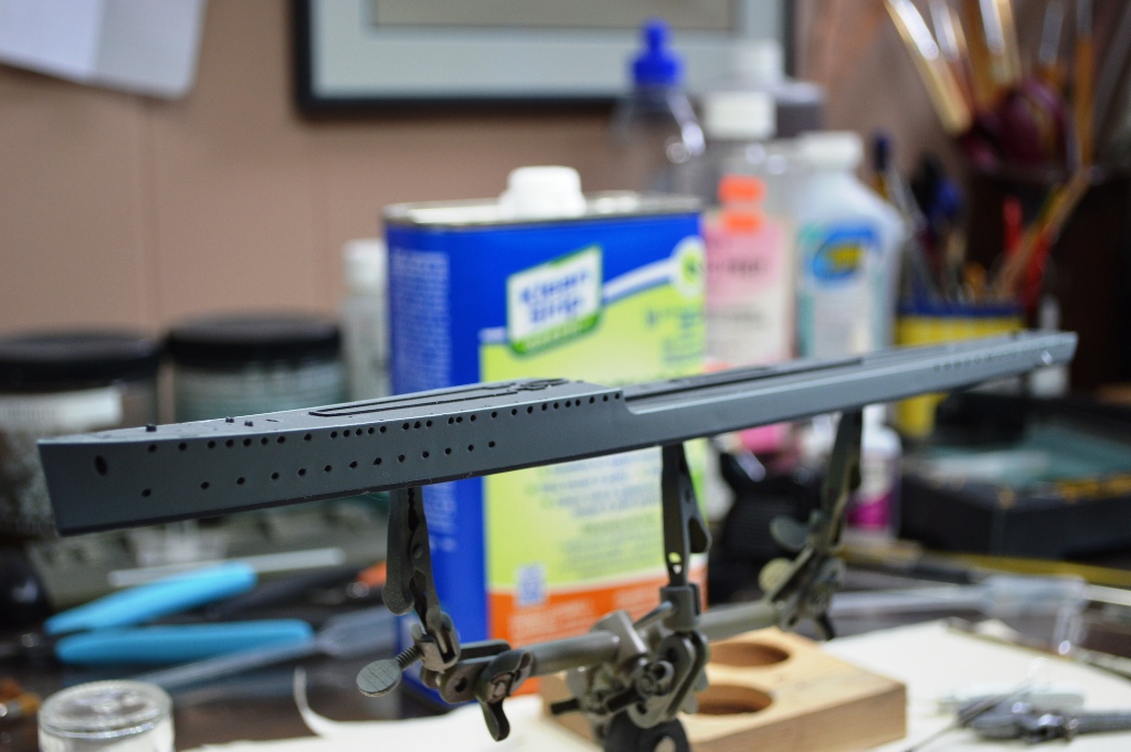

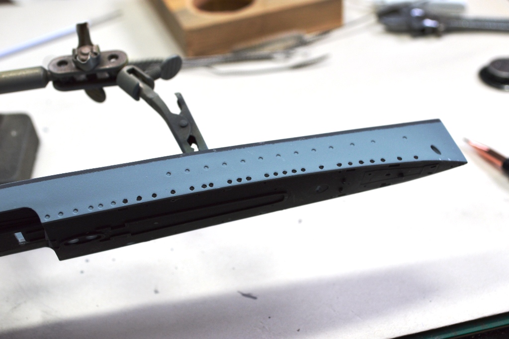

After airbrushing some parts Hellgrau 50, I decided to do something to those huge portholes. Photos show them to be dark, so I decided to paint them with a small brush.
That may be the last installment before the Nationals. I should probably pay some attention to the other people who live in my house the next two nights before I go!
