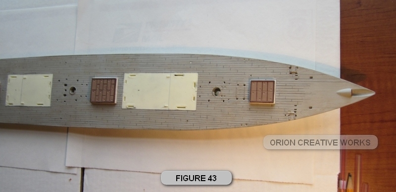

I'm digging into research and trying to learn something about this ship before I jump in... and there is a lot to learn.
I'm about 90% decided on hand-planking the deck with individual wood strips...it will be one hell of a job but huge monotonous projects which really add to the character of the boat don't scare me and are actually a bit stress releaving for me; I'm weird that way. It will also allow me to accurately recreate the gutters (what is the actual term for them?) along the deck edges which are absent from the kit as well as all the plank detail missing on the kit and give a better end result than a stick-on laser cut deck.
I'm studying old pictures of the Bismarck and it looks to me like the deck ISN'T random plank lengths but that the ends of the planks line up every fourth plank. Can anyone confirm or deny that? If so/not, what is the pattern of the planks?

with a model of that size I would definately take the time to hand plank the deck! :thumbs_up_1:
ps: gutters ... and every 4th is pretty standard so that is probably correct. (I think that comes from older habits of using 16' teak planks over the 4' spaced iron stringers (?) on the wood-hulled iron-framed sailing ships of the 1860's - 90's ... if thats what you call them??? :smallsmile: )

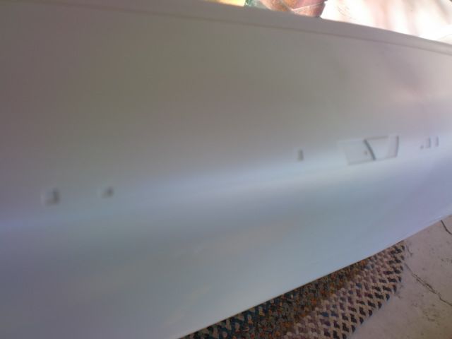

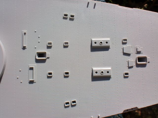

My ship has come in, so to speak:

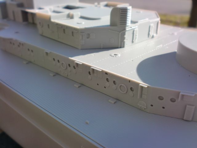

The detail is crisp and the quality otherwise very good, minus a couple of issues.

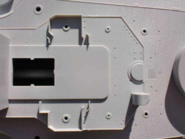

The first problem that struck me are the slightly cattywompus portholes on the angled pieces of the superstructure This is probably because Trumpeter molded the main deck pieces as 1-piece units and had to do them at an angle to to get them out of the molds. I plan on drilling them out and hopefully adding "glass" but it probably would have been better to mold them in pieces like most normal models.

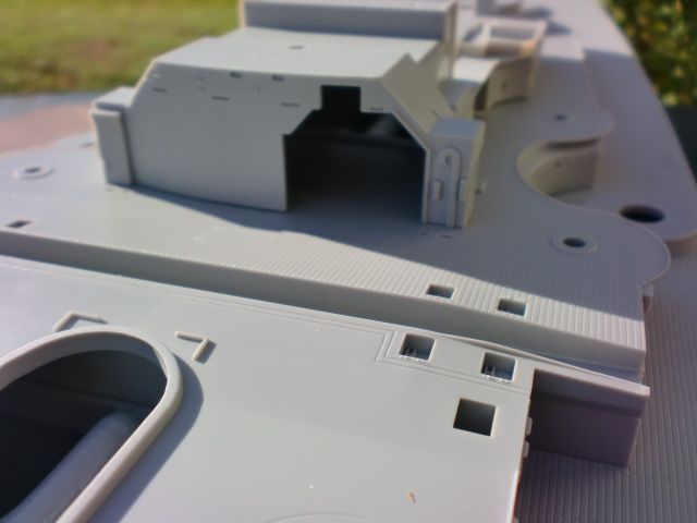

Second, the 1 piece hull doesn't mean no seams; Trumpeter molded the deck lines slightly off center on the mold seams right in the middle. The deck plank pattern is wrong too.
The hull itself is a bit rough too, and the portholes on the bow and stern suffer the same porthole problem as the superstructure.
I hate molded on detail because it usually looks toy-like and, well... molded on, but most of the detail actually looks pretty good otherwise. Only the circular steel window shields and molded horizontal lines meant to represent steel bar steps really look bad but I can't expect a model company to actually replicate them at this scale.

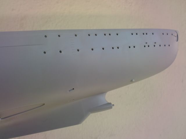

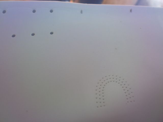

I have a question for the Bismark Experts. What in the world is this U-shaped set of holes?
It's on both sides toward the bow. Is it right?
-Jason Channell

Jon C Ryckert
Posts: 586
Re: The Big One... Trumpeter 1/200 Bismarck 1940 build
Post by Jon C Ryckert »
Channell wrote:Being poor didn't stop me... though maybe it should have! :big_grin:
I believe those are for a typre of sonar (passive?)that Bismarck carried. Check out some Bismarck websites on the web to get a better answer than I can give you.
boomstick68
Posts: 1091
Location: The Buckeye State
Post by boomstick68 »
I was wondering about these myself so I started doing research for my build. These are the GHG Sound Locator microphones.
And, Trumpeter appears to have them correct. :thumbs_up_1:
