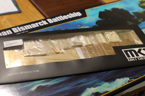

File comment: some of the awesome ref photo's for using the KA details
File comment: the KA models (MK1) deluxe bismarck set

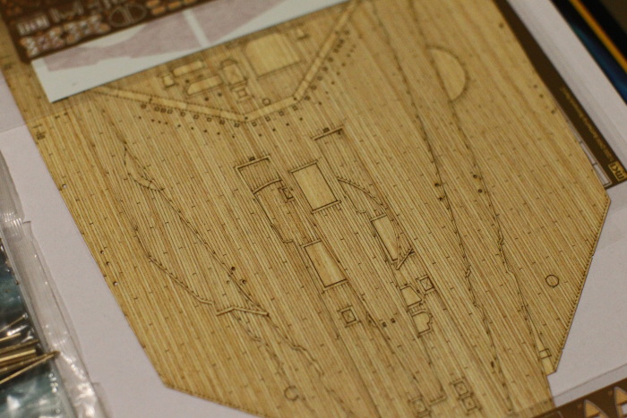

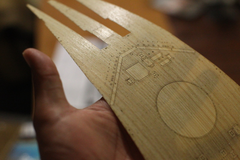

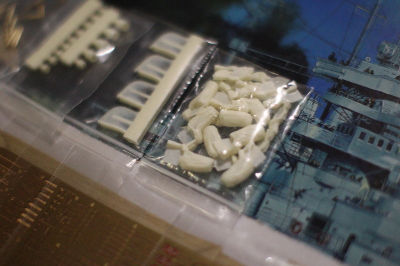

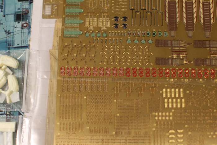

While not cheap I believe the KA deck and PE set are a must have for Bismarck. One thing which I noticed straight away is that the brass sheets feel like brass! While they don't look any thicker than the included trumpeter sheets - which are renowned for being flimsy as hell re- Arizona, these KA parts have a nice solid feel to them while keeping perfect scale. Time will tell I suppose.
I have to say though, I am disappointed with Trumpeter for one not including the sea ports on the bottom of the hull but more so for KA not including PE parts for the moulded in sea ports and those that aren't included on the kits hull.
File comment: resin blast bags, boat davits and vents
File comment: the wooden decks supplied have a self-adhesive on the back!! thank god for that
File comment: these decks are paper thin
File comment: some of the pre painted PE parts even include the life rings with Bismarck painted on them.

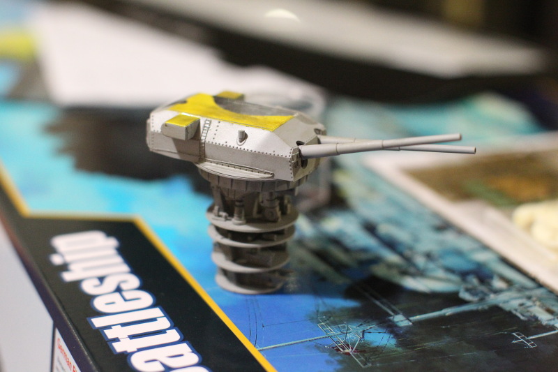

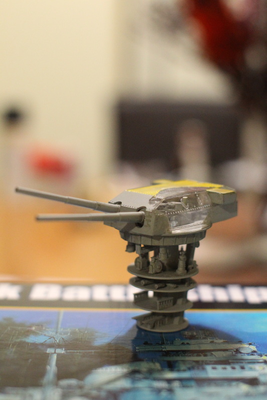

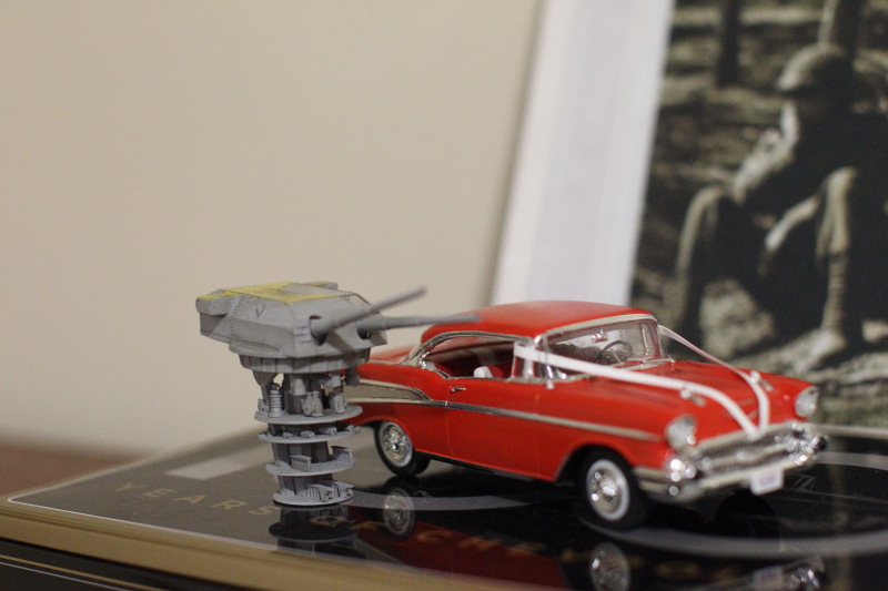

Oh I almost forgot, you do receive this cool extra main 38cm turret with internal structures. Could easily go to town on this also but just wanted to get my hands dirty so this mini kit was an arvo of fun. Now I will focus on the ship itself.
File comment: next to a 1/24 57 Chevy for size ref.

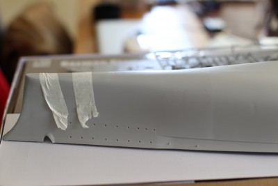

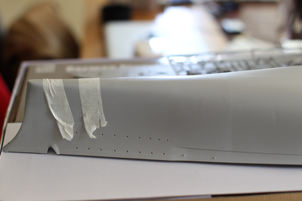

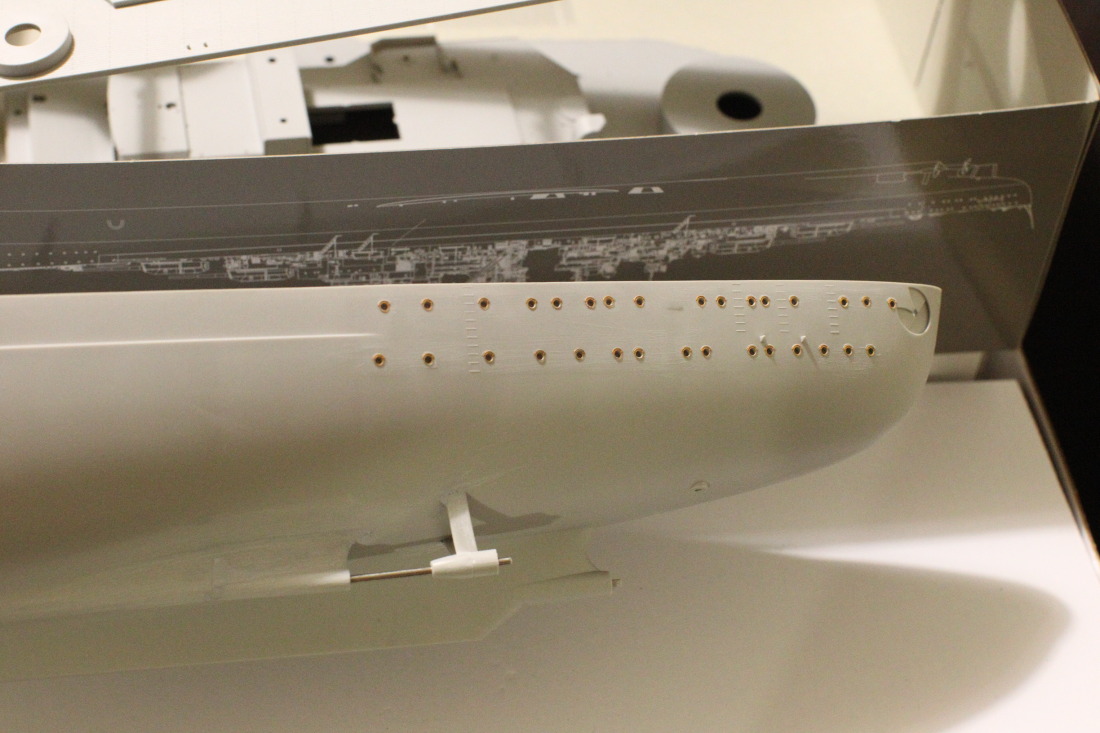

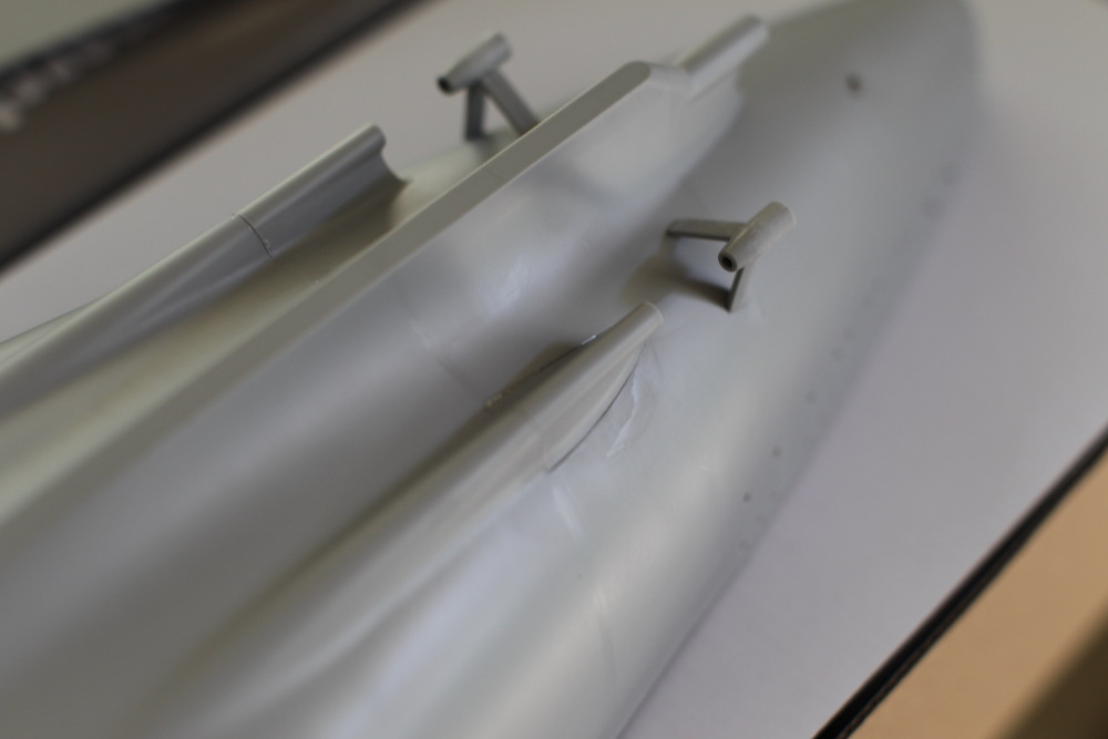

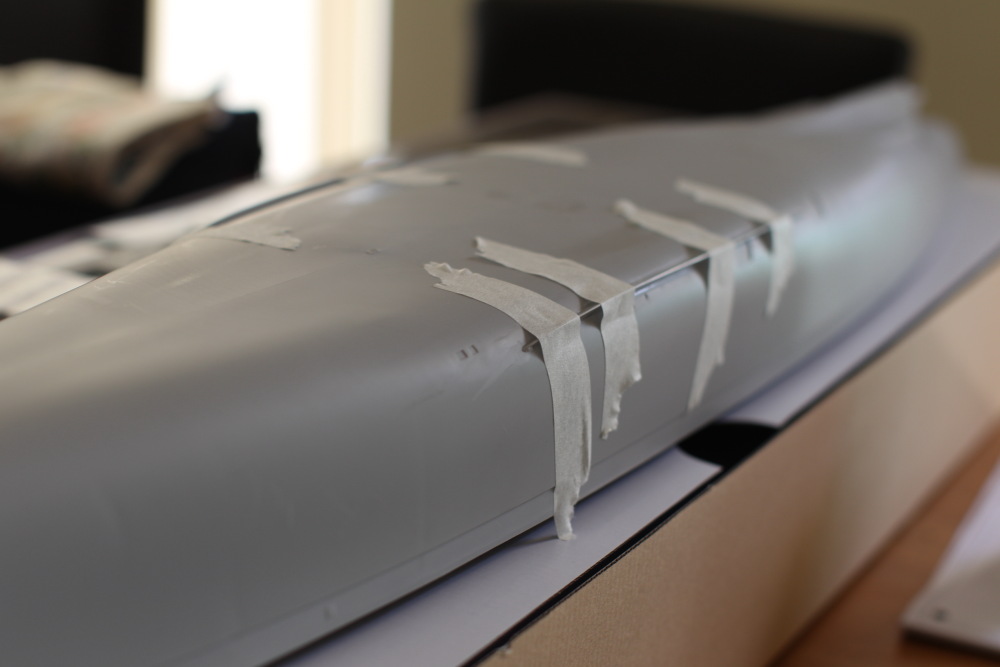

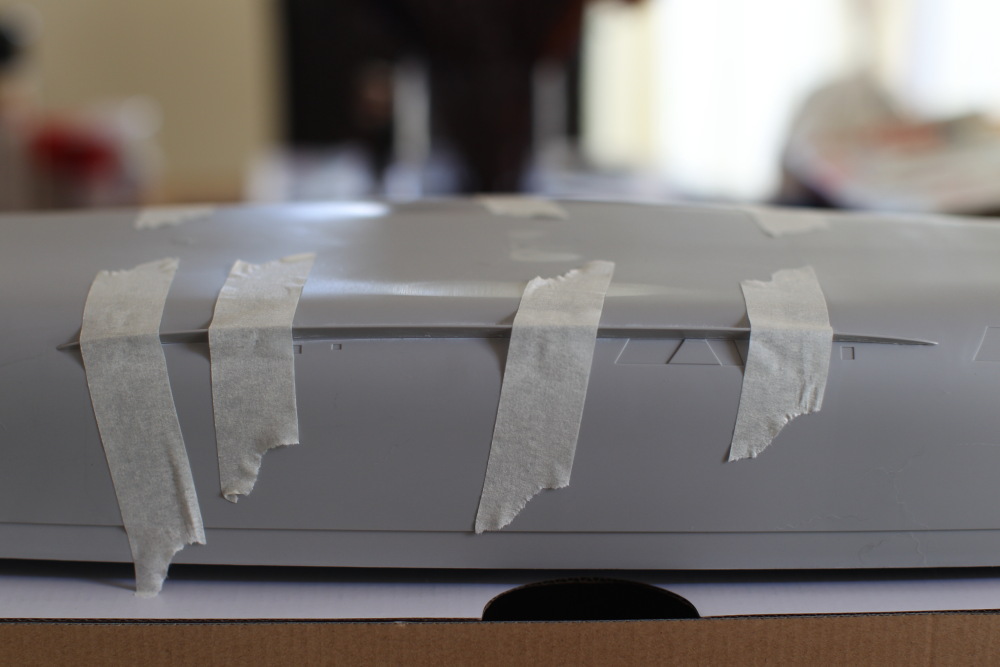

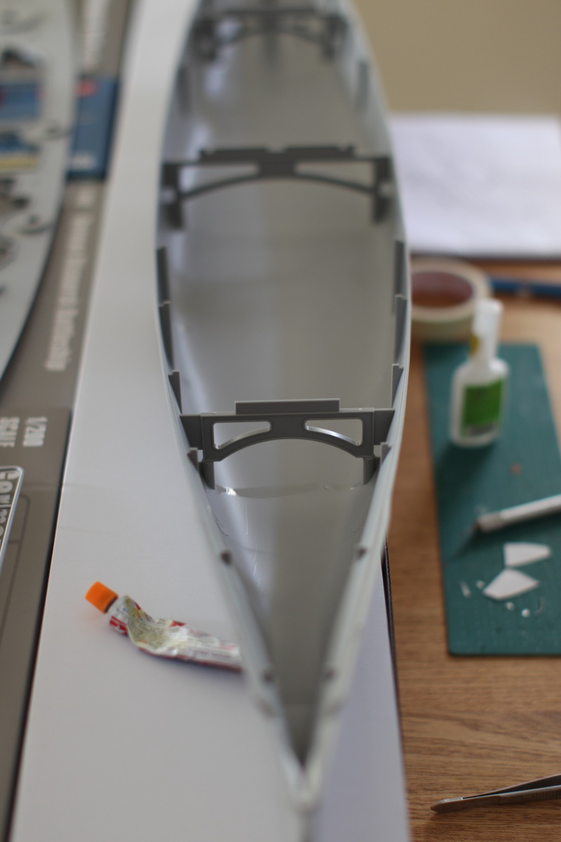

So I've officially made a start and attached the bow pieces, bilge keels and prop shaft a-frames and mounts. As expected at this scale there is some filler required to make smooth and fill the gaps, while small they're there.

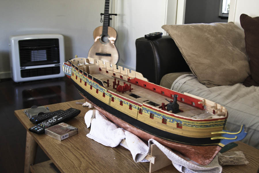

This is my current long - term project, it's been 2 years so far. The 38 gun frigate Diana 1794. Hence the break I need from wood, I also like seeing some instant satisfaction for a change hahaha :)
She's at a scale of 1/64, plank on frame etc.

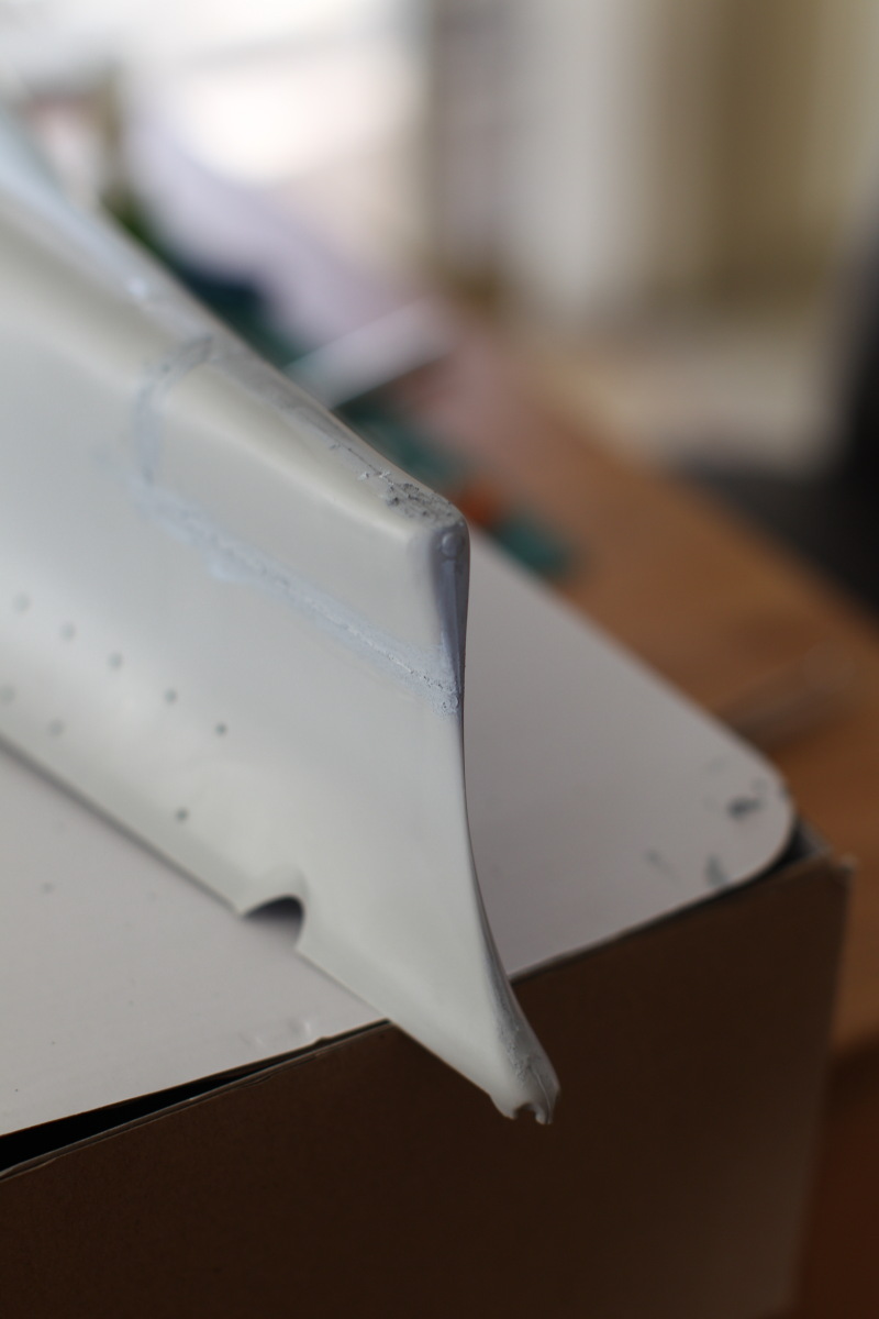

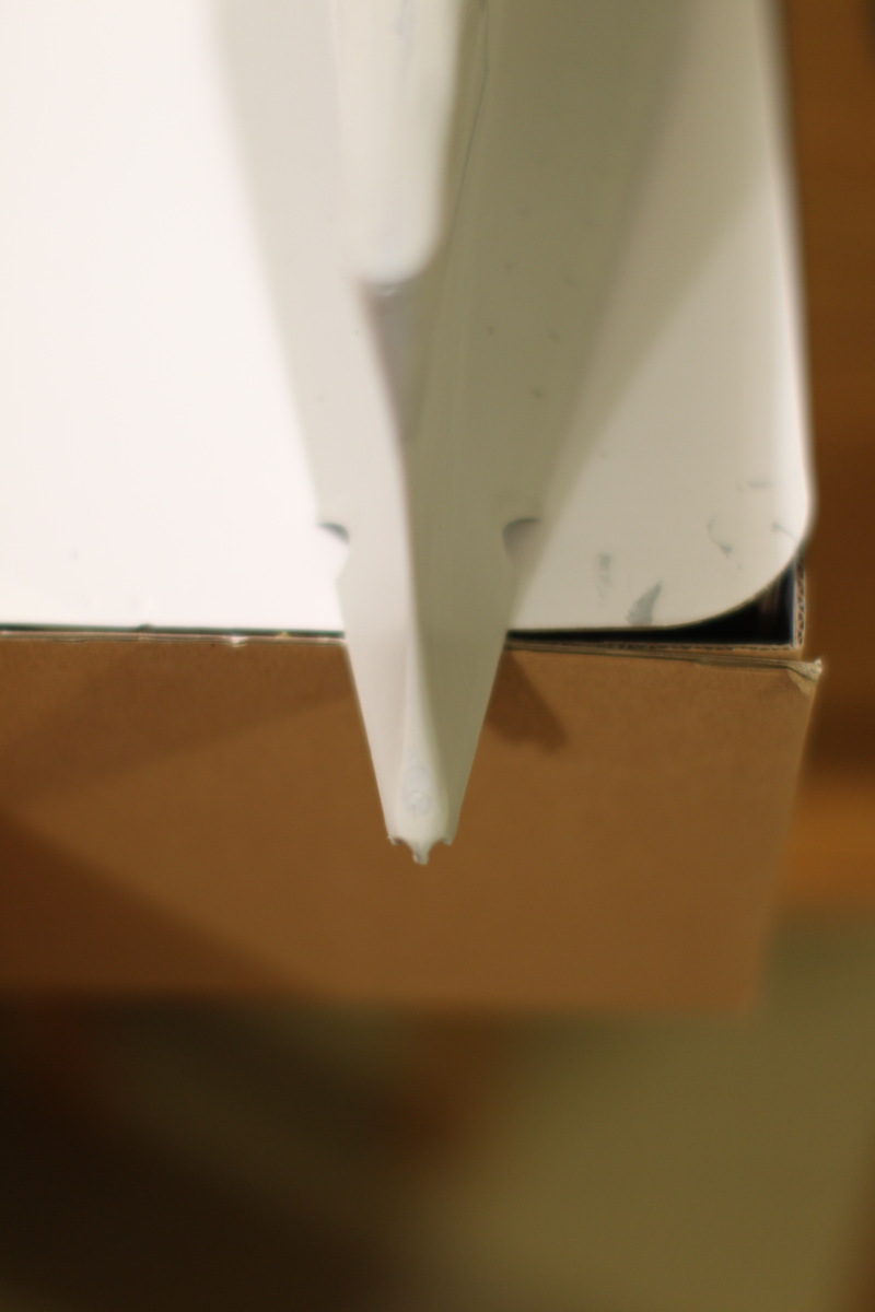

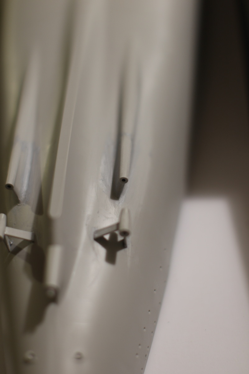

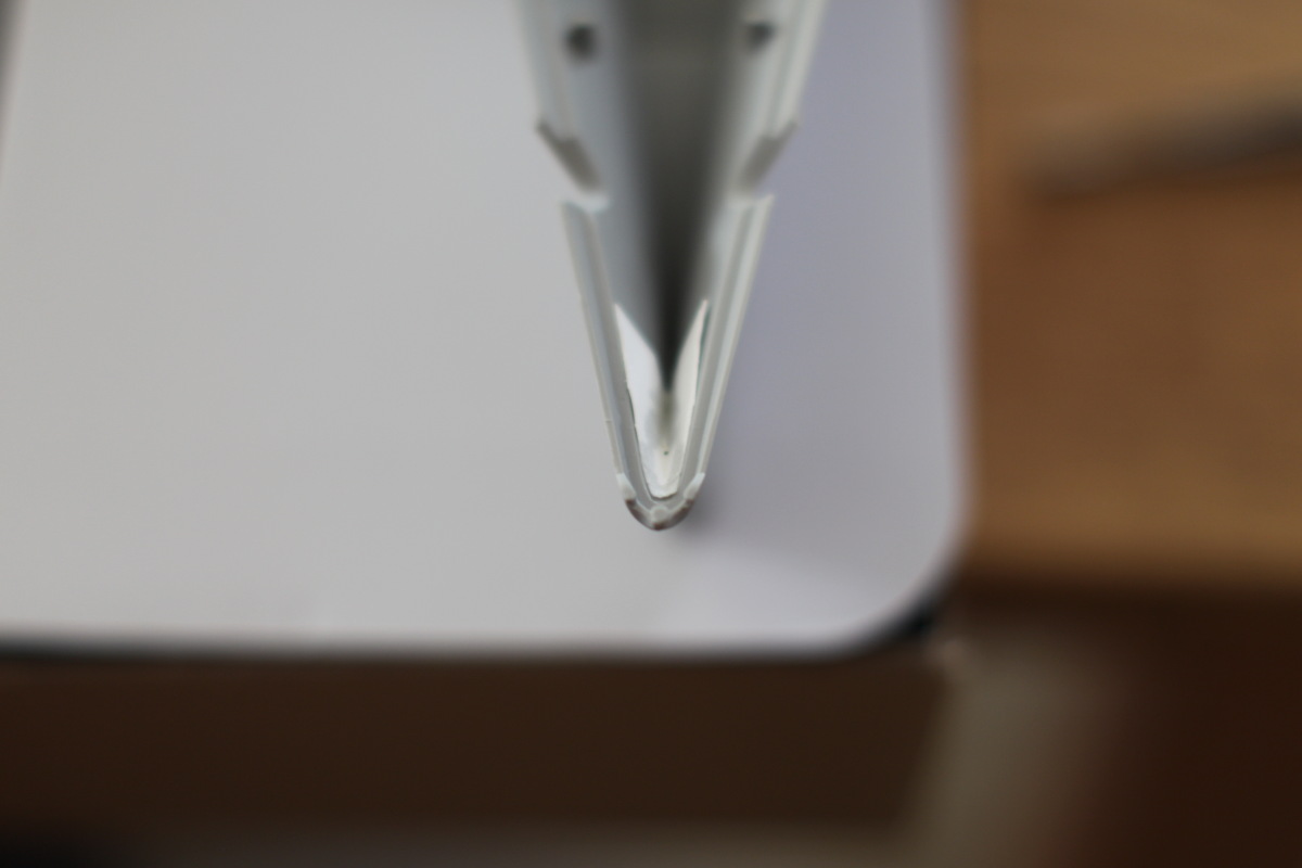

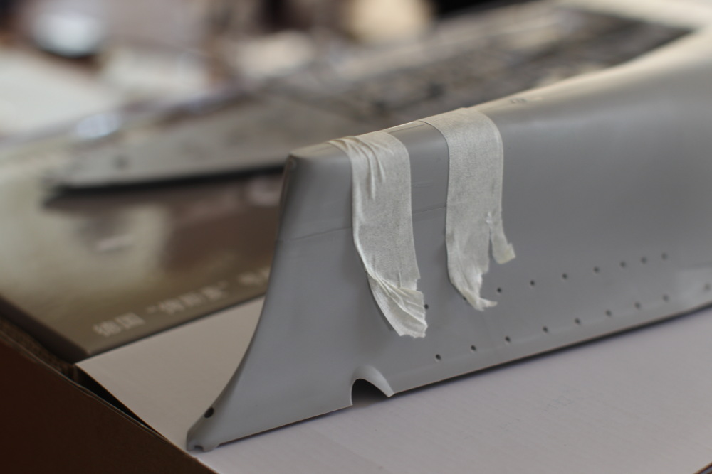

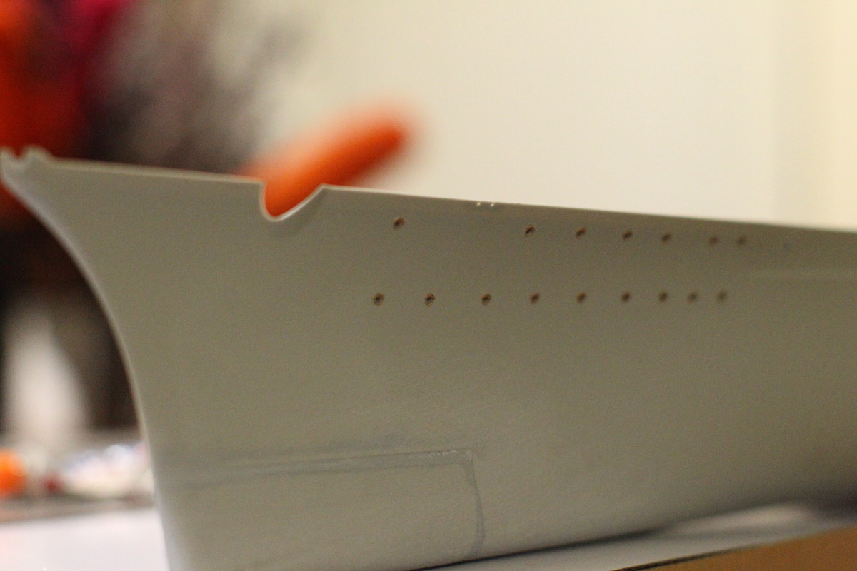

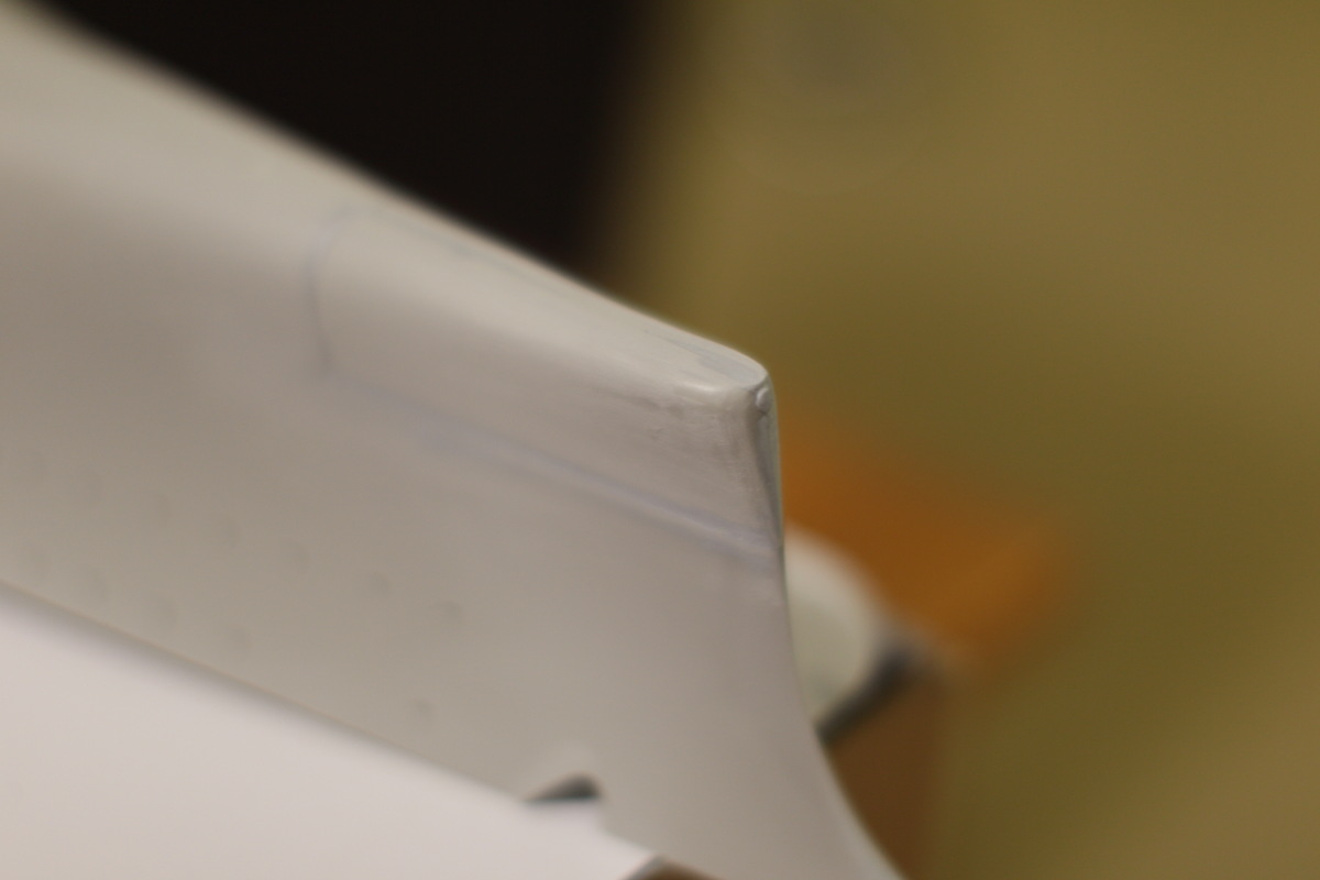

further filling and sanding. I've also removed the stem hawse hole as it's far too low.
File comment: Finally arrived today!
File comment: hull support frames added
File comment: plasticard used on inside of hull before applying filler on stem hawse opening
File comment: filler on bows
File comment: bows smoothed down
File comment: stem hawse opening filled, just need to red rill opening in correct spot
File comment: prop a-frames and shaft opening smoothed after filler

hi
your a frames look out of line
good start
gary

a-frames were out a touch so all lined up now plus have added the PE ports and scuppers on the hull.

Looking good Perth! Does the KA set include PE for the steps on the stern too?
-Jason Channell
PostPosted: Tue Jan 08, 2013 10:17 pm
Joined: Tue Dec 08, 2009 11:15 am
Posts: 677
Location: Fremantle Western Australia
Thanks Channel, yeah after spending $$$ on the KA stuff I'm using the metal portholes. They look the part to me and with the right weathering should be fine.
Yep every step ladder is a single microscopic piece! I'll be doing them today.
