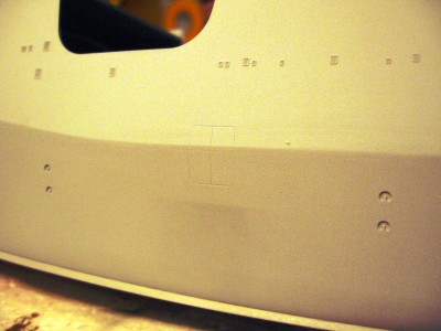

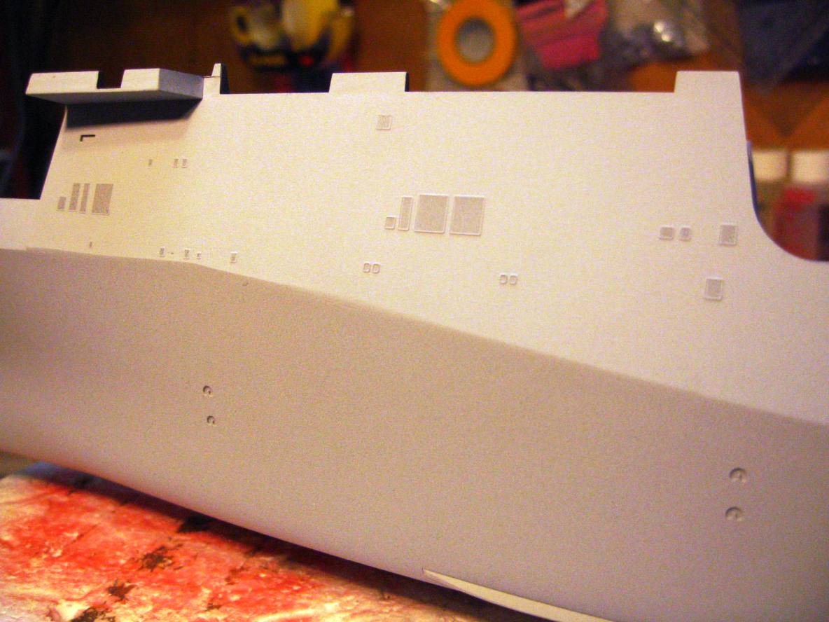

The separation line between the hull and superstructure is a little strange, and will present some interesting seams to be dealt with. This is not a fault in the kit per-se, as the separation is where it would be on the real ship. Fit of these two large pieces is again, very good, so that should minimize the frustration in this area.

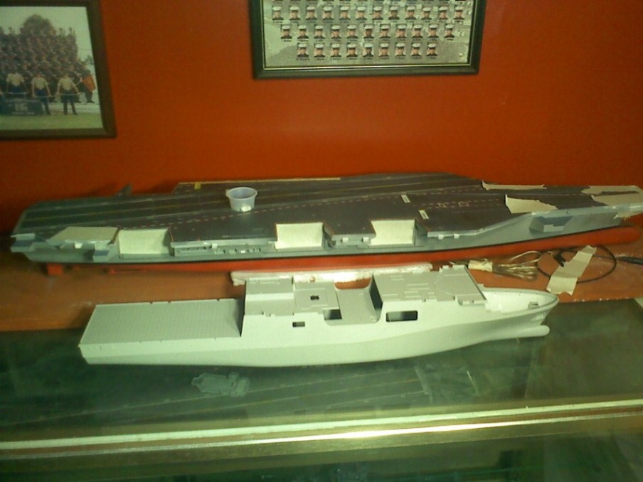

File comment: Size comparison to a 1/350 Nimitz

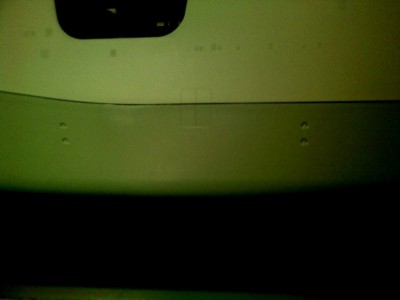

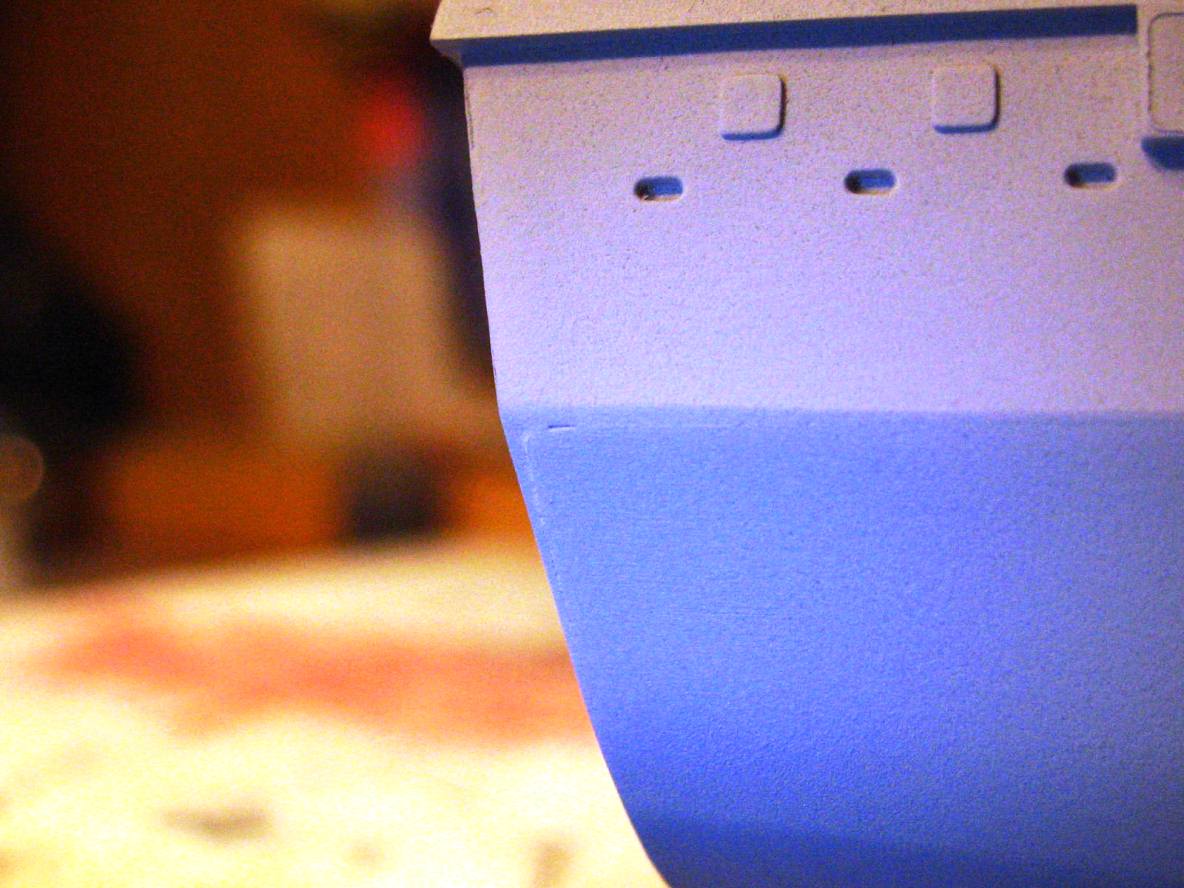

File comment: Hull-superstructure separation, this is the worst area, as the seam goes right through the middle of one of the large access bays. Likely going to require sanding away and re-scribing the hatches.

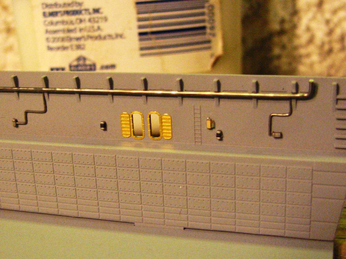

Picture Time!

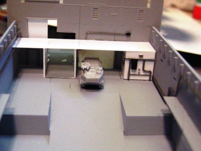

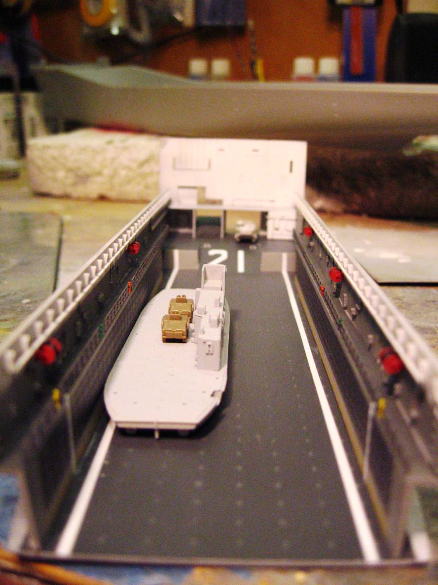

Ok, so I described most of what I did in the posts above, but I'll give a small recap:
The well deck sides were detailed with some PE doors, and rails, some hose reels from a 1/350 yamato, and the rest is different thicknesses of soldering wire and bits of the circuit board torn out of an old cell phone. I gotta say that it was fairly simple and stress free, and I really think the results are just what the doctor ordered. It's a shame that most of it will be lost int he depths of the well deck.
File comment: Kit part, out of the box. Wierd that the lower is nicely detailed, and the upper is nearly bare.
File comment: Starting to look a little lively now.
File comment: I think this looks like it was designed at the factory, the details blend in perfectly with the kit part.

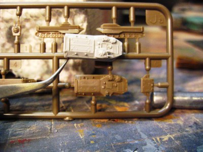

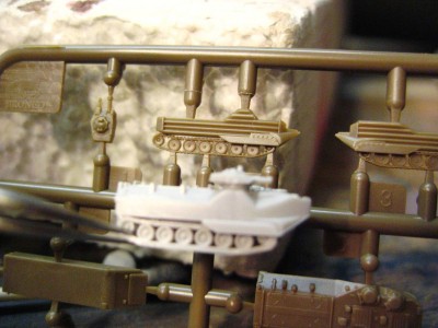

I went to my LHS for supplies and was happily surprised to see that they had a bunch of the bronco accessory sets for their new york. Based on bigdaddymark's posts of the harriers, I bought those (for use on my LHD's) and I grabbed their up-armored humvee's and their AAV set.
The Humvees are decent, more detailed than the gallery ones, even if the doors are a little thick and blocky. at least these have a little more surface detail including the engine snorkel. the armored turret is really thick, but overall nice.
The AAV's are very different. The bronco ones have the explosive/reactive external armor on them, and have detailing on the back end with the escape hatch etc. all in all, I have to give the bronco ones the win over the gallery AAV's.
File comment: gallery in grey, bronco on sprue
File comment: gallery grey has a very slight advantage in detail over bronco on sprue
File comment: blank slate on grey gallery, bronco clearly wins out here.

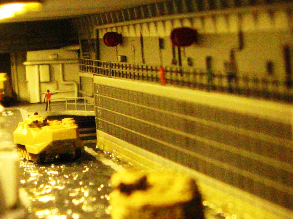

PostPosted: Wed Jan 23, 2013 8:45 am
Posts: 2646
Location: Connecticut, USA

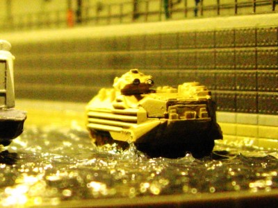

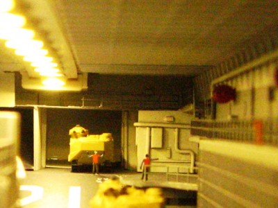

Well deck= DONE!

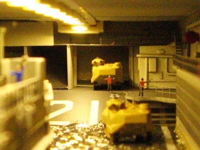

I decided to go ahead and flood the well deck a little, I have seen lots of pictures of the Amtracs driving out of the deck with just a couple feet of water inside, then they sort of just plunge off the stern ramp, and that is the feel I wanted to capture in here, just to illustrate that the deck is meant to be flooded with water. I like the look, even though I am doing a full hull build, and well, as long as I like it that's all that matters in the end. The flooding will also give me some latitude if down the road I decide that I want to turn this into a diorama in a seascape, then I just have to sink the hull into the sea and I'm all set.
I proceeded with the overhead lighting VS side lighting, and I think it is an effective result. I went with warm white lights VS the natural white that I used on teh CVN's just to try something different. I like em both, the natural give off a more flourescent feel, and the warm, are, well... warmer!
I tied up an LCU in the well, though it is likely that they would move it out of the well if the Amtracs were maneuvering in there, but I wanted it in there, so there it sits.
File comment: strip lights easily attached to the roof, soon to be blended away with paint.
File comment: the sea is pretty frothy while the gel is still wet, but it'll clear!
File comment: all clear now

PostPosted: Wed Jan 23, 2013 8:54 am
Posts: 2646
A note on the build process: The directions call for you to attach the well deck to the lower hull, then attach the upper hull over the deck and the lower hull. Save tyourself a lot of time and frustration, and attach your completed well deck to the upper hull (underside of the flight deck) then attach that whole assembly to the lower hull.
Lucky for me, I studied the structures enough to catch this in the planning stage, and it made life simple, and painless.
Now on to the upper/lower hull fits. All I can say is WOW! That loooong, complex seam that I was worried about was simply a non-issue. The fit is so good and so tight, that there was only one micro sized spot that required any filler whatsoever. the rest of the nearly 4 feet of seam simply disappeared with a light swipe of a medium grit sanding stick. Very Very impressive.
Only thing that did make me scratch my head a little is the starboard side access hatches. The port ones matched up perfectly, but the starboard ones seem to be mis-scribed about 1/16". They must be mis-scribed, because the fit was perfect on both port and starboard sides, but the top and bottom halves of those doors simply do not match up. So they were sanded away and will be re-scribed.
File comment: literally this is the only spot on either side of the hull requiring any filler at all!
File comment: this is the fit of the upper/lower hull after gluing, a very light sanding, and priming. wow.
