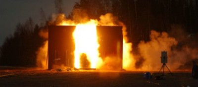

Yes, they were bolted. Between the hull and the armour there also was a layer of hard wood (teak or oak). The purpose of this was to act as a shock absorber and flex to further reduce the change of penetration.
Hard armour plates are not easilly welded. At least not in 1939-40..
A small digression: This picture is from Sweden. My former company and Swedish FMV -Material Command used this plate for firing 155mm 43kg shells onto the side armour of Tirpitz. This plate was bought from Norway some time after the war.
Shell was standard 155mm HE with PPD 440 Prox Fuze fired through 40 cm plywood (first) as part of a safety test - it shall not detonate. However: The impact against Tirpitz in enough to detonate the shell even with a crushed and destroyed fuze!
There was no marks in the armour after the tests!!!
Some plates of somewhat thinner Tirpitz armour is still in use in the Road Constrution Dept in Oslo..
