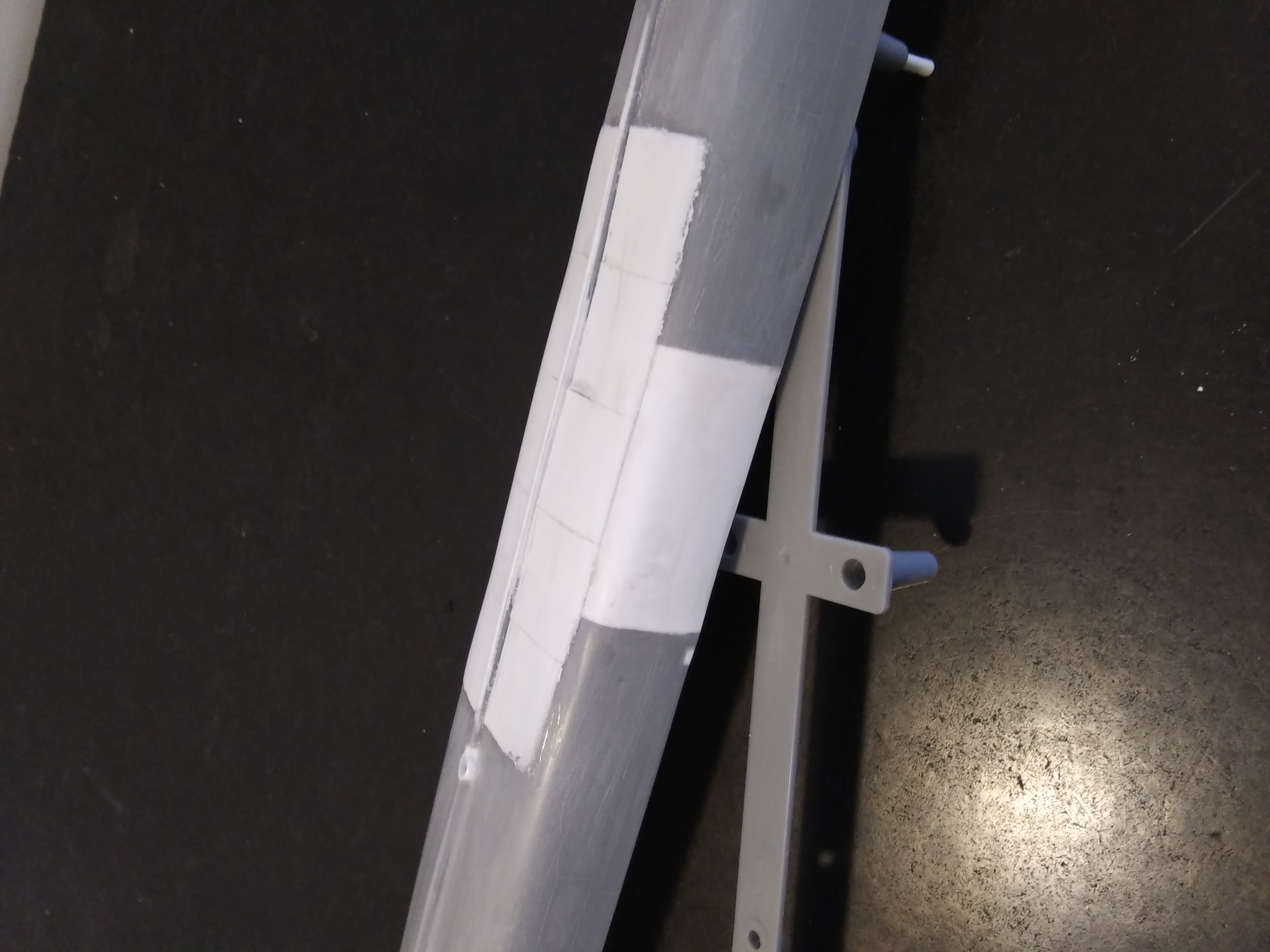

David P : you got me thinking, so I tried wraping plastic sheets cut in small pieces around the kit's F.Sherman stacks, two sheet pieces overlaping gives the correct thickness, So looks like will use this method,
When I did the hull extension I tried one piece on each side port and strbrd getting the correct shape was time consuming bend and heat, then bend and heat again ended with too much heat damage just too thick to work with, so I ended up using four layers of thin sheets overlaping over each other in layers, one set of four for each side, worked out much better, attached to a thick piece in the bottom center(keel) match the thickness of the keel there, then added side frames just below the deck level; after the glue dried area feels very solid.

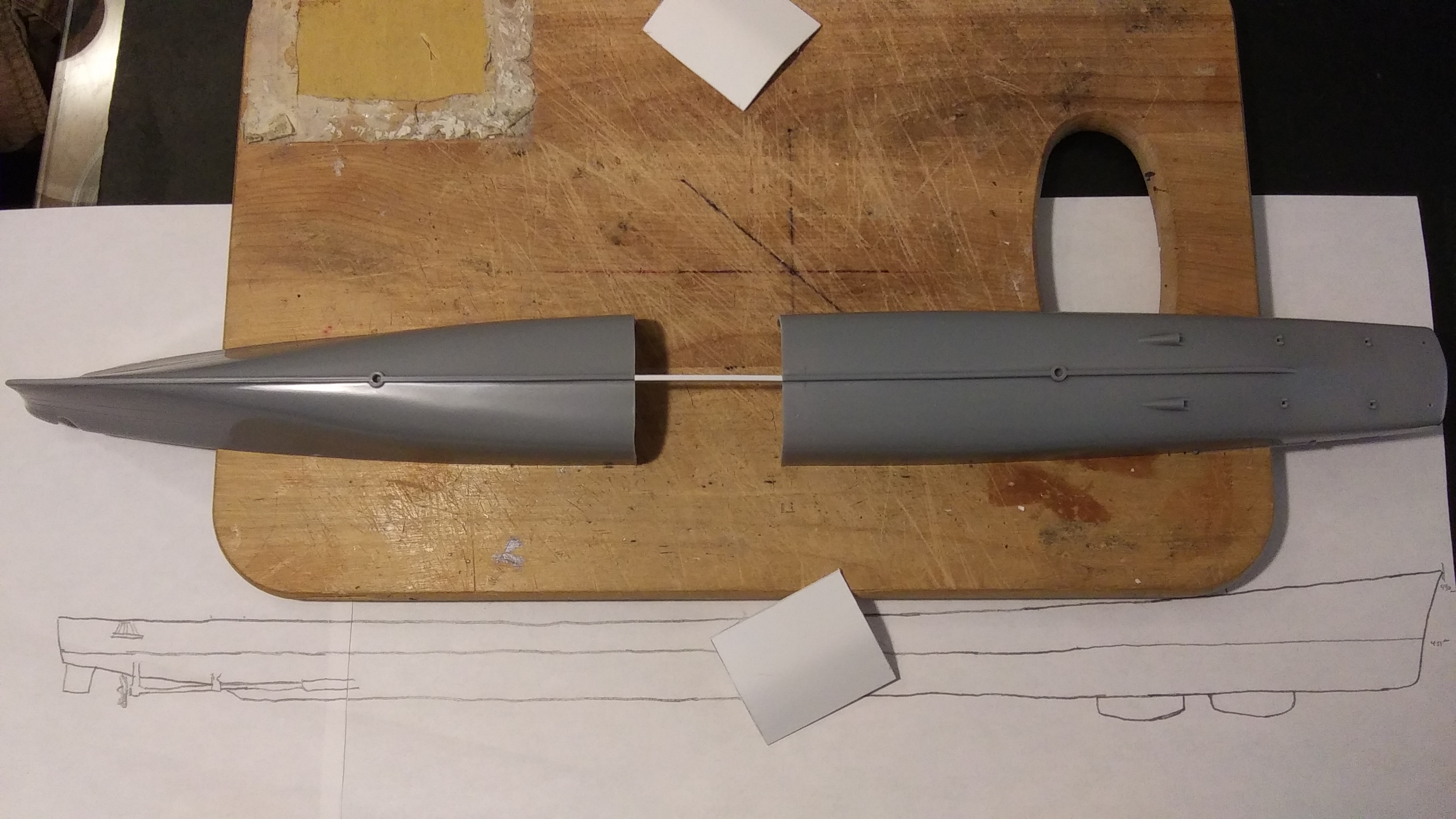

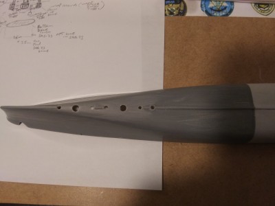

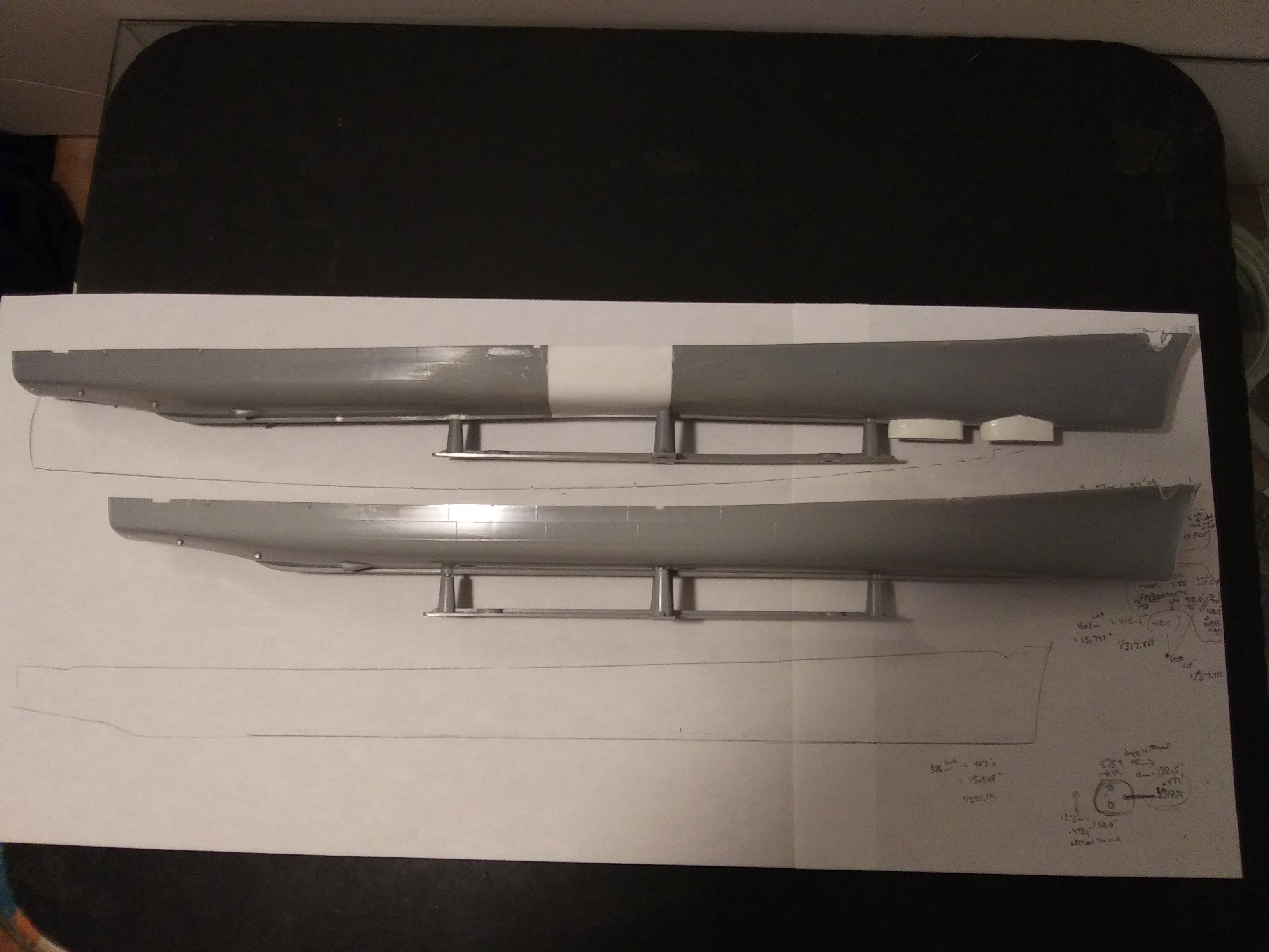

after a very long delay {due job change/life, family etc. Finally restarted work on the DD931 type to DLG conversion, added twin sonar domes, closed up the anchor ports, and reconfigured the anchor ports, raised the bow by 2.85mm (about 3 ft in scale), next is add the main deck

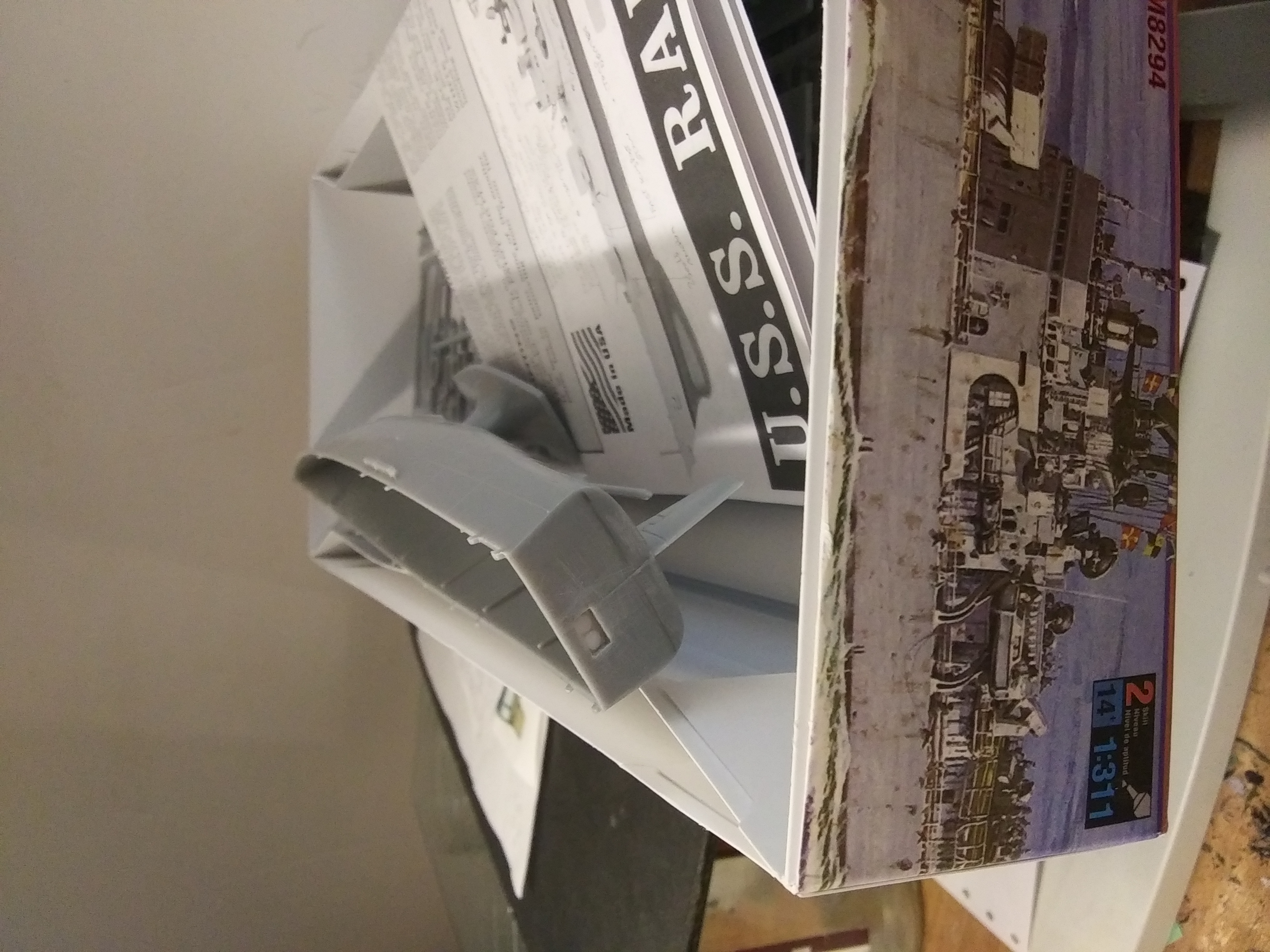

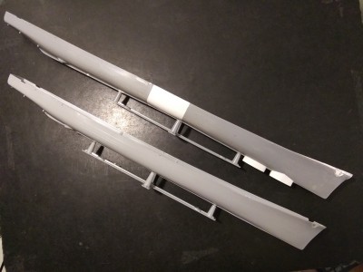

In the above picture post was able show a original dd931 hull next the to the extended hull, this my fourth F.Sherman kit 1/320 scale, (kit is the John Paul Jones), also picked up two 1/311 scale DEG-1 Brooke class models (kit is the Ramsey), both model kits by Atlantis (old Revell/Monogram kits released under Atlantis)

thanks FFG-7 for that link of the deg, that i did look that over before after buying the Ramsey kit and i saw the two 21" torpedo tubes, I quickly modified the new kit, so I would not forget to do this modification later when I build the kit.

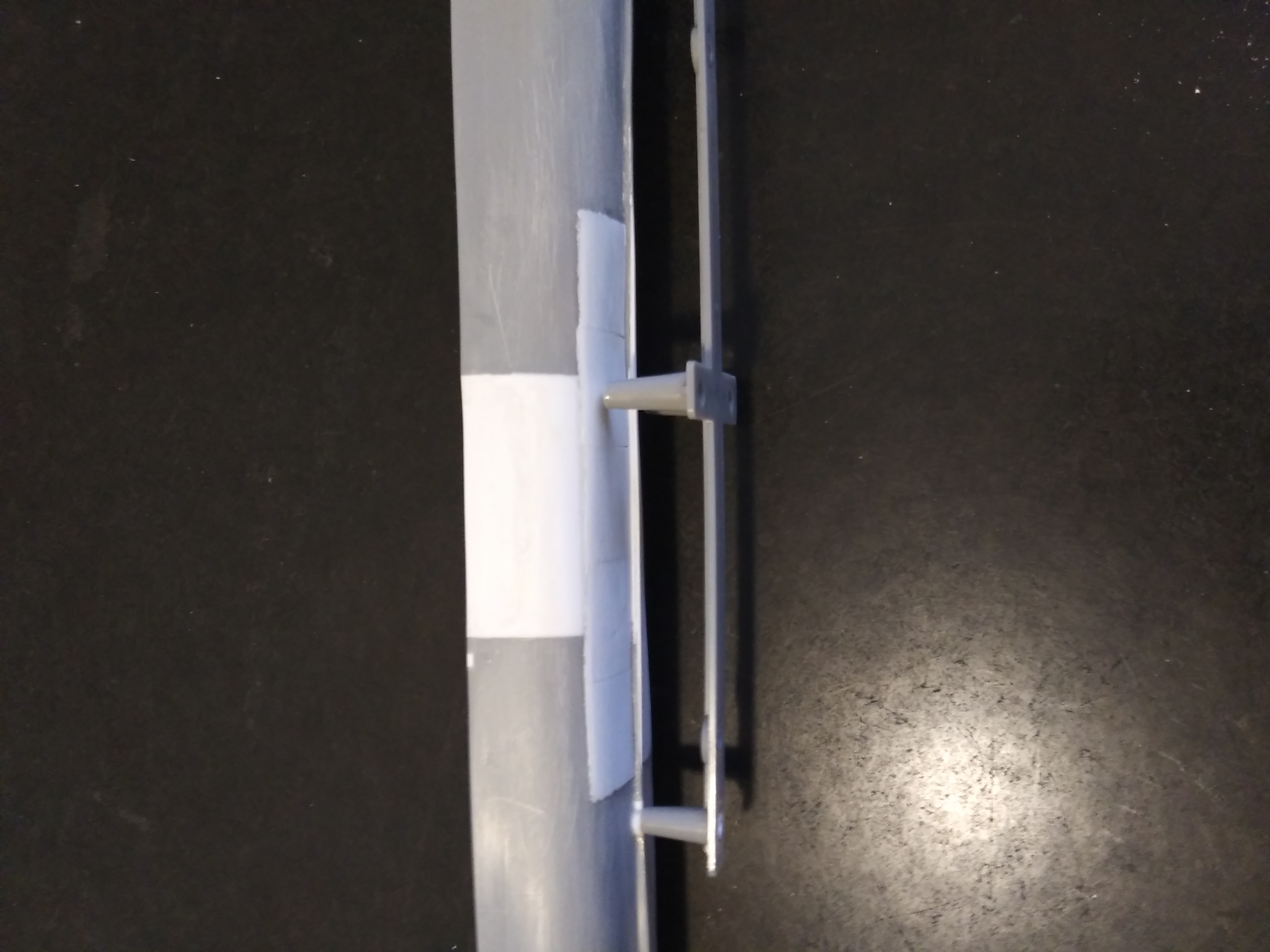

thanks FFG-7, I looked at the DEG general plans after I brought the 1/311 Atlantis Ramsey kit, And notice the 21" torpedo tubes in the transom, so I quickly added that modification to the kit, so when I build it later would not forget or be too lazy to add it.

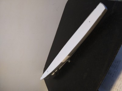

FFG-7 I remember this issue now, after not touching the model in many months, when I sanded the hull extension to blend in with the hull , parts of the keel got sanded down in certain areas, quick fix added a strip of white plastic to the keel and will add super glue later to even the keel out more.

The hull not bent, the curves of hull are changed due sanding to blend in with the hull extension, and hull is also push out with inside brackets to widen the hull. add all this together get a change hull curves fwd and aft of the extended hull section.
So I decided cut the inside brackets to take some of the pressure off the widening part, it only moved about .05mm at the most, this cause the extension part to bubble up little in some spots, as this is made up of four layers, it bubbled up inside the layers, also added white plastic to hull to try fill in area of heavy sanding see if will take out some of the curves, and then build the keel back up in this area.
