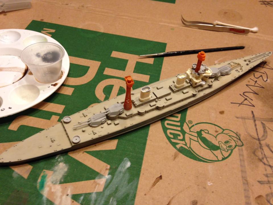

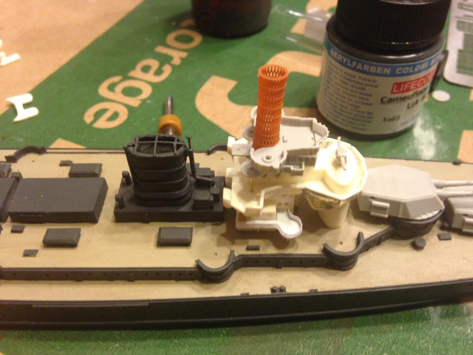

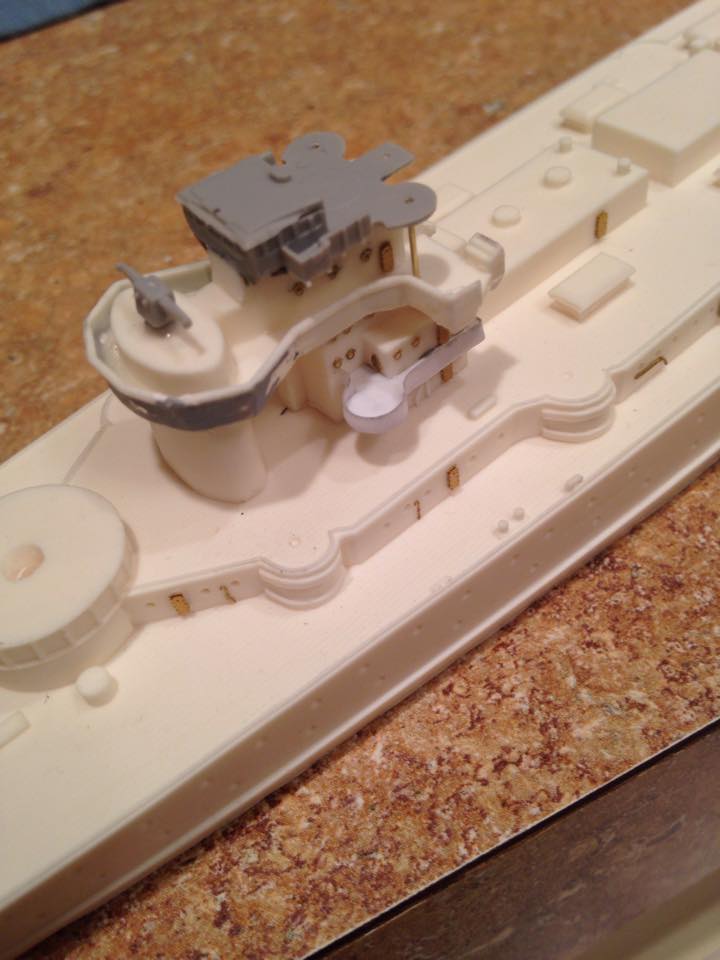

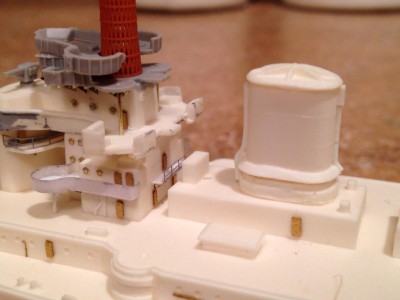

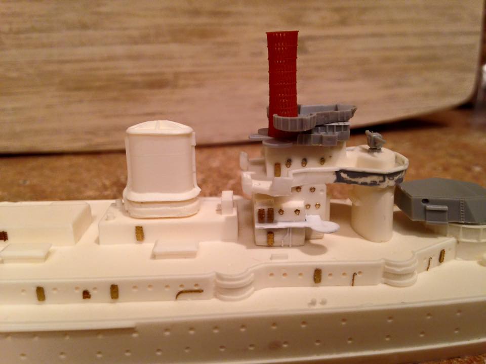

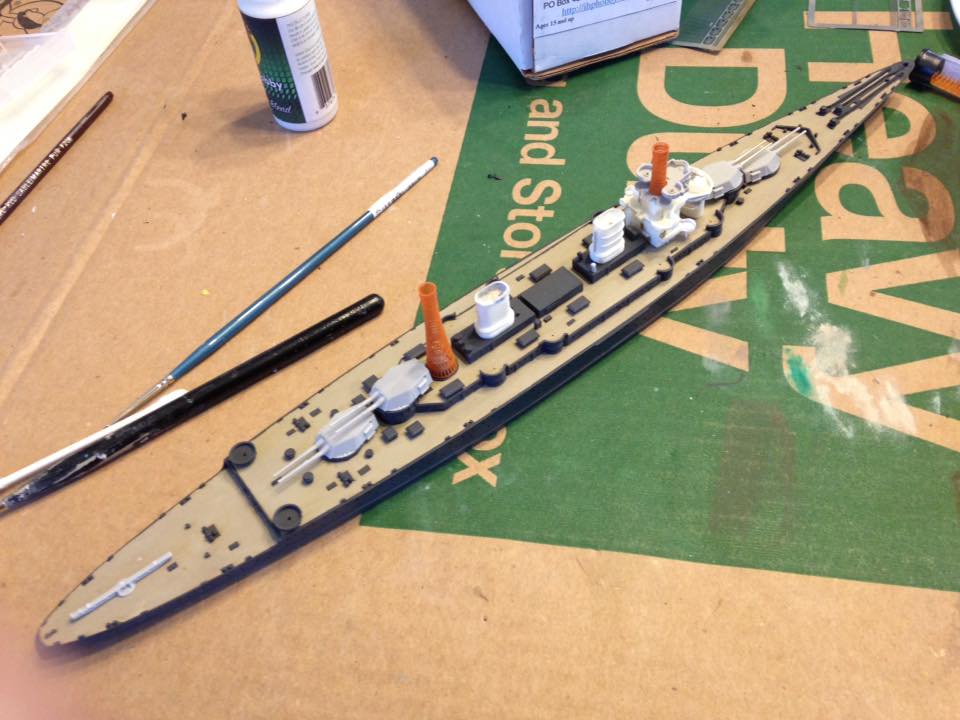

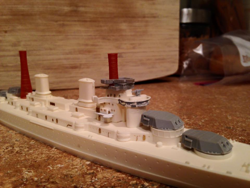

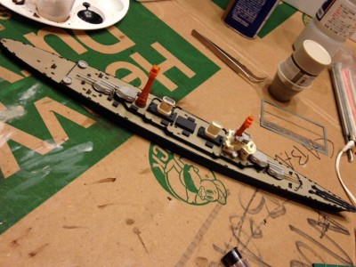

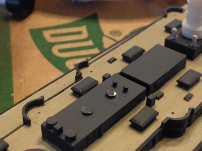

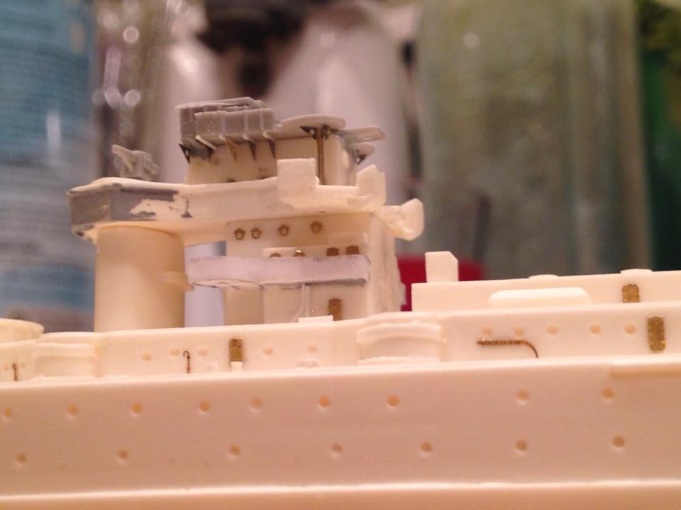

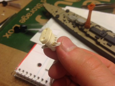

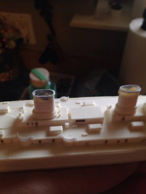

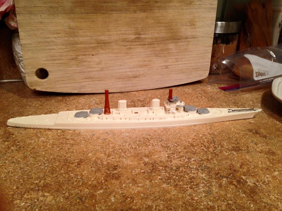

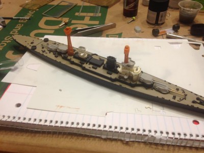

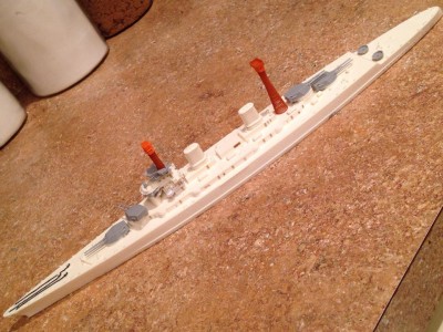

Progress on the IHP Lexington.
I've been chopping and building the bridge structure, utilizing parts from a Maryland kit. Many portholes were too high, so I filled and replace them with Flyhawk PE. The other deck details are from a hard to find Lion Roar set.
I'm close to getting paint on the hull. Once that's done, I'll start adding 1.1" gun tubs, catapults, etc.
The funnels are going to be a beach, being that they're solid resin. I'm 50/50 on a total scratch job here. I'm going to TRY to hollow these guys, but well see.
I'm also planning to re-rig the Queen Mary in the near future, so that'll put this back a little farther.

Chris,
Looking good, you can get 3d printed stacks off of shapeways. They are hollow and easier to drill the cap out and detail.
Look forward to more updates,

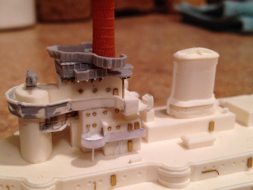

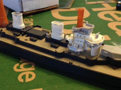

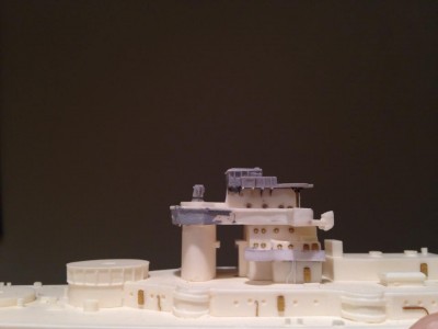

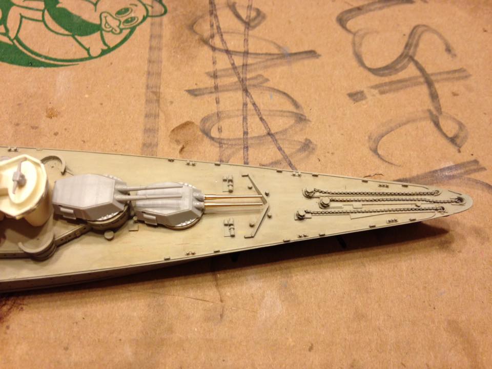

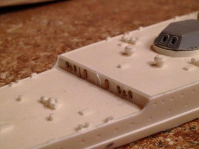

Progress on the USS Lexington. I've only had about an hour to build today, but I've largely finished the navigation level of the bridge.
Added: supports for the 5" rangefinders (behind navigation bridge) and support structures under the bridge.
I'll next do this to the lower 1.1" platforms and catwalks (which were built with styrene and CA-stiffened paper.
Next? I'll give the main hull a once over and decide if it's ready for the first primer level. I also need to finish the 1.1" gun tubs that are on deck.
....lots to do. I need to fill space between the gussets and the navigation bridge, for example. There's still a LOT of work to do on, well, everything.

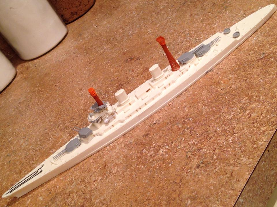

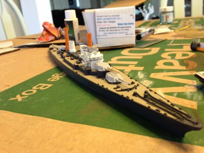

I've continued building, rebuilding, and just throwing PE at the bridge. I keep some level of sanity by doing quick dry fits (like this) to remind myself that there is a warship under all this work. I'm mostly satisfied, sans the railing on the catwalk under the bridge. Thankfully, this is resin and I can sand it lightly down to match the PE. I got impatient.
I am noticing that the IHP superstructure is longer on one side. I'm hiding it as best as I can, but I'm sort of wishing I simply went with the Colorado class bridge entirely.
File comment: Overall shot. Dry fit the cage masts, because cage masts. I'm going to cut the plastic barrel portion off the guns and attach brass barrels.
File comment: Aft platform is made of CA-stiffened paper and PE.
File comment: Best view of the platform I need to fix. 1.1" tubs are made of styrene and paper.

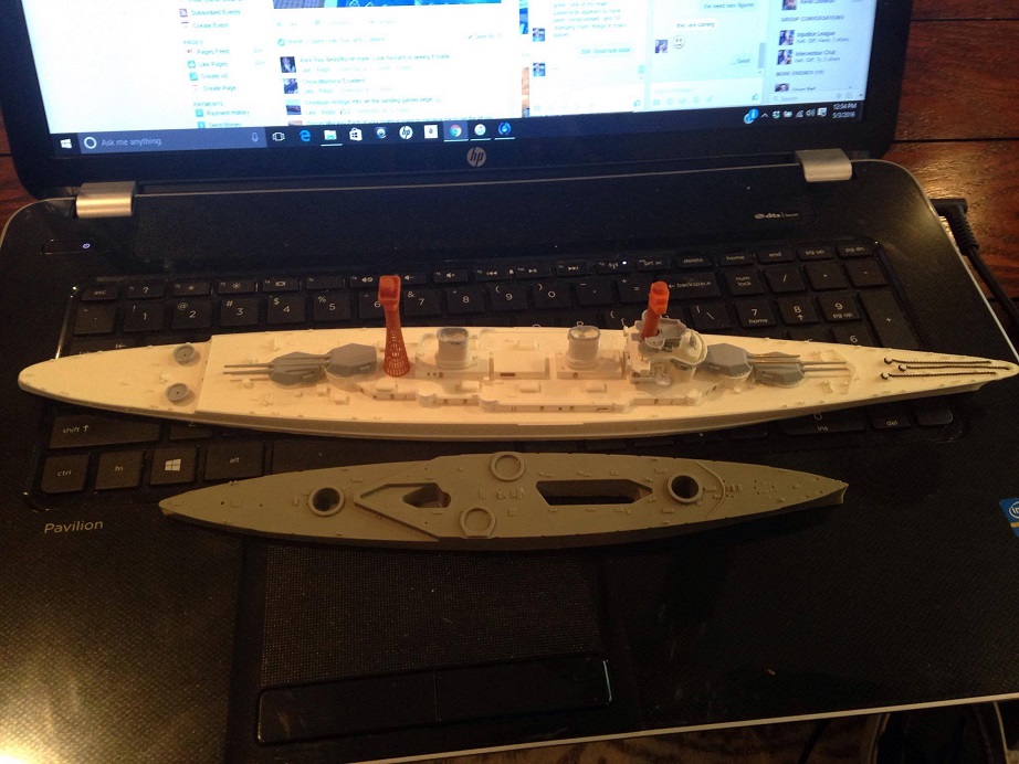

I've finally dug this one out again. Updates with be rather sparse due to the evolution of my skills and time obligations from work, life, and modeling promises (read: commission work.)
Setting:
I'm still planning to do Lexington as imagined on December 7th, having been dispatched to escort carriers currently ferrying aircraft to Wake. The battlecruiser will be sailing at high speed back to Pearl Harbor, actively searching for the elusive Kido Butai. She'll be without her float planes, having launched them to search for the fleet.
Status:
I've hollowed out much of the IHP funnels and plan to build new grills using copper and/or stretched sprue. I'm also currently building gun tubs to protect exposed AA gun positions using plastic stock. I'll add ribbing and other detail as I go on, likely with sprue. The following pictures show the detail of two of the (incomplete) gun tubs and overall show of the Lexington dry fit. Note: I haven't yet started work on either catapult or the 1.1" gun tubs I plan to add. I also am still debating how I'll place her launches, though they'll likely go midships as per her design. I'm seriously considering adding to platforms adjacent to launches for additional AA. With the Lexingtons likely acting as escorts for the scouting fleet, I imagine they'd have priority for the new .50 cal and 1.1" AA guns.

Looking good! I have often wondered about the 1.1/ 3-inch aa guns on this class. Being mounted on the lower aft deck, I wonder if this would have been good or bad considering that at high speed I imagine this deck to be pretty wet.

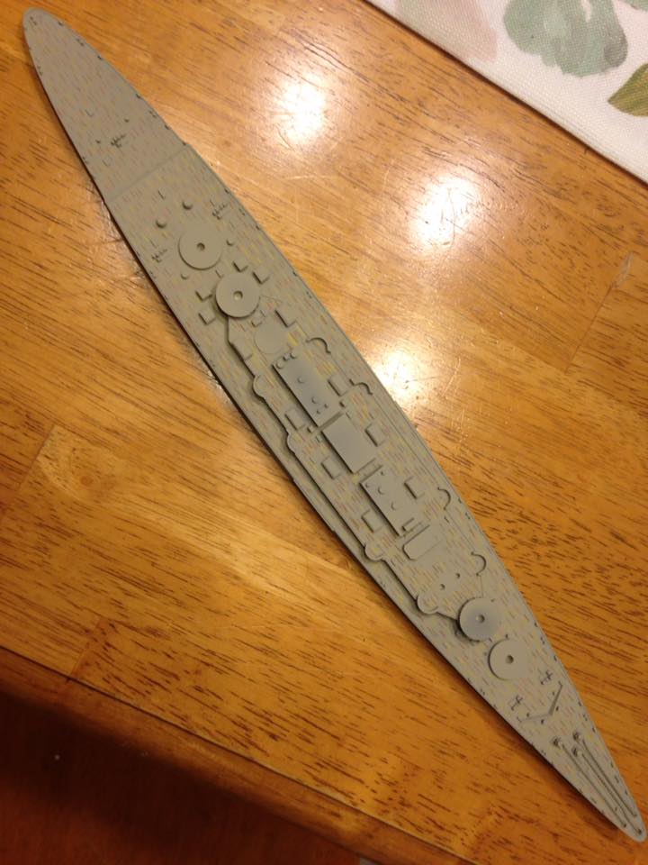

With Invincible done, I'm back at this. I had planned on making serious headway this weekend....
...then the wife decided our kitchen cabinets needed new paint. Sigh.

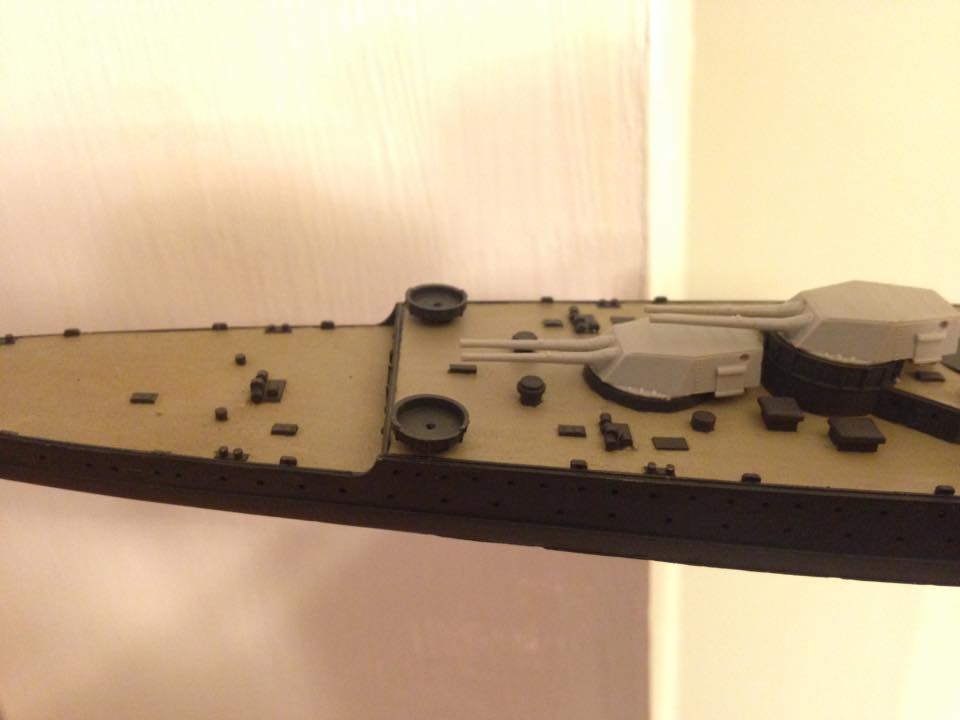

Still, I -did- managed to prime the main hull after finished the AA gun tubs and begin work on the wood deck.
Process is as follows:
1) Paint the deck in your desired base coat. In my case, I used Tamiya's light deck tan.
2) Use very sharp colored pencils in a variety of colors. I used two shades of yellow, a few dashes of orange, and two shades of brown. Make your deck look like a damn Thanksgiving decoration. Like this:
3) Resume with base color or a shade off of the base. I added some Tamiya flat white to my deck tan mixture and diluted it to 80-90% thinner. Over several layers, mute the lines until they're just visible. All lines should blend into the base paint and only bear a little hint of their existence. This was, well, mostly successful. A few darker lines are still visible on the starboard side of the second turret. I'll lighten it up after work.
4) Future then use a darker oil wash to pick out the hull planks. This should be light unless your vessel has seen a lot of action, JMO. This has not been done.
I'm not sure if I'm going to mask the deck off and airbrush 5D on the hull or stick to hand painting. I've had paint ripped off by tape in 4/5 ships I've done in resin, regardless of how hard I've scrubbed them or how much I've primed the ships. My one exception was after a Future treatment on the ENTIRE ship, but I'm still admittedly paranoid. I may mask off the entire upperworks and spray the hull, relying on the brush for her upperworks. I'm still not sure.
All for now. Ideally, I'll post a pretty picture of her hull fully base-painted in the next few days. While that dried, I'll continue work on the forward superstructure and funnels.
- Chris

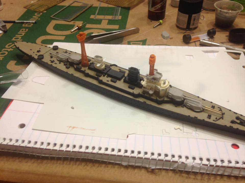

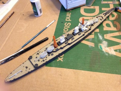

After a few days off masking in my "free time," I managed to get the vertical surfaces and superstructure painted 5D. Thankfully, a preparatory layer of thin Future avoided all but one big chunk of paint that came off right where the superstructure sits. Win.
Here's the vessel with what bits I've started work on. I hadn't touched anything up to the point.
I've added two 1.1" gun tubs from my donor kit above the quarterdeck. I figured that the latter would likely be utilized almost entirely for aircraft handling and likely wet.

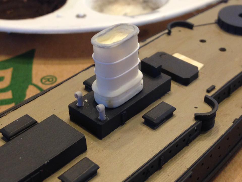

Note this midships aft superstructure where funnel #2 sits:

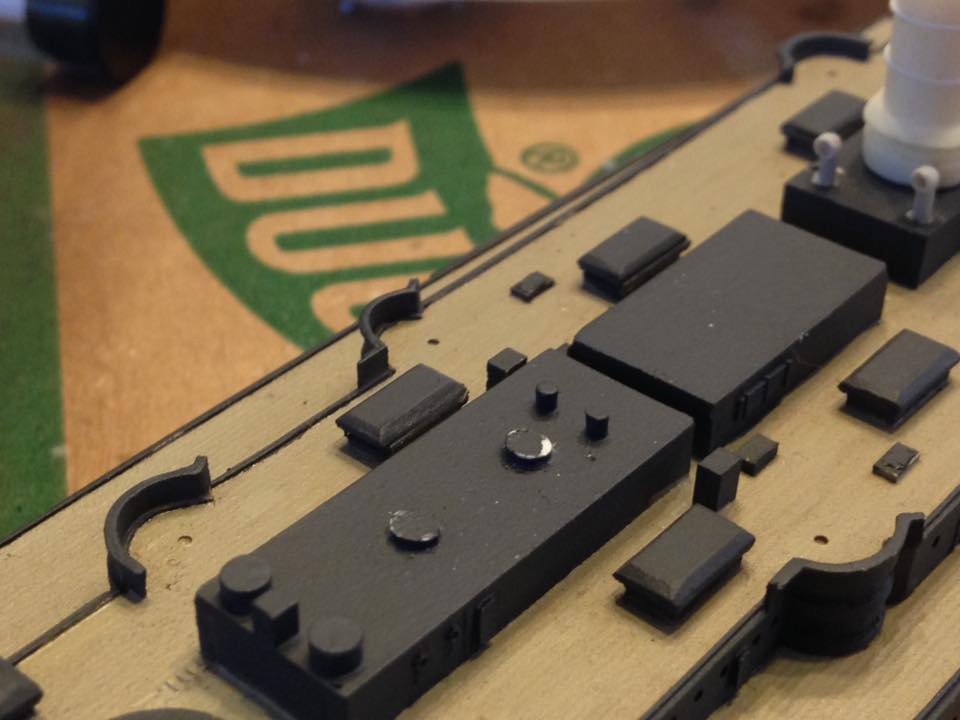

I've cut and removed the knob-things and placed two ventilators from the Maryland kit after drilling out their holes to a major in-scale size. Note one is painted:
