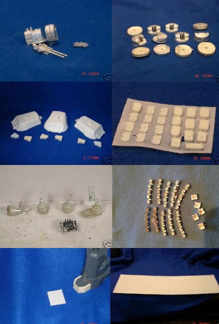

For parts I went to Ebay. There is seller who casts his own parts... resellersunlimited2007. His parts are nice and also pricey. I paid more for his upgrade parts than I did for my model. The 5 in turrets are nice but I think they are just a bit out of scale. They seem bigger. When I put these I found that the guns weren't pointing straight. Might want to watch out for that. The extra 25mm encased guns are nice. Just hard to add detail to metal. The main gun turret upgrades are big and are better than the originals. I made the barbettes a little bigger to make them look right. The doors and hatches are nice but I'm having a damn hard time getting the extra resin off the doors to make them set flat. Also the ammo boxes. They are made of metal and you need to shave off almost a millimeter of metal to get these to look right. If anyone has any ideas on how to do this please let me know. The bridge add on corrects things to the way they would have looked in '45. Looking back I should have just tried to scrap build this considering it cost almost $40. The long diamond tread resin piece I believe was to be used for remaking the forecastle deck. I just use this as a pattern for when I use time foil to replace damaged or changed locations on the deck.

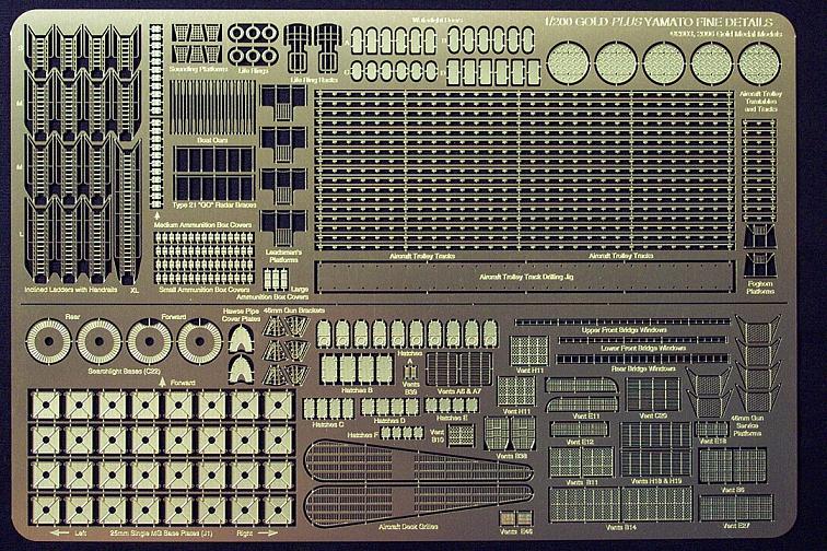

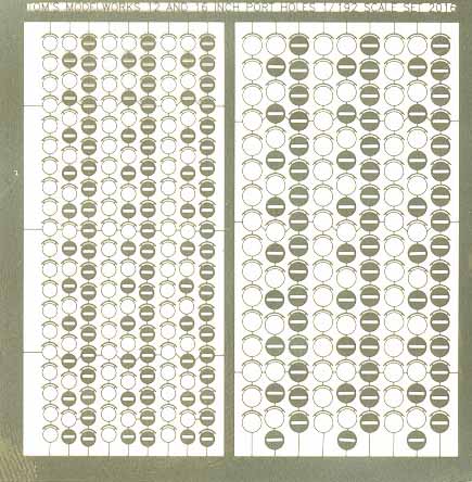

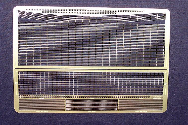

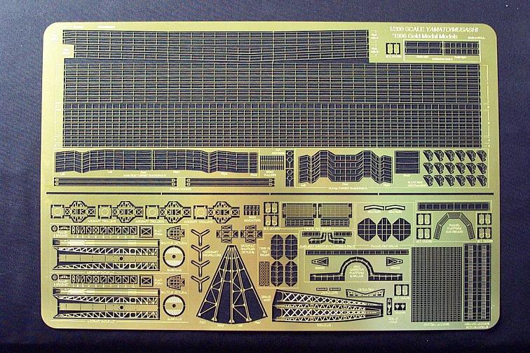

For photo etch I bought both GMM sets along with Tom's portholes. Also purchased the GMM 1/200 2 rail set which is great. Has iron grabs and a jig. And has limoleum deck strips Im probably going to use on the aircradt deck linoleum. I did purchase the 25mm photo etch guns from GPM but my getting cross eyed putting them together. I did use the sights like Bucketfoot-al used on his build. Atlantic models put out a photo etch set as well. I might get this when I build my 1/200 Yamato commission version. https://www.whiteensignmodels.com/p/Atl ... WZsrqJg-Dk
As the build goes on I will be adding additional things used.

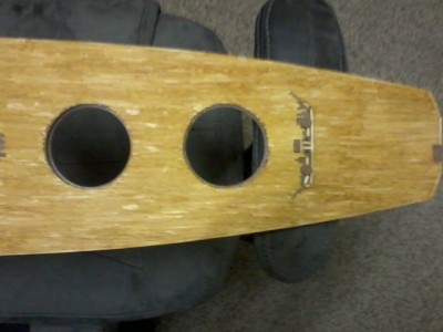

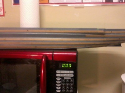

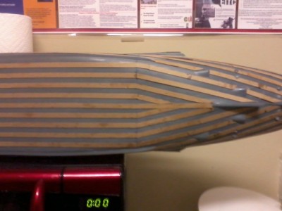

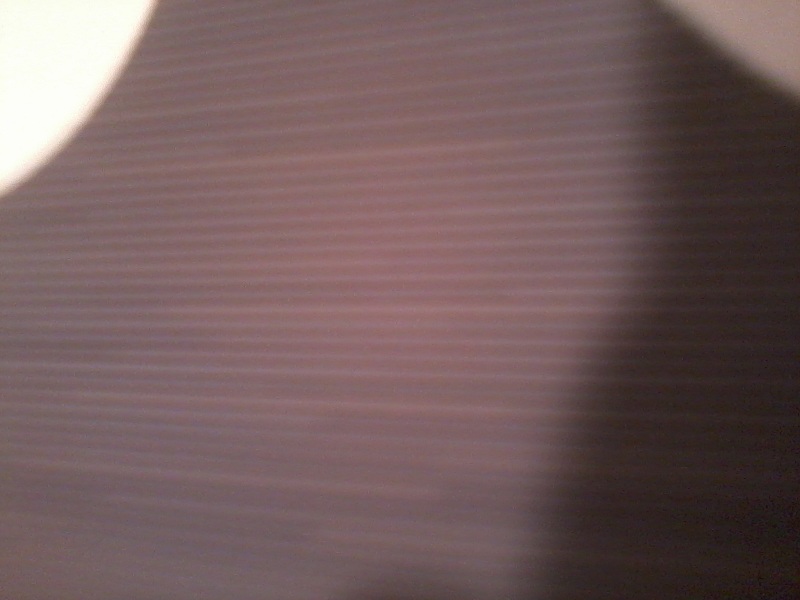

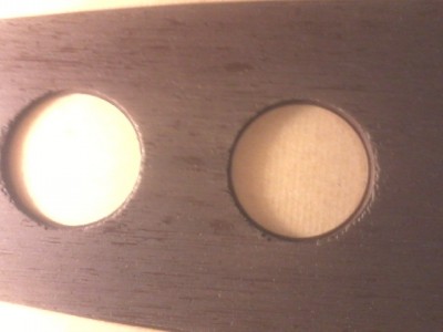

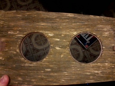

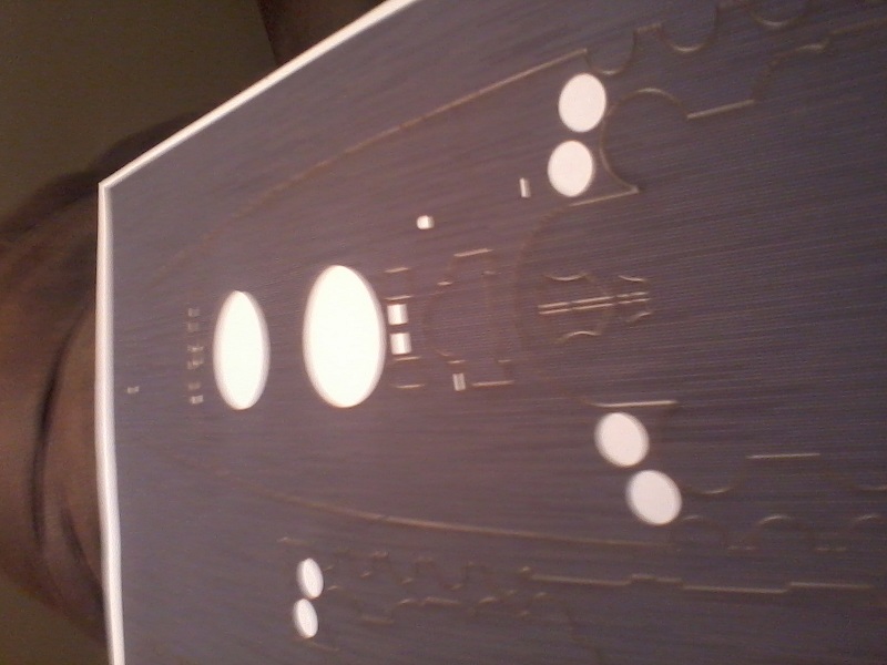

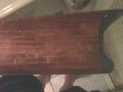

Just to clarify this is a 1945 build. Not the original 1944 set up. To start I wanted to plank my hull and thought I knew what I was doing. I was wrong. First don't use CA glue to glue down thin wood strips. It soaks through the wood and makes it so you cant stain it (my intention). You can paint over it but it comes out glossy. I should have used...like what Ryan did..and use pencil between the planks. I liked the way his deck turned out. But I wanted my to have a dark grey/brown look. So I competed the deck and then stained it and it looked like caca. I sanded it and tried to stain again but no luck. So then I painted it and that's the current state its in. I'm thinking of redoing the plank job and staining the wood prior to application. Then use the pencil technique and hope.
- Added brown stain.
- 200 Yamato brown stain.jpg (24.18 KiB) Viewed 13589 times
- Added black stain. Notice the area's able to be stained?
- 200 Yamato added grey stain.jpg (32.34 KiB) Viewed 13589 times
- This is the deck prior. I needed to add those pencil marks between the planks.
- 200 yamato main.jpg (26.43 KiB) Viewed 13589 times
- Current condition.
- 1deck.jpg (18.64 KiB) Viewed 13589 times

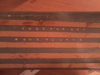

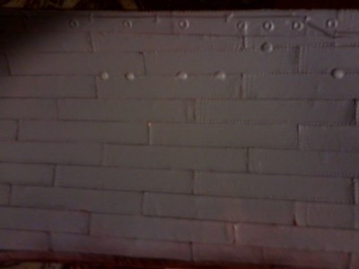

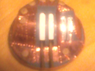

Next up was the hull. I wanted to add hull plates and rivets. I was thinking of using foil tape and a pounce wheel for this. I got the tape off ebay and bought the pounce wheel from a hobby store online. The effect was OK but the edges were a problem keeping down. I Liked the way the foil tape adhered to the detail but it wasn't what I wanted.
- 200 Yamato copper hull.jpg (19.57 KiB) Viewed 13586 times
- Lite layer of primer
- 200 Yamato primer plate.jpg (15.23 KiB) Viewed 13586 times

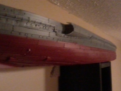

I was thinking of other ways to give the hull some detail. I was going to use styrene strips but I couldn't find any in the width I wanted. So after looking around I found chipbaord. It's like cardboard on the back on notebooks. I had access to a paper cutter so this made the job easier. I then wanted to add porthole covers and found a large hole punch for this. I also used the chipboard for the covers. After starting out not really wanting to go over scale much I said to hell with it. It's Yamato. She was over scale and so will this model be. I bought 1mm rhinestones to use as the rivets. I do wish they would have not been as much pronounced but what the hell. I did buy some 1mm dots that I plan on using for my 1941 version.
- 200 yamato hull.jpg (21.88 KiB) Viewed 13585 times
- 200 yamato port.jpg (19.4 KiB) Viewed 13585 times
- 200 yamato port2.jpg (21.03 KiB) Viewed 13585 times
- 200 yamato under.jpg (25.32 KiB) Viewed 13585 times
- 200 yamato under2.jpg (25.06 KiB) Viewed 13585 times

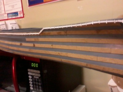

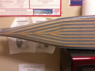

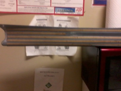

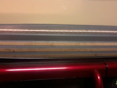

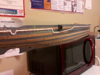

Next was adding the degaussing cable. I bought half round styrene strip and channel styrene. Buying the half round was a bad idea. Should have bought square. The channel styrene was hard to cut. I was using scissors and it bent the edges. If anyone knows of a better way to cut channel styrene please let me know. Saw maybe? The outcome was OK but if you had a closeup of the cable you can tell the defects.
- 200 yamato degause.jpg (23.07 KiB) Viewed 13584 times
- 200 yamato degause2.jpg (17.95 KiB) Viewed 13584 times
- 200 yamato degause3.jpg (25.78 KiB) Viewed 13584 times

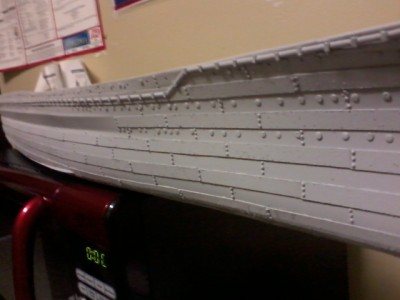

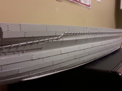

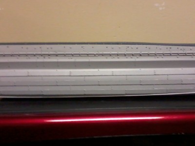

Next up was priming and painting the hull. I had been trying things out and after over a year I had yet to use any paint. I don't have an airbrush (might get one soon) so I used Tamiya dull red and Tamiya Kure Grey spray paint. It came out alright. But Im not looking forward to weathering it. I should have kept the rhinestone detail off the waterline. It was a pain in the arse to mask and I'm going to have to touch up the waterline to get it looking right.
- 200 yamato hull prime.jpg (21.66 KiB) Viewed 13583 times
- 200 yamato hull prime2.jpg (18.93 KiB) Viewed 13583 times
- 200 yamato hull prime3.jpg (19.77 KiB) Viewed 13583 times
- 200 yamato hull 2012.jpg (18.78 KiB) Viewed 13583 times

This is insanity, wonderful insanity. Your work on the hull looks good. I've seen these kits in person and felt like my 1/700 Fujimi had more detail...

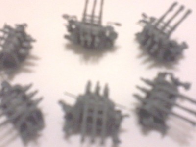

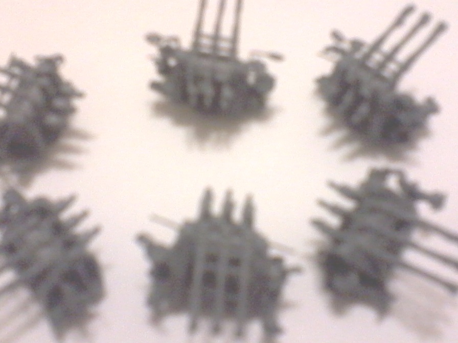

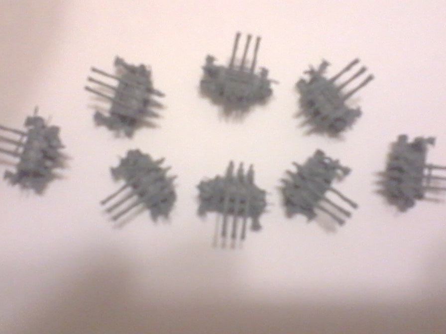

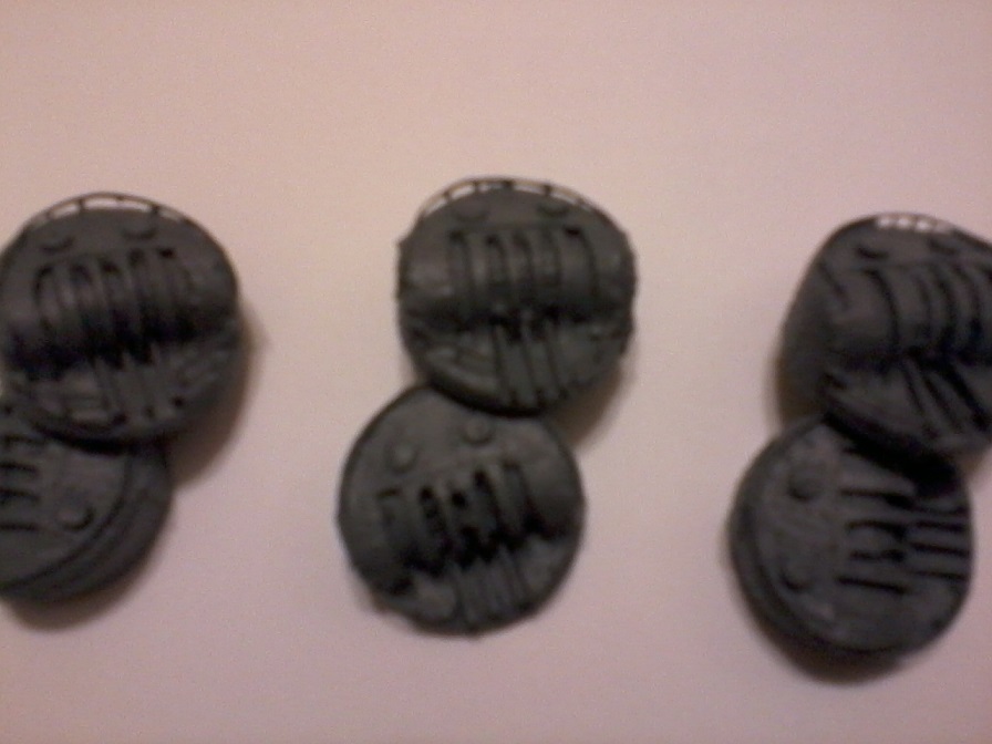

Next up was the 25mm guns and gun turrets. For the open guns I used Ebay aftermarket guns and used the GPM sights. Damn sights keep falling off the more I touch them. Will be nice to actually put them on the model and be done with them. For the encased gun turrets I added rivet detail with foil tape and a rivet maker but without some shading it is hard to see. I used loose 25mm guns from GPM that I inserted into cork.

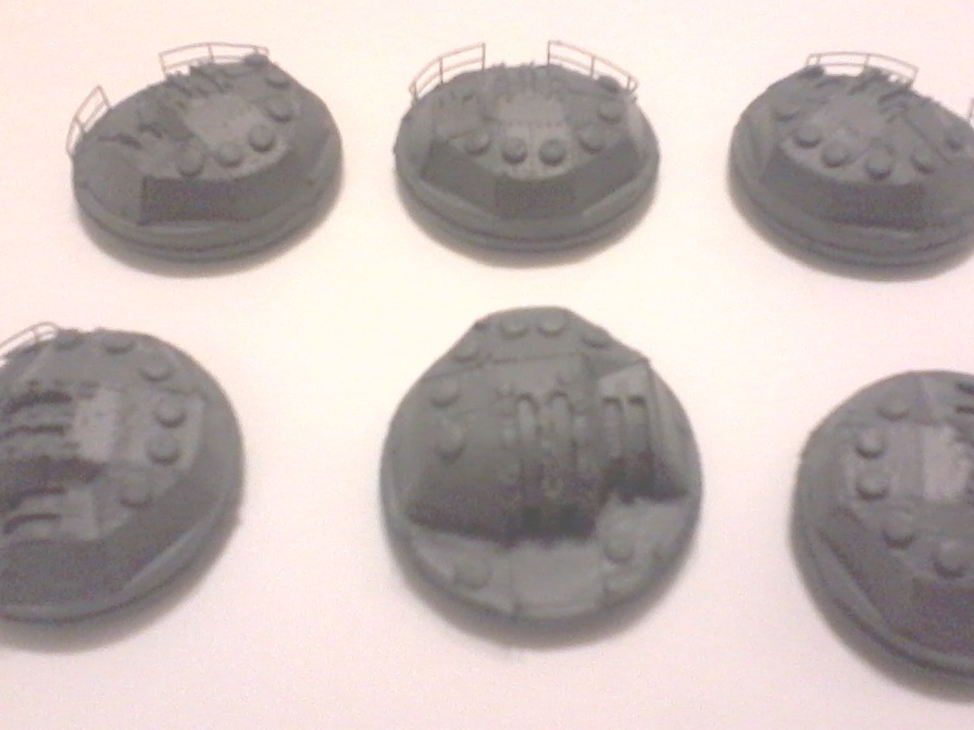

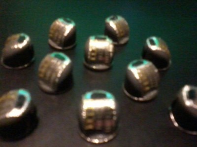

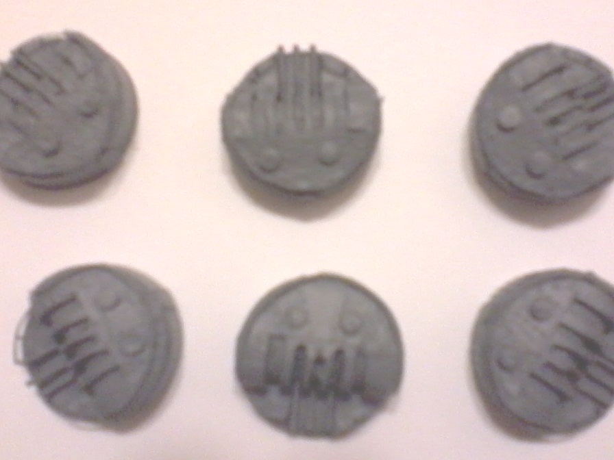

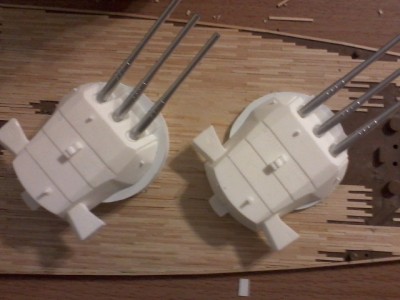

I tried again to add detail with foil tape to the 5 inch turrets. The camera on my phone sucks. So the detail doesn't show as well.
- 967.jpg (28.3 KiB) Viewed 13445 times

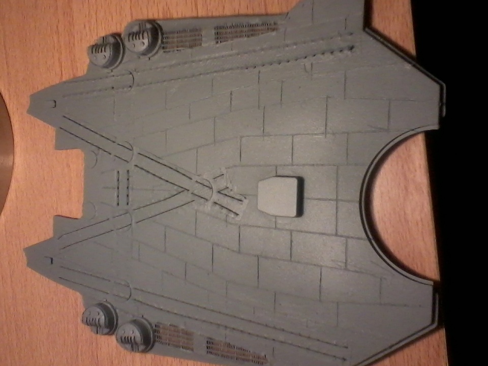

I've seen the aircraft deck with 2 different patterns so I went with the one I liked. I carved the hull with a file. I attempted to put tread plate under the rails using tin foil. I lost the GMM grills and had to make my own with wire. I haven't painted the linoleum strips yet.
