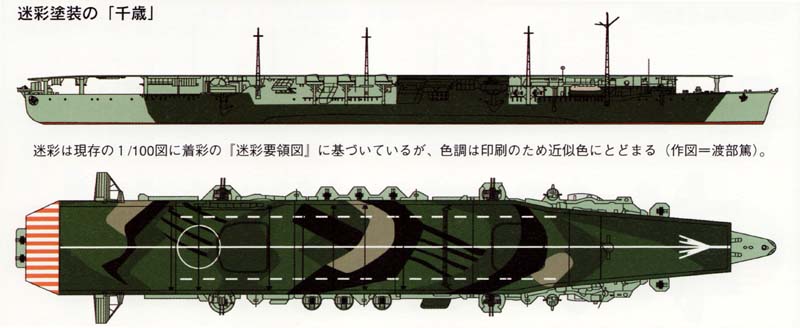

Here is a very nice little lady:
Laid down as seaplane tender. Rebuilt in 1943 into light aircraft carier. This is the version I would like to build. Painting as belov.

Since there is a very little references for that ship - it's a "suppose to be" design...
Any photos or source materials of Chitose in aircraft version would be very welcome.... :)

PostPosted: Mon Apr 22, 2013 12:05 pm
Posts: 8814
There's an excellent set of plans for one of the sisters as a CVL. I'll have to check which sister and publisher. I guess there's not to much on the CASF thread.
Maybe these can help
