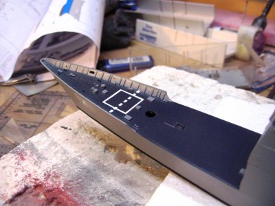

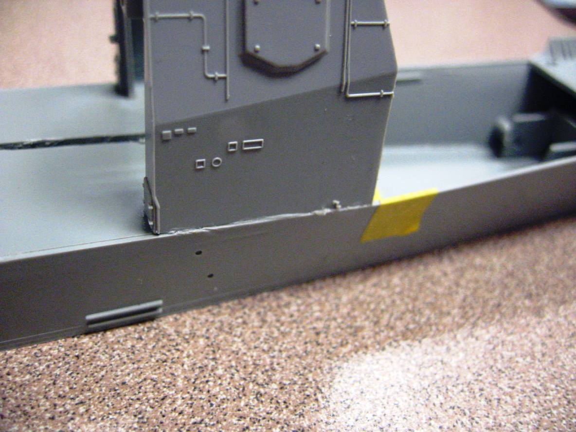

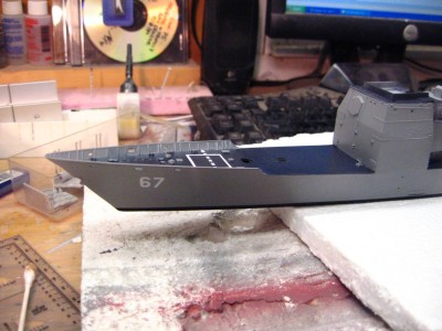

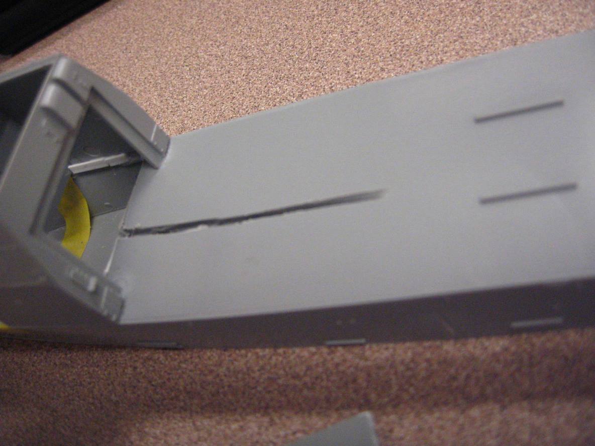

My first impressions of the kit are not good. Aside from soft details, there are some very serious fit issues right off the bat. Worst of these is the fit of the foreward superstructure to the deck, there should be a flush fit on teh sides, but this one has a very considerable lip that is going to have to be overcome.

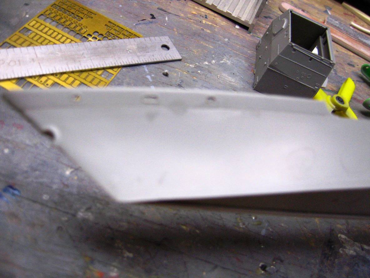

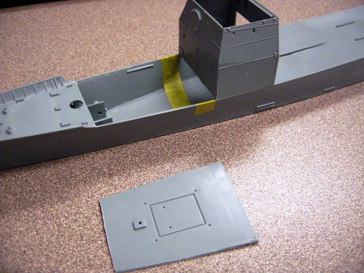

I replaced the stern deck with blank styrene, deciding it will just be easier to start from a clean slate rather than sand off the marking lines and deal with the kit part.

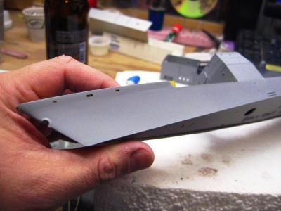

the plastic itself is brittle, the hull cracked right in the middle from only minor work on it.
While teh picture sucks, I was trying to illustrate that the front deck piece is designed poorly, and fit is not so great.
looks like she is going to be taking on water from this crack!

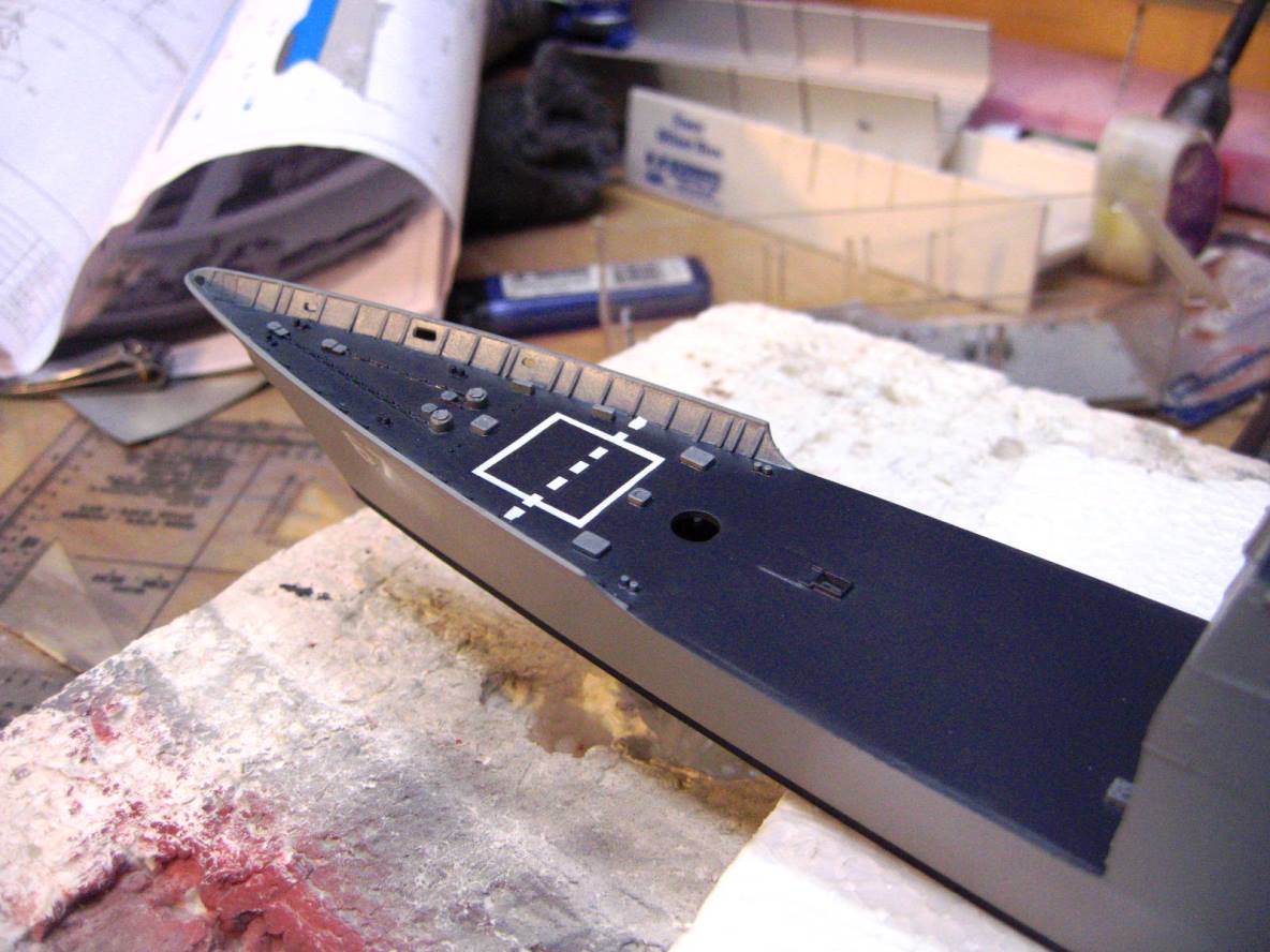

stern deck replaced with a blank.
and her backside, hole drilled for what I think is a towed sonar array.  Whatever it is, it will be there.  And yes, the array is off-center on purpose, I was not drunk when I drilled it (yet)

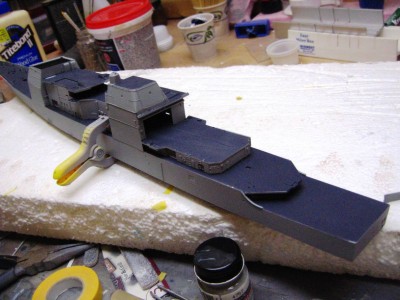

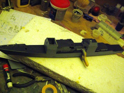

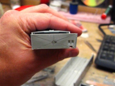

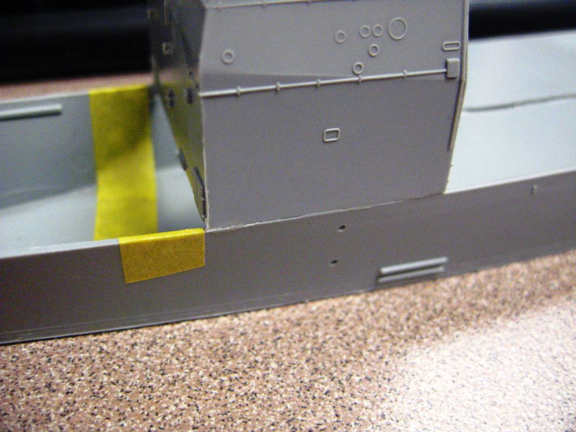

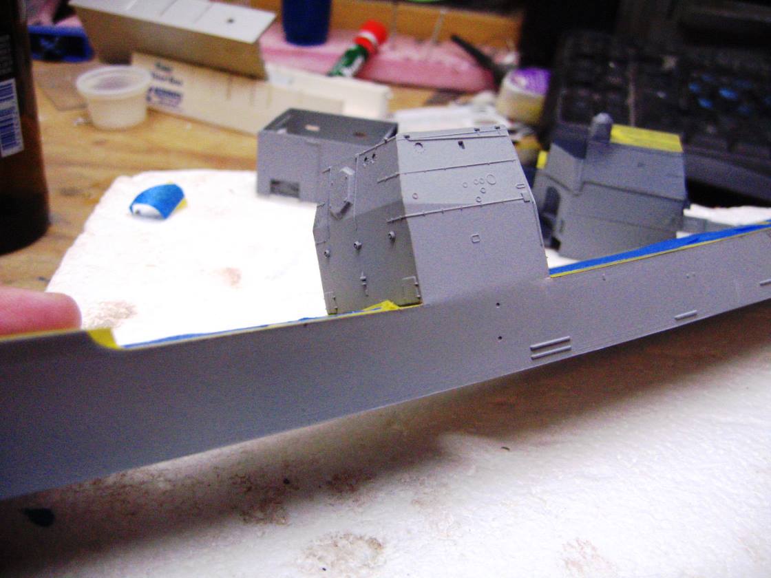

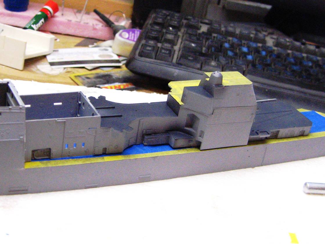

Well, I am very happy to say that the hull to structure fit issue has been resolved, and it was actually a lot easier than I had anticipated.
I removed a section of the fore deck (simple piece, 1ll replace it with a smaller scratch built one), removed the deck under the structure, and cut a channel in the remaining aft deck. this allowed me to pinch the hull sides in to conform to the completed super structure part. I reinforced the joints, and we are good to go. If I had not already installed the aft deck, I would have just replaced it with a styrene piece on each side, leaving a gap where I cut out the channel.

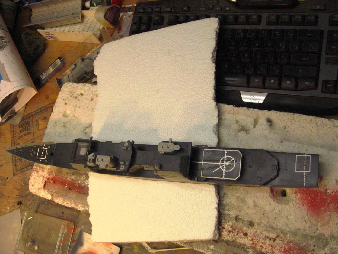

Well, I have finally beat the main parts of the superstructure into submission. On some of the parts, especially the flight deck to hangar fit, I can't even say the fit is poor. It is more like the parts were designed for 2 separate kits. I am finally happy enough with all the fit that I started painting her. All of her decks were painted first, now I am masking them all off so I can paint the hull and sides. She should start to actually resemble a CG pretty soon!

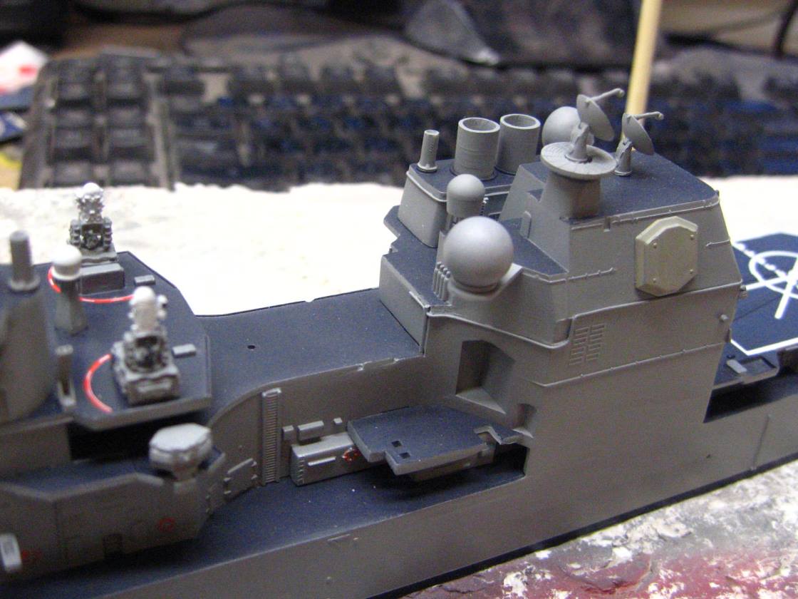

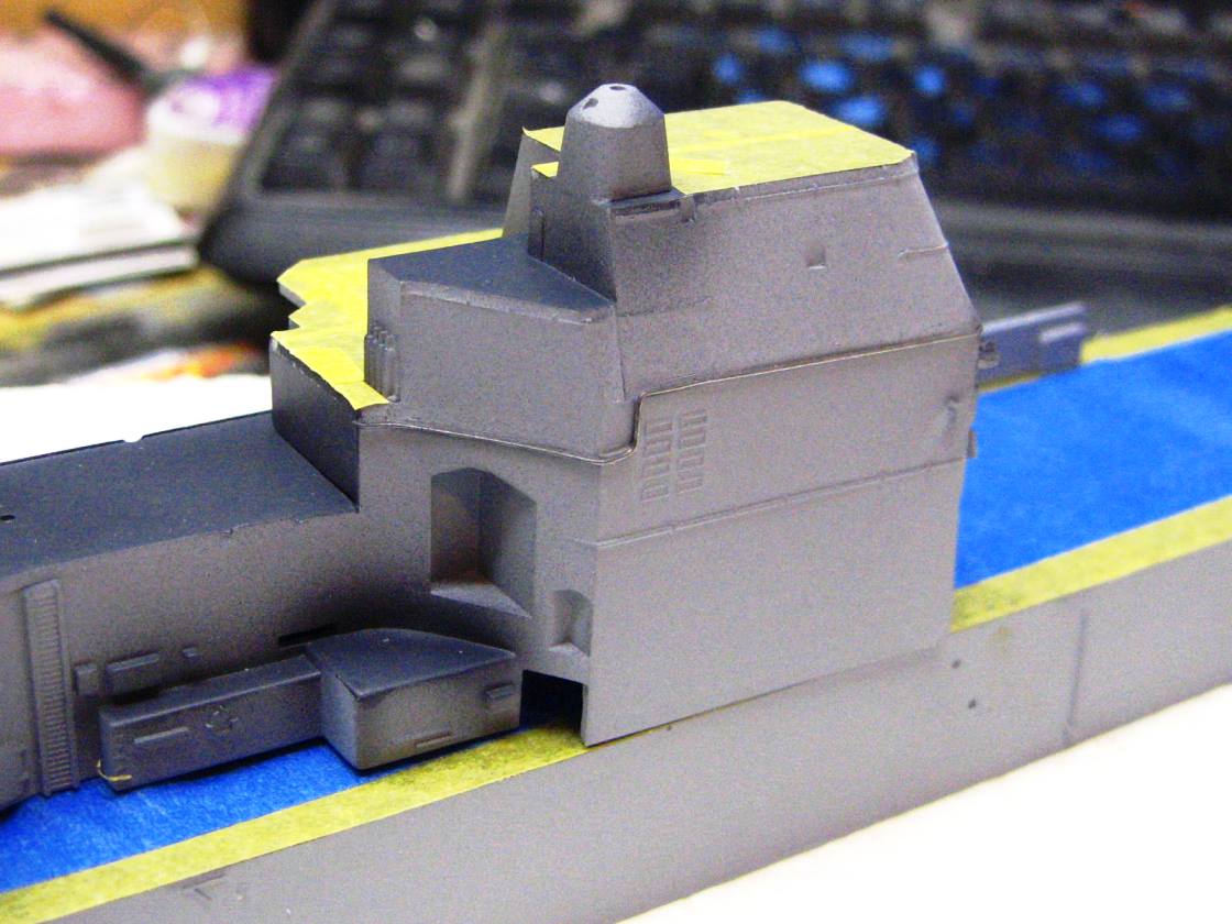

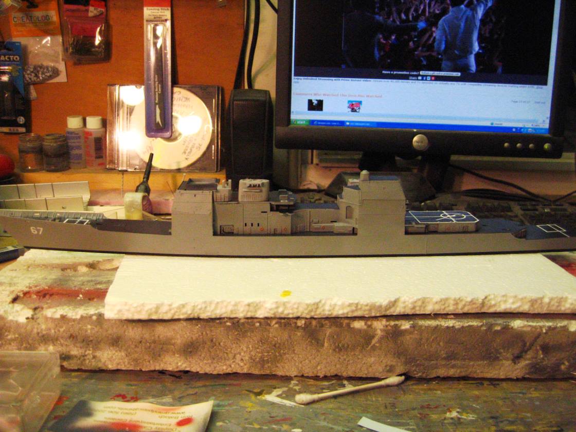

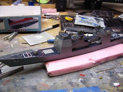

So main hull and superstructure colors are all done, one or two minor touch-ups needed. and in the words of Forrest Gump, "And that's all I have to say about that." :big_grin:

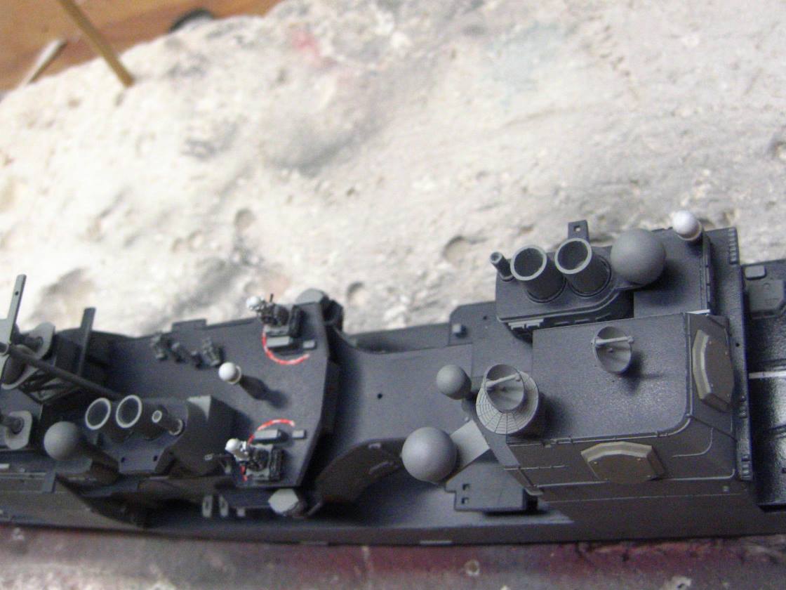

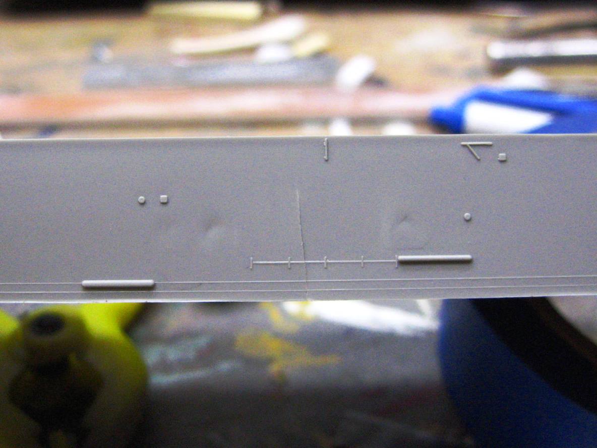

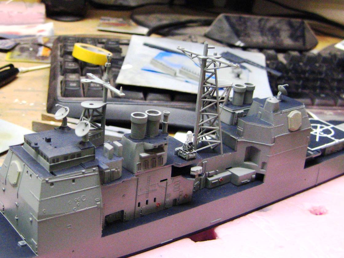

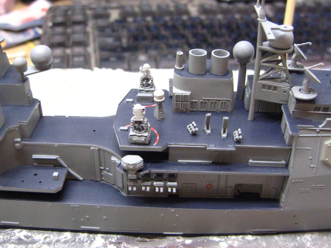

This kit continues to suffer from fit that ranges from bad to crap. Huge sections of plastic parts have been removed all over the place and replaced with styrene in order to get some type of acceptable fit. Luckily, I think all the surgery is behind me now. She got a lot of her markings, which are a combo of painted and decals.

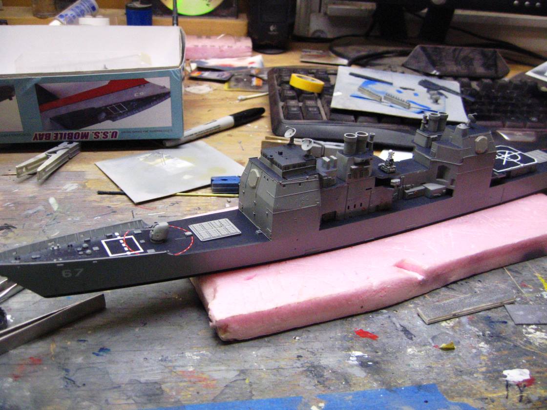

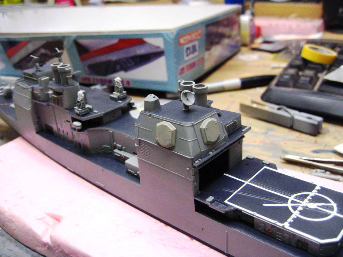

Nearing the finish line...sorta.
I think I am getting past the frustration with this kit's crappy fit, and it has morphed into a sort of morbid humor. Every time i think I have rounded the corner for crap fit, a new challenge rears it's ugly head. Seriously it is like this kit was designed by 2 different people who did not consult each other even once during the design process. Really, there are many parts that I can not even describe as having a poor fit, because they simply DO NOT FIT! It's like I am using parts from 2 completely different kits made by different companies.
Anyways, the good news is that with the exception of the mast to deck fit area called out in the pics below, I think I am done using any of the original kit parts. from here on out it is all aftermarket and / or scratch parts. At least if I am making parts from scratch I know that they are beign made by a professional and they will actually fit! :big_grin:
All weapons are from veteran, CIWS, harpoon, deck guns, and nulka & bushmasters which have not been installed yet.

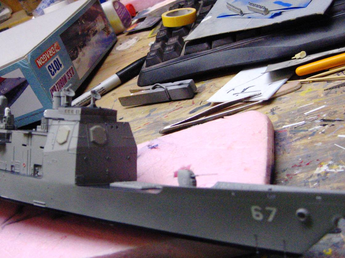

From the start, this was planned as an intermediate type build, mostly OOB for the main ship, with a few additions here and there to make it accurate for shiloh. In retrospect, it probably would have been easier if I just scratch built almost the whole damn thing from the deck on up. The horrible horrible fit has just taken all the wind out of my sails. But the ship, unfinished is like a nasty distraction teasing me and taunting me in my shop, and i have decided it is time to man-up and finish the beast. Even though there are a lot of things not installed on her yet, just about every detail part is finished and painted, just waiting for install as soon as I iron out what I hope is one last speed bump in her masts.
