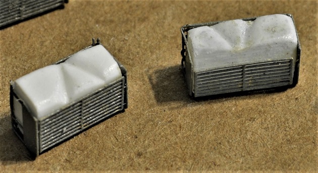

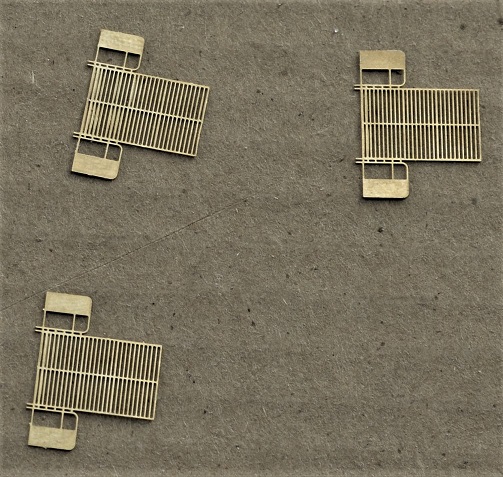

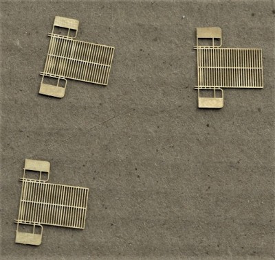

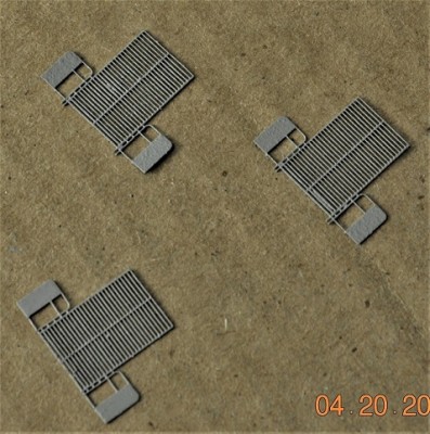

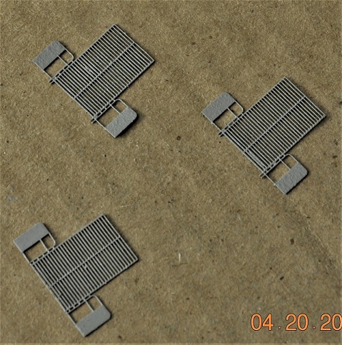

Last night I cut out, painted, bent to shape 7 of the raft racks on the sheet. Here are photos of a few of them as I progressed on this task. THESE HAVE NOT BEEN COMPLETED - THEY ARE SIMPLY FOLDED TOGETHER WITH THE RAFT PACK TO SEE ABOUT THE FIT & SO FORTH!!!
The racks need to be properly glued together and the raft pack painted and replaced. Then, the rack assembly will be ready for installation. Only 53 or so more to go!!!

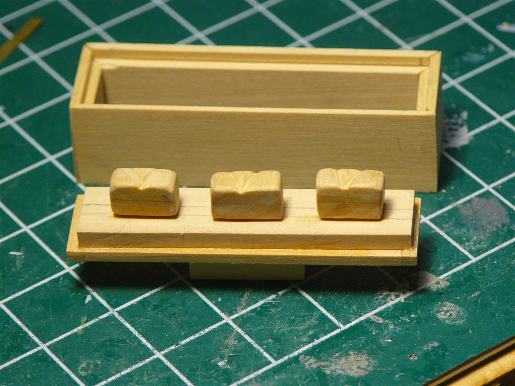

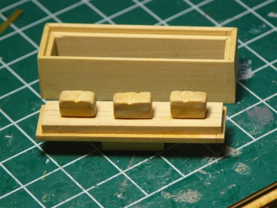

And thanks, Tom - for the mold with which to cast the raft packs!! Of course, this came about several years ago so these little dudes have been sitting around waiting for the racks to be designed, printed, and assembled. I did have to do some sanding on 3 sides as the racks are slightly undersized for the packs; but this isn't a deal breaker, just a small amount of work on each one. As the hull/deck work proceeds, I plan to do maybe 1 row (7 racks) a night, so that's spreading out the extra time a bit.
Mark, Tom cast the mold from 3 boxwood prototypes I sent him - here is the mold box & 3 prototype masters:

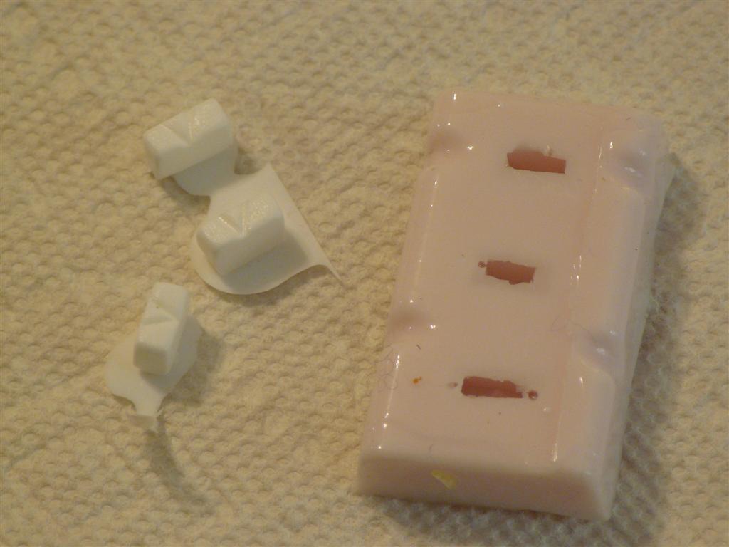

Here is the mold and 3 castings:
Doesn't look like much, but it works, so that's what counts. The packs are cast resin (2 part) from Micro-Mark.

Hank, the strapping on the rafts? Are you duplicating this with thin tape strips or just painting a strap line on?
Tom - Well, originally I had designed the PE sheet to include the triangular shaped straps, but the vendor could not print it, so at the moment I'm not sure how to replicate this. I still have the Micro Mark PE kit but I really don't want to have to get into all that at this time. However, having said that, it may be the only way to do this. Sometimes need precedes desire, right?
I actually have the necessary racks painted and put together as of last night - the packs I will spray early next week and insert, ready for installation when I get the superstructure unit out of the closet (no pun intended, believe me!!!) to work on it.
It's interesting that while at NARA last month I did find one photo of NEW JERSEY during her sea trials in early '68 that shows three of these racks (deck mounted above the whaleboat) with white packs, not the usual gray that you see in most photos of the time. I have a picture of me standing at the end of the whaleboat in 1969 that shows the std. gray raft pack in the same racks. Somewhere, they must have been replaced. My life raft packs will be a slightly ligher gray to set them off from the rack itself.
PostPosted: Thu May 04, 2017 11:15 am
Posts: 5011
Try some really thin tape for the straps, cut into a narrow strip. My guess is that they didn't replace the packs but just furnished a new cover? I think that tape will work better than PE, which would have trouble adhering to the curves like a real strap would.
PostPosted: Thu May 04, 2017 4:34 pm
Posts: 2948
Location: Mocksville, NC
Tom Wrote:
Now that's a good idea - one worth exploring, for sure!!
Thanks, Tom
