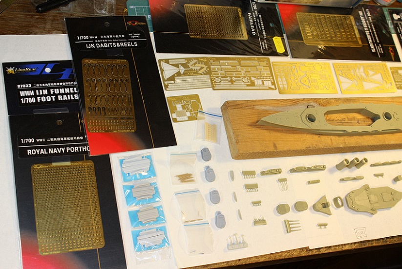

I would like to share with you an account on the construction of my 1:700 Combrig HMS Tiger.
She will be shown on a common seascape with my recently completed SMS Derfflinger that some of you might have seen.
The diorama will feature the two ships in early 1919 - SMS Derfflinger at anchor with HMS Tiger steaming past her.
Contrary to what I have posted before this is intended to be a much more detailed account on this build, so it will inevitably become
a lenghty one as alas, I am a slow builder with limited time for my hobby.
I hope however that the ones who persevere will find something enjoyable or useful in it.

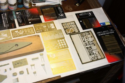

I am through the planning phase and acquired all the stuff deemed necessary for the build.
As you can see the hull has been screwed to its temporary base and the kit parts are surrounded by the eleven photoetched frets of the prodigious Artist Hobby update set as well as two sets from WEM and ten from Flyhawk and Lion Roar.
The Artist Hobby set also includes replacement main turrets of resin plus turned brass barrels for the main and secondary armament.
I plan to use some Admiralty Model Works boats and aircraft.
The printed reference can also be seem in one of the pictures - besides the books featured I have collected a number of photographs from the internet. Jim Baumann has kindly sent me some others.
I will rely on the pictures of the models built by Vicent c.f. Lau, Mike McCabe and John Werler in the first place, as they feature a state of the ship more closely related to the one I intend to depict than the others I could find, but studied photos of every build I came accross throughout my search. I would like to thank everybody for making accessible images of their superb models.
The pictures will be shot by my Canon EOS 450D camera but will have to be reduced in size to conform the rules of this forum.

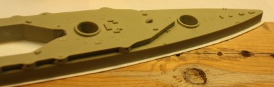

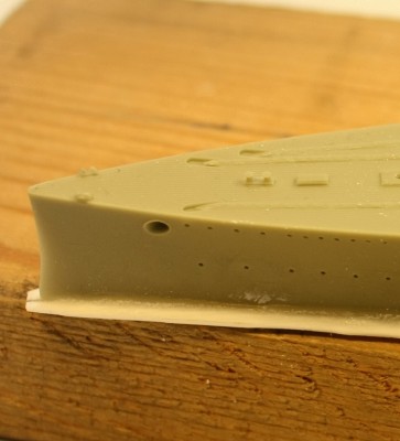

I don't share the common view that the majectic appearence of this ship has been spoiled by the alterations that took place after Jutland - on the contrary - the more substantial bridge structure adds quite a lot to her appeal in my opinion and the short mainmast fitted to the derrick stump does not make her look unbalanced.
I started with measuring the freeboard and compared with the drawing in the Burt book it seems to be spot on - initially I though it would be too high. I glued a plate of styrene of 0,5 mm thickness to the bottom of the model because it will be surrounded by the seascape at least that high.

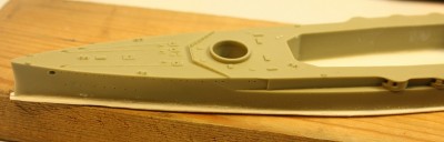

Then the styrene was faired into the hull by sanding with 200, 1000, 1200 and finally 2000 grit wet-and-dry sandpaper.
I took the opportunity to alter the shape of the cutwater to make it flare forward towards the waterline as it should.
Before
and after correction.
(this is a blurry image but the difference can be seen)

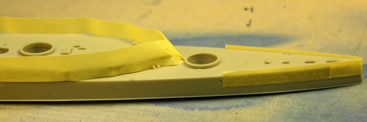

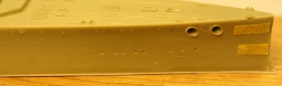

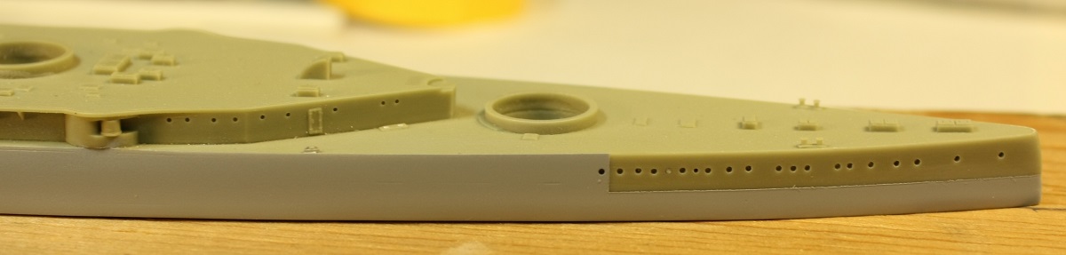

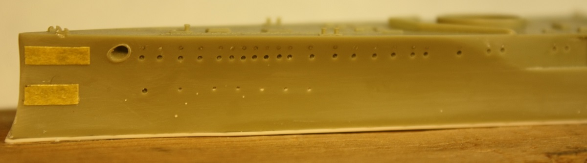

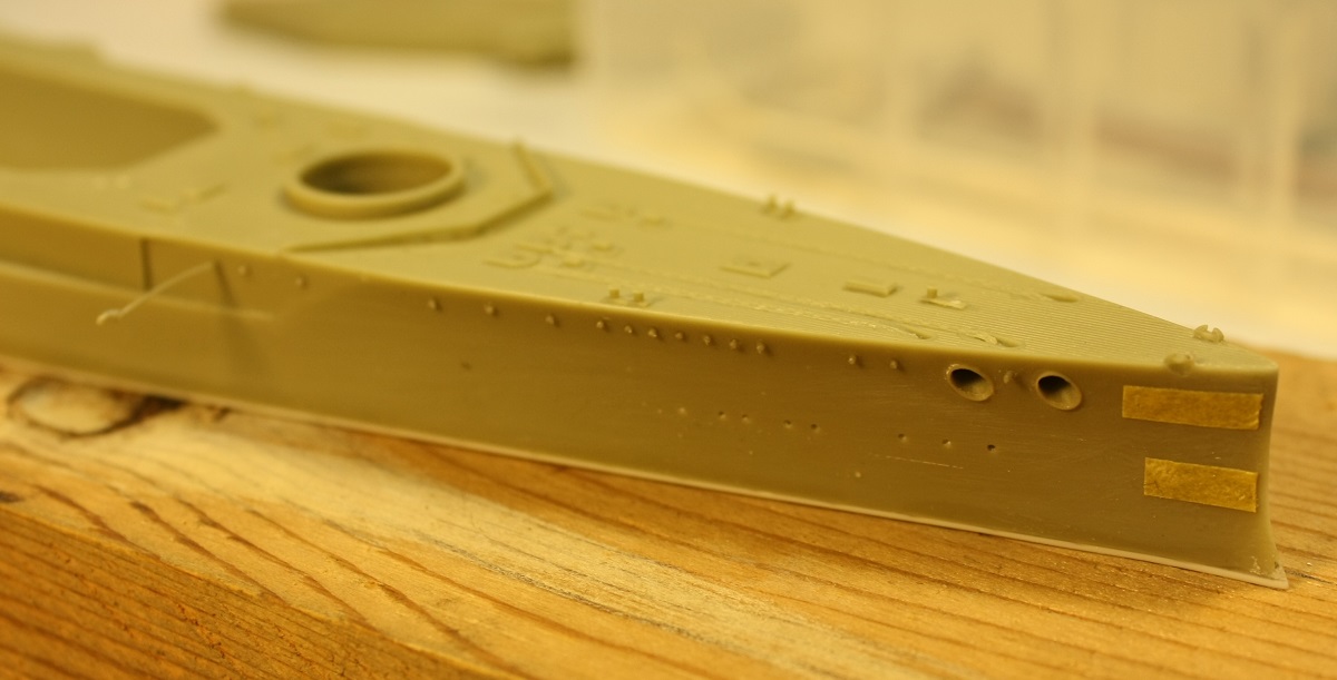

Next I started to mask the strakes on the hull when I realised that the top row of portholes is too high and parallel to the deck, not the waterline, as it should be. I filled the portholes, sanded them smooth and drilled another row underneath.

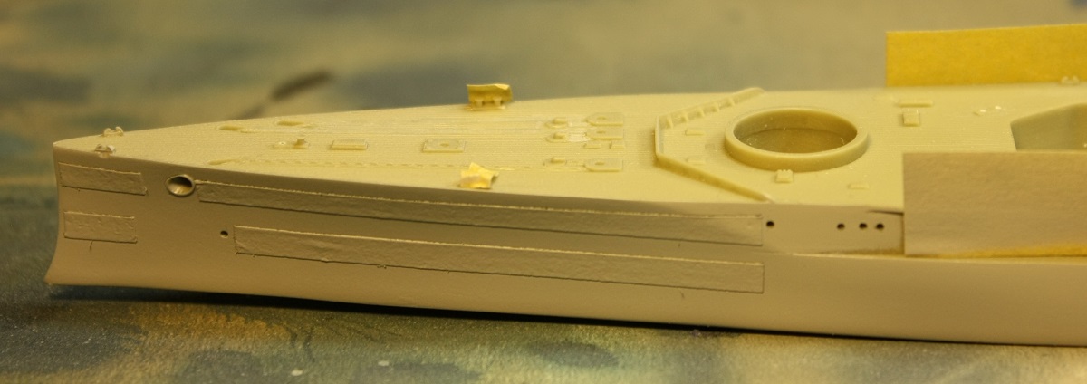

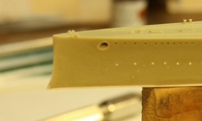

I promise I will not post every day, it's just that I have made some progress.

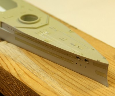

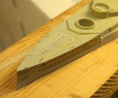

All the portholes in the hull sides have been redrilled, the armour strakes masked and the side sprayed with Mr.Surfacer.
I have to make some refinements but I think I managed not to overdo it - these strakes are only just visible in the close ups of the original.

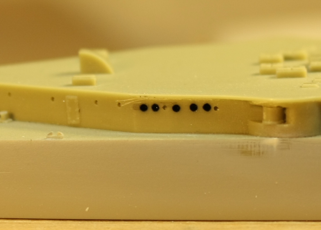

I drilled the holes and tried to secure her to the base by screws to ensure that this process will be smooth when the ships is ready. I had two screws of slightly different dimensions and finally the larger one had been screwed into the bows causing it crack and finally break off. I ended up with a 4 cm section of the bow missing. I quickly realized that this hull will not be fixed - the detailing would not have been possible to restore, so I tossed it in the trash. Within fifteen minutes a new Tiger model along with the Artist Hobby detail set had been ordered from WEM and with a help from a friend, Greg Gobl who generously lent me his Tiger I could recommence the build the very same evening.
It goes without saying that this was a severe blow to my morale (and bank account).
It was hard to get through the same phases again but this time I tried to reach new levels of accuracy. Almost all scuttles have been redrilled.
I painted the holes black betore attaching the rings or bulkheads:

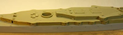

I can celebrate - I surpassed the state of construction of my previous effort in this 2.0 version.
Here's what I arrived at:

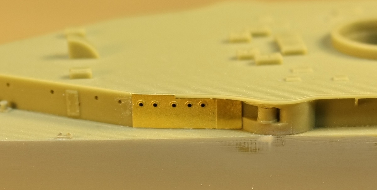

Maybe I studied the pictures of the original too long. Upon noticing that the casemates had a grab rail (doubled on the actual casemate gun installations, single between them) I knew I just had to add them - I have never seen them on any model of any scale before.
This was the PE set used:
And this the result (sorry about the poor photos):

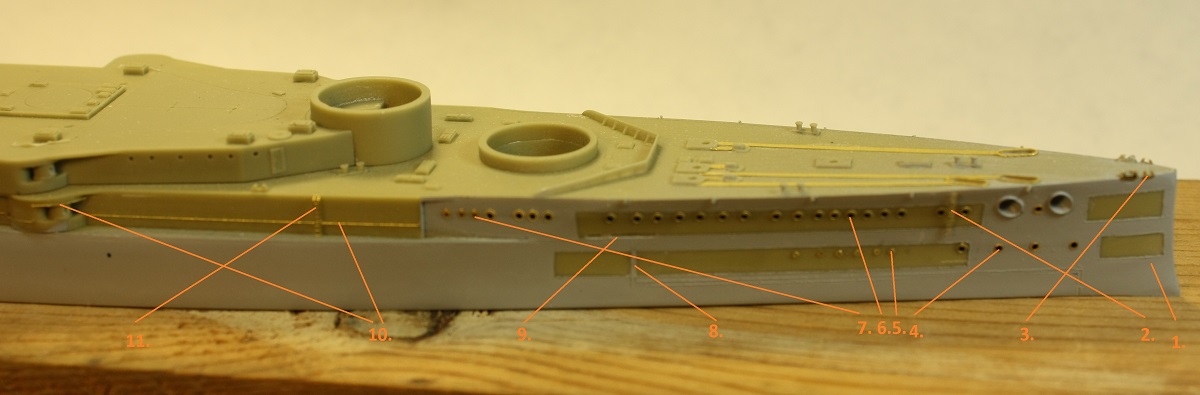

In the following picture I show what's been done to the sides of the hull:
1. armour strakes represented by spray primer (will be hardly visible when painted)
2. steps out of cutting a WEM ladder to individual rungs and gluing them to the ship's side (faintly visible in this not-so-perfect picture)
3. small fairlead (Flyhawk)
4.5.6.7. portholes (Artist Hobby and Flyhawk, big and small, with and without rigols). I attached these because the ones AH provides are really very fine (and tried to make them thinner by sanding). I know Jim Baumann won't like them and he's probably right, as there was no such protruding ring around the portholes in the majority of real ships. I don't think I will utilize them in my next models - using them now can be regarded as some kind of tribute to the oriental style of modelmaking - attaching insane quantities of PE parts throughout, doubtless attractive, but sometimes producing exaggerated details.
8. the aforementioned strip covering the edge of the armour belt
9. a recess of unknown significance - scribed in nonetheless
10. grab rail (Lion Roar)
11. ladder (WEM)
