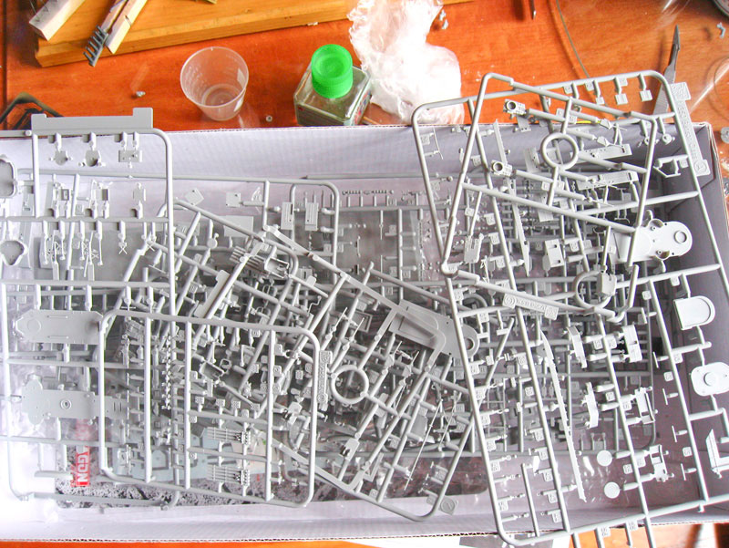

File comment: There are a TON of parts in the box (and this is with the hull and main deck sections already removed)

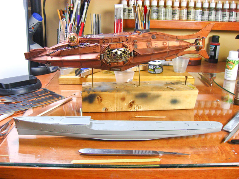

File comment: A quick mock-up, making sure everything fits. The parts go together quite well, even in this dry fitting. The sub in the background is the Pegaus submarine Nautilus that I'm just finishing up.

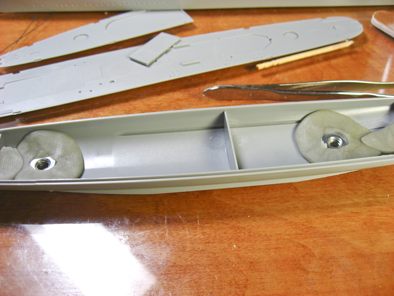

File comment: I drilled out the mounting holes, as this will be a full-hull build, and mounted nuts with Apoxie Sculpt putty. The nuts will allow various lengths of screws to be used to mount the model as the build progresses from initial assembly, painting, and final mounting to the base.

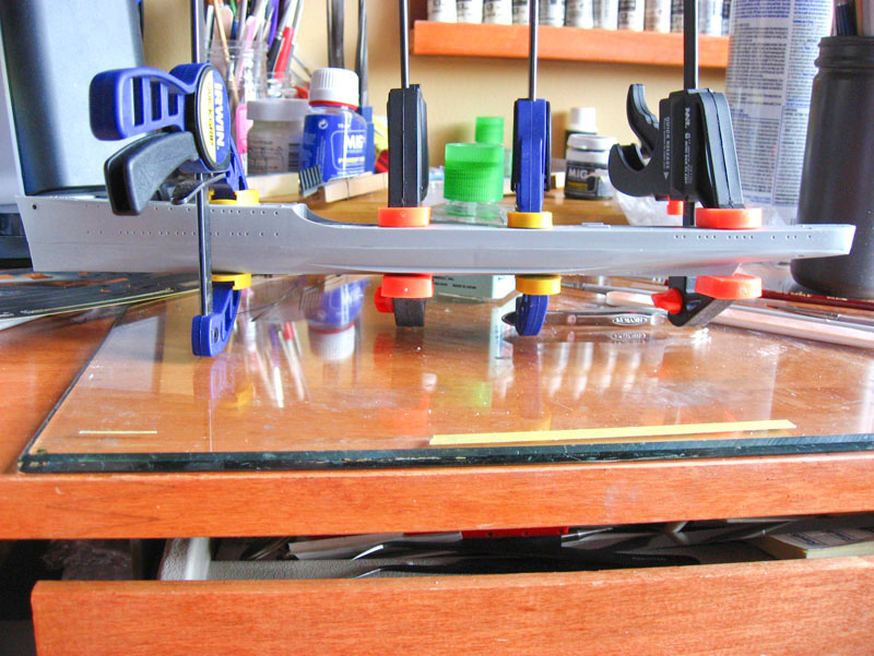

File comment: Everything glued and clamped together. I took a little finesse here and there to minimize seams between upper and lower hull, and around the main deck edge, but doing so results in very little putty being required when fill-and-sand time comes.

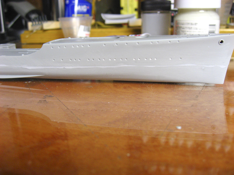

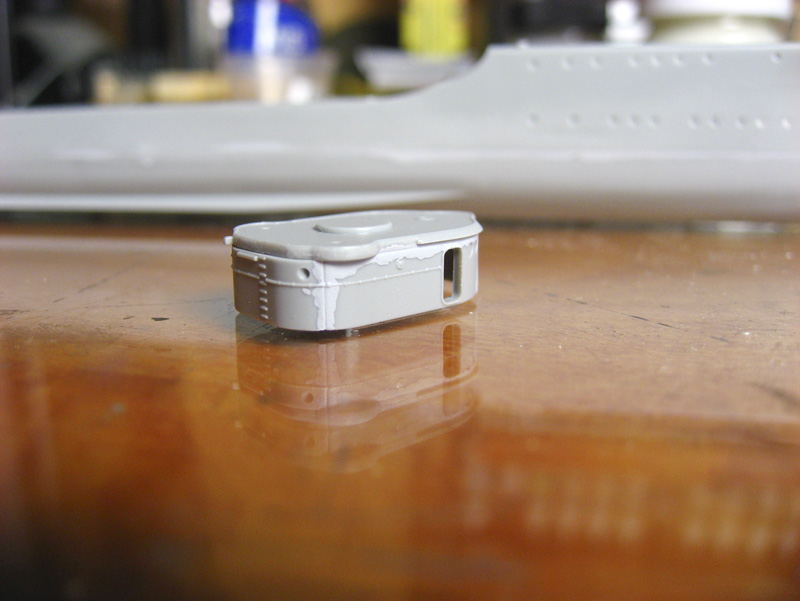

With all of the major sub assemblies except for the weapons assembled, I can start filling seams. The kit has the blessing of a lot of very fine surface details, but the curse of having a lot of those fine details intersected or adjacent to seams that need filling. The hull isn't an issue, as without porthole gutters, or "eyebrows" it's a simple matter of filling with Mr. Surfacer then sanding. Old school and simple.
On the superstrucure parts with the hand rails, electrical conduits, and door coamings, I could go scorched-earth and just sand it all smooth -- which I may still do -- but I wanted to see if I could preserve the detail. The uppermost level of the forward superstructure received very precise applications of Mr. Surfacer with a fine brush. After that had dried for over an hour, I dampened a Q-Tip in nail polish remover and started erasing: rub back and forth over the area, perpendicular to the seam. At first nothing happens, but as the remover works its way into the Surfacer, it begins to rub off of the raised portions (the surface and the details) and remain in the recesses (the seam). I won't be able to tell if it worked well enough until I get a proper coat of primer on the piece, but so far it looks pretty good. I'll still remove some of the detail that'll look better with PE aftermarket, such as life rings, fire stations, etc., but the fine hand rails and conduits that would be over-scale with styrene replacements may be saved after all.
A little extra work, but I'm glad the kit has these details, allowing me the option of using them or sanding them away and making my own.
Some photos:
File comment: The hull, straight forward fill and sand. The stern need some more work and putty, but overall the entire upper/lower hull join is pretty easily cleaned up.
File comment: Mr. Surfacer applied to the seams.
File comment: Q-Tip and nail polish remover clean-up completed, partially. The corner will need another application, but the seam between the overhead and bulkheads cleaned up a lot better than I could have done with sanding.

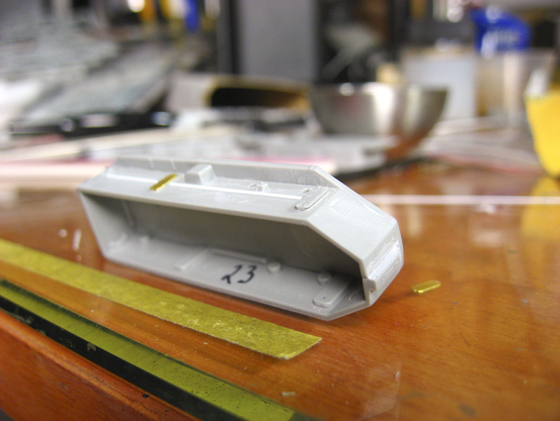

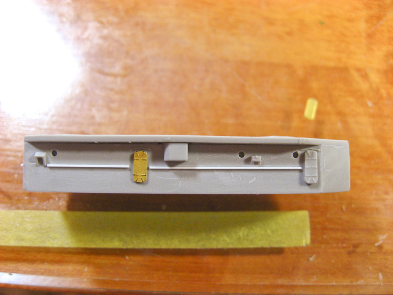

As I predicted, I ended up sanding off the molded in hand rails. They just didn't have enough of a 3D look to them. I'm using some .5mm round styrene strip to replace them. It's tricky work getting the strips lined up and then putting on enough glue to hold them in place, what not putting on too much that'll run, puddle, or warp the fine strip.
As far as the doors go, I'm stuck. The one on the right is the molded styrene version, which snaps wonderfully right into the opening. The problem is they stick out a bit too far and are overscale.
The provided PE doors look good, but they're just a hair too small. It takes a good two minutes to line each one up in place (try taking that much time with even a slow drying glue like Gator Glue), and then they don't quite cover everything. In the photo you can see there's a slight gap at the top.
My third option is to try aftermarket PE doors, but as luck would have it, from the literal dozens and dozens of envelopes of 1/350th scale WWII photo etch I have in the house, not ONE is a door set.
Just one photo tonight:
PostPosted: Tue Jun 03, 2014 9:30 pm
Posts: 2143
Location: Hoboken, NJ

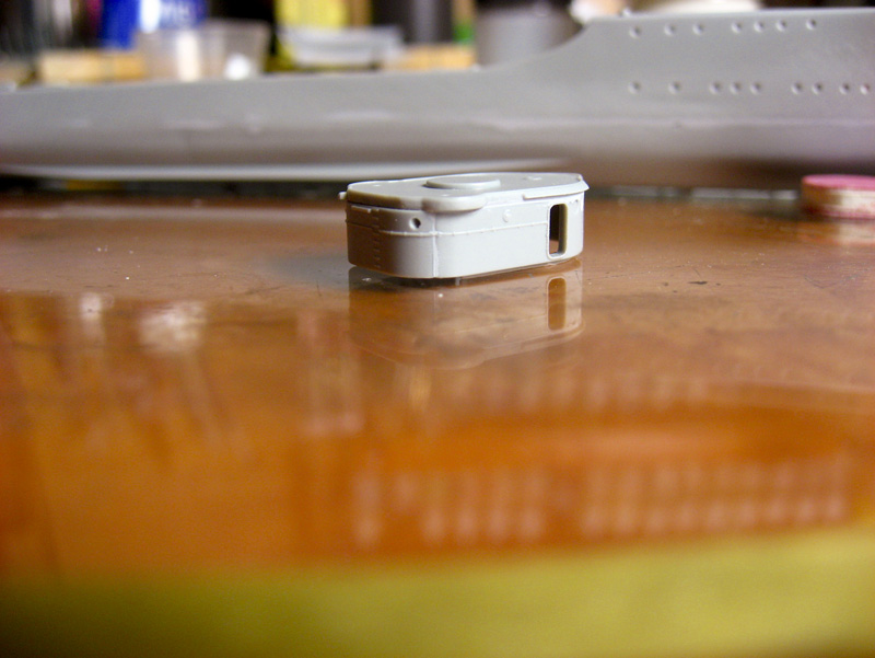

Actually, one more photo tonight. After walking away and coming back with fresh eyes, the styrene door doesn't look that bad. A little thick, but under that overhang, with railings and other details between it and the viewer... Plus,using them will save me literally hours of work. The brass door is thinner, but not by leaps and bounds, and I'm not one to use PE just for the sake of it.
I'll sleep on it, look again in the morning.
