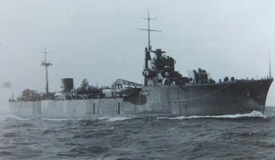

In a web I find only two pictures of this ship, or I should say grayscale and colorized versions of one photoshot.

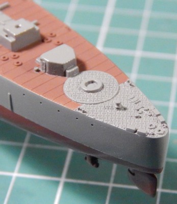

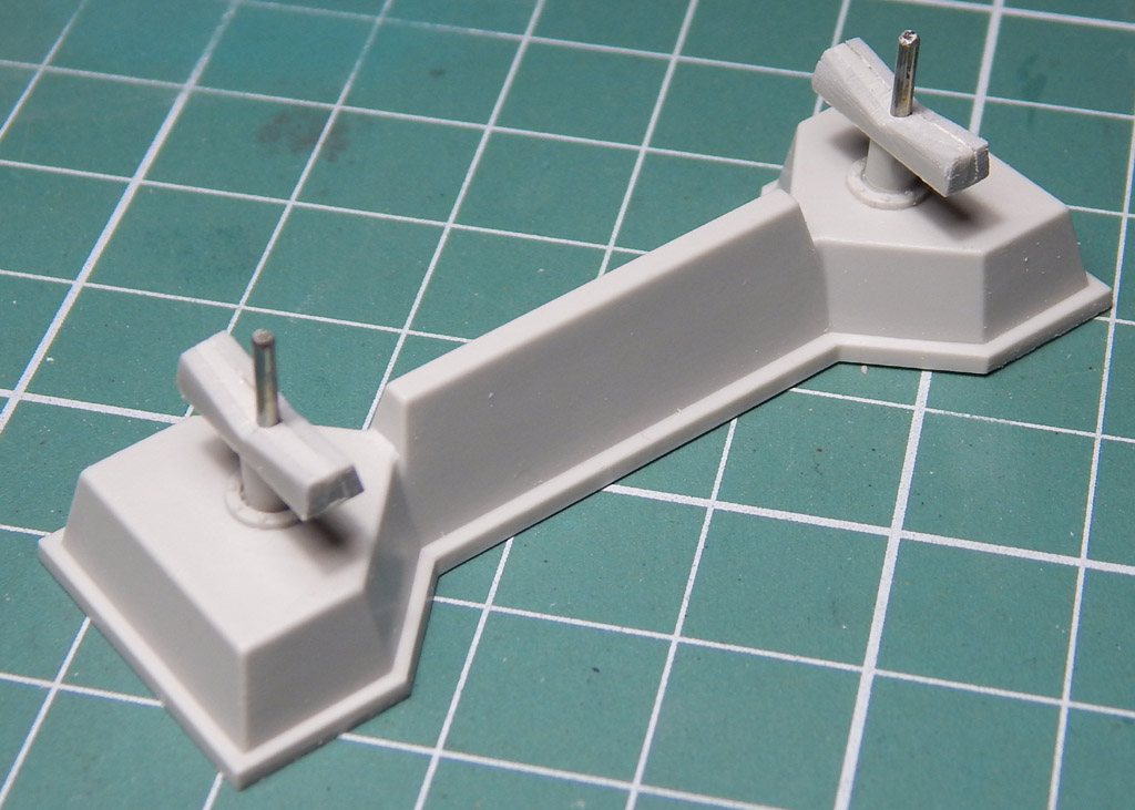

...Display stand and the bottom modified a little bit. The kit gives the option to assemble waterline or full-hull model but I prefer full-hull ships...

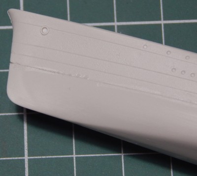

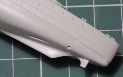

Than the halves of hull were glued. You can see the gaps. I used CA-glue as a putty few times...

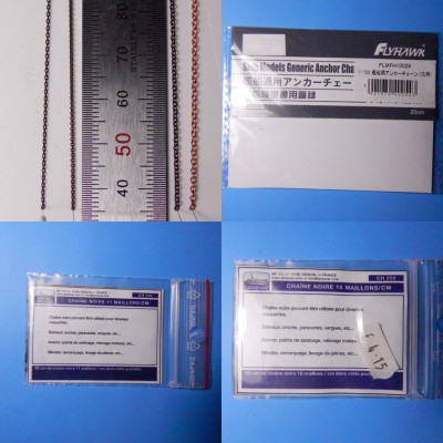

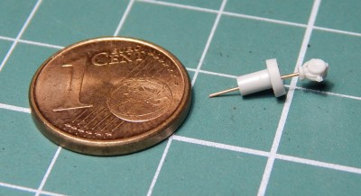

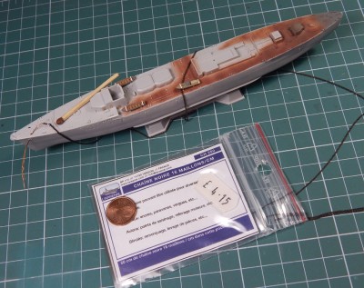

Anchor chain added. Capstans made of aluminum rod. I used L'Arsenal chain 16 links per cm...

Comparision of chains (left to right): Flyhawk FLMFH10026, L'Arsenal 16 links/cm, L'Arsenal 11 links/cm, Artwox bonus for IJN "Jingei" wooden deck. As you can see first chain is more preferable (but I have only 20 cm of Flyhak chain and 51 cm of L'Arsenal).

For the future, you can try to "squash" the circular L'Arsenal chains by clamping it in a vice, then pulling it taut, and using a pair of pliers to squeeze the links so they're more rectangular. It'll reduce their link/cm count, but would look more realistic.

Thank you very much! I shall try this technique on another project. For "Ashizuri" too late now...

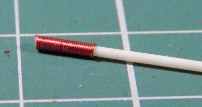

Drums. Copper wire fixed on styrene rod with zaponlack. Simple device made for cutting of drums with equal length.

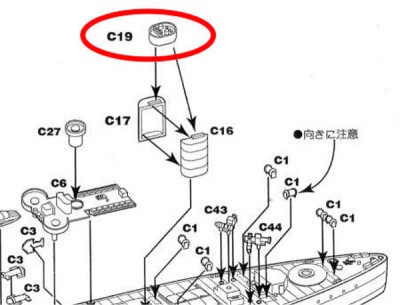

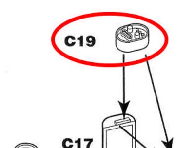

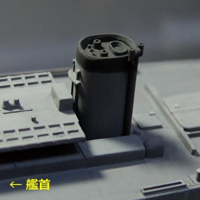

Looks like Assembly manual gives wrong position of funnel. It must be turned on 180 degrees (but I am not sure).
My opinion based on sistership "Shioya" drawings
...drawings of Japanese modeler with nick "hsn5656"
... and the model of another modeler with nick "ddminekaze"
Best regards, Yury
