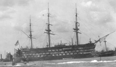

black and white-- all though in dead straight lines-
no concession even to sheer line...
-even across the anchors !
excellent !!
JB

Dear Goodwood, to be honest, knowing the original Vic-version, already the 1803 striped version was a bad mutilation - and still everybody is building this one ;-)
And Jim - thank you a lot for the picture, I have it in a worse resolution so it is a great update! Now it confirmed that even though usually being labelled "Victory" it is not, my personal believe to be the Wellington.
If one looks around, there are loads of pictures of the empire attitude of the Victory, but only a few in a useful resolution, those ones I am seeking still.

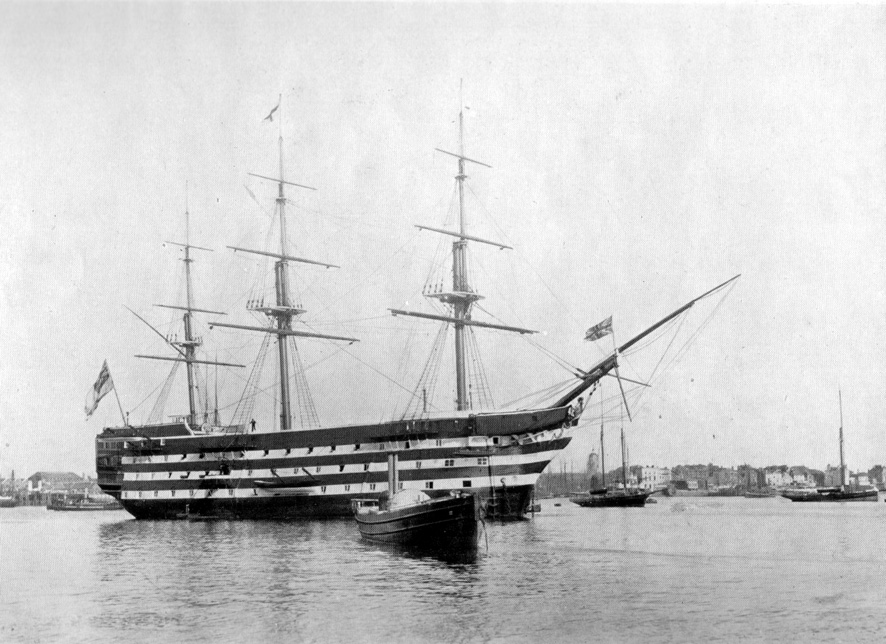

Since the start of this project I was extensively searching for traces of this version of the Victory and I found 3 to 4 dozen good photographs and drawings that slowly give an impression of the state of the outer hull. Mostly from postcards - I already managed to get hand on some interesting copies - but also through some original photographs. One of those someone managed to snap away just from under my nose on ebay - should have hear me cursing! If it was one of the readers of this lines here then I would swap all those curses with all my heart into "best friend mode" to get a scan of the picture ;-)
More difficult to define are the head and the deckw especially the forecastle. The small houses seem to have been added and changed by time, not making things easier.
On the first picture the small hut was not build yet. Only a big skylight is established.
Here the hut appears still smaller than in later times, the big chimney is missing, but the small one is there as the are the boxes (?) and the small companion way. Good for orientation is the start of the hammock boxes and the last fore shroud.
Nice to see the round bow and the hammocks running around the forecastle. This picture is a good reference as it is quite good to fix the date and the final version of the changes. It appears that behind the hut still can be seen some parts of the skylight of the first picture? Also could it be that the small companion way is overbuild by the hut? The small chimney looks to be still in place.

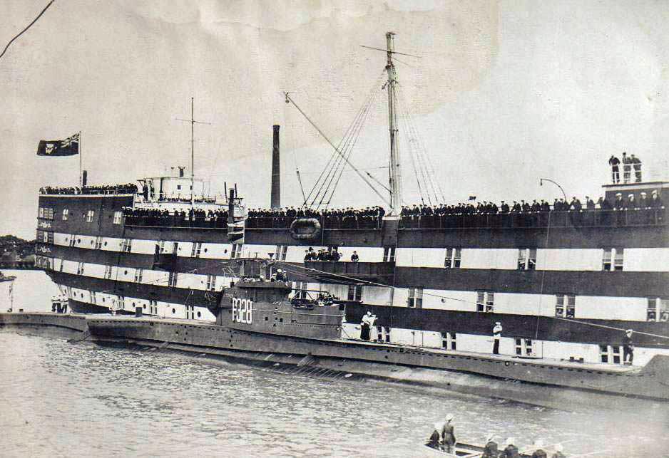

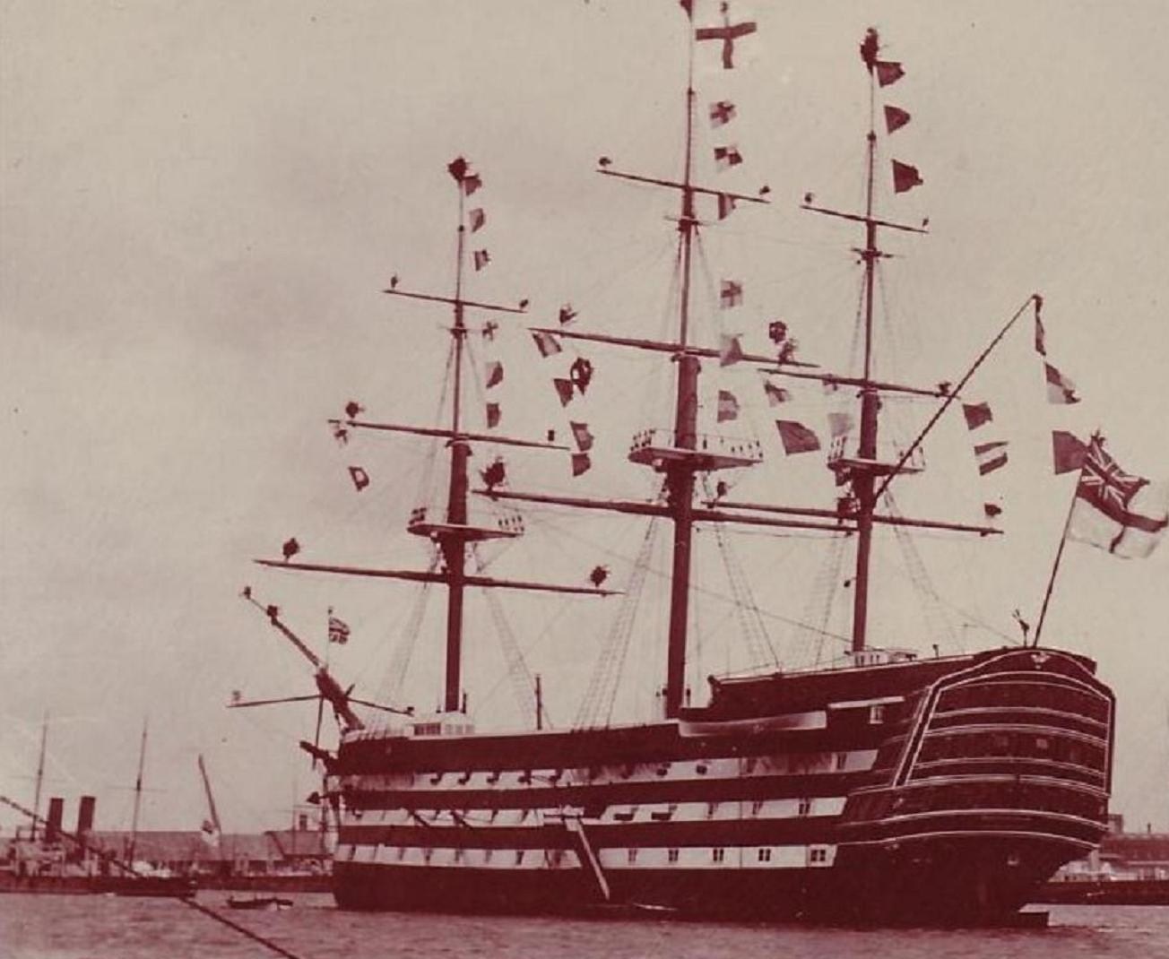

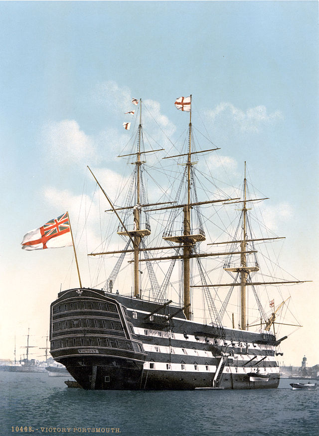

a couple more nice views
